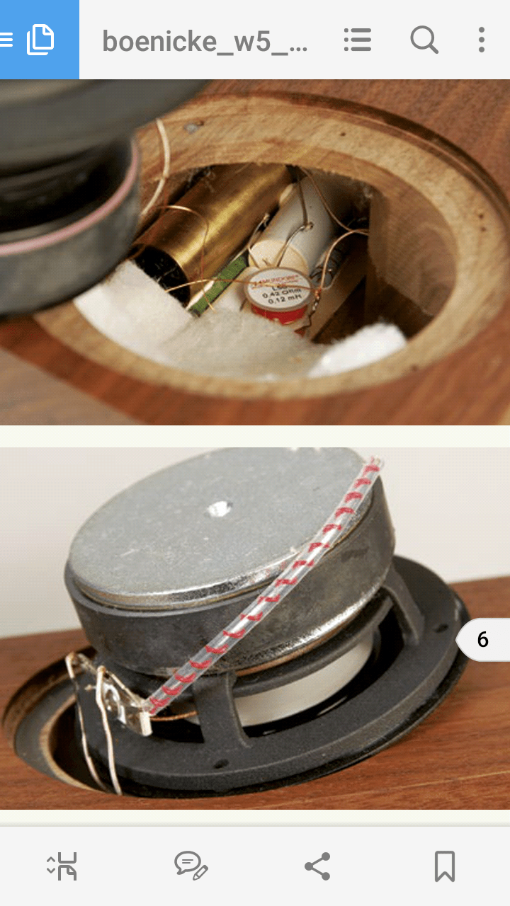

What is that red thing wire on woofer?

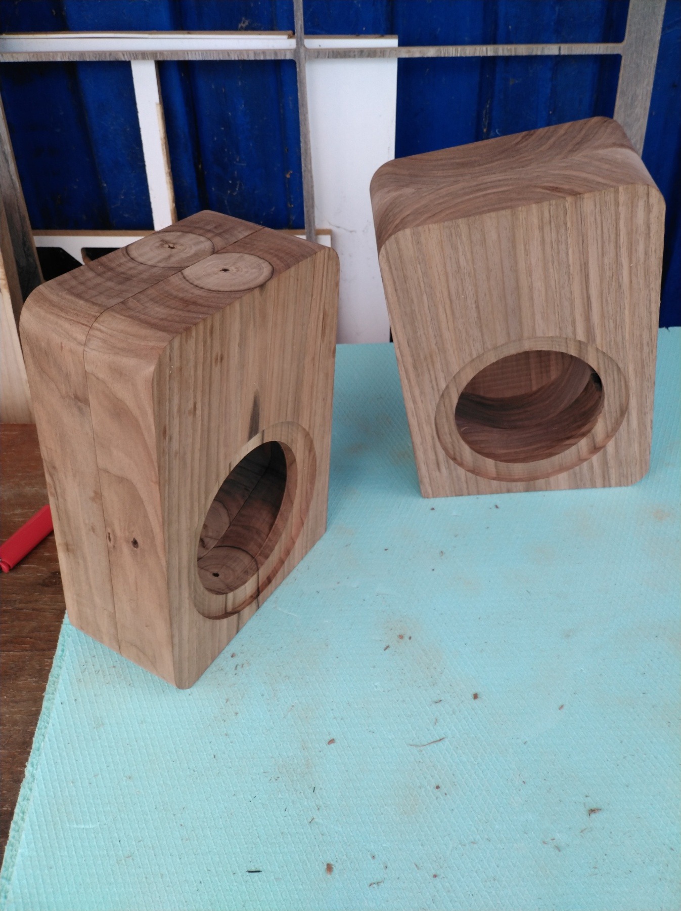

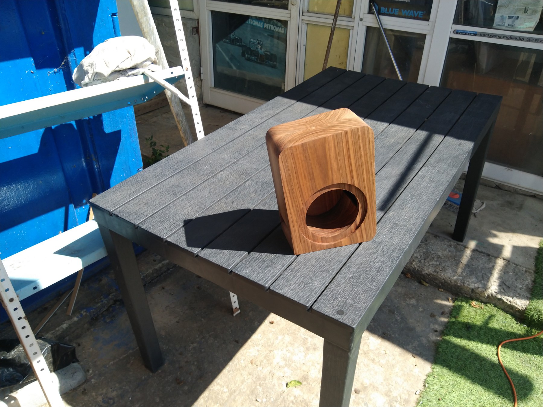

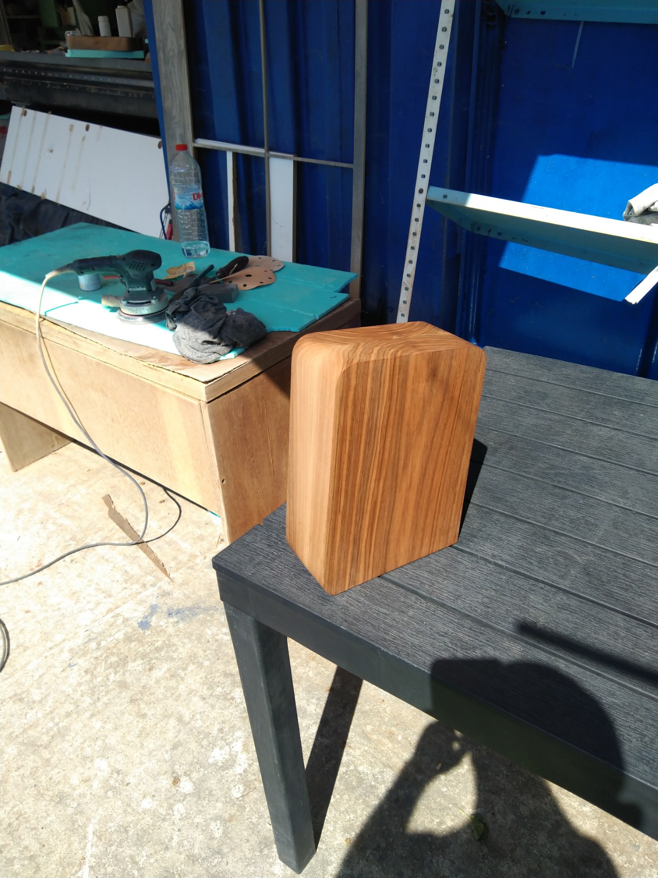

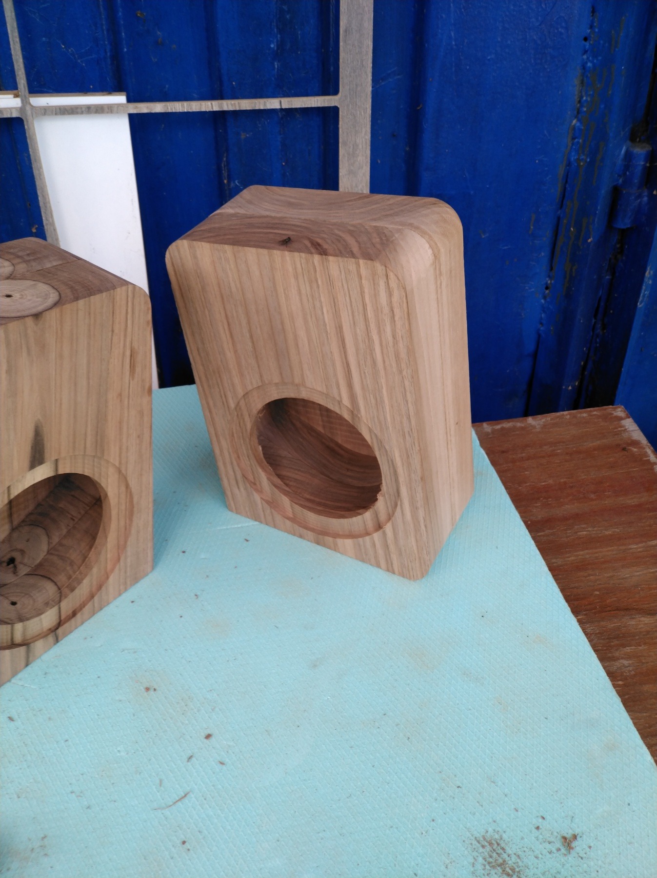

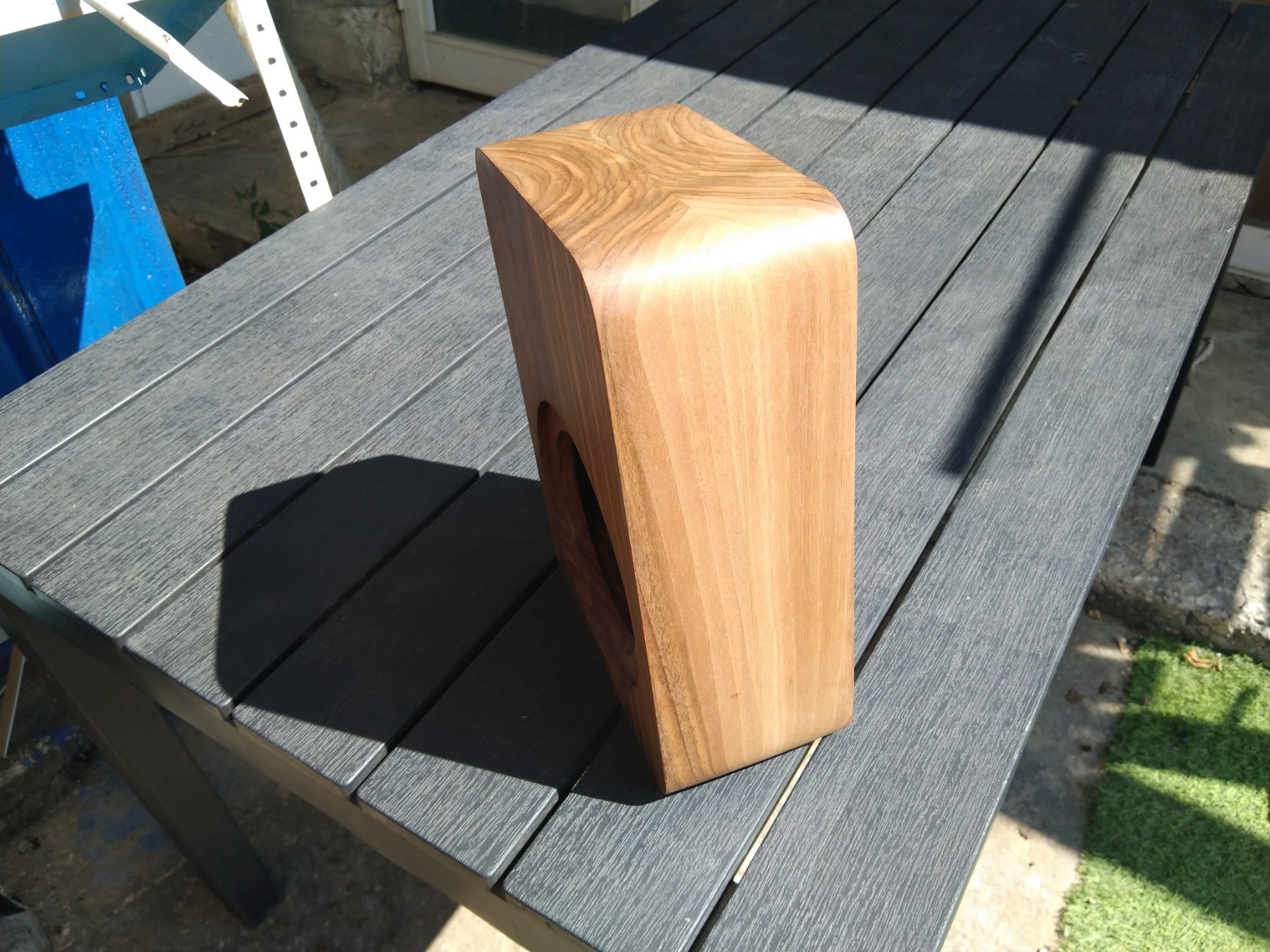

Started the project... Hope to get it done It is pretty detailed and very time consuming. Now I know why they are so expensive ....
If someone can help me will appreciate it!
At this point will give you this info :
Found all the speakers - really happy about it!
1. Tang Band 13-1761S - Tweeters
2. Sven has been using 2 mid range speakers: Foundtek FE 85 / FE88EX
3. Sven is using 2 types of woofer Tang Band W5-1138SMF (for SE and SE+) / Peerless SLS ... 14 cm(for just W5)

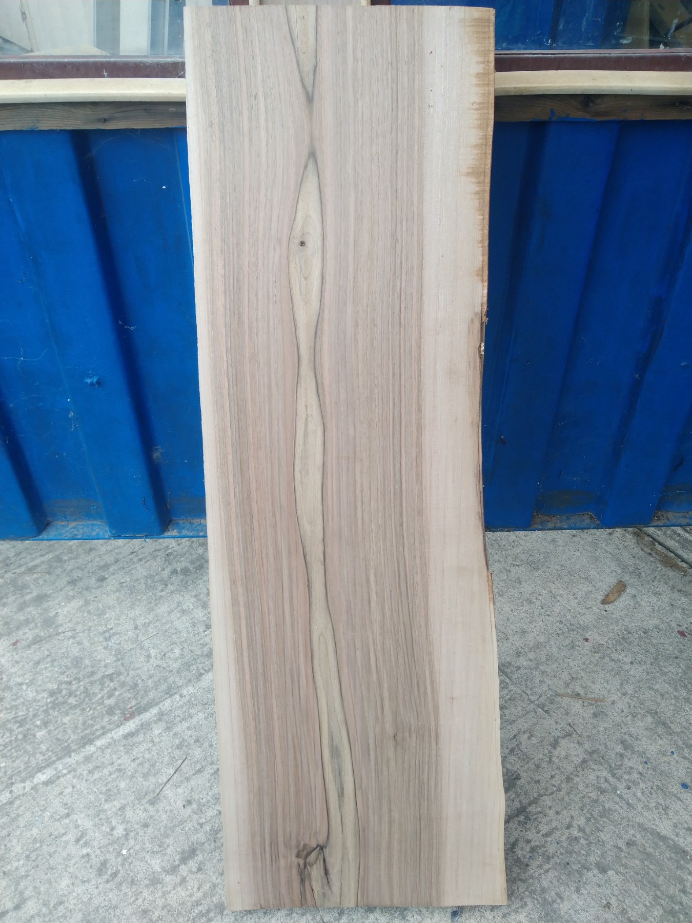

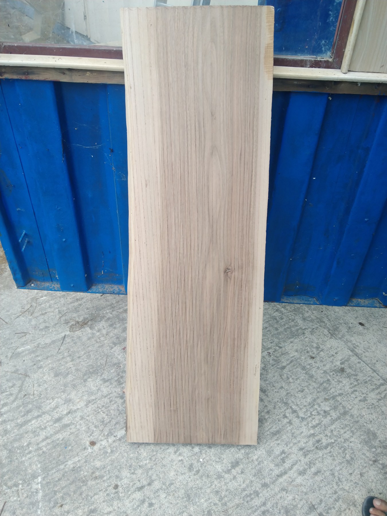

Working on back plate now ... almost done. Need exact dimensions of backplate in mm. Need exact spaces in mm from both edges of the cabinet. If some can give me will be happy.
Connectors: WBT 0703 CU
Wood - 30 years dried walnut at 8 cm thick pieces
CNC - 3-4 hours at side x 4 for both speakers
Natural sheep Wool
And not on last place : Very brave woodman to do the job.
Job is continuing ... Keep you in touch

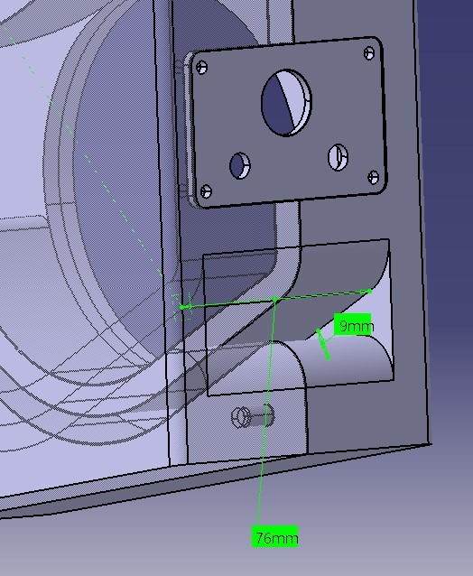

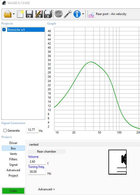

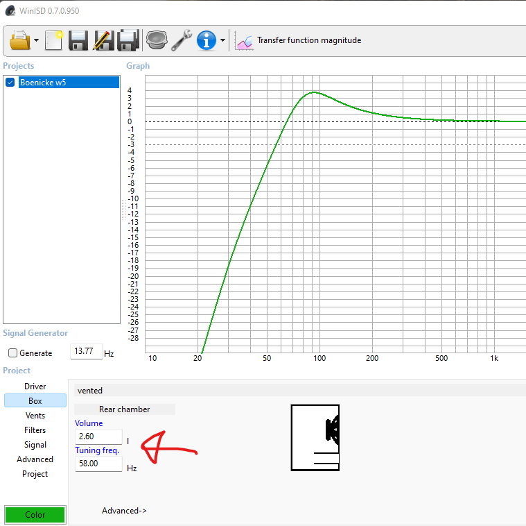

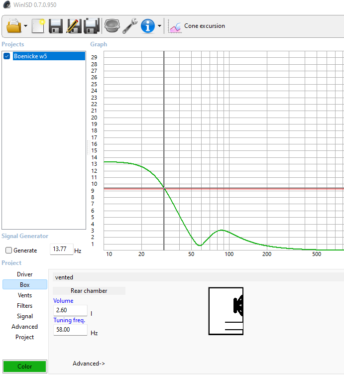

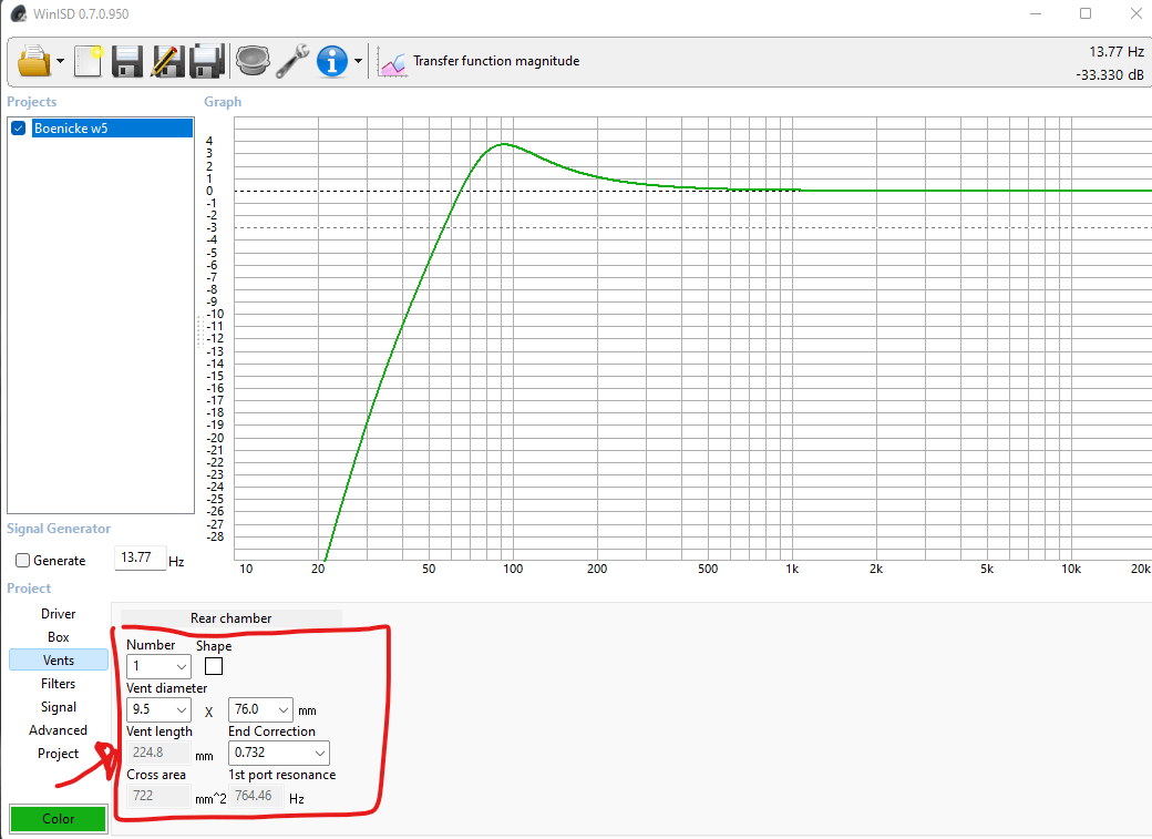

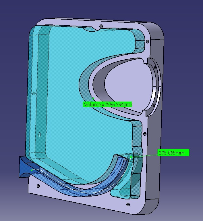

Hi all,
I would like to have your expert advice on the reflex port of the w5 clone. I have used the CAD model posted in this post and change some thicknesses just to make it more CNC friendly. Very minimal modification.
At the moment here is what I got:
· Internal volume 2.8L. If I remove the volume of the woofer it goes down to 2.5/2.6L. It depends also on the thickness of the walls. At the moment I keep at least 10mm. This volume is more or less confirmed by some articles I have read online about the w5. I am not so far off.
· Reflex port’s section is about 10mm x 76mm = 760mm2
· The length of the center line of the reflex port is about 210mm
Here is the problem.
I have simulated the driver W5-1138SMF in Winisd. At the moment I can make it work with a tuning Freq of 58Hz. The vent length is more or less correct. At the RMS power (40W) cone excursion works until 30 Hz and the air velocity is way too high.
It the port going to work ?

I got them from the CAD model I have created. If you see the 3rd picture in my post you see that for WinISD I have used a squared port of 9.5mm x 76mm. This is how I modelled it. With these dimensions the resulting length of the reflex port is 224,8mm with a fb of 58Hz (picture 2). If you see in picture 1, the lenght of my reflex port at the moment is 205mm . So now I have 3 options:@ Gabriellobello: where do you have the measurements for the Reflex port from?
When I want to make a simple tube-style (round) reflex port: how can I convert the given data to a round common tube bass reflex port?
1. Reduce the section (maybe to 9mm x 76 as in the picture attached) to reduce the resulting port's length.
2. Increase the length of the port in my model to 224mm even if I don't think that 20mm will make a lot of difference.....
3. Increase tuning freq to match section & length.
These are all possible options. I am not worry, I am in the zone. The real problem is not the reflex port, but the air velocity. It's way too high and to bring it down the section should be much much larger and not compatible with the size of the speaker. I don't know how boenicke solved the problem. Unless you introduce a subwoofer filter under 40Hz.... or relative low volume.... or stay away from music going down to 30-40hz freq, but then what's the point of the reflex?
BTW you can use a round port as long as the resulting section area is the same. Apart from the losses between squared/round you should get the same results in term of port's lenght. The port calculation is based on the area of the section, not on the shape
