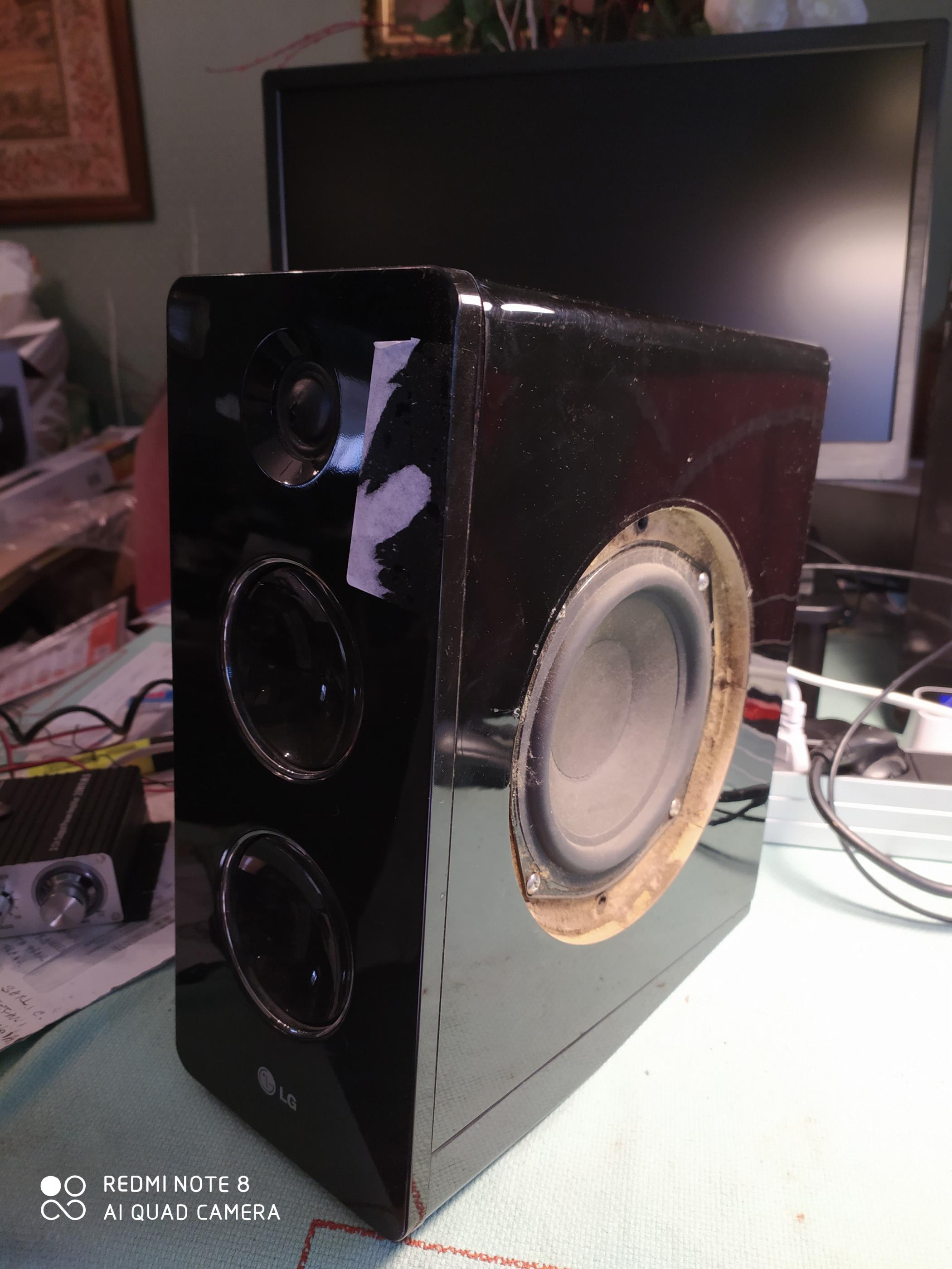

Good morning
sorry if I intrude with the risk of going off topic but please feel free to move this post where you think it is most appropriate.
I have always been puzzled about the solution of side woofers and then I found the speaker that I enclose in the photo. Basically an inexpensive LG unit that I use as a desk speaker. In my situation, a narrow front is very practical and I must say that listening to them better with all their limitations (low quality drivers from what i have see) they sound quite pleasant and full like few other mini desk speakers I have heard.
I dare not think about how they would sound with much more serious drivers, cabinets and driven by a serious amplifier.
Now the question ...
what cross point to adopt between the woofer and the front drivers ?
This in my only question.
The problem of crossing with the woofer is obviously crucial for the selection of the drivers to put on the front.
Moreover It seems that in the Boenicke speaker the woofer is not filtered ? 😕 i am quite lost at this point 😱
Thanks everyone for the wonderful thread.
Best regards, gino 🙂

The cross point depends on the drivers chosen. It’s impossible to define a fixed cross point that will always work. Things like diameter, Fs, Sensitivity and box volume for example will determine the crossing point.
In th boenicke there is not filter for the sub because the working range of the TB speaker makes a perfect match to the Fountek full range. It’s a natural crossover that it’s not very easy to find.
The cross point depends on the drivers chosen. It’s impossible to define a fixed cross point that will always work. Things like diameter, Fs, Sensitivity and box volume for example will determine the crossing point. In th boenicke there is not filter for the sub because the working range of the TB speaker makes a perfect match to the Fountek full range. It’s a natural crossover that it’s not very easy to find.
Hi ! thanks a lot for the very kind and helpful reply. I see a 10uF in series with the FE85 driver ... i do not know how this means in terms of high pass cutting freq ... 1kHz maybe ?
i like this concept a lot because the speaker has a small front width. I have much more space in depth than in width on my desk. 😱
