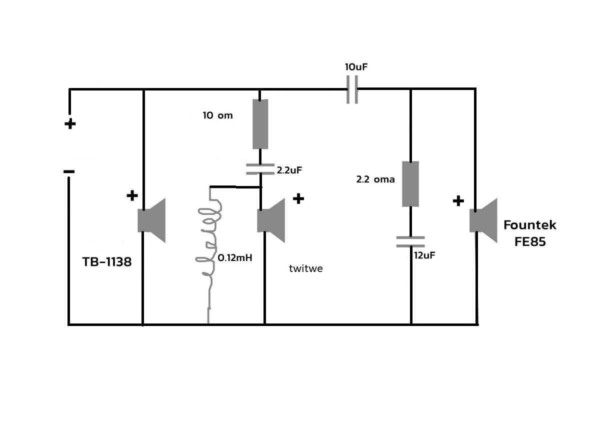

from above Auris Poison 3,"Design-The unorthodox appearance comes from the narrow front baffle with a single fullrange driver (sourced from Fountek) placed close to the top of the speaker, bass woofer (from Peerless) placed on the side but also in the upper half of the baffle, and a tiny tweeter (from Tang Band) placed on the rear. The woofer works up to 300Hz where Fountek takes over up to 17kHz and the tweeter on the rear works from 7kHz to 22kHz. The crossover, as you can see on one of the photos, features high quality components sourced from Mundorf...."
Auris 3 diy clone the crossover looks like (from Speaker Terminals)
Highs 3.3 ohm Res, 2.2 uf Cap, .12 mH Coil, 1.5 uf Cap to tweeter TangBand 13-1761s 3rd order butterworth.
Mid 3.3 ohm Res, .12 mH Coil to Fountek FE85 1st order butterworth.
Bass 2.5mH Coil, 2.2 ufd Cap to Tang band W5-1138smf 2nd order

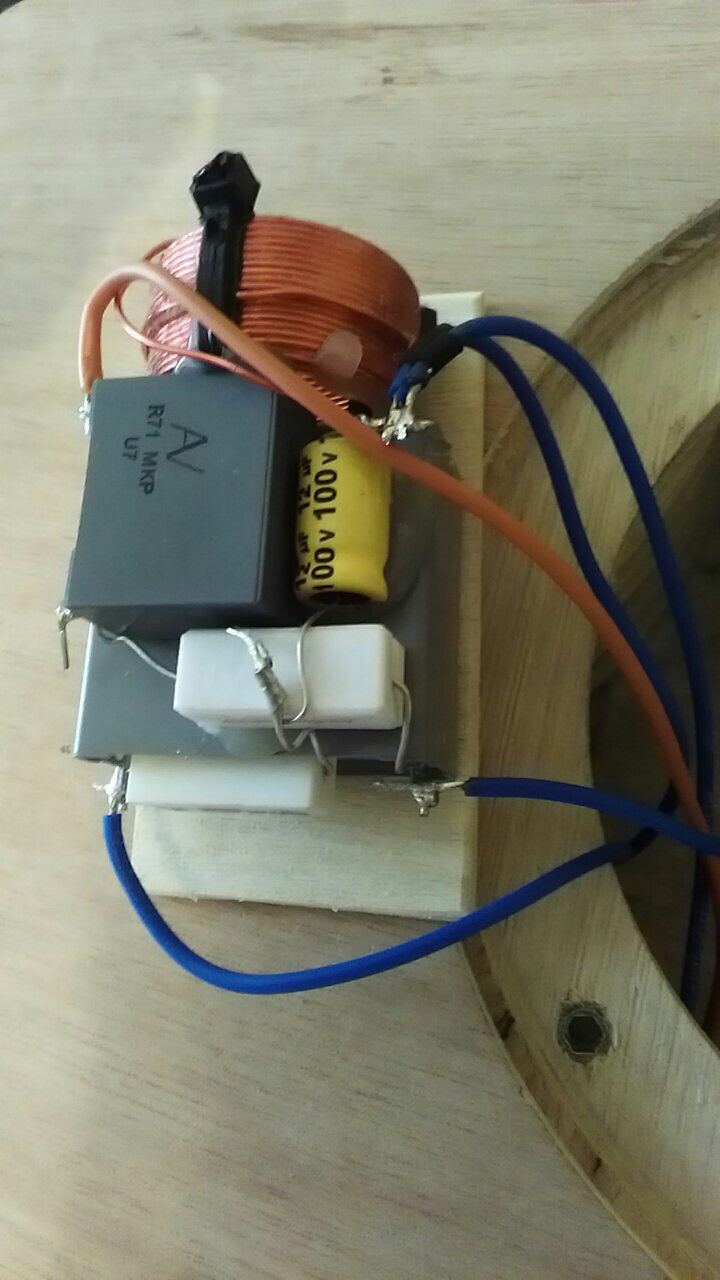

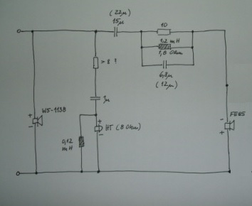

Regarding Entonis original design, something surprises me in his XO.
On the schematic it shows 2 caps 10uF and 12uF for the FE85 but on the XO’s picture you can see that they are 2 MKP caps of very different sizes, and most likely more than just 2uF a part.
Could it be that there is a mistake on the cap value on the schematic?
I don’t know if Entonis is still around to comment.

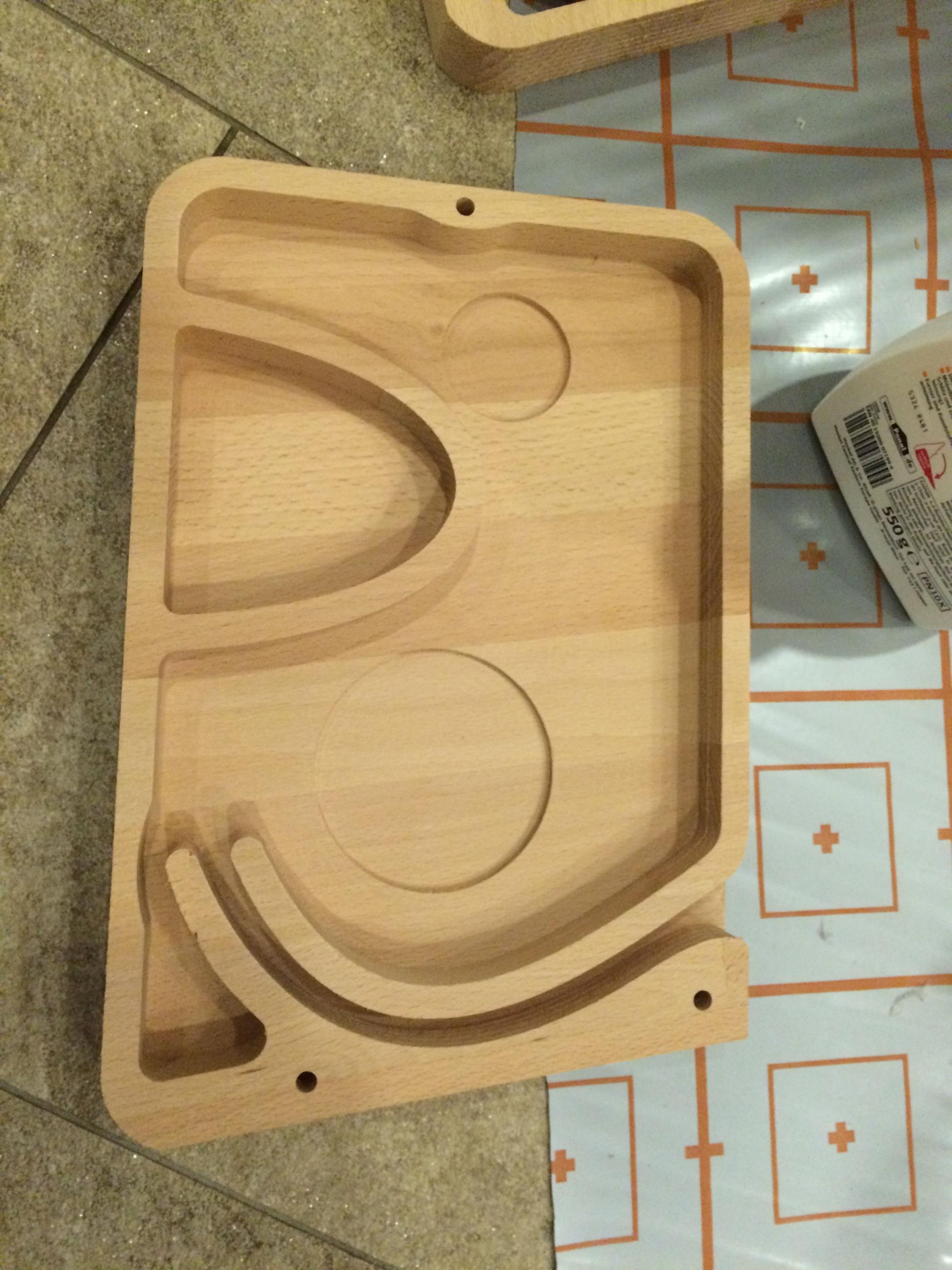

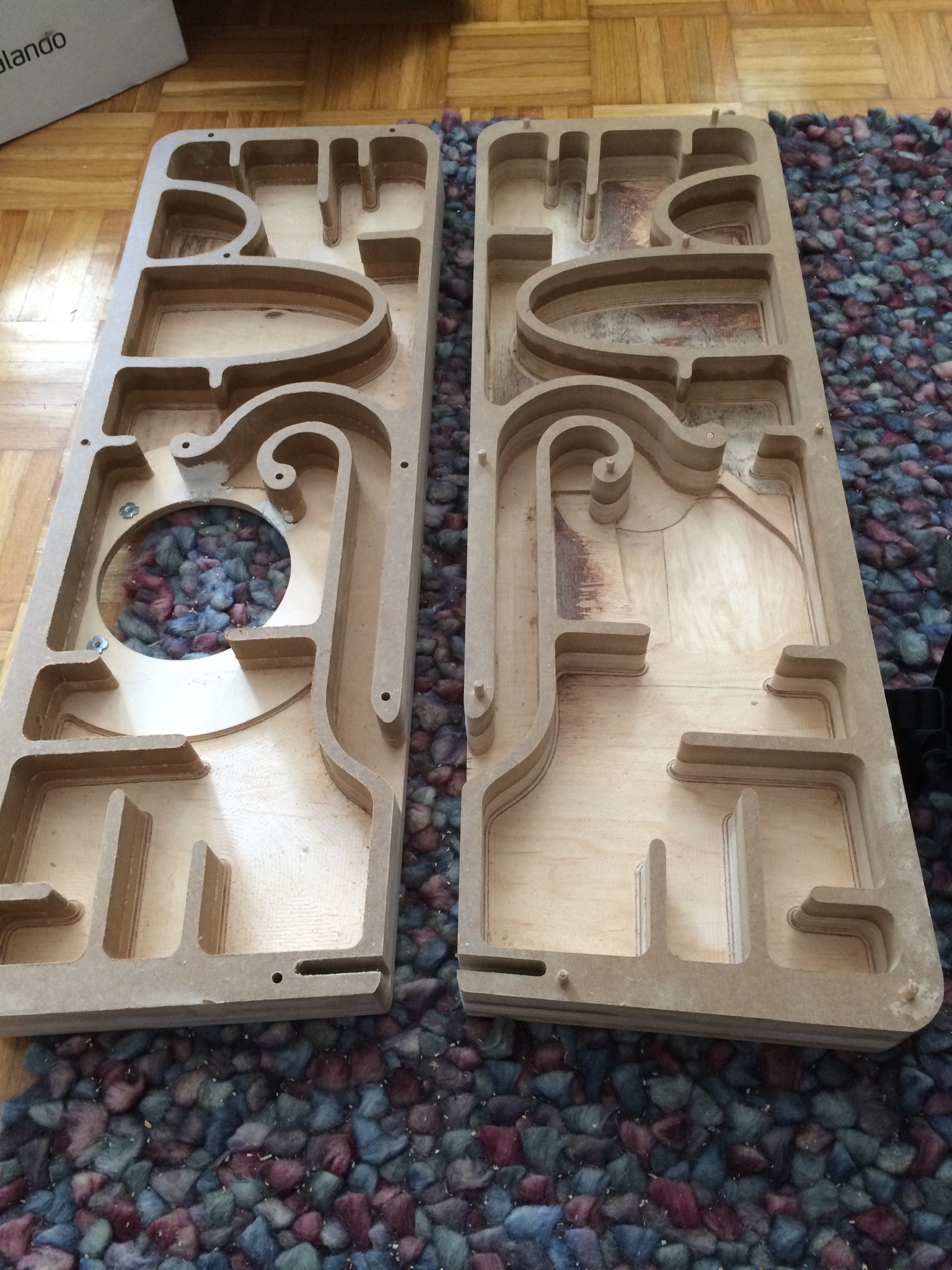

Maybe i missed it but are some cabinet CNC files available?
Thanks,
No. But its very easy to reverse engineer it. There are enough pictures available on the internet.
The bigger variant, the W8 are also rather easy to DIY and are even better. Here a test cut :
Beside the capacitor values, the crossover of Entonis also has one coil only. Here is another version of the crossover which corresponds much better to your picture:
Unfortunately I don't know the source of the schematic. I think the values in round brackets are the original ones. Later, they have been adjusted by ear. :)
No, this design was not very good. Tried it a while ago... In the same Thread was a better one.
