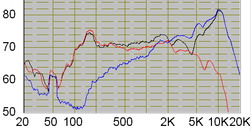

8R|8R 10cm woofers, Visaton SL713 tweeter. On axis at 33cm distance:
627560d1501072289-boenicke-w5-clone-ga15-png
The SL713 has some ringing here and there, most of which is not visible here due to averaging, but it reveals 128kbaud MP3. What a progression, distorting shellack, dirt-attracting vinyl, force-fitting CD, embezzling MP3!
