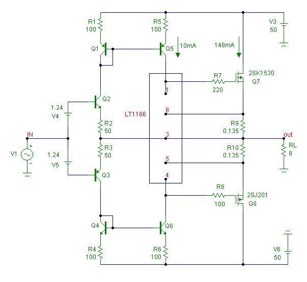

I did a quick sim on an older project (see attachment) and I cannot confirm your results. The Id(M1)*Id(M2) product has the same shape as you got, but the peak is very low, about 400uA.

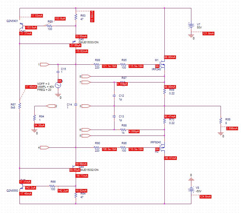

Hmm.... there a few things I don't understand:
1. C14=1F across pin 1 and 4. Doesn't this quite large cap spoils the control function?
2. The idle drain current is ~90mA, that means that the product is 8100E-6. So how on earth can it peak at 400E-6?
Perhaps (and if time allows) you may check/simulate Id figures of the complete amp (or at least the OPS) you have once built with this chip, because I'm not sure if the circuit you just simmed is appropriate to examine the discrepancy that I've observed.

1. Maybe in AC, but shouldn't the loop act at DC only? That's why I was asking about any possible frequency effects.
2.
90mA*90mA=90,000uA*90,000uA=8.1*10^9 uA^2
I got Id(M1)*Id(M2)=400 uA^2
Edit: I have just tried 100uF and it's still 400uA^2. However, at 1uF it's 75mA^2! So that's definitely a frequency issue.
DC only? I don't thinks so, as the data sheet describes this chip as "A high speed regulator loop [that] controls the amount of drive applied to each power device." To me, that means it's intended to be active throughout the whole audio spectrum.
Furthermore, their 100W amp, fig. 19, has no cap between pin 1 and 4.
Last but not least, such cap will spoil the whole concept as it will be charged to a higher voltage under dynamic condition, resulting in an increase of the bias level.
Okay, the math is correct, but I consider that 400 uA^2 as a dip instead of a peak as the base line is much higher (8.1*10^9 uA^2).
So, in order to compare our results, I'm afraid you will need another test circuit.
BTW, may we have a look at the schematic of your amp?

I don't know. Originally I used it myself without the cap (see below), eventually I added a 1u cap and it worked slightly better (less HF distortions).
http://www.diyaudio.com/forums/showthread.php?postid=1107005#post1107005
I hope you still have that schematic on your PC. With that one (without cap) it's quite easy to verify my results.

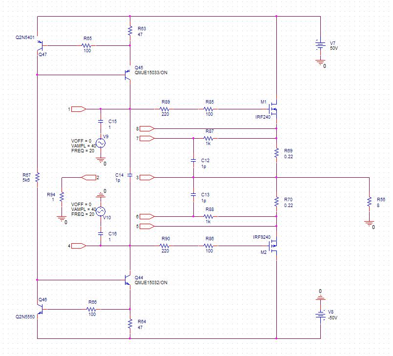

I agree with you, with a 1uF cap one gets less HF distortion, because it reduces the bias voltage modulation. But, as already mentioned, there are some unwanted side effects.
In the mean time I've figured out why this chip has a pos. TC. The reference current source (around Q42) is the culprit. Whether this was done intentionally, we will probably never find out.
PS: Our posts were crossing!

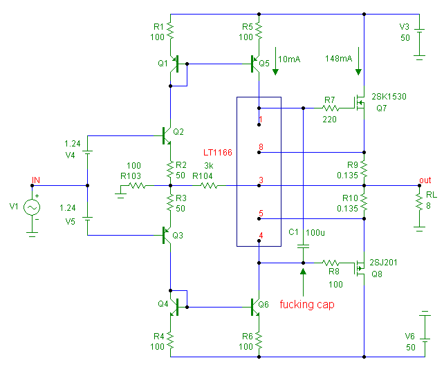

This setup is unsuitable for a Id(M1)*Id(M2) test, because pin 1 and 4 are still (AC wise) shorted by C15 and C16. In a couple of hours I will drop a version without that short.
edit: Here it is already:
This is a closed loop configuration with a gain of one. I'm not sure if this configuration is valid, LT recommends other ways to close the loop (and avoid using the transconductance stage at pin 2).
http://www.linear.com/pc/downloadDocument.do?navId=H0,C3,P1163,D5943
I'll take another look myself. But I'm also not sure why using the LT1166 in "DC mode" is a problem. I did it and found no practical issues.
Okay, here is an example with a gain of 31. Regarding the behavior of the bias loop, I observed no differences.
As I said before, "such cap will spoil the whole concept as it will be charged to a higher voltage under dynamic condition, resulting in an increase of the bias level."
With 100uF and at 10kHz, the bias will rise from an initial 148mA to 180mA after a couple of cycles. Okay, in practice not a serious issue, but this chip was designed NOT to do such things. Instead, it should hold the bias at a constant level.
When examining the loop behavior (the product of Id's, for example), this cap should be removed, otherwise one will get completely erroneous results.

You may close the loop in any other way. Does it really matter? No!
Observe the voltage of that cap with a value of 0 resp. 100uF under dynamic conditions, that is, large excursions of the OPS. With 0uF the voltage will increase -on purpose- when the OPS delivers large currents to the load. With a large cap, this thing will hold that charge (and voltage). As a result..... guess what.
