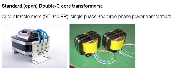

thanks macura
ok, yes, I have seen double C-Core transformer before .. in some pictures from amplifiers
i do not remember which amplifiers
i will look into it and see.
If prices are right,
i may even try them for some amplifier
Double C Core, Secondaries:
S1= 280V-250V-0-250V-280V -- 125mA
S2= 0-5V-6,3V -- 2A
S3= 6,3-0-6,3 -- 3A
Toroidal transformers
Hello Edmond
Sorry for pulling you into this discussion on power transformers I just assumed you had experience with this type.
With C cores in the 1KVA range is it any issue to build a low noise (mechanical noise) transformer.
Regards
Arthur

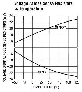

Back to an old topic: the auto-bias section of the LT1166.
Does anybody know why this circuit has been designed such that bias current of the OP devices depends on the temperature of this chip? According to the diagram (see below) it's about +0.2%/K.
Regrettably, the (description of the) simplified schematic doesn't give me any clue why and how this feature (or flaw?) has been added.
Next, as I have convergence problems with the spice model, could somebody else tell me if this model confirms the temperature dependency?
Edmond.
Edmond.
Most likely, it's a complexity vs. performance trade, I though fail to see why this TC is a huge deal. This chip is not supposed to be thermally coupled with the output devices.

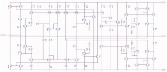

To solve your convergence issues, you may want to convert the attached LT1166 schematic that I reverse engineered some time ago to a SUBCKT. You may use two generic NPN and PNP models, but you need to have the device area as a parameter. I had absolutely no convergence issues with this model, however I don't think it will accurately model the TC you mentioned.

Re: Re: LT1166
IOW, the TC is a flaw.
Of course this chip is not supposed to be thermally coupled with the OP devices, rather 'coupled' with the ambient temperature. As the latter may vary under worst conditions by say plus and minus 25 degrees C, that means a deviation of the idle current of plus and minus 5%. Admittedly not a huge deal, although performance wise, not really impressive as well.
Thanks, but the component values are hardly readable. If you can enlarge the font by simply change some setting, that would be very much appreciated.
Okay, but did you also simulate this model at different temperatures? If so, what effect had it on the OP bias current?

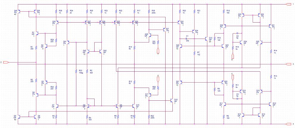

Re: Re: Re: LT1166
http://www.synaesthesia.ca/files/LT1166.PNG
I did not simulate at different temperatures, but I have good reasons to believe it will not model correctly the datasheet TC.
Syn08,
I have two queries, one OnT, one OffT:
OnT:
After Edmonds question I looked for a model for the 1166, but didn't find one. Your reverse engineered model looks quite detailed, how did you arrive at it?
