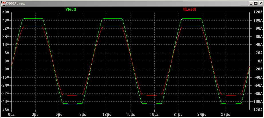

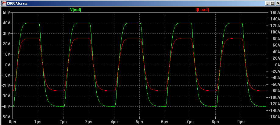

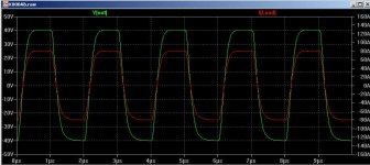

And here it is clipping with a 100kHz sinewave into 0.5 ohms.
I've got most of the bits and peices. When my shed concreting in finished in a few weeks time I'll be able to start the mechanical assembly :spin:

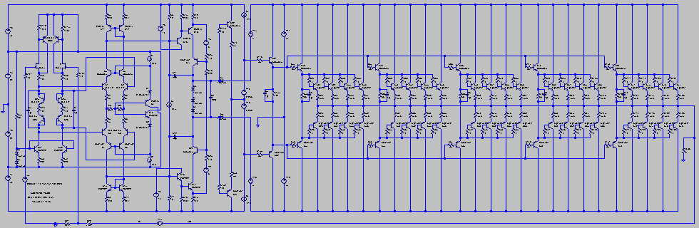

G.Kleinschmidt said:
Attached below is a simplified schematic of the finalized front-end design I have developed for a series of my power amps. The first amp to use it will be the K200AB (specs listed on my website).
The design uses a BJT dual LTP input of the current-on-demand H brigde topology buffered and biased by a JFET input buffer.
Each leg of the each LTP runs a quiescent current of 3mA and the VAS runs and quiescent current of 10mA.
Current mirror loads for the LTP's double up the slewrate. Prefectly stable VAS biasing is provided using my VAS biasing scheme in which a bipolar current source biases each VAS transistor via a 1k load resistor presented to each current mirror.
For this sim the closed loop gain was set to 40 (32dB).
The openloop gain was compensated for a unity loop gain crossover frequency of exactly 2MHz.
THD-1kHz at 40V peak output:
0.000011%
THD-20kHz at 40V peak output:
0.000064%
Here is what the final schematic looks like.
For a 2MHz unity loop gain frequency the miller caps are 16pF. Double for 1MHz. Slew rate is 600V/us and 300V/us respectively.
Hi Glen
There is too many transistors in that circuit.😀
Where is the cascode differential VAS? Or would that be too many transistors even for you? 😀
I’m just kidding.:clown:
I see you using THAT arrays. They're nice, but you certainly "pay" for them....:dodgy: A couple of points I've noticed with these is although they are matched very closely with Ft and noise measuring quite good, I measure Hfe at around 90. This generally isn't a problem but you could buffer the base currents in the mirrors to ensure more equal reflection. You can get away with using little or no degeneration with these. 100R or 47R is overkill. "That" is a reason they cost so much.🙂 Perhaps they’re already degenerated? Not certain but it might explain the lower Hfe figure. Anyway, you only have to connect pin 4 or 11 since they both connect to the substrate.
:2c:

CBS240 said:
Hi Glen
Hmmm.... The double current mirror circuit I've used with the quad arrays compensates for the base currents. You're quite correct about the emitter degeneration though. I'll drop them down to 20 ohms.
The great thing about these arrays is the fact that they don't have PN junctions between the collectors and the substrate and have minescule device-device capacitances - unlike the MAT and SSM dual matched pairs. They're also cheaper and you get 4 parts instead of 2.
Glen
