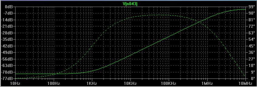

May I ask why with a JFET input why you need a 2uF input coupling cap.
Can I ask what the PSRR is for the negative and positive powersupplies respectively at 20KHz , without using regulators.
Regards.
Arthur
PSR plot attached below (soild line). The coupling cap is there to block DC from the source. It incurrs a high pass pole of 0.6Hz.
I did make a boo boo in the schematic though. The mute relay needs to be wired after the 2.2uF coupling cap to prevent audible clicks when it operates due to any DC from the source.
I will ammend the drawing when I get time.

Do you think a simulated 40 and something dB PSRR @20KHz is good enough?
Could you check if both PSRR- and PSRR+ are identical?

Hi Glen
Is the PSRR the same for both positive and negative supplies. This graph is it for pos or neg supply.

Re: Re: Re: Amps
Yes, I think that is good enough. Read what D.Self says about this and supply rail decoupling to the VAS. With regulated rails it's a complete non issue.
Glen
Re: Re: Re: Re: Re: Amps
syn08 said:
Figure out, I've read what D. Self says about. Have you checked both PSRR+ and PSRR-? Obviously, regulating the rails would help.
Yes, both rails measure the same as I've said already. I know that you didn't actually design most of it, but are you actually aware of your PGP's front end PSR?
