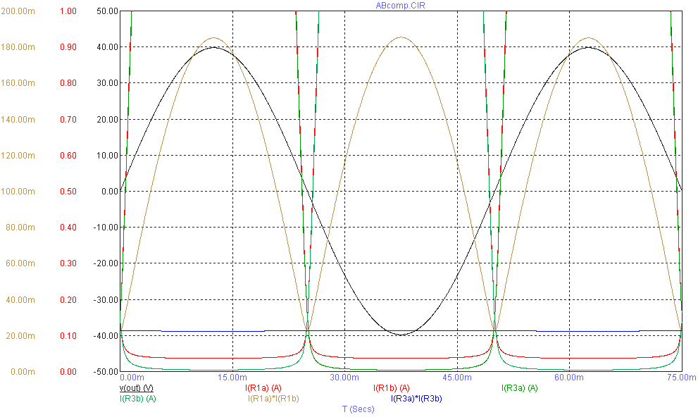

Re: LT1166
Originally posted elsewhere by syn08
I'm not sure I understand your question about the LT1166, could you clarify what is the behaviour you noticed?
My question was: "Did you observe this too:
.... My sim reveals that, opposed to the data sheet, the product of drain currents is NOT constant. Instead, the OP devices are always kept 'on' by (softly) clamping the minimum drain current at about 1/4 of the nominal idle current."
To make my point more clear I have simulated two test circuits, one with your model and one with a so called "NFI function source", i.e. a controlled current source that keeps the product of Id-N and Id-P at a constant level, that is, 150mA*50mA=0.0225 mA^2. Furthermore the tests circuits comprise a single 2SJ201/2SK1503 pair. RL= 8 Ohm, Vout = 40Vpk and Iq = 150mA.
As one can see, during near turn-off, the drain current is held at a more or less constant level, about 35mA (red curves). Consequently, the Id product is far from constant (brown curve), ranging from 0.0225 to 0.185.
The curves from the second circuit shows what you would get if the LT1166 would behave as described in the data sheet. Now Id drops to a minimum level of about 5mA (green curves) and the Id product is (of course) really constant (blue curve).
Please, notice that I'm NOT suggesting that the model (or even the chip itself) is wrong, I'm only surprised about the discrepancy between your model and the verbal part of explanation in the data sheet. The schematics however, are in agreement with your model circuit. So I concluded that your model is okay (at least regarding DC and AF).

Re: Re: LT1166
Honestly, I did not go into this level of detail with the little LT1166, therefore, I am still having trouble following your description.
Can you clearly identify which curves are for the LT1166 and which are for the ideal model you created?
