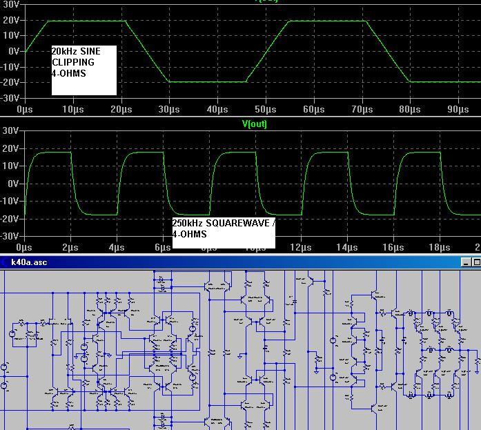

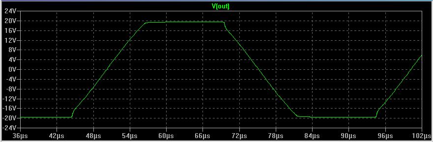

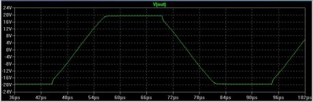

I posted that sim of Bobs amp just to demonstrate how and why the sticking effect exist to some degree with this type of compensation, even when you have a unity loop gain frequency of 2MHz and light miller loop compensation with a JFET input stage. As far as his amp is concerned, I am not going to claim that it is an issue.
However, as I already stated, I have a ~half the unity loop gain frequency and a BJT input stage with higher gm - that requires heavier miller loop compensation at the LTP and the sticking is much worse (pic attached).
This form of compensation in this application is clealy less than ideal, as far as clipping recovery is concerned.
To put this in perspective, my el-cheapo hybrid, "Blameless" style amp with prehistoric 2N3055/MJ2955 for the output devices clips at 20kHz witout any visible sticking issues:
http://www.diyaudio.com/forums/showthread.php?postid=1488531#post1488531
So any clever suggestions on how to alternatively compensate the miller loop to eliminate the sticking or what?
Glen

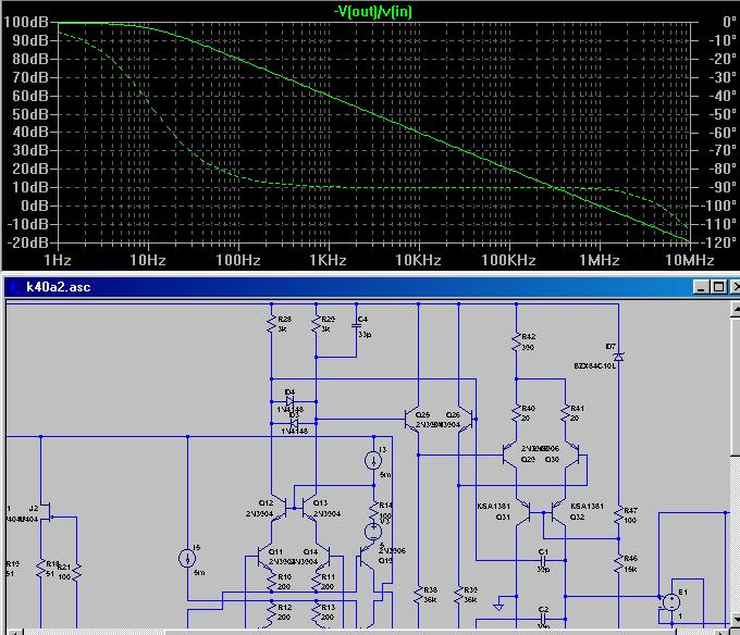

Ok, here is an alternative compensation method for the fully differential VAS.
It is a slight deviation from traditional miller compensation applied around the VAS and a depature from Bobs compensation scheme in that the miller loop is no longer returned to the inverting input.
As a consequence the slew rate is not as high, but in this case it is still >100V/us, which is pretty good considering the fact that the unity loop gain frequency is 1MHz, not 2MHz.
A pair of 39 pF miller compensation capacitors are connected between the differential VAS output and one load resistor of each LTP and a pair of 33pF caps shunt compensate the other side of each LTP.
This results in an impeccable loop gain and phase response, as can be seen in the attached pic.......

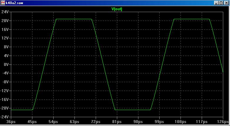

And here is the resultant clipping performance, again at 20kHz.
Since there is no longer a large compensation capacitance effectively shunting the differential output of each LTP, sticking is eliminated.
Glen
:smash: :smash: :smash:
OK, here is the challenge:
Who can work out how I can I get the pristine clipping performance as shown in the post above when setting the unity loop gain frequency with a "miller" cap connected between the VAS collector and the inverting LTP input?
Glen

G.Kleinschmidt said:
I’ve just been optimising the frequency compensation of a preliminary design of mine in which I used the frequency compensation method that Bob Cordell used in his MOSFET power amp. Namely the unity loop gain frequency is set as desired with a “Miller” feedback capacitor from the VAS collector to the inverting input, while this loop, which can be referred to as the Miller loop, is compensated with an R-C loading the LTP.
With my amplifier adequately compensated with a unity loop gain of 950kHz the slew rate was near 150V/us and operation was other wise fine, with the exception of the clipping performance.
A diode clamp is used on the VAS collector, but coming out of clipping there was significant rail sticking that could not be attributed to either the output stage or the VAS.
The cause of the sticking was tracked down to the LTP R-C. The problem here is that when the amplifier has clipped, the LTP has become overdriven and the compensation capacitor at its output attains a charge that must be gotten rid of when the amplifier comes out of clipping. This takes an amount of time, during which the amplifier’s output “sticks”.
I’ve attached a screen shot of a simplified simulation (I have omitted the cascodes and used an ideal output stage) of Bob’s amplifier to show the sticking effect, clipping at 20kHz.
The VAS is diode clamped at +/-30V. The blue trace is the current through the LTP R-C. The alternate changing and discharging of the compensation capacitance during the sticking period as the amplifier enters and leaves clipping can be clearly seen.
For the LTP R-C, Bobs amplifier used 100 ohms in series with 150pF. I am using a BJT’s for the LTP (instead of JFETs) which have higher gm. For adequate compensation of the miller loop a lower value R and a higher value C is therefore required. The sticking was therefore proportionally worse. While it can be reduced by significantly reducing the LTP’s gm with higher emitter degeneration and lightening the miller loop compensation accordingly, this is not desirable.
I’m now rethinking the compensation scheme for this amplifier. Any ideas on an alternative way to compensate the miller loop that does not cause rail sticking?
Glen
Hi Glen,
I think I agree with your analysis with regard to that implementation of what I refer to as input Miller compensation. The need to compensate the Miller loop does have a cost, and I believe it can have this modest sticking effect you show. It looks like in the case you presented, the sticking interval is about 1 us.
I don't like sticking at all, although this amount and kind of sticking seems more benign that a lot that I've seen, especially when any transistors are allowed to saturate. Of course, sticking will be influenced in different amplifiers depending on whether the VAS or the output stage clips first, and whether or not Baker clamps are used.
I have not looked closely in simulation recently at my MOSFET amplifier to see how much of this type of sticking behavior it exhibits. However, there is no question that your observation about the Miller loop compensating capacitor attaining a charge during clipping that must be dealt with during a sticking interval is true. Its just a matter of how long this interval will be.
This compensation scheme thus does have a cost, but it does also have big benefits in terms of naturally-achievable slew rate (300 V/us in my amp) and the fact that it effectively encloses the input stage in a feedback loop.
In later implementations of my compensation scheme, I've added a series R-C shunting the VAS output node to ground as part of the Miller loop compensation. In some designs this improves the stability of the Miller compensation loop. In some cases, the use of this R-C allows one to decrease the size of the LTP shunt capacitor, reducing the sticking. Another key point to keep in mind is how high the allowable gain crossover frequency for the Miller loop can be. Obviously, the higher we can make it, the smaller need be the capacitance shunting the LTP.
One other thing to bear in mind is whether a resistor is inserted in series with the main Miller compensation capacitor (providing a zero in the open-loop response above the gain crossover frequency). This can have an influence on the necessary compensation for the Miller loop.
BTW, I have also seen really excellent results with TMC. I have also applied TMC back to the LTP inverting input with success.
Bob

Thanks Bob.
Adding a zero to both the open loop response and the Miller loop allowed a significant reduction in the required Miller loop copmensation capacitance. I also found that doubling the VAS emitter degeneration was an effective and relatively cost-free way to afford and other ~2:1 reduction.
I've arrived at an all-over compromise that I'm pretty happy with. Unity loop gain frequency (900kHz) and Miller loop compensation is still conservative, the compensated loop phase response is ruler flat and the sticking has been reduced to a pretty neglible level.
Now I just have to redo the PCB layout to incorporate the extra three resistors.
Glen
