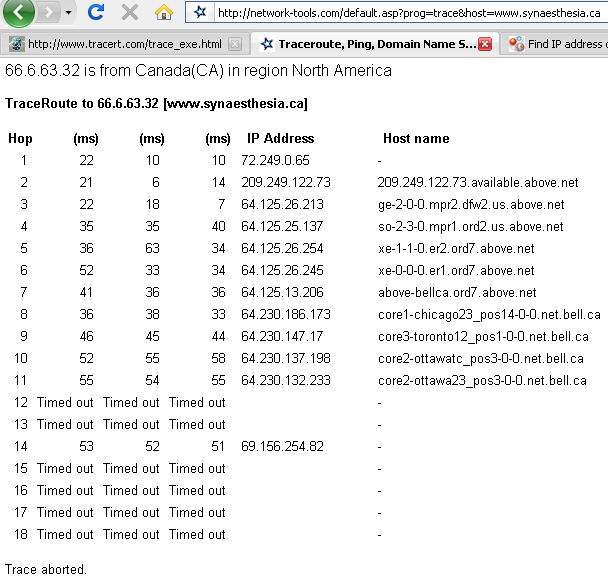

Shouldn’t you work on your website accessibility?
Maybe it’s the dark forces, the moon phase or even the negative influence by the Mars moons? Or maybe it is just Joshua and his friends.
Spooky
Stinius
Originally posted by Edmond Stuart ........
If routed via: 'Netherland, Amsterdam, Support Net'
I got 'Not Found'. Also when using your IP address (66.6.63.32)
But if routed via 'Greece, Athens, NTUA - National Technical University of Athens' (for example) I got no error msg.
So, ''Netherland, Amsterdam, Support Net' has issues. But why?
Support Net (Amsterdam) doesn't work apparently due to another bug. Using a different trace tool (network-tools.com), it seems that the connection gets stuck in Ottawa (see picture) and not in Amsterdam. This also explains why people from other countries have problems as well.

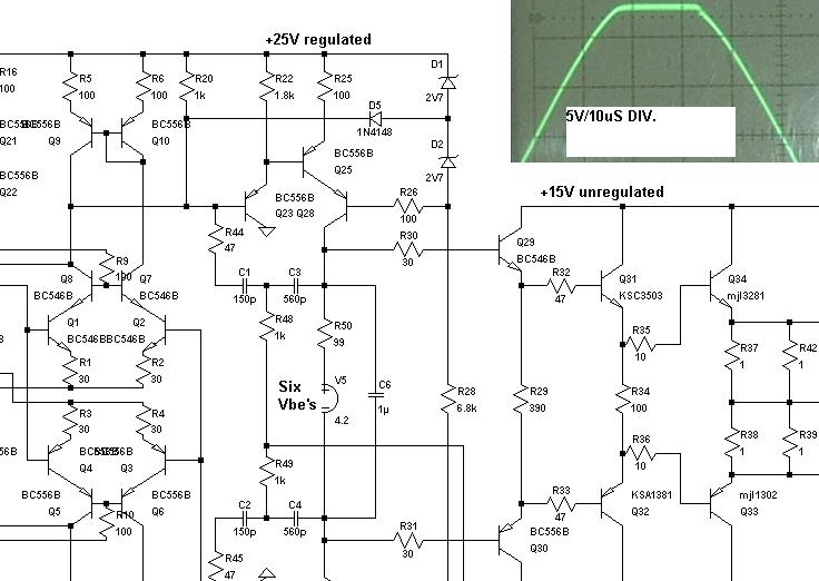

More on sticking and clipping performance.
Here is a scope shot of my K12A amplifier clipping at 10kHz.
I did not bother with a voltage clamp on the VAS collector in this basic design, and allow the pre driver transistors to saturate - though a simple diode clamp on the VAS buffer base acts as a VAS current limiter (2*Iq) and prevents saturation of the VAS cascode transistors.
Saturation of the BC546/BC556 pre-driver transistor pair results in approximately 1uS of sticking.
TMC (1.1MHz ULG) is used and the amp does ~0.002% THD-20 into 4 ohms. A previous prototype version with supply rails scaled for 12W into 8 ohms did ~0.001% THD-20.
I believe this is the first scope shot of a TMC amplifier to grace the pages of DIY audio 😀 😀

Re: More on sticking and clipping performance.
These are nice results, Glen. TMC is quite effective.
What slew rate do you achieve?
What input stage tail current are you running?
What output stage bias current are you running?
Bob

Re: Re: More on sticking and clipping performance.
Hi Bob
1) ~35V/us
More than enough for such a low voltage amplifier - 250kHz squarewave response attached. The output network is a 2-pole L//R-C low pass filter. The ripple in the response is due to the 1uH (in parallel with 1R) output inductor resonating with the 100nF output capacitor.
2) 5mA
3) 1.5A
The amp clips at 12V (18W), so I run the bias high enough to keep it in class A into 4 ohms 'till clipping.
Glen

I've had a chance to adapt two of Edmond's above configurations to my application and look at them in detail. But first, for anybody else wondering how this all came up, I'll summarize the background briefly below.
I'd been experimenting in simulation with a high-power amp having +/- 90V rails for the output devices, and boosted, regulated rails for the rest, including drivers. I had originally been trying HEC. But over in the YAP thread, Edmond mentioned that CFB output stages with Miller comp share one very desirable trait with HEC - namely that the bandwidth of the overall output stage is not constrained by its unity loop gain frequency, but is approximately the same as that of the driver/output stage combo by itself without any feedback or HEC. In other words, for both types of circuit, the distortion gets reduced without a corresponding bandwidth reduction - a very desirable trait. After verifying this for the CFB case, I decided to try a CFB output stage. This was before Edmond posted the above circuits.
Originally, simulations consisted of THD-20k with an 80 V peak sine wave output into 8 Ohms, and a transient sim using a 160V p-p square wave that's low-pass filtered to 204 kHz to test slewing. The latter signal gives a maximum dv/dt of slightly greater than 200V/us. At first, I found that when the VAS switched into class AB mode under high-slew rate conditions, it would break into oscillation. I tracked this down to an unstable Miller loop. At first, I tried unsuccessfully to simulate the Miller loop gain. This is easy for single-ended circuits like the Blameless topology, but for a complementary circuit, having two Miller loops really messes things up. If you put the loop gain probe inside one of the two Miller loops, the simulated Miller loop gain is complete garbage. The solution to this problem involves artificially joining the two halves of the Miller loop (if possible without otherwise disturbing the circuit), and inserting the loop gain probe at the join. This technique is described in this post and shown in the schematic attached to it. Note the large inductor and capacitor in the global feedback loop to block the AC component of the global feedback. The only part of that circuit that isn't shown is the 10+10 output devices. Once I got the Miller loop compensation going, redoing the square wave simulations showed very robust performance under high-slew conditions, with the system remaining stable when the VAS switched into class AB mode. The conclusion I reached was that Miller loop stability is extremely important and should not be overlooked.
With that in mind, I looked at Edmond's t3g and t3f configurations, adapted to my power supply voltages and bias currents, with special emphasis on Miller loop stability. With regard to the effect of TMC, previous simulations I've done with a Blameless configuration and TMC show that TMC does not affect the gain or phase margin of the Miller loop when the TMC resistor is properly chosen. However, it does affect the Miller loop gain and phase at low frequencies. This is as expected. Because of this, I looked at Miller loop gain without TMC first, as it can be retrofitted later without affecting the phase and gain margins of the Miller loop.
This is getting long, so I'm going to split it into multiple posts.
The first configuration I looked at was an adaptation of t3g. This has a current gain of 7x in the Miller loop, and takes the Miller feedback from the emitter of an EF following the VAS. When I looked at the Miller loop gain, I was dismayed by what I saw. At around 10 MHz, its magnitude dropped like a stone, along with the phase. By the time the ULG freq was reached, the phase lag was huge, well in excess of 180 degrees. I gave up on trying to stabilize the thing, because it would have required a compensation cap of thousands of pF together with some careful lead compensation. I'm not sure how Edmond got this stable. His circuit may be an order of magnitude faster than mine, or the phase lag at the ULG freq may have just coincidentally been far from 180 degrees. I don't know. I didn't pursue it further.
Next, I looked at an adaptation of t3f, in which CMCL is used and Miller compensation is taken from the VAS collector. The Miller loop gain of this configuration looked great. Only a small compensation cap of 100 pF was required, and putting a small resistor in series with it resulted in the phase shift of the Miller loop gain being a constant -90 degrees out to 10 MHz. Even at 100 MHz, its phase shift only reached -140 degrees. Nice.
When I tried a THD-20k sim of this, I got about 40 ppm at 400W into 8 Ohms (80V peak) without using TMC. This is the same as what I got with the configuration I was previously using, shown in this post. The difference of course is that the high Miller loop current gain of the CMCL configuration allows TMC to do its thing with the potential of further distortion reduction. When I tried TMC, I was able to get this down to a little above 20 ppm. I am including 19 harmonics in this sim, so it's overly conservative.
However, TMC causes a problem in my circuit that probably doesn't show up in lower power designs. Because of the 10+10 output devices, the output stage bandwidth varies radically from its maximum value of about 20 MHz at 0VDC out, to about 2 MHz at 80VDC out. This is of course due to the Cgd variation of the vertical FETs. When it's put into a TMC loop, the overall global phase margin degrades quite a bit as the output approaches the rail. I test this behavior by simulating a 1 kHz input signal that drives the output to 80V peak, and superimpose on that a 20 kHz square wave that gives an additional output swing of 1 Volt above that. With the input LPF disabled, the square wave shows very bad ringing at the 80V peak of the sine. This goes away when TMC is disabled.
In the overall amplifier, which is a modified Blameless configuration, I use TMC and see the same problem with degraded phase margin near the rails. I take care of this by putting some lead compensation in the global feedback loop. This gives the global feedback loop a phase margin of about 70 degrees at 80VDC out, and is overcompensated a bit at 0VDC out, giving about a 100 degree phase margin. This gets rid of the ringing on the same test signal described above, and also eliminates ringing that was seen on recovery from clipping. I suppose I could do a similar lead compensation in the output stage's global feedback loop, but I'm worried that this could lead to very complex behavior in the overall amp, both as the output approaches clipping, and in how it recovers form clipping.
So I decided to use TMC in the VAS of the front end, but not in the output stage itself. In other words, I don't use "TMC inside of TMC". Since there will be no TMC in the output stage, the additional complexity of CMCL has no benefit, and I decided to simply go back to the output stage configuration I was using before, described here. I suspect that a CMCL-based output stage combined with TMC in the output stage would make an excellent choice for an amp that isn't burdened with so many output devices as mine is.
I have some other observations, but I'm getting tired from typing all this at the moment 🙂.
