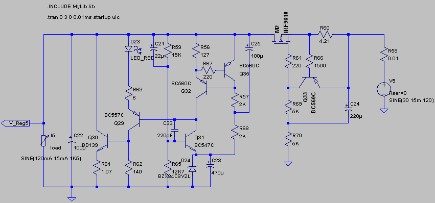

As I mentioned before, the main two components that predictably will make the circuit to oscillate are C1 and C2. Anything larger than 3nH will make it oscillate for me. Now, since I'm talking about the output cap and the upper resistor cap (in the divider for the base of Q3), it will be difficult to get low ESL values. That is my concern.
If anyone would like to try the exact circuit that oscillates for me, the attached zip file should contain all that is needed. LTSpice is freely downloadable from Linear Technology

Here's a thought; I am questioning C1, the cap on the upper resistor on the base of Q3, becomes a bypass of all high freq ripple that happens to be on Vout. This bypasses all that ripple directly into the base of Q3. So I propose to either use a resistor (maybe 1kOHm) in series with C1, or not use C1 at all.
I still think there is something wrong with your simulation? I built the exact version that you are simulating on a PCB - I posted a picture some pages earlier - and it does not oscillate in real life, run from my normal lab power supply.

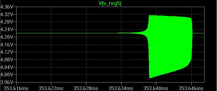

Martin, I took the liberty to make the following changes, which IMHO are not outrageous. Set the load to SINE(75m 15m 1k5), the voltage source to SINE(30 15m 120), the ESL of C21 to 8nH, and the trans command to .tran 0 1.25 0 0.01ms startup uic.
See attached image pls.
Perhaps in reality none of these appear in the real circuit. It still doesn't make me feel very good. The second thing that is worrying me a bit is the transient response (with that little bit of ringing) to abrupt changes in the load current.

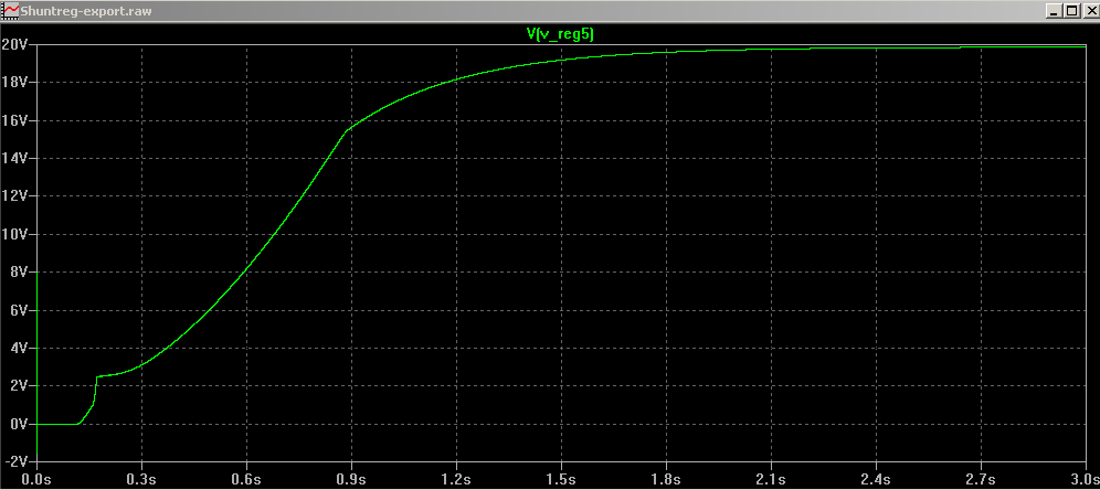

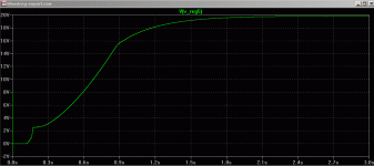

Here is the result I get, after ca. 2-3 secs the circuit has reached the set voltage of 20 Volts. I note also that in your chart, the oscillation occurs at 350 milliseconds, and the voltage is 4 Volts, but the circuit is set to 20 volts output. You still have me confused ... can you let the simulation run for, say 5 - 10 seconds then show oscillation at a steady state?
P.S. in the next couple of days I should have an alternative circuit (some Borbely shuntreg clone I hope) and will present it for test, then we should compare the two.

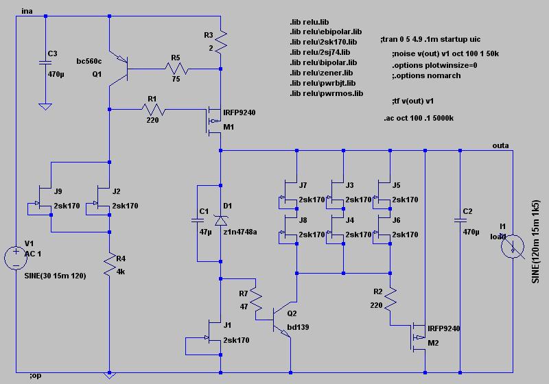

I agree. We could always compare against something very simple and with small parts count, like salas' shunt regulator, which happens to be an excellent performer in simulation as well as in real life. I am using it with my phono stage and it rocks. The attached image shows the circuit a bit tweaked by me to run higher current through the mosfet drivers. However, the circuit works very well even with just one jfet in that position and replacing the bd139 with bc550b.
I was looking at Salas' regulator with one eye but wasn't closely following it, and I must admit that I do not understand it yet, including some of the "design" decisions.
