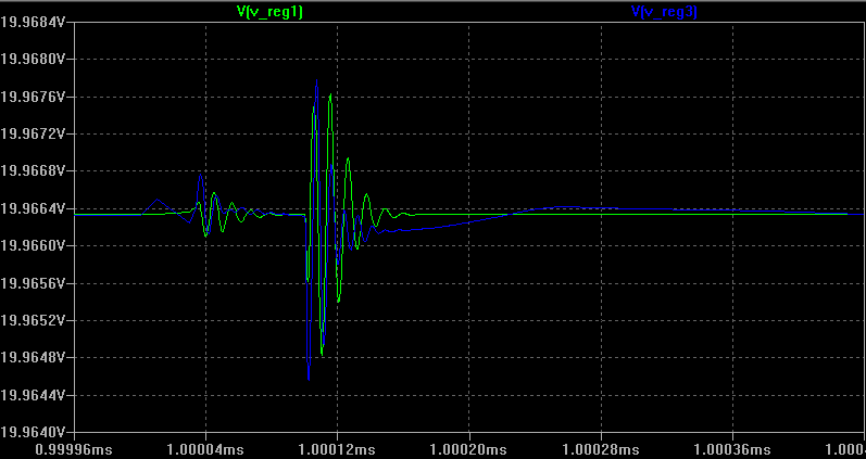

I played a little with transient response, stepping the supply voltage by 1 Volt, ristetime 0.1 µsec., with the original circuit and then with the new current source and as expected I can get both of them to start ringing. Off course, I do not believe that we would normally see such large transients in the raw supply, but nevertheless, it seems to show potential issues.
A small cap from collector to base of the error gain transistor.
This seems to work very well, so thanks for the tip. It does not completely eliminate the ringing but decreases it by several orders of magnitude. I initially tried the compensation cap on Q1 (original schematics) but moving it to the right transistor (Q3) works much better. I value between 100 - 220pF (3-6 nH) seems sufficient. Here is a picture of the remaining ringing, just a couple of mV and settles very quickly, and note that this is after a transient of 10V/µsec. ... green is the original CCS, blue is the new CCS, simulation with new IRF subcircuit which seems more realistic:

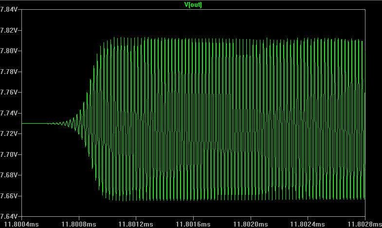

Martin, perhaps small differences in our simulations result in these effects. When I was talking about oscillation I was not talking about the simple ringing on the transient response, but full blown oscillation, such as seen in the attached image, generated by the original circuit with a 200p from C to B on Q3.
Yes, we need to find out why your simulations are oscillating and mine are not, very strange. I do use series inductance for all caps, maybe we have different values? A ballpark figure for a low ESL electrolytic cap should be some 6nH. I found this value in a datasheet for 100µF Rifa (axial) electrolytics that I have, similar in size to radial caps, this is what I used by default, for want of better data. Varying it a little does not change much, but it should be in that range. For the compensation caps I used 3nH and going too high with the inductance here will cause problems, too. Can you confirm what inductance values you are using?

For these simulations I have been using 15nH, 0.5ohm parasitic values, which may seem exagerated. Do you think it is practical to assume much smaller inductance?

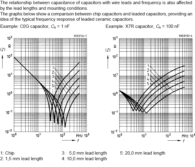

I believe 15nH is fine for the electrolytic caps, but for the compensation cap this could be exactly the issue. I would need to do a few more tests but I believe I saw oscillation at or above 10nH, so either use no compensation cap or a cap with low inductance and close to the place where it compensates. I do not have more exact inductance values right now (other than that my 20mm long rifa cap has 6nH), but attached is an excerpt from an Epcos datasheet for ceramic caps, the graph on the left shows how the resonance frequency of a 1nF C0G cap (exactly what we need) is influenced by lead length and hence inductance:
