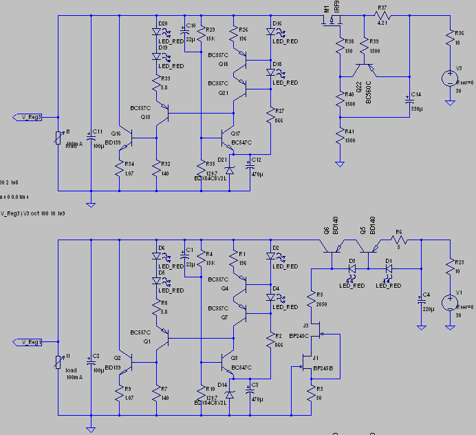

The base currents of the two lowish gain BJTs destroys the constant voltage across the first LED. Varying the LED current/voltage directly changes the voltage across the first resistor.
The current source is not optimal for higher currents, no doubt about that, and we should investigate alternatives, like the one ikoflexer proposed, or other VBE multiplier types. Having said that:

I just ran an impedance @ DC on the first CCS using ~60mA of current to the load. The effective Z of the CCS was only 700r!

Andrew has a valid concern. I don't know how much it shows up in measurements, but the issue is there.
OTOH, people probably don't want to throw away all the work done so far. So, the simplest chnage I can think of is use darlingtons for the two input transistors. With some luck, no changes to the PCB are necessary.
For example, BD675/676 series, Hfe min 750, same pin-out; but there are others.

I still think that you are barking up the wrong tree but let's not quibble. Here is an alternative version, VBE mulitplier with a FET, IRFP9610 in this case. This is VERY scalable in terms of current draw, and several amperes (at maybe reduced performance?) should be feasible. BTW, the same type used in the original ZEN amp and it is similar to what Erno Borbely is using in his new shuntreg, except for the different capacitor connection:
Martin, I also got some very nice simulation results with this circuit. Just as good Zout as the original circuit (in fact a little better). I think in this application the irf9610 does nicely compared to the irfp9240 because of its lower capacitance.

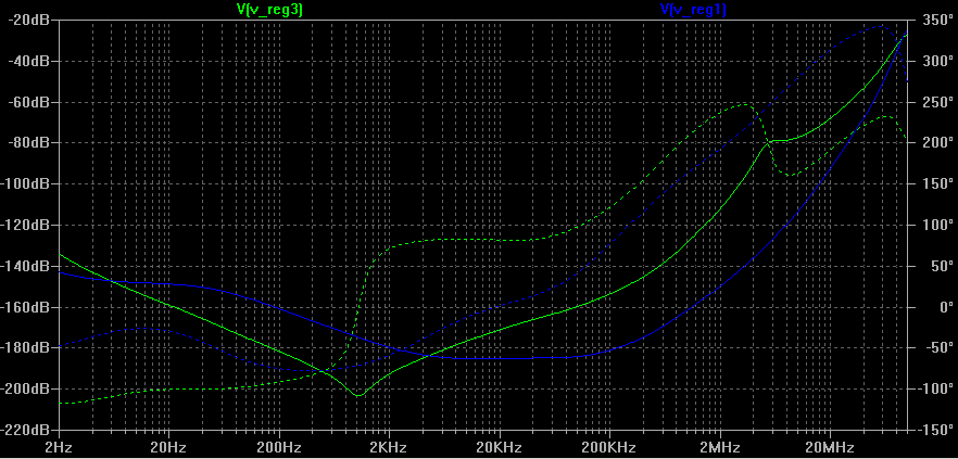

deletes 4semiconductors and adds two resistor. That meets cheap and simple and economic on PCB area.MRupp said:Here is what my simulator shows in terms of PSRR, both look pretty similar in performance. Blue is the original LED current source and green is the new one:
Heck, it even performs.
I don't like all those steeper slopes in the 9610 version. Does it need some compensation?

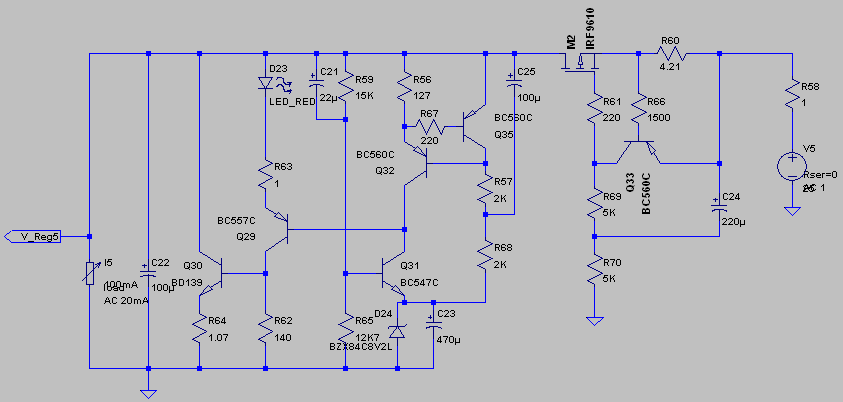

The first steep phase slope / trough is introduced by the RCR network. Putting the JFET current source back in to bias Q22 eliminates it. I am not sure if it will cause an issue, my first guess would be that it doesn't. And I tried compensation, same as in the Pass CCS, and it did not compensate anything, not as far as I could see. Off course we could leave in some space for a small cap, just in case.

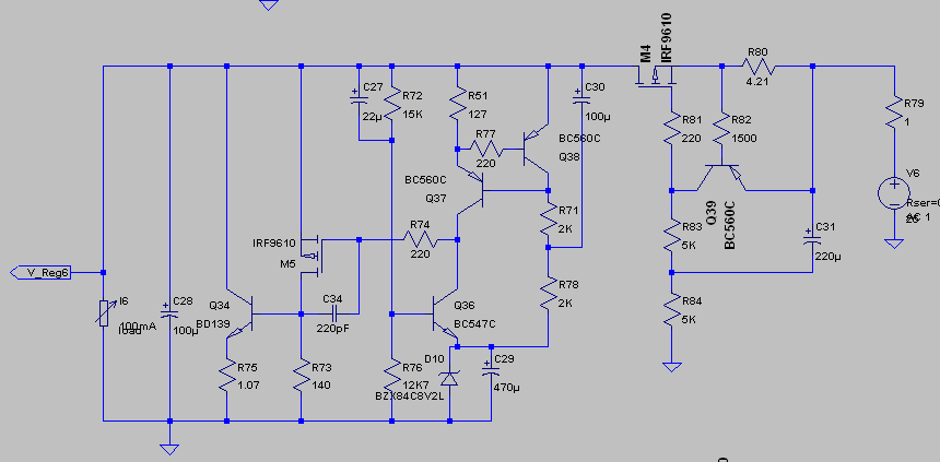

If that is your objective you might like this version, with the second CCS (2 LEDs) replaced by another bootstrapped VBE multiplier. A further benefit is that it needs less voltage accross it, which comes in handy if you need a 6 Volt or maybe even a 5 Volt version of the regulator - with a LED as voltage reference. And we can eliminate another LED that we needed for Q1 (Q29 in this schematic). PSRR is identical but load regulation is even slightly better - in simulation:

MRupp said:I still think that you are barking up the wrong tree but let's not quibble. Here is an alternative version, VBE mulitplier with a FET, IRFP9610 in this case. This is VERY scalable in terms of current draw, and several amperes (at maybe reduced performance?) should be feasible. BTW, the same type used in the original ZEN amp and it is similar to what Erno Borbely is using in his new shuntreg, except for the different capacitor connection:
I was testing this version in LTSpice and get oscillation. A 200p capacitor to ground off the base of Q15 ( the BC557 that connects to the BD139) controls this. I used the directive ".tran 0 60ms 0 .1u" to look at transients and this is where the oscillation shows up. Perhaps my problem was that I was stressing the regulator too much. I put 400ma through the CCS. The load was 286ma with a 1000Hz 50ma component. I have tried most of the different types of CCS's and get this oscillation with them all, so I suspect it's either my method or the shunt.

And for discussion, I have another modification, as an alternative to the previous version: Q1 (Q15 / Q29) is replaced by a MOSFET as level shifter, this gets rid of the remaining LED and resistor. TO92 types like ZVPxxyy, BS250, etc. would be good candidates even though the schematics shows IRF9610 (VGS should be 2-3 Volts at least) - and I have included a compensation 220pF cap as stated above:

This is stable in my simulation. It is also about 20dB better, but with reduced bandwidth. I tried it without the compensation cap and it was still stable. This should be looked into.
