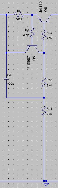

Martin, I would not bother with the alternative ccs. It is overly complicated for little benefit; sometimes I get some crazy idea that should stay on my computer, really.
If anything, my simulations show that even a simpler ccs than the currently used cascode would work very well (below 1mOhm Zout up to 1MHz, exc. line regulation), in case Andrew's concerns about the ccs are proving to be bothersome in the real circuit. The simple scheme (attached) has been much used in other shunts already, for instance in the salas shunt regulator.

LED CCS
The current through the first LED is only about 1.2 ma with the present jfet ccs. Andrew pointed out that this is too low. If the bottom jfet is changed to a 2SK170 the total current doubles and the current through the first LED goes up to 6.8 ma. Would this be enough to solve the problem of low current through the first LED? I used LTSpice to simulate this.

no.
The input CCS does not work at all well.
The base currents of the two lowish gain BJTs destroys the constant voltage across the first LED. Varying the LED current/voltage directly changes the voltage across the first resistor. That in turn makes the CCS not constant. It just does not work when highish currents are required. That is the inherent problem:- high current and two BJTs.
This explains why the original Cetoole had R5=1k (swamp the LED with current)
The other CCS defining the reference for the shunt works very well.
I have suggested two alternatives.
A high gain first transistor and a FET for the second. This was rejected.
A cascaded pair of 317s (W.Jung), but this too was rejected.
