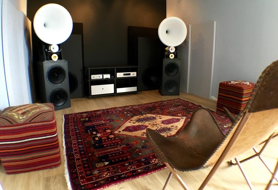

Today i use JBL 2384 horn with JBL 2451 beryllium and i think it is a easy and affordable way to get very good result from 800 Hz. In this setup with 2384 i have tried Fostex T500 back and forth. I am happy without but T500 gives a tiny bit more air. Without the focus/coherence are slightly better.
That looks like an excellent system!
I'd love to listen to it.

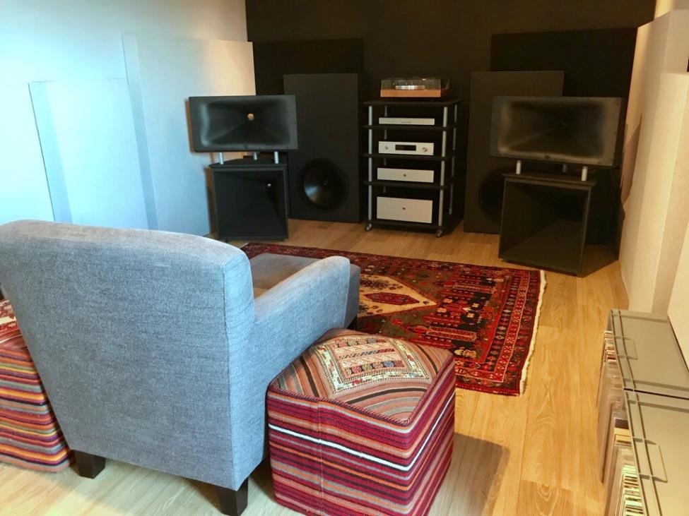

Looks fantastic! What drivers for the LF horn and subs?

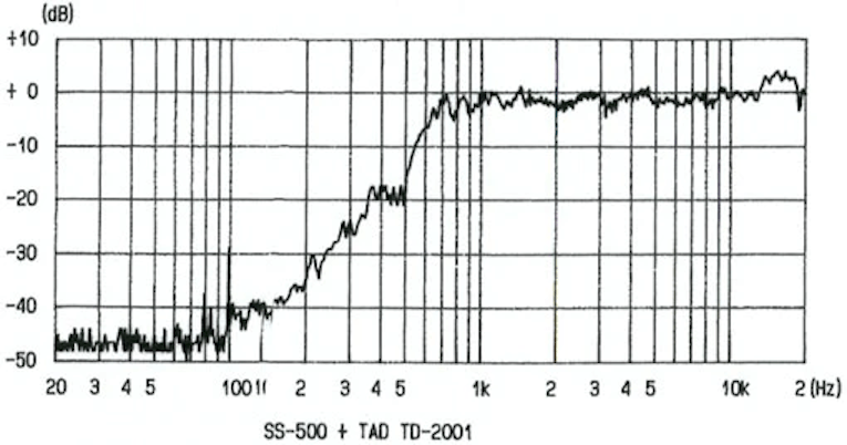

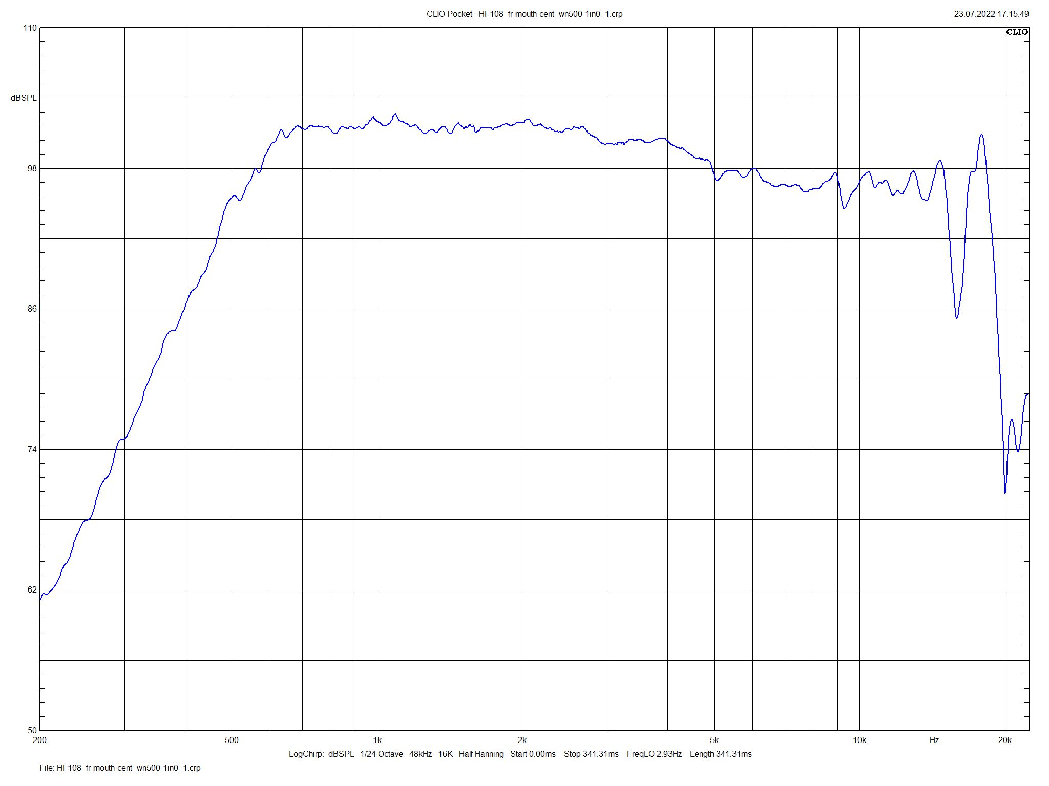

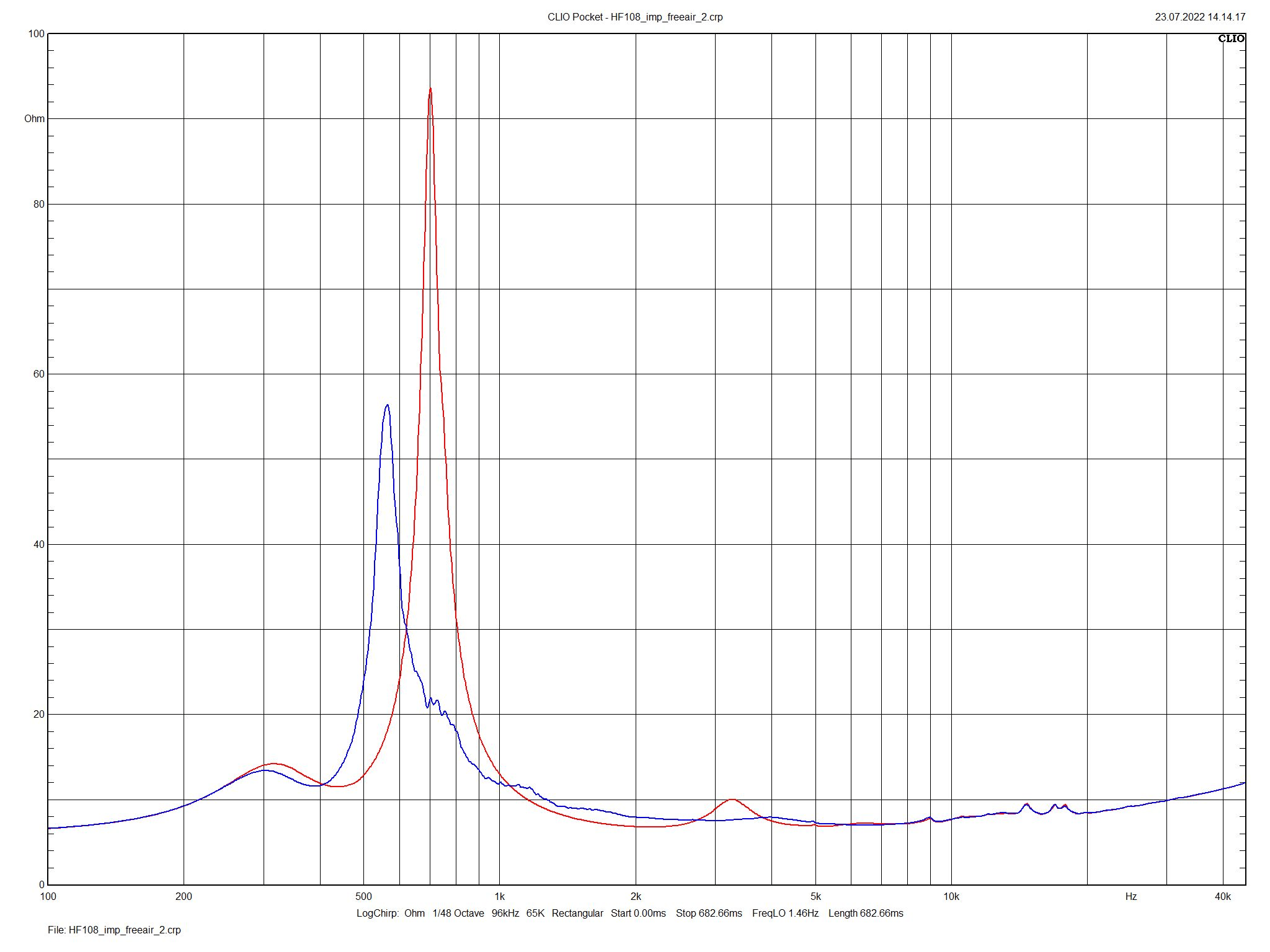

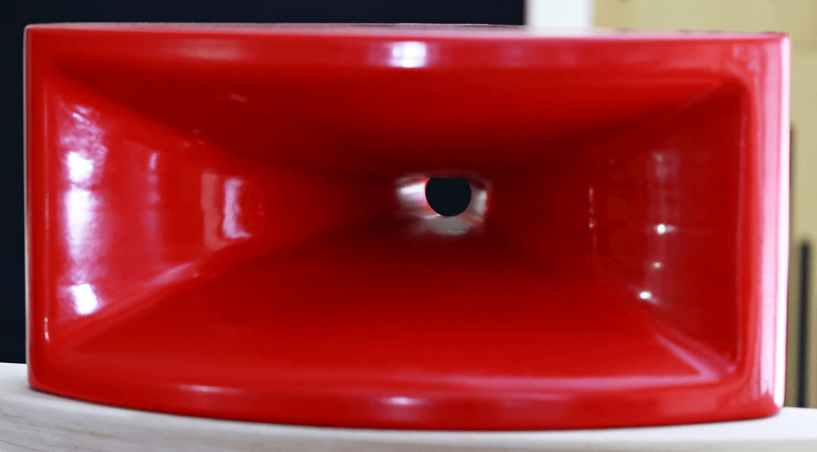

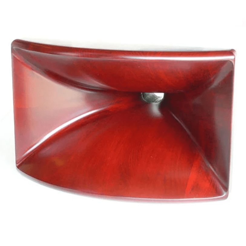

If anyone wishes to clone/approach Yamamoto Soundcraft's 1" horn (SS-300) which is used with the B&C DE500 in the YS-500 2 way (open back)...
View attachment 1177381 View attachment 1177382

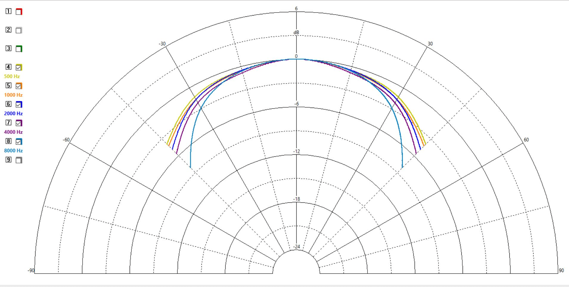

Docali's 1" Neile horn is definitely a cheaper alternative and just as good, with wider dispersion > 90x40 versus 70x30.
Prototype with Faital HF108 (the horn has since undergone improvements):
View attachment 1177387 View attachment 1177385 View attachment 1177388
Rectification: The SS-500 is Yamamoto's 1" horn and not the SS-300, as erroneously stated.

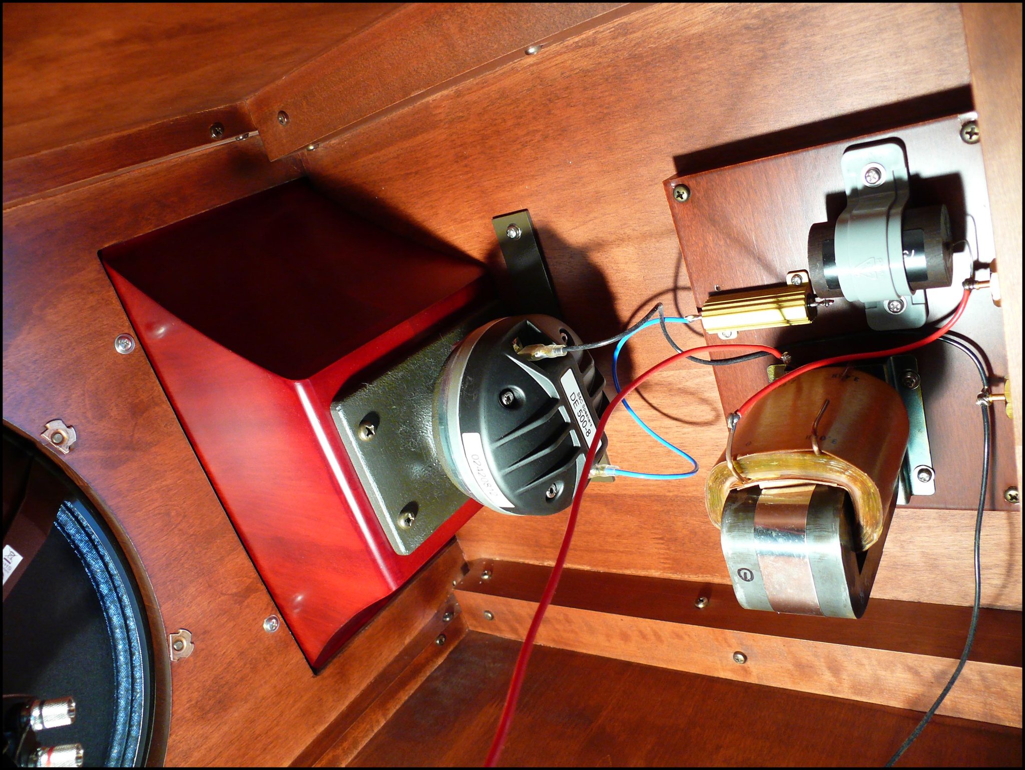

Thanks, and sorry for the off topic : are auto transformer even worse than resistor (in the way they color or impact the total magnitude) ?
Just in case it would be helpful. I recently switched to autoformers for my RCF 940/950 combo after discovering that the l-pad was "doing something wrong with the sound" (compared to lowering the driver FR with EQ). It's hard to explain, but with the l-pad there is some "decline in clarity" and a little less dynamic (of course, subtle differences, but I think I could tell the difference blindly). Mundorf 20W resistors were used, equalization is always about the same target curve, and very different crossover points were in the comparison (with and without l-pad) - always a muddier sound with the resistors.
I don't believe in my home distortion measurements, not a very good sound card and microphone, but I didn't find anything unusual on the measurements with autoformer. Subjectively the sound with them seems about the same as without attenuation, dynamic and clear (sounds like a direct connection of the driver to the amplifier). Plus they add a lot of variability for a passive crossover design, especially for the hybrid crossover (passive +EQ).
I have not found a convincing physical explanation, perhaps it is because the driver sees low impedance after the autoformer. All warnings that it will give some special distortions and problems did not come true (at least at home moderate volume levels).
The review should be taken with skepticism, I have neither golden ears nor a pedantic approach to designing my own speakers, I rather enjoy experimenting. But if there is an opportunity to test autoformers I would recommend trying.
