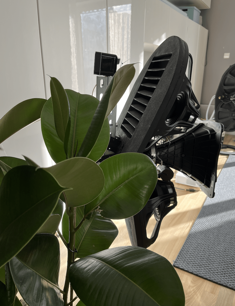

Just in case it would be helpful. I recently switched to autoformers for my RCF 940/950 combo after discovering that the l-pad was "doing something wrong with the sound" (compared to lowering the driver FR with EQ).

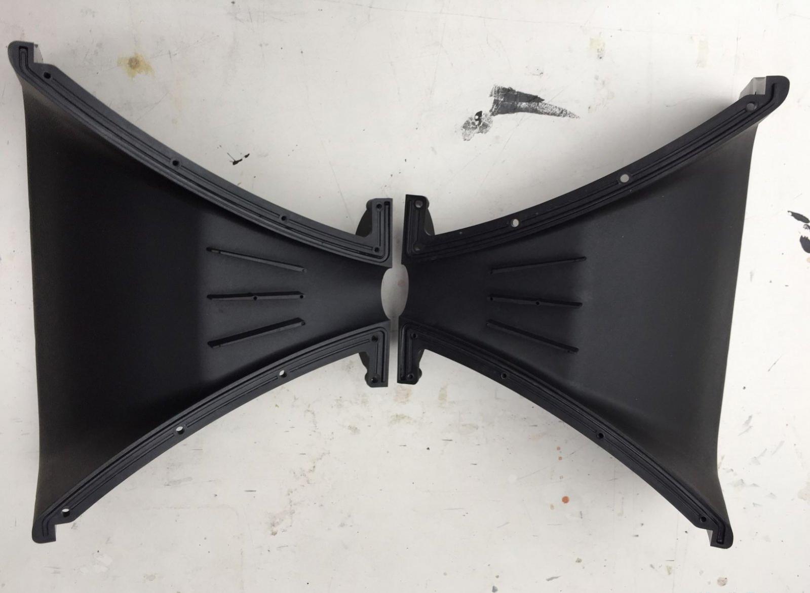

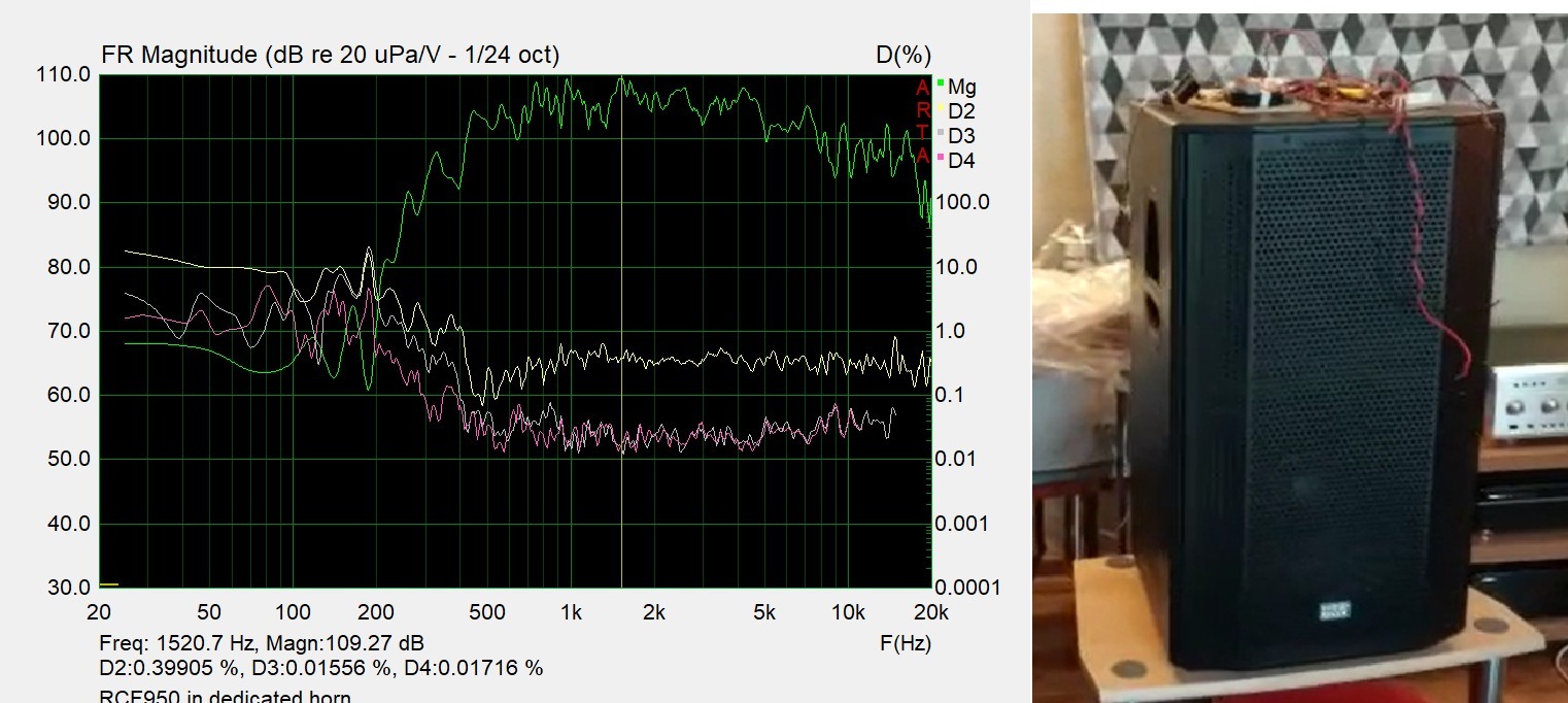

The RCF HF950 is certainly one of the most advanced diffraction horns, without a sharp edged slot. In addition there's no narrowing/pinching in the horizontal plane of the throat/slot section. Therewith it approaches the inner workings of a Yuichi horn, only in the opposite plane.
I've only experienced this horn in the RCF TT-5 and these are among, if not the best full range PA speakers I've ever heard.
Someone rightfully stated: "The TT25A Mk II, and TT5A, are two of the few 15" two-way speakers that don't have that typical indistinct mid-range".
The coverage angles are larger compared to the XT1464, which implies that the sound intensity [pressure × particle velocity] should be lower at the mouth.
The 'beam' - often associated with 'horn sound' - is less concentrated, especially in the top octave, which may be preferable.
Finally, I couldn't detect anomalies in imaging, as with the XR1496.

Thanks for that--I had not seen those. Those measurements do look pretty good, but the RCF850 isn't bad either. Really smooth, more extension on the bottom end, though not as smooth in the last top octave. Again, it probably comes down to system design. My preference would go to more extension on the bottom end, down to 500 Hz to get the crossover in a more optimum spot for a 15".JosephCrowe measurements on the TAD 2001 show the best 1in driver performance ever. Saying there is no demonstrable advantage seems like self medicating.

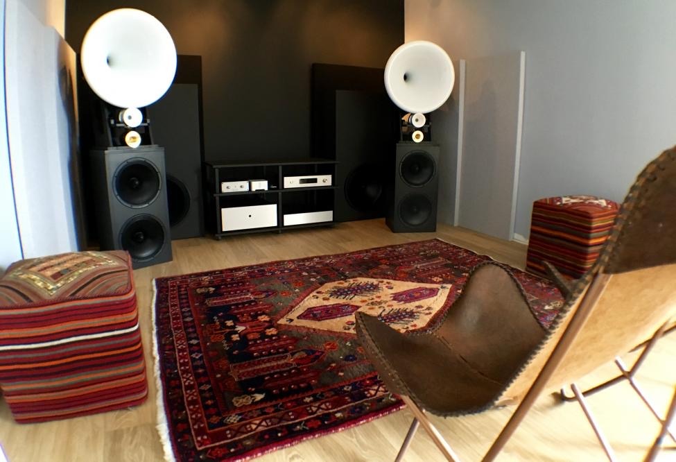

Regarding the discussion of SE Tube amps on horns. I have several amps f.ex. DIY SE300B monoblocks and PP Kt88/EL34 monoblocks as well as DIY First Watt class-A amps and DIY Class-D and a chip amp.
My 300B amps paint a lot larger than life scene and get confused on complex classical and rock. For acoustic music and jazz they are great. The PP tubes and the First Watt amps are similar although the tubes have this inner life that can be mesmerising. I can live with either. Some class-d and chip amps are to cold sounding on my horns (ncore, Neurochrome) while the ICEPowers and olders hypex UCD400 are warmer sounding on my speakers.
Regardless of having many amps to chose from, I have for a long time used: ncores on subs, and First Watt F6 or ICEPower 1200as2 on the VOTs. With active crossover on the sub and some suttle eq on the horns the amp discussion seems to dissappear and the convenience of class-d takes over.
I will at some time go fully active (miniDSP flex 8) and try a combination of class D on the subs, PP EL34 on the bass and SE300B on Mid (and tweeters if I need them) and compare with f.ex. ICEP 1200as2 on the subs and 2x ICEP 200as2 on bass and Mid (and tweeters if I need them, my tweeters are old jbl 075). It will be intresting, but I alread suspect the conveninece and reliability of the class Ds will vin.

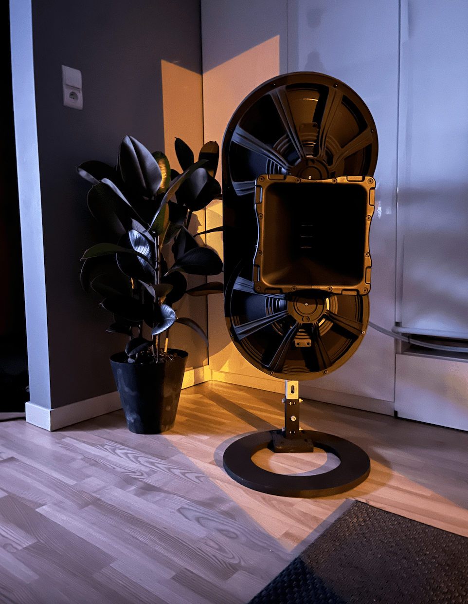

Its behavior with other drivers may not give the same smooth FR. My friend uses the horn with Faital pro hf1440 and the combo requires more equalization. With the RCF 940/950 you can get it fairly flat in the passive without any problem. And it allows a low enough crossover that you don't have to worry about a lower frequency driver. It may not be the world's best combo, but in terms of the set of tradeoffs and overall quality, it's a great products.I find it a bit ugly bot it might be a good candidate to use with one of the B&C coax drivers
About the look. It's typical PA stuff, the aesthetics conventional. And they come in different plastics, sometimes looking better or worse. But overall, I'm personally quite happy with its design.
