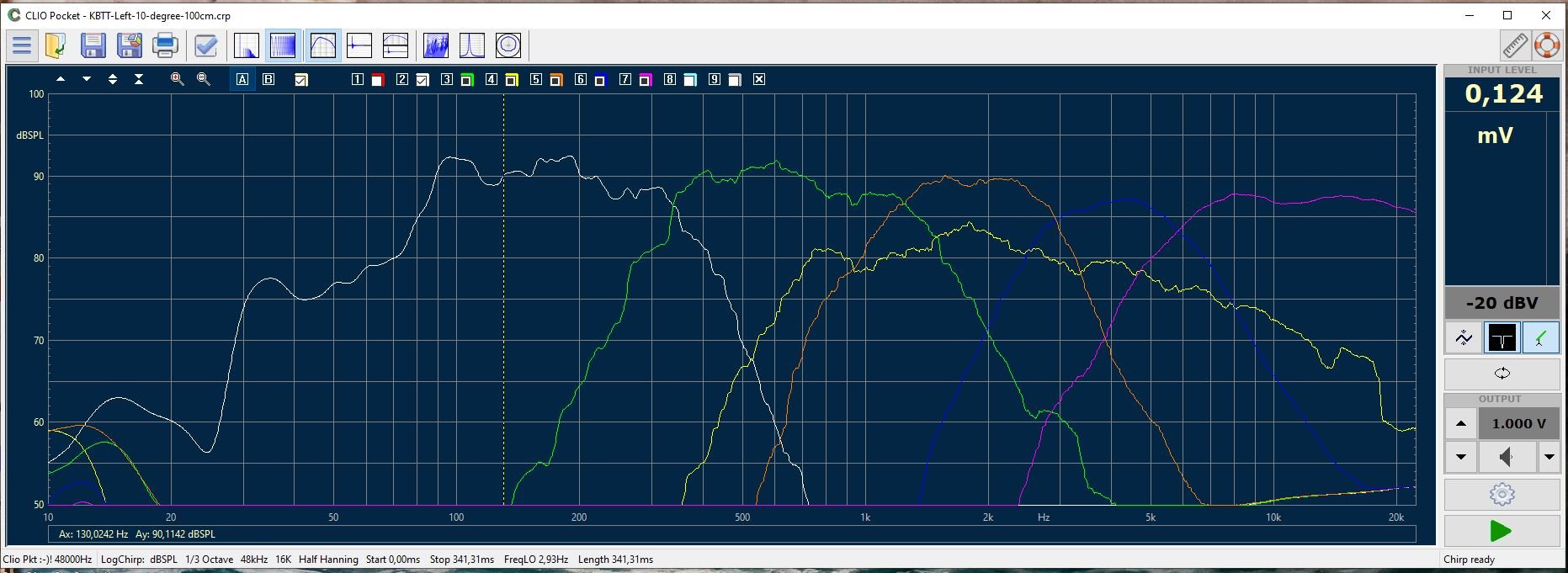

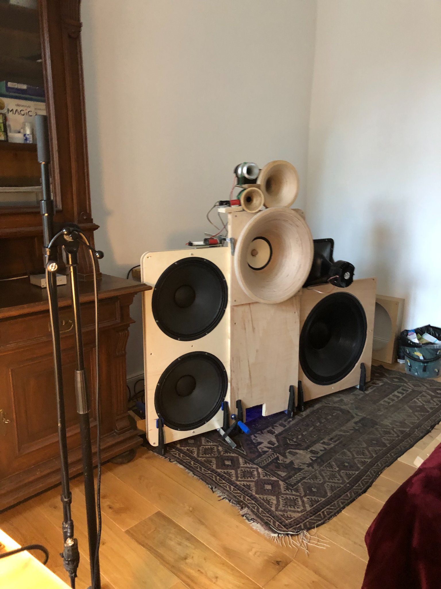

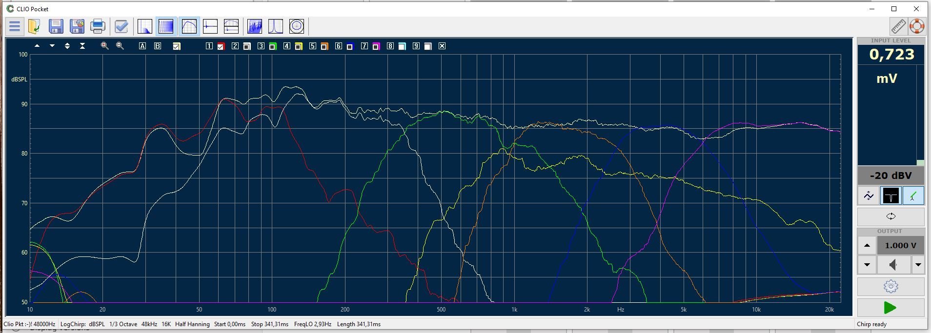

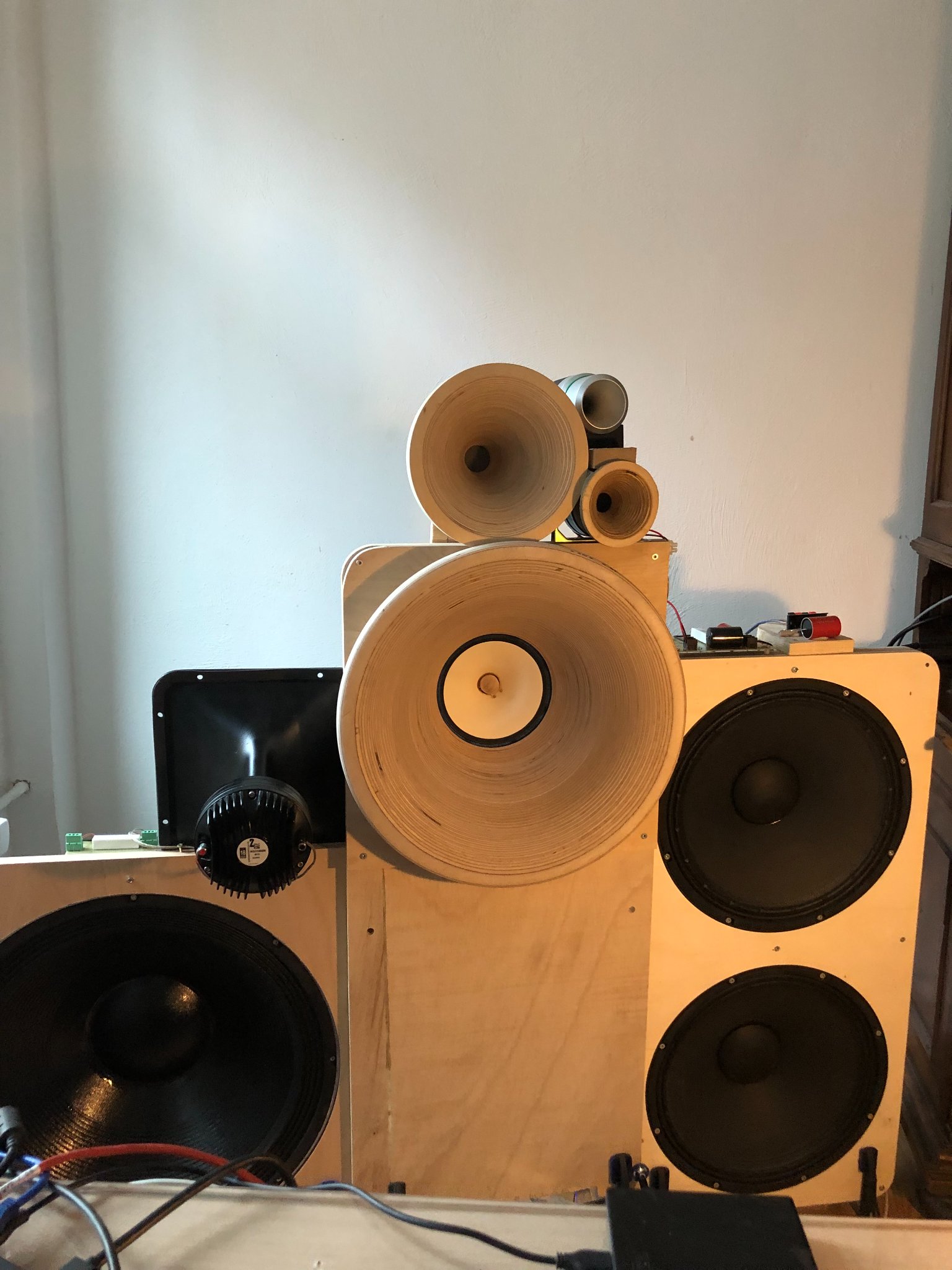

Hi all, posted some time ago this proof of concept exercise for a multi horn system with short listening distances
CLIO measurements without 21 inch OB sub woofers
10 degree Right CH / Left CH equalized for unsymmetrical
listening position 150 cm L / 350 cm R at my home office desk
ALL-KBTT-TMT-Backfire_MHT-MHT-HT-SHT-Left-10degree-100cm-Capture.JPGKBTT-TMT-Backfire_MHT-MHT-HT-SHT-Left-10degree-100cm-Capture.JPG
got it to work for near field listening position only after the introduction of miniDSP 8 Flex DL Dirac room correction
