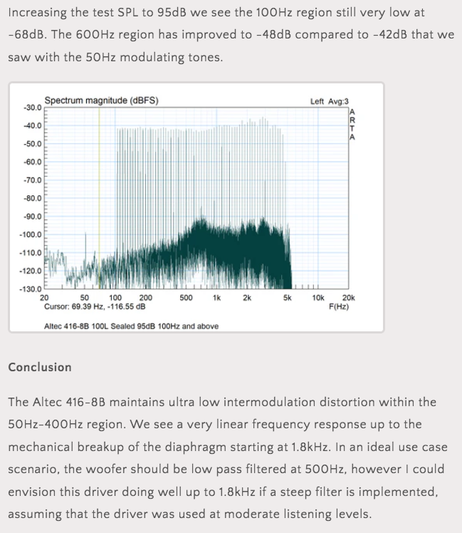

https://josephcrowe.com/blogs/news/altec-416-8b-in-100l-sealed
Note that Troy Crowe says to cross them close to 500Hz, which will minimize third harmonic and IM distortion. And I want to main system impedance well above 4 ohms to minimize distortion with this amp.

The HP filter (low cut) is what minimizes harmonic and IM distortion in the woofer.Note that Troy Crowe says to cross them close to 500Hz, which will minimize third harmonic and IM distortion.
In the 100-1000 range your Altec woofer probably has less distortion than a compression driver at the low SPL you will listen at.
Recorded music sounds most natural (non-artificial) without adding harmonic distortion.From what I think you said, the 2450J can reach towards 16kHz, which even though I can’t hear that high can perhaps best deliver the lower HF harmonics that makes recorded music sound natural.
Adding harmonic distortion may make source material sound more euphonic, but that addition generally already has been done (or overdone..) in the recording stage.

But are you saying that Troy Crowe's recommended 500Hz crossover point is uncommonly low for my 15" midwoofers? https://josephcrowe.com/blogs/news/altec-416-8b-in-100l-sealed But is 500Hz the wrong choice despite my intention to cross with my subwoofers at ~ 70Hz,80db likely and given the 100 liter sealed cabinets rather than the large reflex cabinets those drivers were designed for and for minimizing IM and 3rd harmonic distortion?
https://greatplainsacoustics.com/pr...Ix_45k7dErBP0jDGJzmzw0gzjQutdQXpwlttSewcxVvNk and
Troy Crowe wrote the Altec 416-8B would do well crossed over up to 1800Hz, and it's "ultra low IMD" is even less when there is no stimulus tones below 100Hz.But are you saying that Troy Crowe's recommended 500Hz crossover point is uncommonly low for my 15" midwoofers?
Driven to 95dB (one meter) it's IMD reaches it's peak ~700 Hz, so if you were crossing over based on IMD levels that are similar to the noise your refrigerator makes, you might "ideally" cross below the point where the 15" IMD rises.
Ideally, you would also unplug your refridgerator whenever you are listening for IMD..
IMD will increase with SPL, the dispersion of woofers and tweeters does not change with level.
Most designers and listeners prefer crossover frequencies near the point where the woofer and horn's -6dB dispersion is similar, or "matching".
Arez wrote 600Hz is unusually low for a 15/16" woofer when it comes to matching it to the dispersion of a horn.
Troy's test did not include dispersion tests.
Altec Lansing's beam width charts indicate the 416-8B -6dB point is ~150 degree at 600Hz, dropping to ~70 degrees at 1250Hz, 50 at 2000Hz.
The deeper cone of the 416-8B makes it's upper dispersion a few degrees more narrow than a shallower cone like the JBL 2220B.

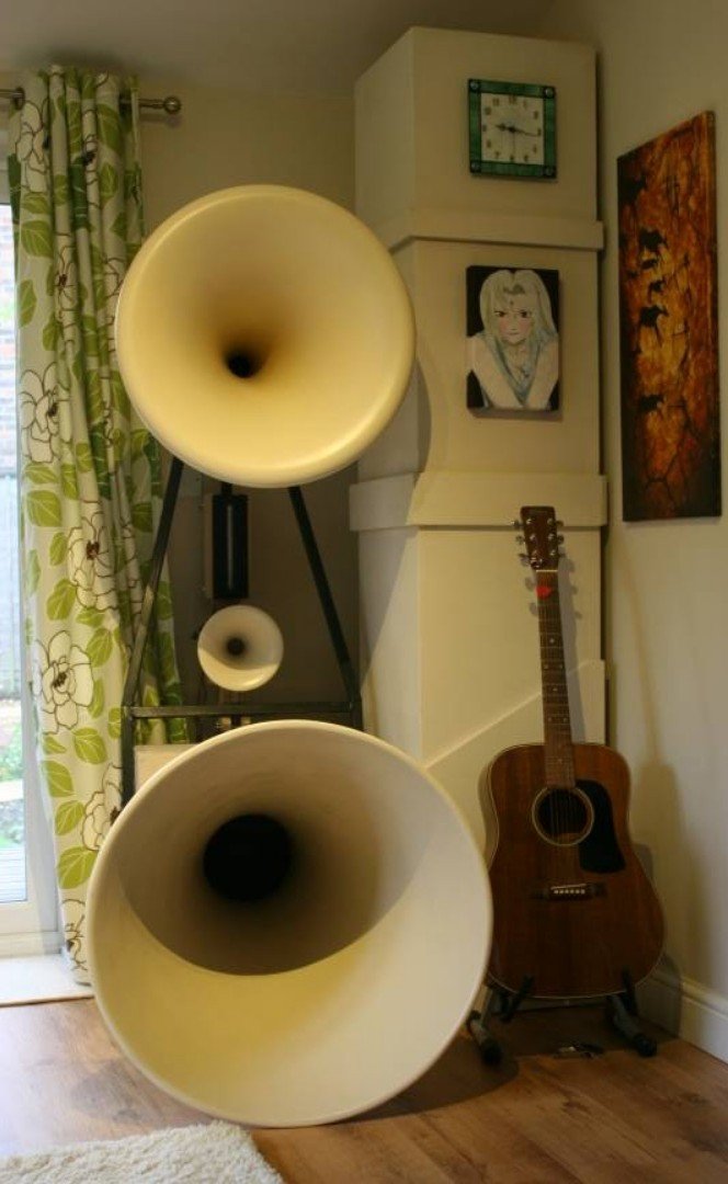

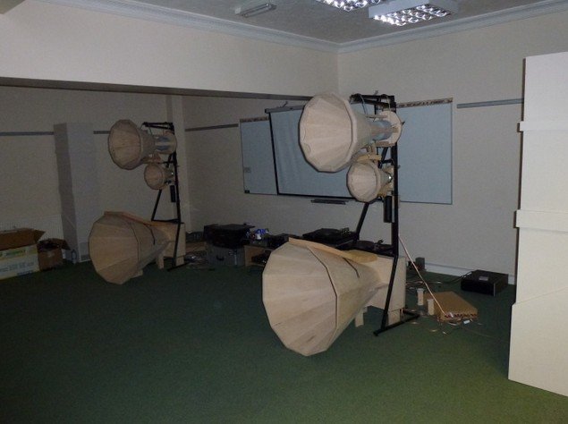

I went from 45° conicals, to exponential (on midbass) / Tractrix, to Le Cléach (where practical) and then back again to 50° / soon to be 60° conicals (Multi Entry Horns).
The latter are by far the most natural, uniform and right sounding horns I've made or heard.
A lot of that is to do with the single point/linear phase synergy effect, I believe.
You mean from here http://www.romythecat.com/Site_Images/HornwiithScraches.jpg and then back?I went from 45° conicals, to exponential (on midbass) / Tractrix, to Le Cléach (where practical) and then back again to 50° / soon to be 60° conicals (Multi Entry Horns).

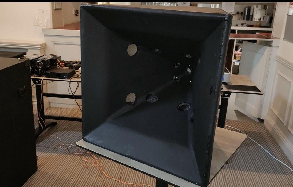

Any experience with what Bjorn briefly mentioned here, diffraction horns?
https://www.audiosciencereview.com/...peakers-is-it-me-or.9633/page-45#post-2274682
Or anything like these?
https://audiohorn.net/x-shape-horn/
https://audiohorn.net/next-gen-bi-radial-horn/
