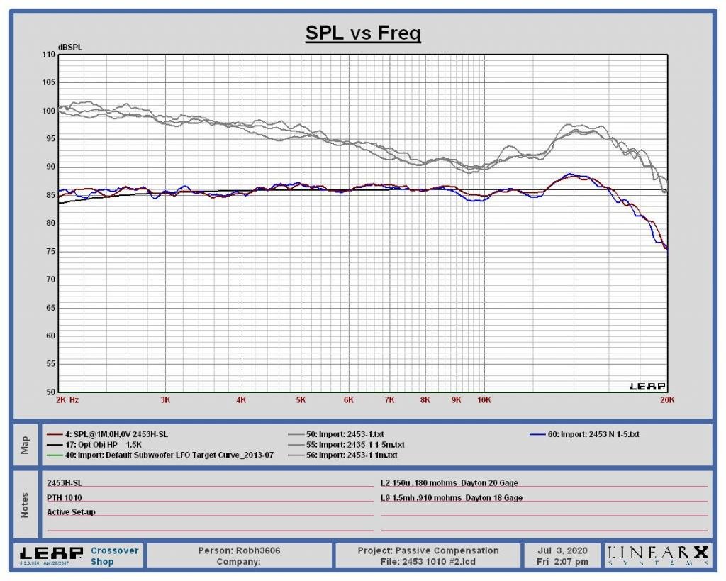

With all the discussion about JBL drivers I am surprised the SL coated diaphragm's don't seem to be in the mix aside from a brief mention. The 2431/2435 drivers were uncoated S/R drivers Aluminum and Be. When incorporated into the Array 880/1400 and 9800 systems they were coated with aquaplas. This coating makes a difference and improves the CSD time domain performance.
The 2450's 1.5 and 2 inch have SL/coated diaphragm's available. The 1.5" throat versions can go out to 20k without + EQ and are much better behaved than the uncoated versions. I have no experience with 2" versions and horns/waveguides.
A cheaper alternative to Be as a start. You mike like the SL's enough to forgo the Be conversion. With a 4" Be there is a good chance you may want to add a tweeter to the mix adding cost and complexity.

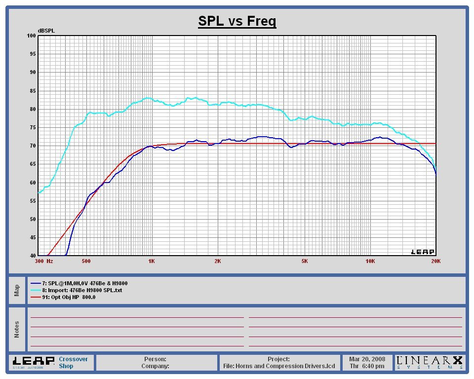

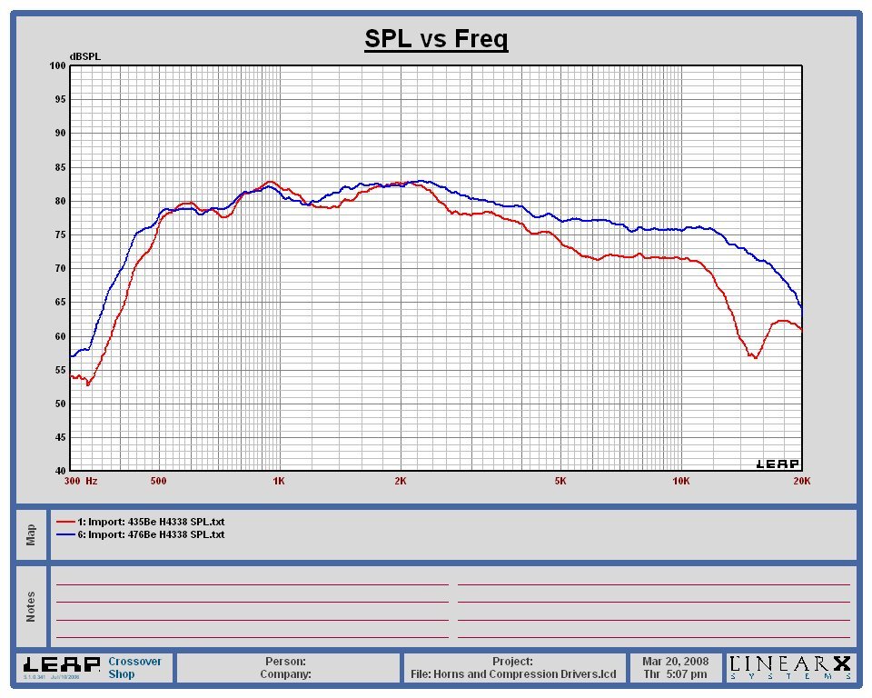

I have a recollection that there were some measurements comparing the Ti SL/coated diaphragm with a Be diaphragm, at the Lansing Heritage web-page, but I cannot find it.
Kindest regards,

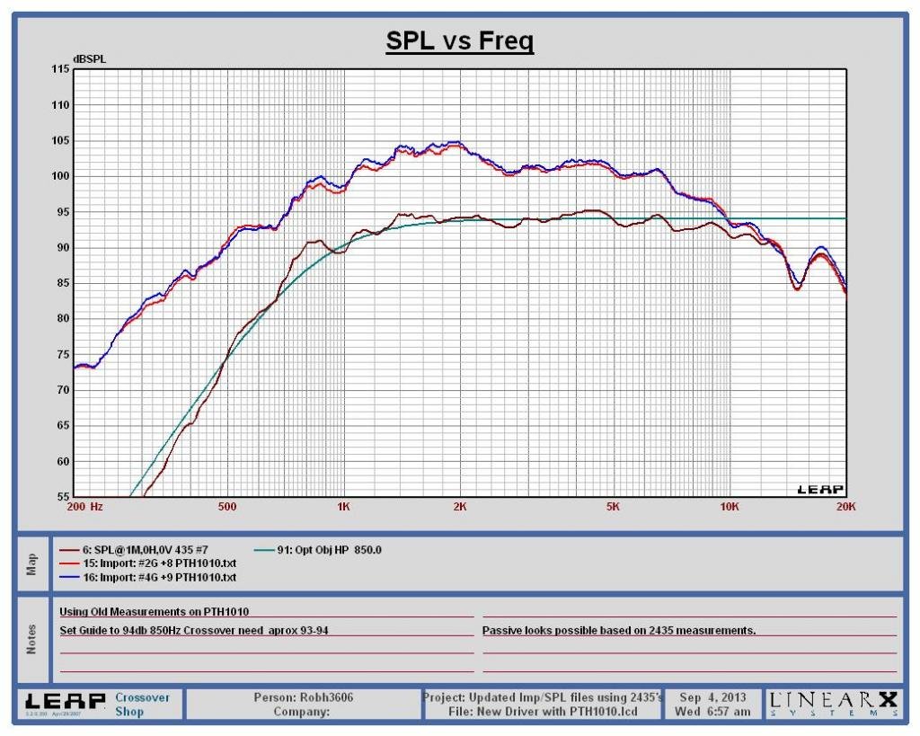

I meant additional EQ beyond the EQ from a passive crossover to flatten the response. Here are some examples 435Be vs 476Be and 2453Sl The Be's are more rolled off above 10K. The 476Mg has a rising response. You could extend the response a bit with a penalty in sensitivity.
The attached thread has comparisons as well. The Be is Truextent and not the stock 476 Be. I believe this may be the thread you were looking for with 2451 core.
Rob 🙂
https://www.audioheritage.org/vbull...-4-quot-Diaphragm-Comparisons&highlight=476Be

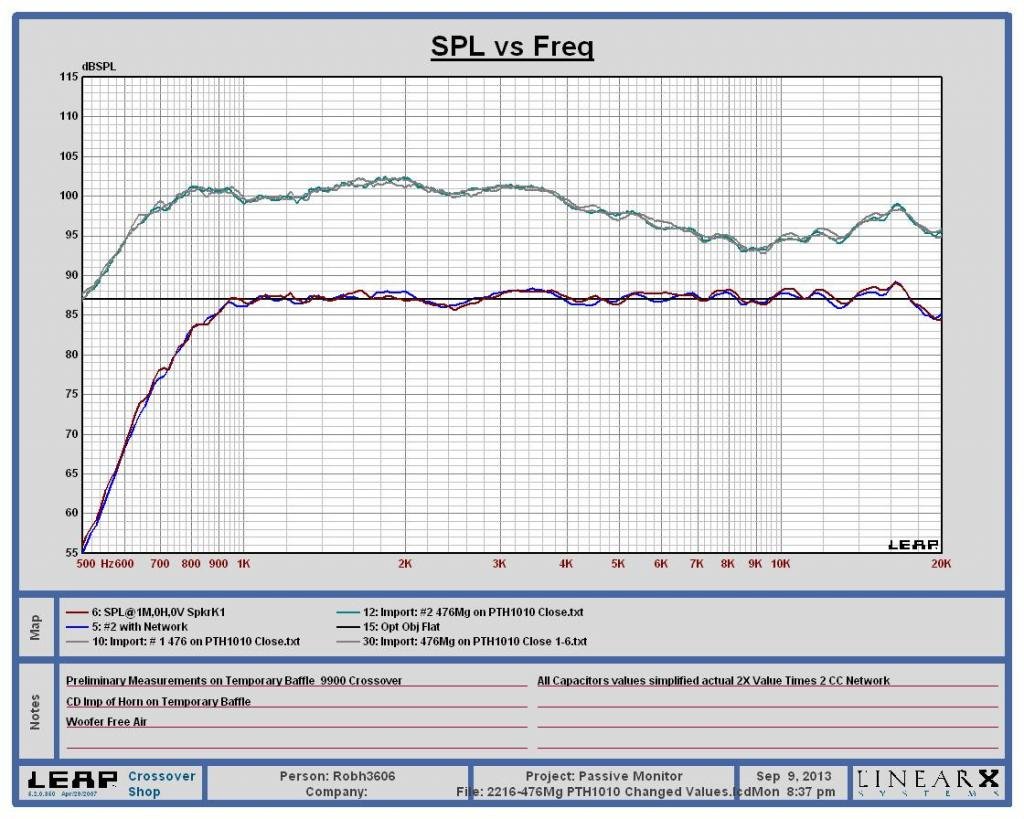

Hmm? I did an analysis of the 9900 network for what the series and parallel notches did with changes for conversion to use on the PTH1010 waveguide. If that's what you are looking for? Nothing recent with single cap values
Rob 🙂

No, that is not it. There was some discussion about the protection/equalization network, with pictures of the PCB, on which the components, I believe a resistor(s) and capacitor(s) were mounted. There was some confusion about the values. It might have been in one of the many M2 monitor threads. I will find it.
The correct value is 3.3uf not 33.3uf
If this isn't it I give up!
Rob 🙂
https://www.audioheritage.org/vbull...ect-M2-DIY-Thread/page2&highlight=passive+pcb
