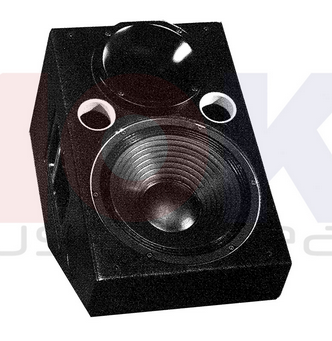

Or have you ever heard the Yamaha JA6681B? https://audio-database.com/YAMAHA/unit/ja-6681.html
As you may know there is a main thread here on this driver from the 1980s. Gary Dahl, Pierre, Radian, and many others found it especially "magical".
Not surprisingly, Lynn and many others won't risk using it as Yamaha and Meyer Sound discontinued making the diaphragms long ago.
Any experience with it?
The last time I heard a Yamaha JA6681B in a Meyer Sound UM-1 stage wedge monitor I wouldn't have used "magical" to describe it, though it was a good sounding driver with very good (for the time) processing on a good "beamy" horn above a good 12" woofer. The processing made it difficult to make it sound bad or burn up, while still sounding "Hi-Fi".
Around the same time, I was using JBL 2425 1.75" diaphragm drivers on an Eden 70x30 CD horn, and JBL 2445 drivers on JBL bi-radial horns for the same application. The larger diaphragm, lower Fc horn/JA6681B could be crossed lower than the 2425, and had smoother frequency response.
In a previous monitor design I used a JBL 2421/2407, more similar to the UM-1 sound.
The 2445/bi-radial had more output, but the 4" diaphragm HF breakup, harmonic distortion and horn diffraction made it sound more "trashy" by comparison to the UM-1.
Meyer's narrow conical exponential horn had little diffraction effects and didn't "spill over" to neighboring musicians, but limited the HF coverage to a small stage section.
It's separate LF/HF limiting would result in an acoustic crossover shift when driven hard above or below the electronic crossover point.
Although I do have nostalgia for the era the JA6681B was made in, and it's peculiar surround, I wouldn't be inclined to search for the driver over others even if diaphragms were still available.
