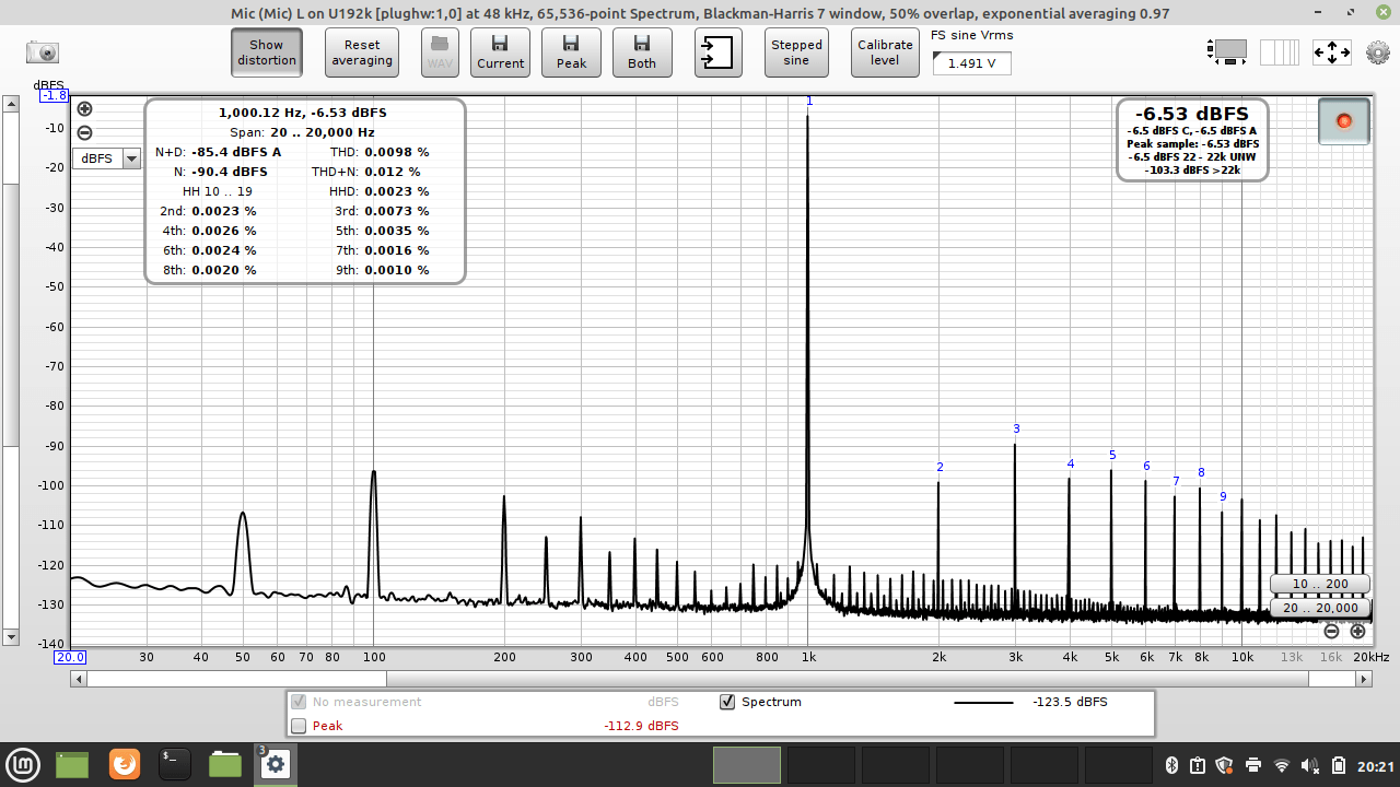

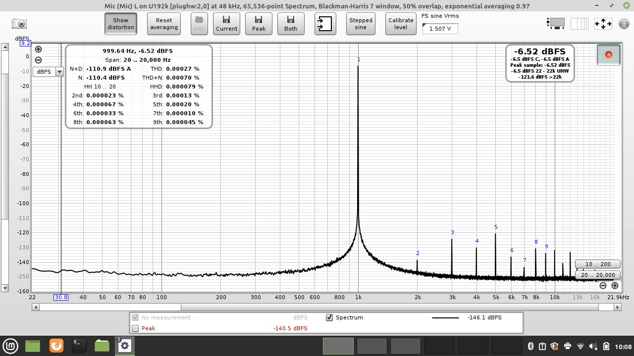

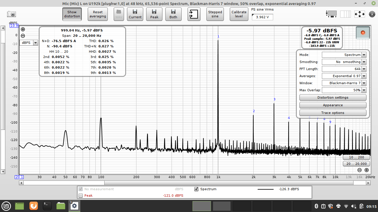

So i tried a lot of different's combination, using some of what was said here, and some with "trial & error" 🙂
The result is kind of much better now.
If i move the trafo away from the chassis, the 250, 350, 450Hz etc... dissapears.
So i turned it 180C, and moved it as long as possible away from the output terminals.
(I forgot to take a screenshot when trafo was moved aeay from chassis)
I took all the screenshot's with 1v output / -6dB
But i also attached a shot here, putting out 2.8V @ 1Watt, really nice THD numbers after all!

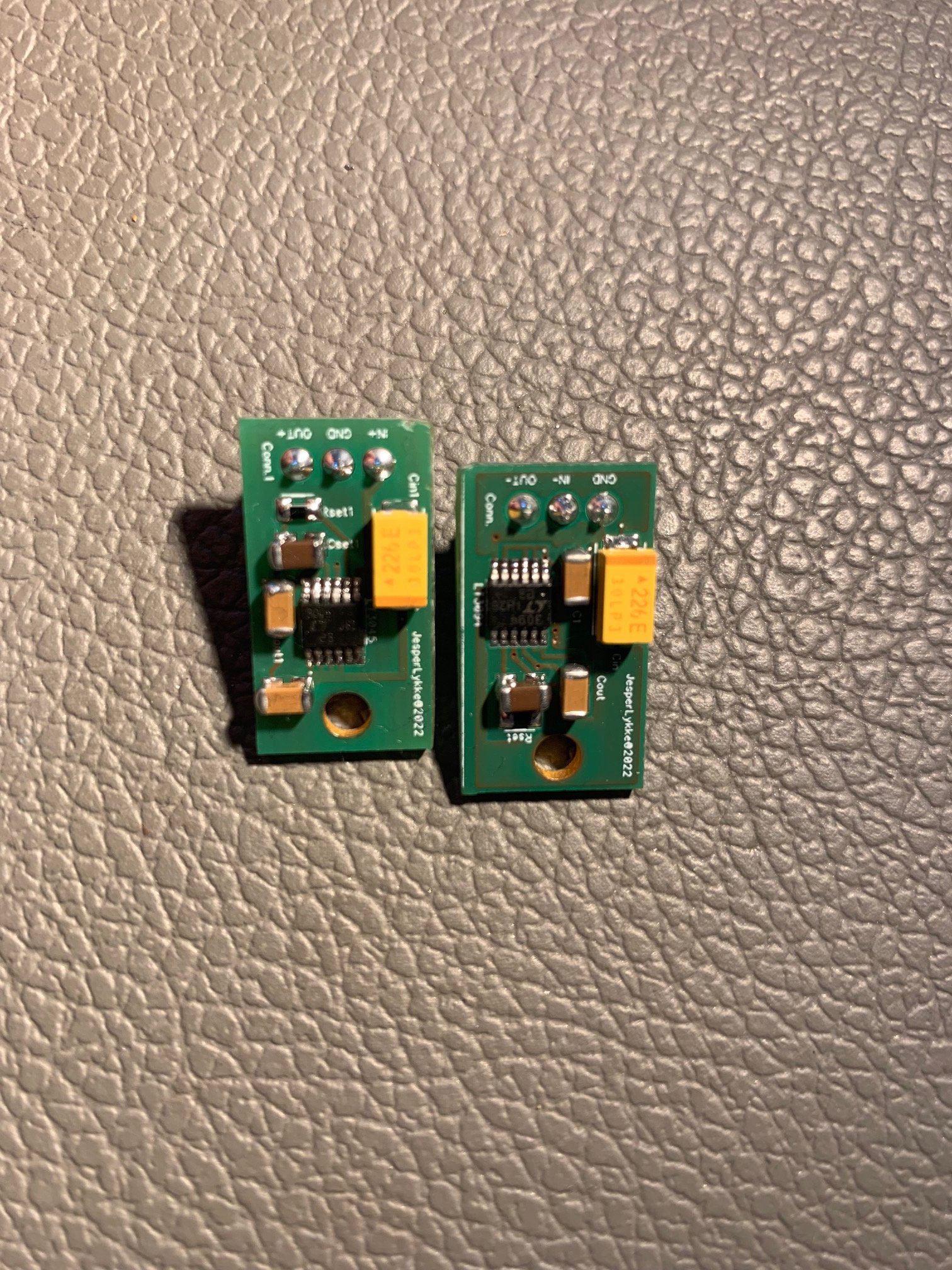

So to compensate a bit for this i just wanna tell that i'am waiting for my own designed 😵 LT3045 and LT3094 TO220 (LM7809 / LM7909) pcb's.
I have the chip's on hand now, so looking forward to see if i can make them work as expected, and replace the LM's on Magic's board.

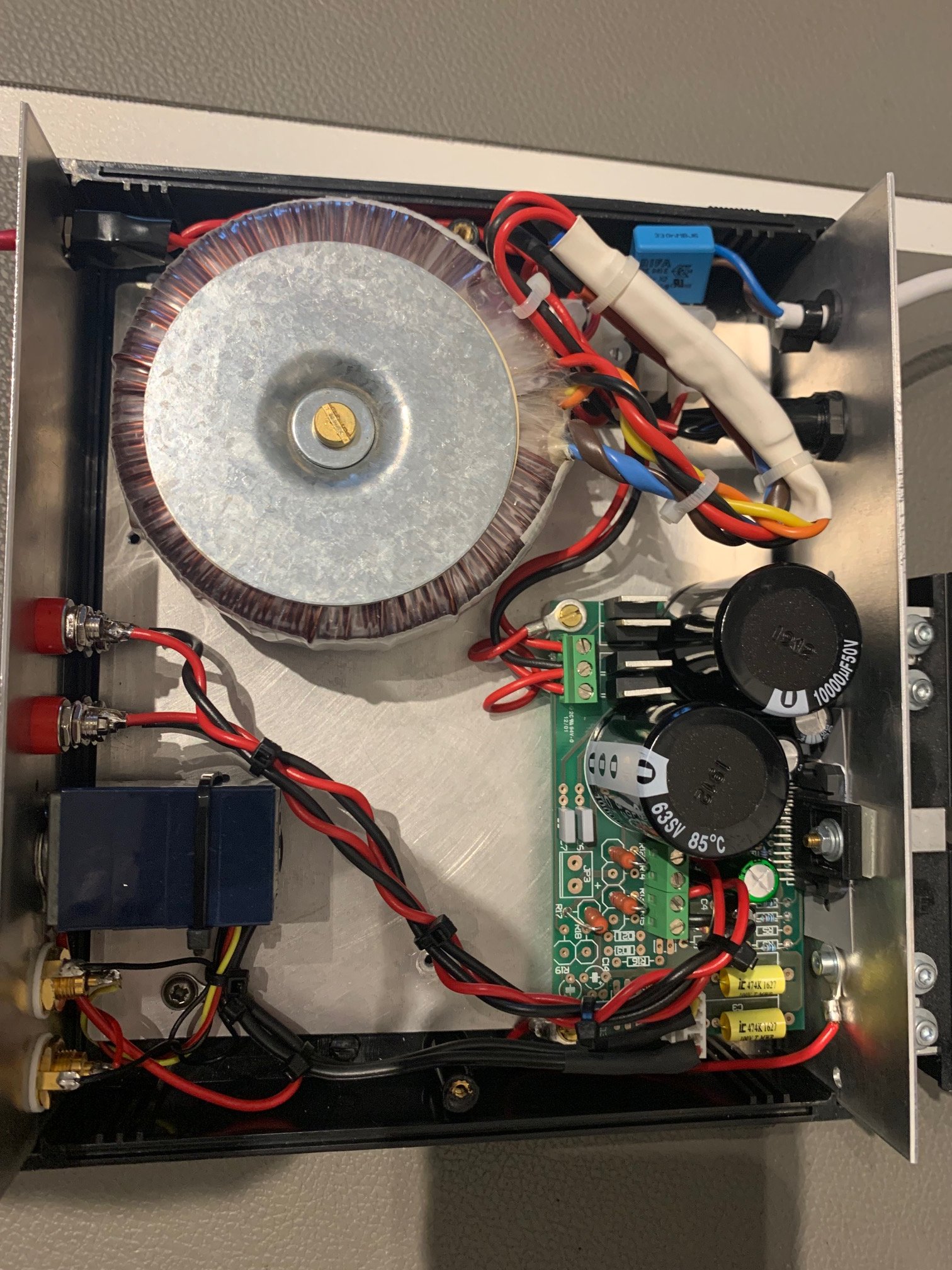

Jesper, your clone amp appears to use the same screw terminal for both the transformer secondary CT and the link to chassis ground - is that correct? Does the signal input ground itself at the input socket, or via the pcb to that power supply screw terminal ? The speaker outputs appear to be connected to ground through the pcb somehow. Is there a link to that pcb to show its trace outline?
Yes i use the CT to also connect to chassis. I moved it to a new point, away from "signal gnd".
If i disconnect this wire, the 50Hz increase some 10-15dB.
Unfortunately i don't have any pcb outline drawing.
Jesper.

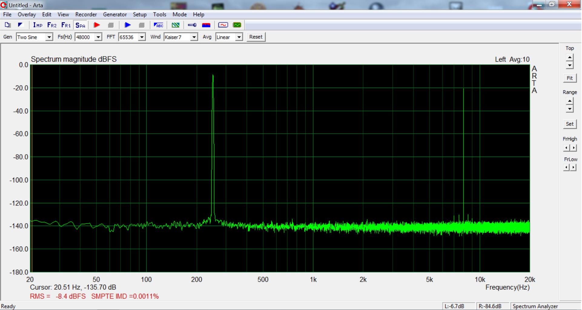

Much better now! And no, not polluting at all. It is a practical application of the project, a test under real conditions. Having access to measuring gear -now possible for low budget DIYers- makes troubleshooting much easier, let alone remote support. 😉 So, for more info on how the transformer was the obvious culprit you can read here : https://sound-au.com/articles/intermodulation2.htm BTW the balanced input has low enough IMD to ensure a clear view of the DUT output.

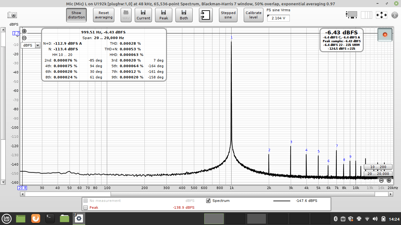

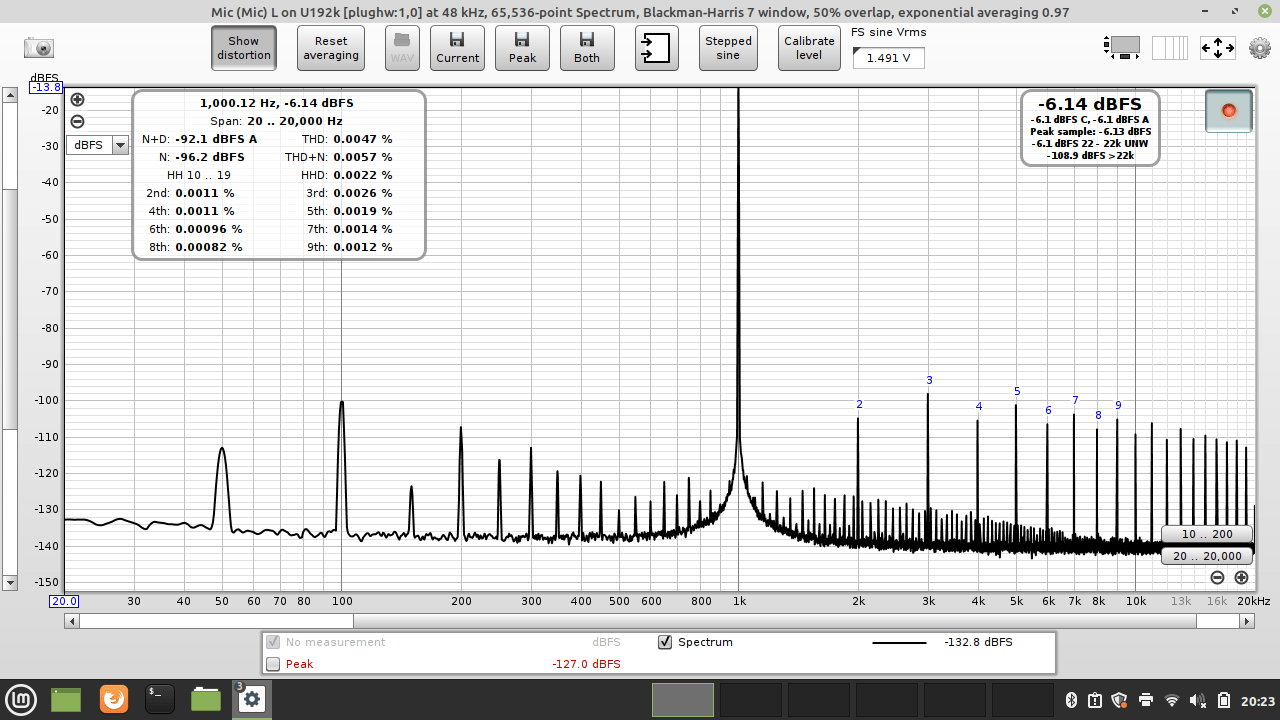

My measurement's are taken with following specs. :
  • Victor's at ~1.0 ---> 1.2v 1KHz sine
  • Victors PSU is normal regulated linear psu
  • Behringer is powered directly from PC usb port
  • CloneAmp for comparing YashN's mod to the Balanced input is at input 0.625v (i don't bother to make voltage dividers today)
  • I prefer using my Behringer around -6dB as i see best numbers there all-around that is
  • Today all measurement's was with my PC (Laptop) psu plugged into the main's (Normally it doesen't do much difference)

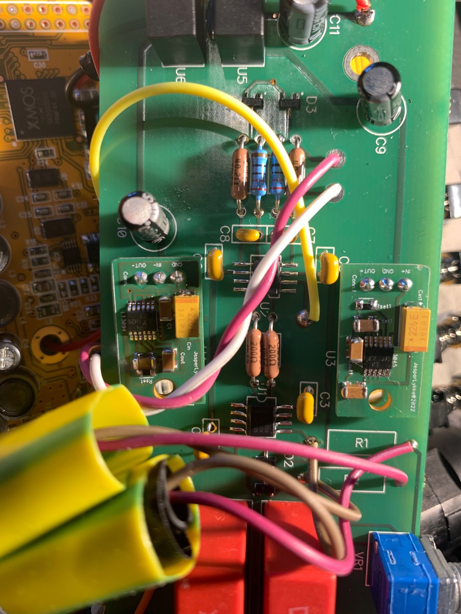

So i have for a long time wanted to try out if a better regulator on @MagicBus board was giving better result's, so here we go.
And yes, i looked at "other" design's, using my good eye's and copyeid much of what i found regarding layout etc... - But i won't be selling or something, just for my own use.
The LT3045/LT3094 board's was tested with my scope and a DMM, regulation was good, and no noticable noise. (I did not intensively test them)
In situ i also measured the -9vdc & +9vdc to be sure it did not change during use, which they didn't, soo seems to be working as expected.
And installed inside the Behringer.
As i see it looking at the loopback's, there is absolutely no need bothering using better regulator's than the "stock" LM7809, LM7909 ones.
I belive thoose topnotch opamp's have such good PSSR and stuff that they don't really care 🙂
Well, the one's i made, they will stay in, but as i said, don't bother.
When i have setup the equipmen't today, i ran some test with @YashN mod too.
It's been some time since i last used this mod (my Right input), and the result's are excellent.
Comparing it all is told by the text giving the attached picture's here also.
I'am so glad i build this handy tool, allready used to optimise my labamp. and stuff.
Really a nice piece of equipment, very good to have on hand when doing stuff and building amp's. like i do 🙂
Jesper.

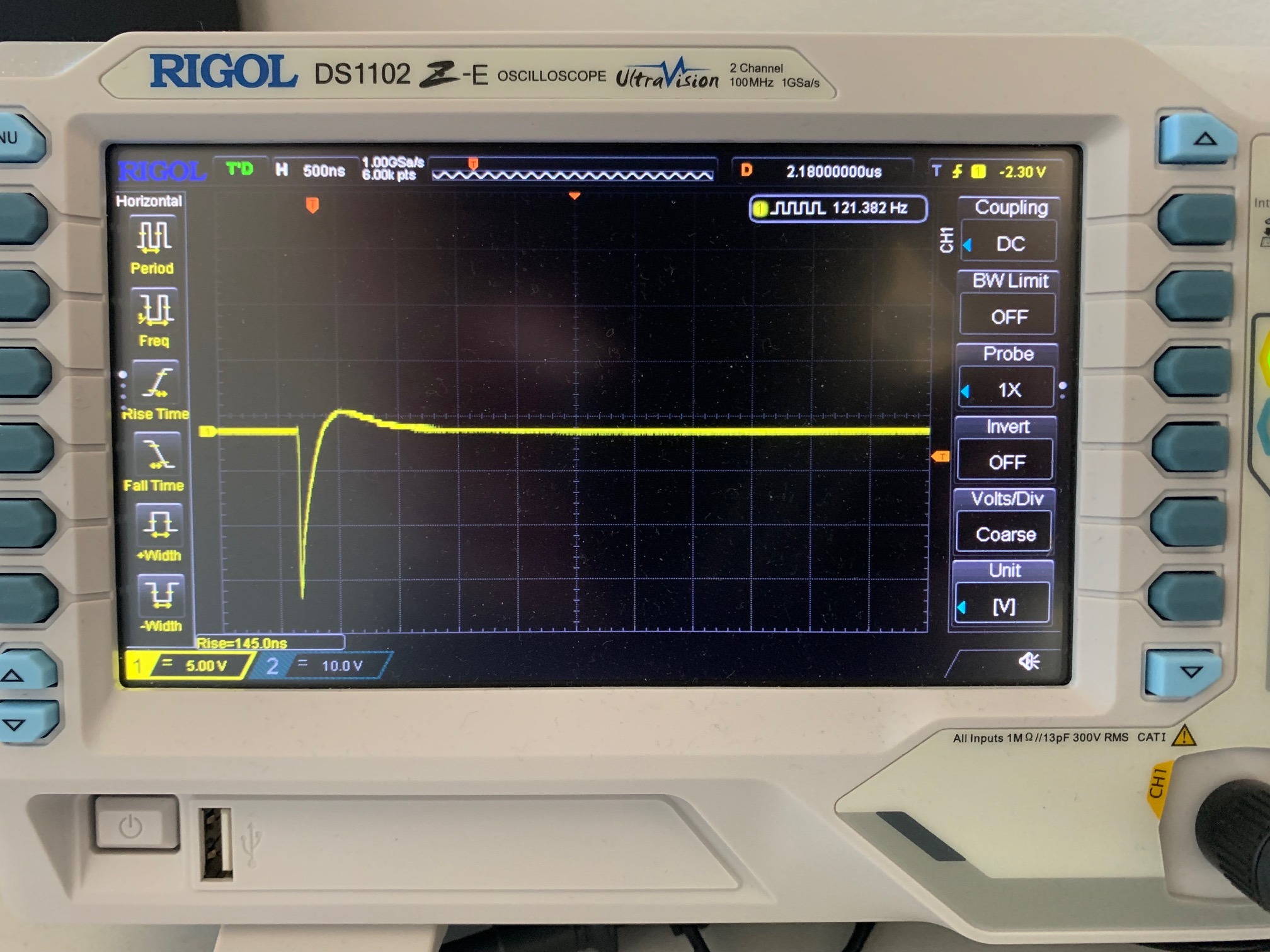

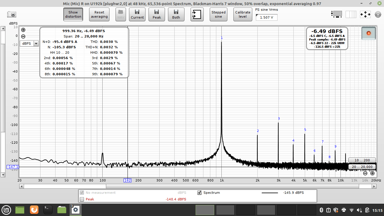

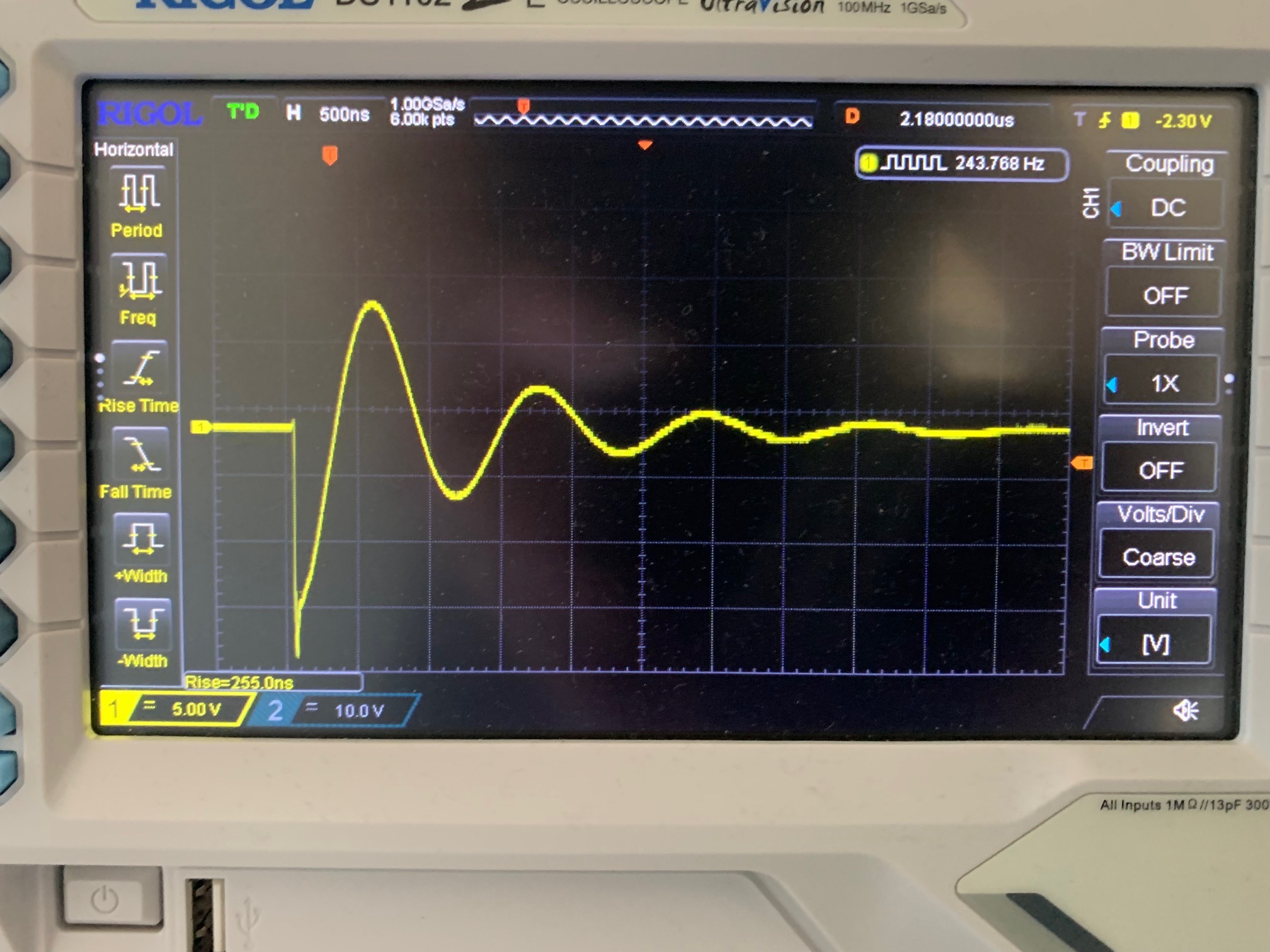

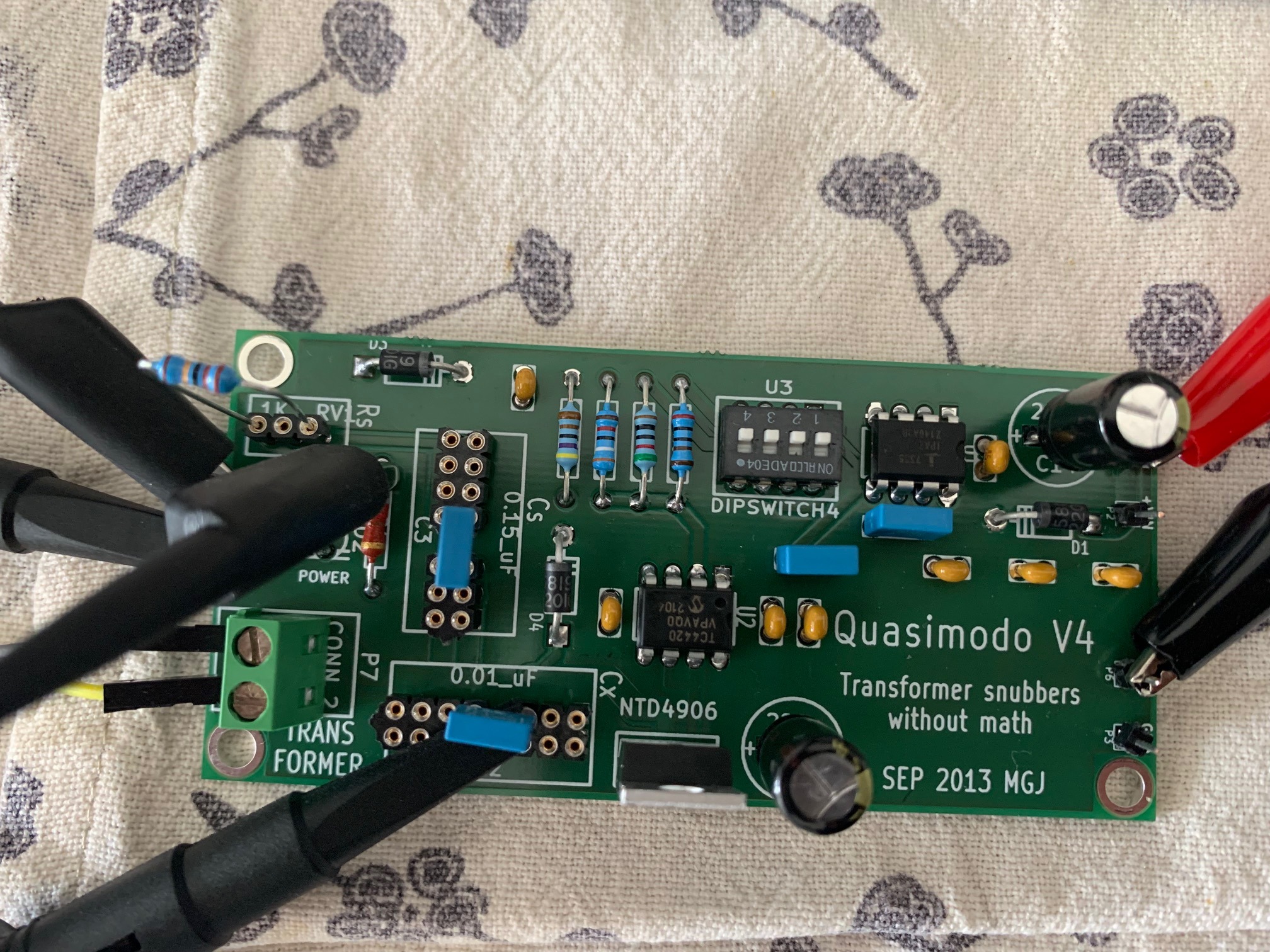

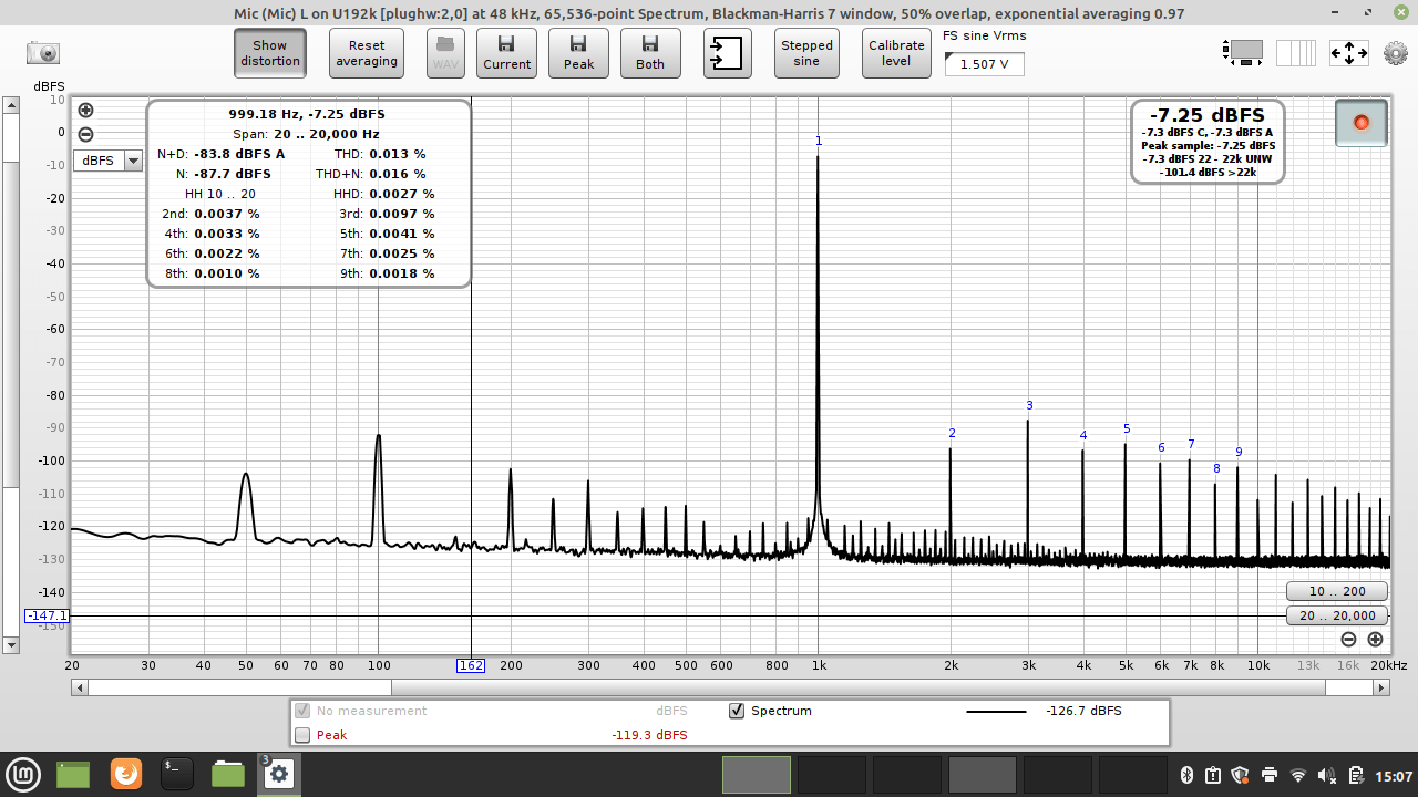

In meantime i had my Quasimodo jig ready and having it working i tested the CT transformer in my famous 🙂 CloneAmp.
Eventhrough i hoped that it would cure more of the 100Hz spikes, it certanly does a really good job, stopping the ringing in the transformer.

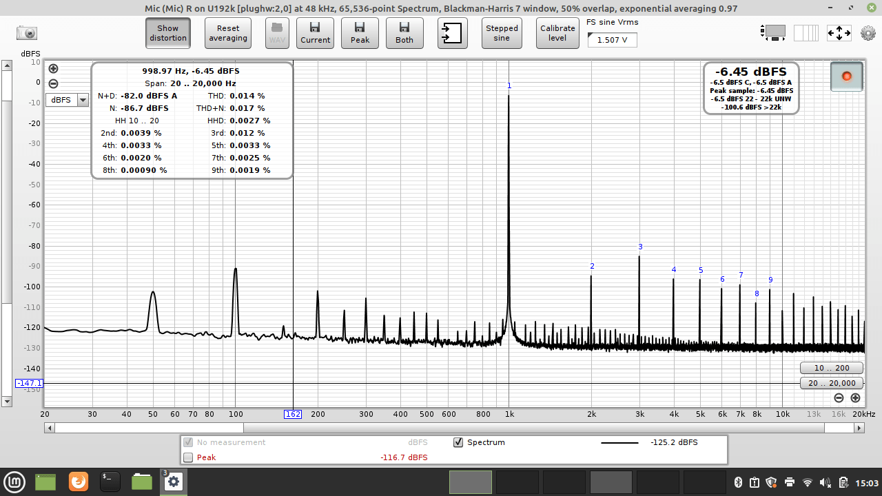

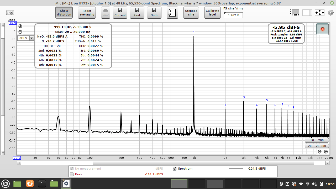

I did a FFT before i installed the snubber's, and a new FFT after, within 90min (Sunday morning), so the comparing should be verified as good i think.
Pictures speak for themself.
Rgds; Jesper.

Are you able to make another measurement of when the snubber is disconnected again - making sure that no leads are moved, or any other changes made than just breaking the connection at the snubber parts?
It just seems unreal to me that your harmonic levels would change by that level.
I will have this in mind, when i do the next snubber experiement on another amp. or like.
But i was very carefull, not making other changes than soldering the capacitor's and resistors on the sec. wires on the transformer.
But your'e right, a bit of wire moving or like could make a difference.
Well, the noisespikes below -110dB are reduced a lot, not that it could be heard, but still the improvement are great.
When i do the snubbering on my next piece of equipment, it would be interesting to see if numbers are getting that much better ?

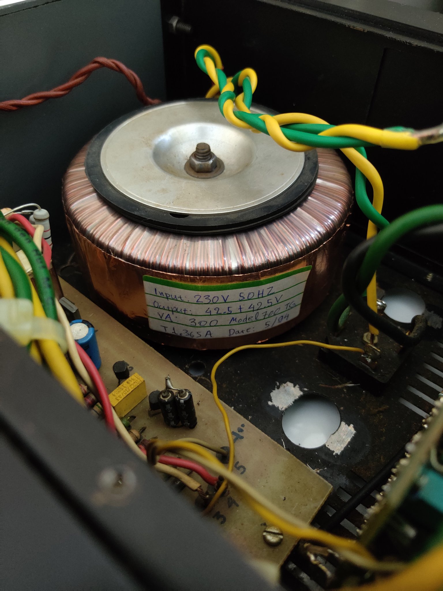

Jesper, hello
I wrapped self adhesive thin copper tape around a 300VA toroid in an old diy amp hoping to form a Gauss band shield. It improved SNR by 10dB. A very cramped amp due to shoebox size chassis. The 90s made so so quality toroid was interfering a lot. So keep this technique in mind as well.
