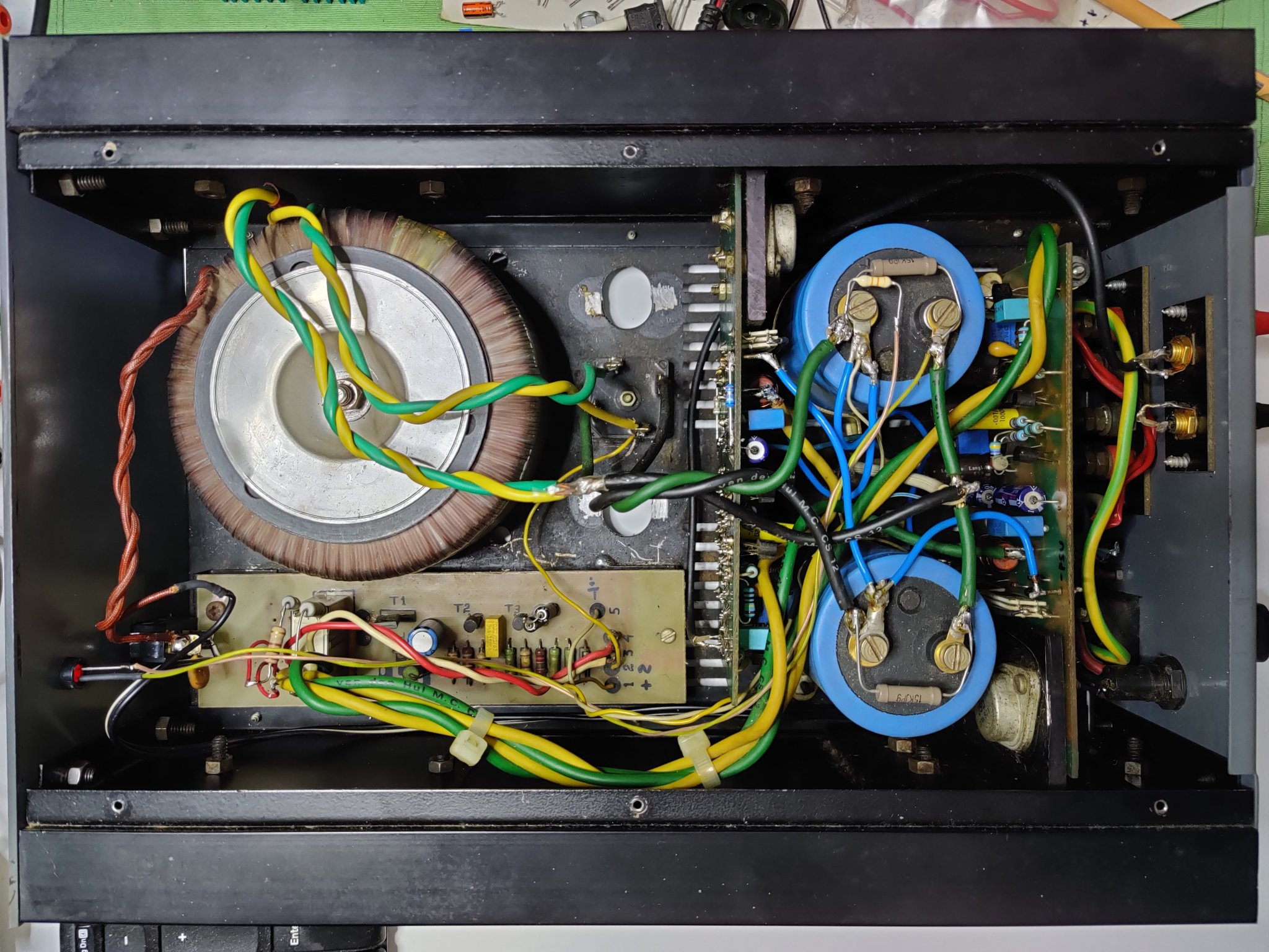

Was 50Hz noise frequency the dominant contributor to 'N' for the -80dBV level, and is it still the dominant contributor to the -90dB 'N' now?

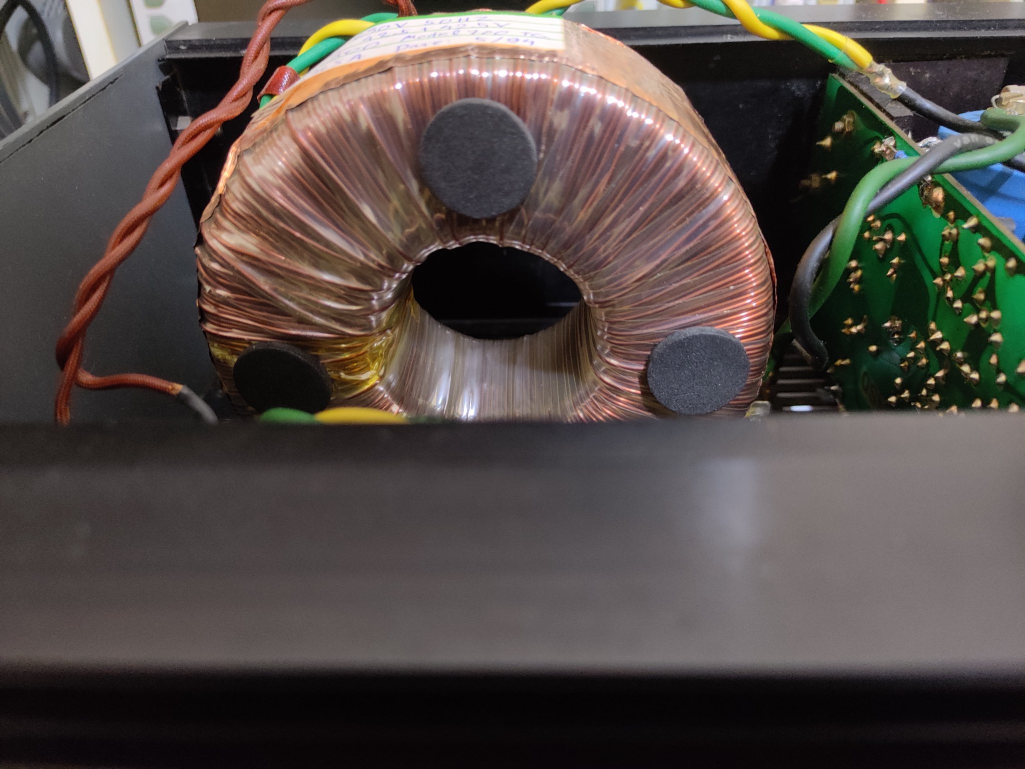

No, the grunge mainly was. I had the 50Hz controlled enough by optimum Tx orientation although the grunge wasn't going away much. But the flux band cleared that a lot. Especially for the closest amp channel board.
So that 'grunge' would have been 50Hz sidebands to any test signal passing through the amp (ie. discernible 50Hz side-lobes on a fundamental and its HD frequencies)?
Unfortunately I didn't keep the older measurement on file. I remember the N+D number and higher visual clutter before and after the test frequency. There's 30dB voltage gain and an output relay nearby as well. Tx hum field could have been coupling in many ways.
There are transformers built like that. I saw a flat transformer from old Yamaha studio monitors that have the copper tape all around. I don't remember if the tape is grounded, but I think that's a possibility as well.

Here's an interesting video I found on the flux band topic. Includes theory and a test. Achieved -10dB field attenuation at the 133 kHz fundamental converter frequency. Some rise of noise in very high frequencies due to electrostatic collection wasn't helped by grounding the band. That JLH 1982 design diy amp I put the thin copper band on its toroid has 35kHz F3 so nothing to worry.I don't remember if the tape is grounded, but I think that's a possibility as well.
Caveat emptor - imho his vid on active bridge rectification had some quite poor comments.
The vid on the flux band didn't appear to make any comment on the width of the copper band except related to ensuring creepage and clearance. As I recall, one past emi guru recommended the band be significantly narrower than what was being shown in the vid - although I can see that the vid was more aimed at making people appreciate the add-on as a no-brainer testing modification if an assembly was not meeting some aspect of emi compliance, although even that aspect of use lacks any detailed comment as to what aspect of emi compliance may be being influenced other than 'look I used a sniffer probe to indicate a change'.
I can assure you that these flux bands are widely spread in smps originitating from asia - including low cost versions. From my own experience I can confirm a significant reduction of emanating magnetic stray flux. This is an issue specially with gapped xformers found in flyback converters - the common topology for lower wattage smps. The stray flux induces voltage noise along adjacent copper traces that can make the hole regulation unstable.Caveat emptor - imho his vid on active bridge rectification had some quite poor comments.
I appreciate the widespread use of the flux band in smps. My comments relate to the width of the band, and to a lack of comment about what aspect of emi compliance is at risk (ie. take a commonly used compliance standard and indicate the particular measurement(s) that may not be being met, and hence make a part change and remeasure to see if compliance is then met).
Your unstable regulation comment appears to relate to local corruption of reference and feedback signals that may or may not be a result of poor pcb and part layout.
As far as I remember the flux band may improve conducted emissions upto 1MHz. And its width correlates with flux attenuationI appreciate the widespread use of the flux band in smps. My comments relate to the width of the band, and to a lack of comment about what aspect of emi compliance is at risk (ie. take a commonly used compliance standard and indicate the particular measurement(s) that may not be being met, and hence make a part change and remeasure to see if compliance is then met).

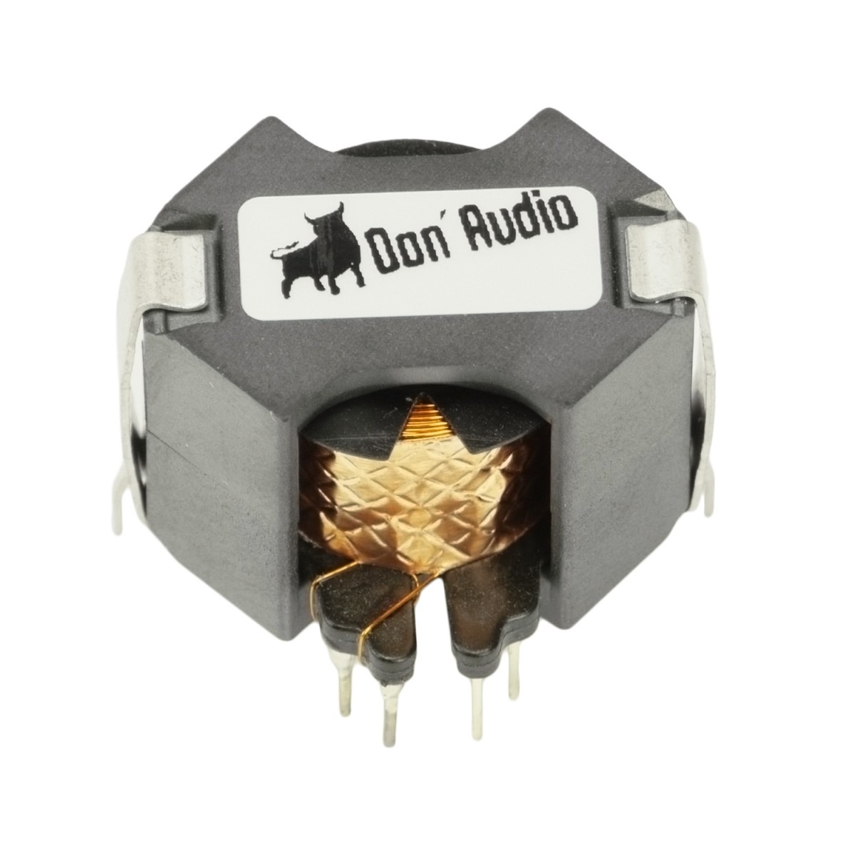

Why are you wanting to shield such an inductor? It already uses an RM core.
For shielding? I don't know. Do you mean that it's unnecessary or it even does more harm than good?
