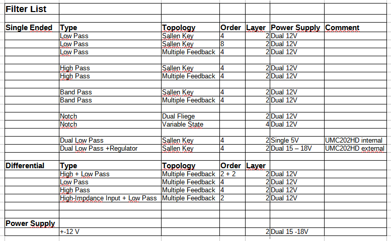

Hi all,
I wrote an article about a Fliege Notch filter for ELEKTOR. (https://www.elektormagazine.com/magazine/elektor-272/60926)
You can download the layout files there.
I also have PCBs for the filter and the power supply.
Please find attached a list of filter PCB I did, in case somebody is interested.
Then I can provide detailed information.
Alfred

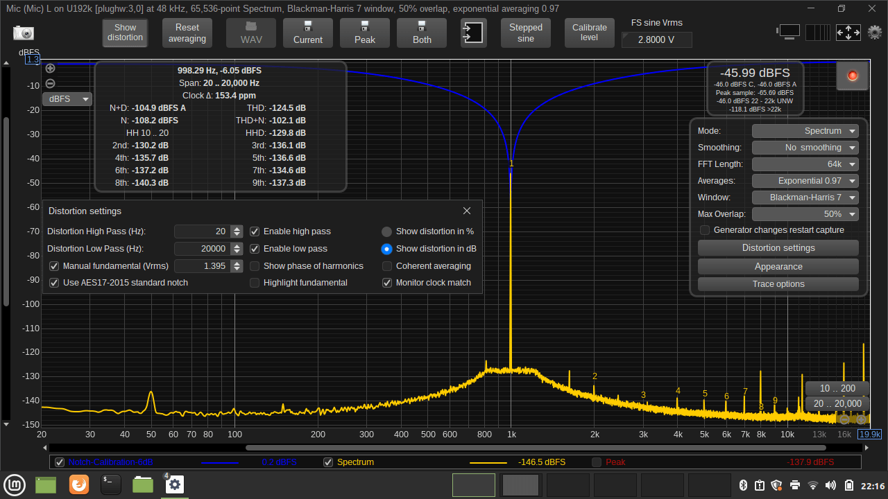

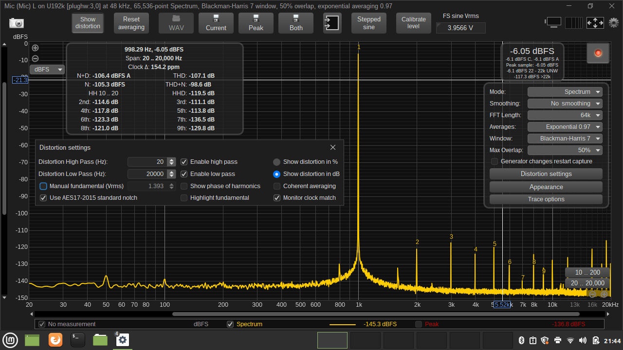

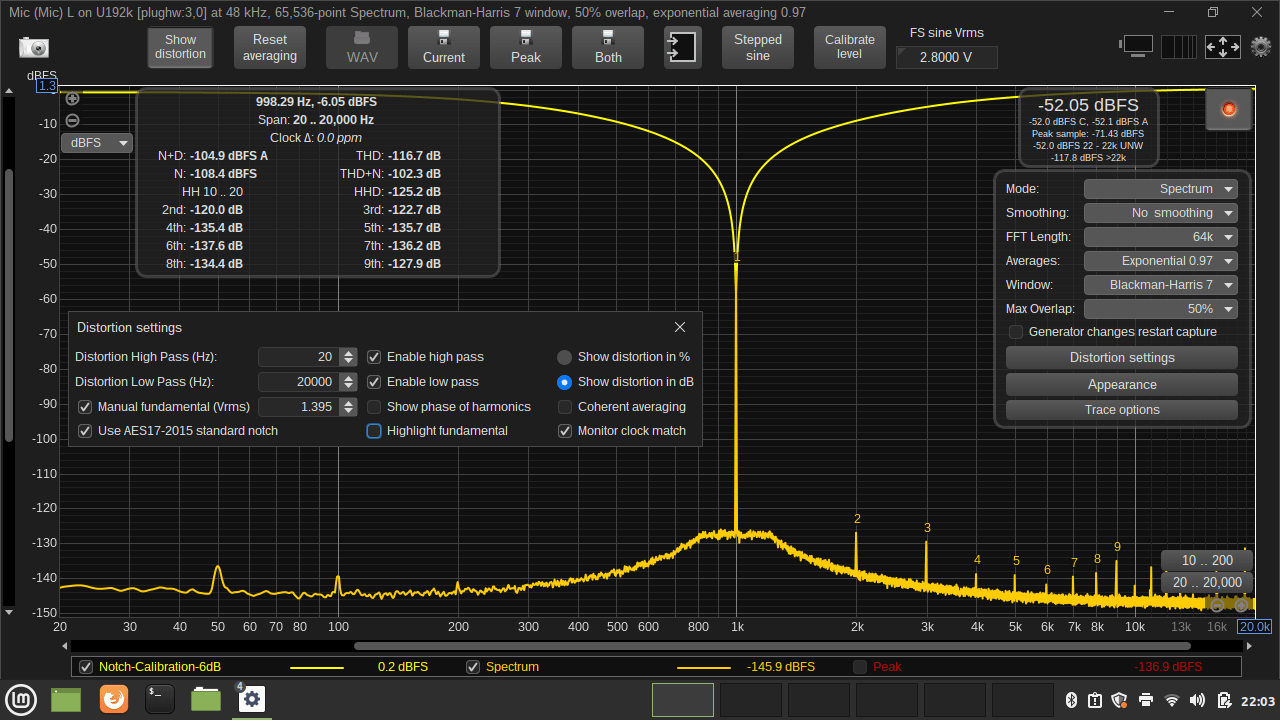

Hi all folks here 🙂
I posted this !here! ... but i have something on my mind, i better ask here that is.
Recently i bought this fine Topping E30II !Topping!, and ofcause i should try to measure it.
I'am wondering why i cannot reach more than MAX -105dB (THD+N / Sinad) with notch, while the Topping should go near -120dB
Someone in the other thread told me that it could be the limit of the codec (mention that i perhaps need ES9822PRO), but i think he could be wrong ? Another one that i can amplifi the signal directly after the passive notch too 🙂
@alfredr was kind and wrote a pedagogical explanation to me some 5 months ago, when i considered building one of his active notch designs.
But duo to component shortage and increased prices, i'am not going to build one at moment.
(Case is also that i can buy one of the Cosmos APU's for nearly the same price, but this is ofcause not that much fun! - and maybee it is, while they offer a kit to adjust the APU by hand by user)
Alfred told me, that by adding some gain in the end of an active notch (could be +20dB), would help bring the harmonics out of the noise. (I understand this)
The +20dB should the be subtracted from the result (this i'am sure could be implemented into the REW calibration file too) .. (This makes perfect sense too for me)
But how would that actually look like in the FFT ?, I mean how would the spectrum look like when adding gain at the end of a notch (active & passive)
I'am sure some of you guy's here can explain it to me ? - Did i get it right, is the modded Behringer up to the task @ > -120dB
Thank's in advance, hoping you all are doing well.
Jesper.
Direct with no passive notch. (I actually reached very near -100dB at some point)
998Hz passive notch with REW calibration file (notch / NOnotch)
(I actually reached -105dB at some point)
I posted the wrong notch screenshoot... here is the right one :

It looks like the 'N' signals that are contributing to a 'poor' THD+N level are actually harmonics above the 9th order, but still within the 20kHz bandwidth you have specified in the Distortion Settings box. You could confirm that by narrowing the bandwidth to say 9.5kHz.
The notched response is now more prone to the non-harmonic signals. Those extraneous signals may be internal to your equipment - have you tried different environments, and quality of interconnectors to clarify the circa 800Hz and 1600Hz signals, as well as different fundamental frequency ?
I could of course be wrong but IME only ES9822PRO has low enough noise and high enough SNR/DR for measuring -120dB THD+N with a notch. Based on your measurements THD+N is dominated by noise.Someone in the other thread told me that it could be the limit of the codec (mention that i perhaps need ES9822PRO), but i think he could be wrong ?
It is true that according to datasheet, the CS4272 cannot do more than -100dB THD-N. Interesting to see that there are ways to expand this. Also interesting this little DAC on its own!
the measurement with a notch (passiv or active) does not help you at THD+N if noise is dominating.
Just at pure THD.
The function of the notch is to prevent the ADC to add its own harmonics since it does not see the signal itself in such a high level.
The noise is amplified by an active notch, since it has its own OpAmps which add their noise too.
In rare cases you might notice that one or the other harmonics is smaller when you measure without the notch.
So the phase of the incoming harmonic is 180° compared to the harmonic generated by the ADC and so the displayed harmonic is reduced.
Alfred
