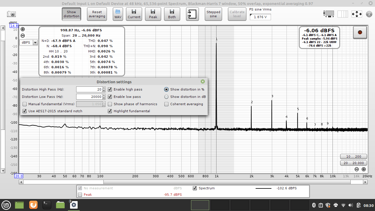

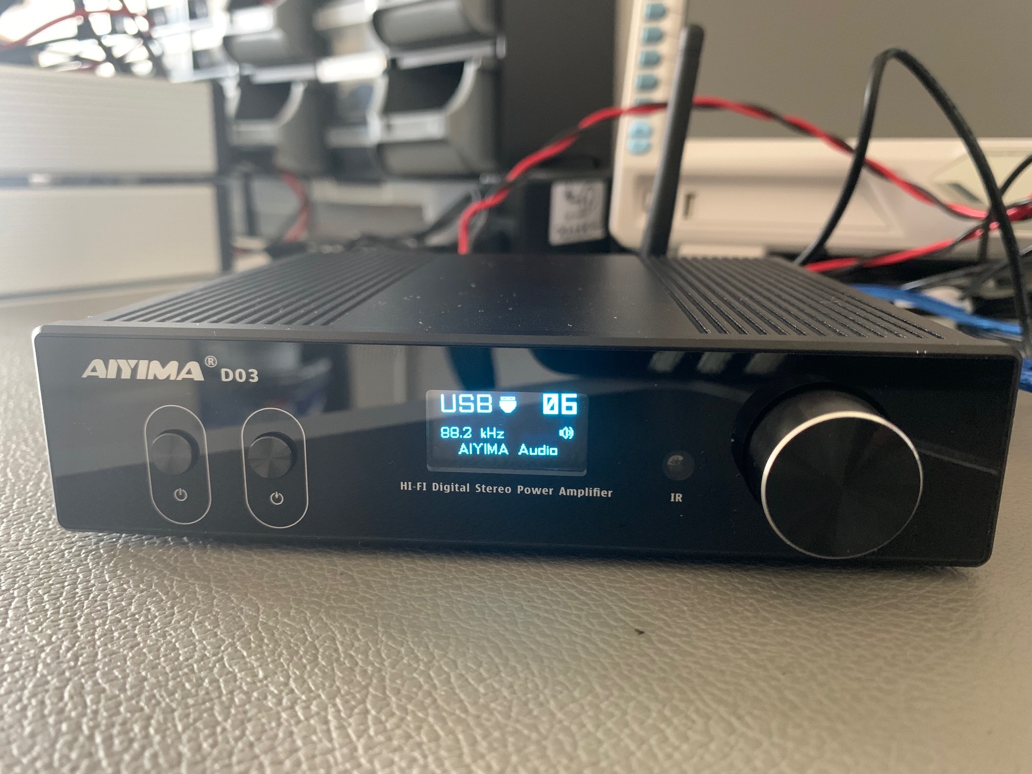

I bought a little Chinese multi-streamer, to be used for folk's streaming also through they're bluetooth....
The Aiyima accept's both USB (24/192), AUX, Bluetooth, COAX & TORX.
Also it's capable of adjusting Bass & Treble (working fine actually)
I'am not very comfortable taking some FFT of it, because
1. I now some class-D don't like wrong load (i used non grounded 8ohm power resistor's on both channels when i did the FFT)
2. I don't have a lowpass filter to attach between the Aiyima and the Behringer.
3. It's hard to track down howto excatly test thoose machines.
There is a slight hiss when holding ear on speakers, the hiss is not affected by volume... Really it's very fine... very very low hiss, but i think's this it was making the noisefloor climbing up to near -100dB ?
The thing is playing nicely, and i had it on for +24hour's now to really test it out.
FFT is ~1vac / Loaded on 8ohm powerresistor's / 1kHz, ~1vac Sine output (Victor's)
As i wrote before, i'am not comfortable doing the FFT on it, as i don't know enough of the Class-D machines
