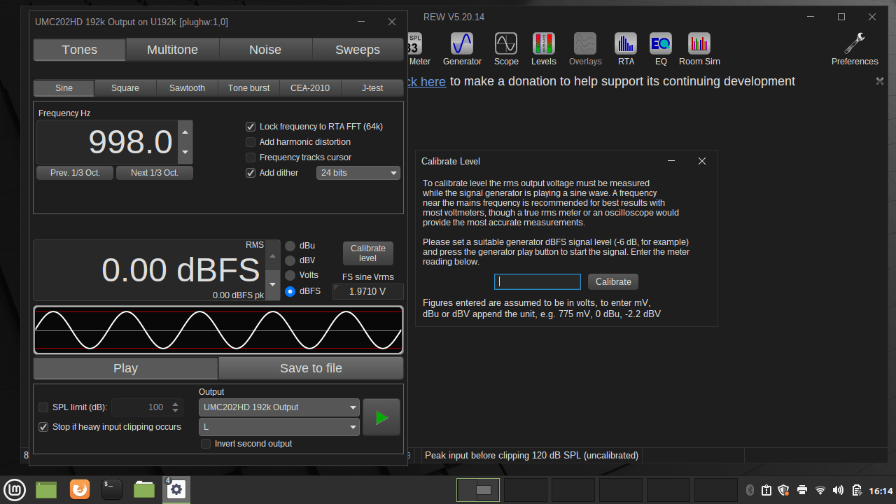

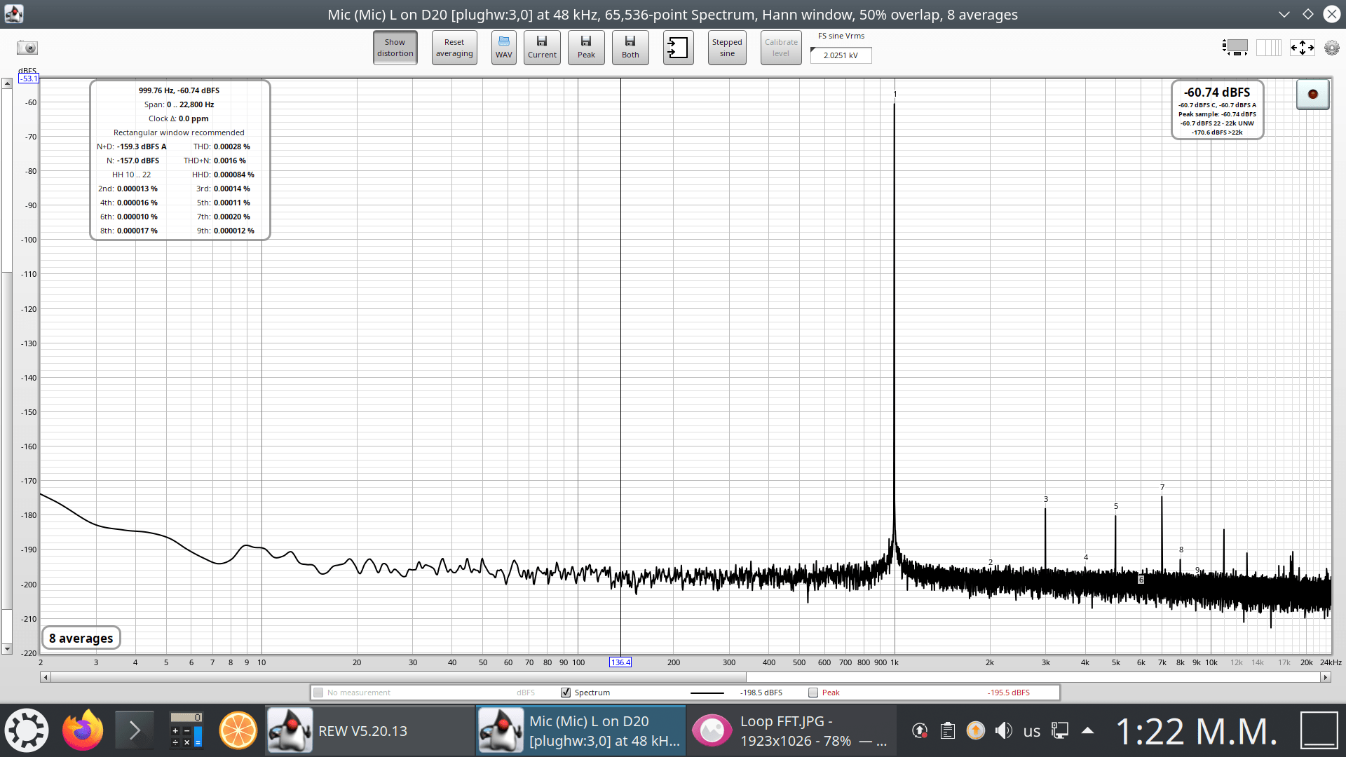

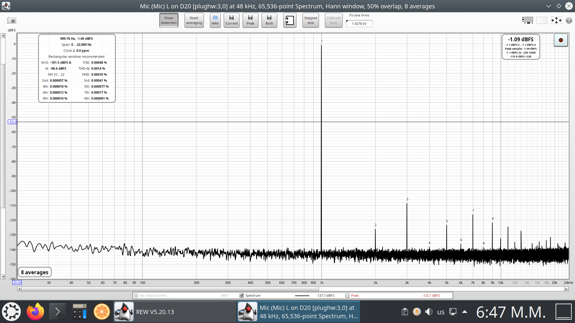

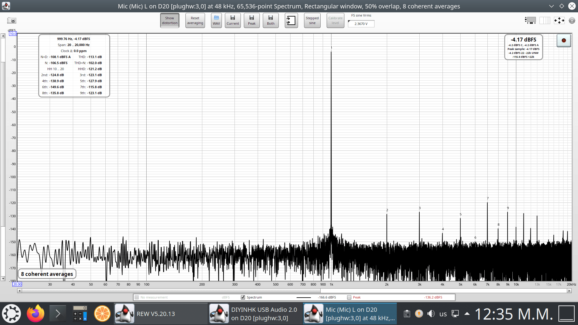

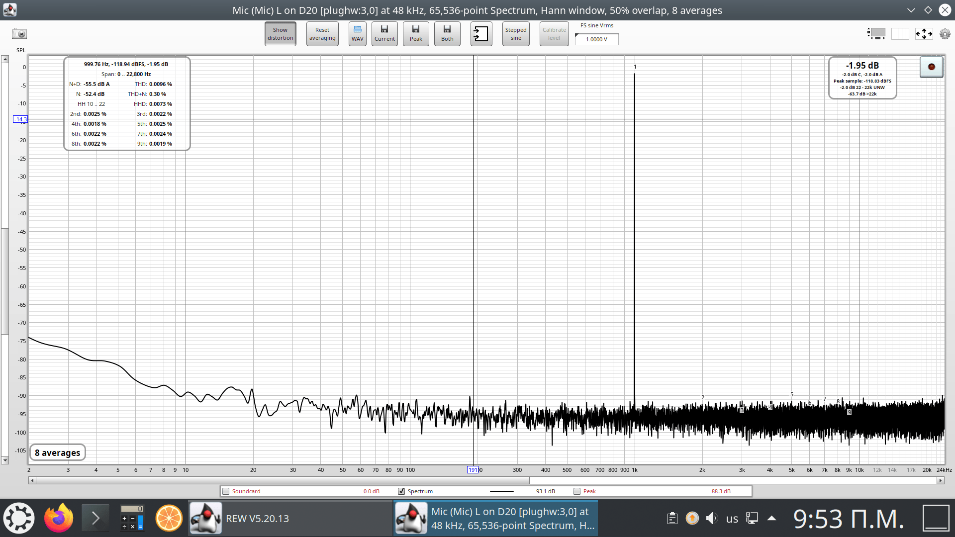

OK! First time I feel I have proper control on REW! Calibration was easy. I remind you that this is my diy soundcard but it shares the same audio codec and the front end that Jesper transplanted to his Behringer, so I think it's comparable. Everything works, however there is something to resolve. For some reason, it seems REW handles my soundcard as a 16 bit device or something like that, I don't know how to fix it.
Edit: Perhaps it's not the bit depth. It seems to exceed 0dB without clipping so problem with scale?

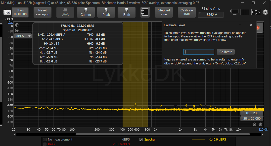

You can calibrate both generator output and RTA input.
If you calibrate both, you can actually use the RTA as a voltmeter
(Actually @Salas teached me this)

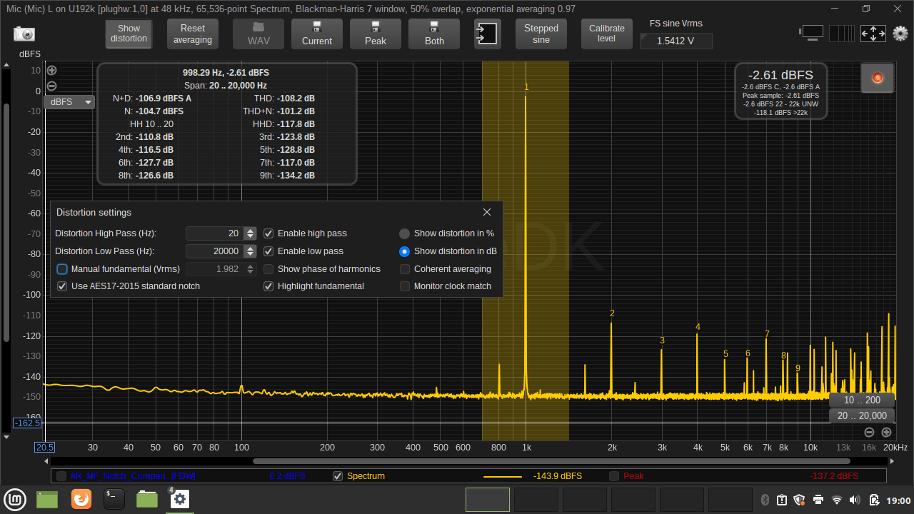

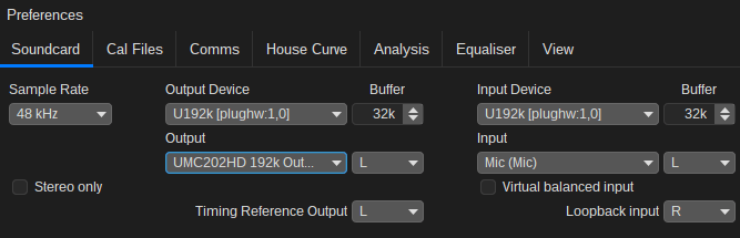

Regarding input/output bits. If i choose the Behringer as both in/out I have 32bit in/out
If I e.g. choose default in/out, I only have 16bit in/out, so REW knows about the soundcard.
You can also see howto use AES17 "notch"
Please see attached pictures for better explanation.
Jesper.

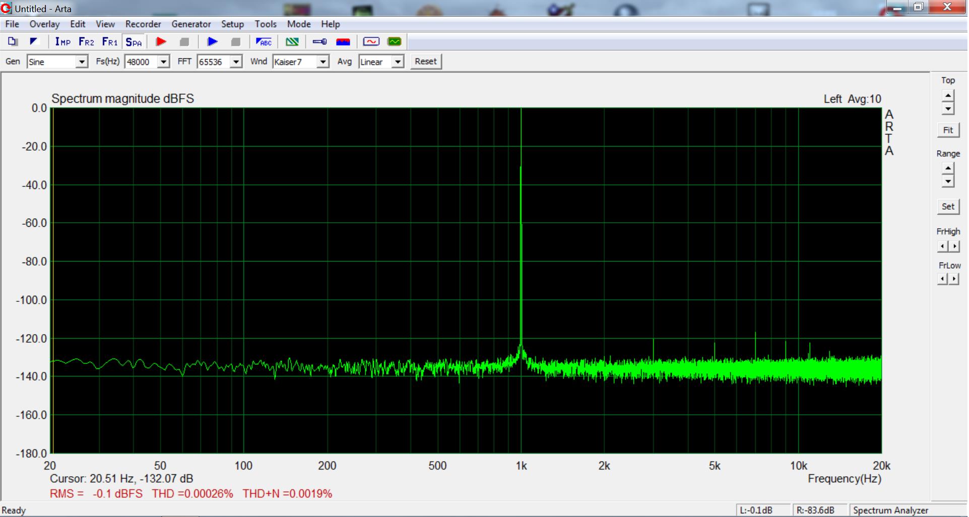

Suddenly it decided to fix everything on its own. And this is with both input and output manual volume controls full open. With ARTA I had to keep one of them a bit down. Settings refinement will follow but it's already usable.

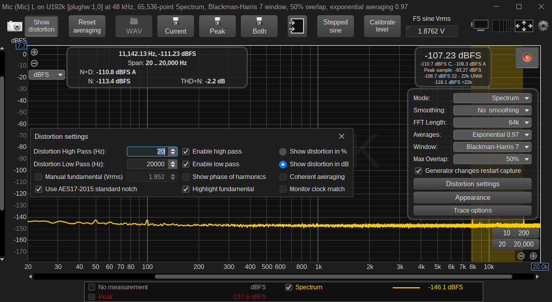

BTW, make sure you set FFT length at least at 64k and enable coherent averaging. It makes significant difference.

I suddenly remembered, or more like the opposite, that I did not post here my finding's with my Cosmos APU notch when I discovered the correct way of taking the sweep's to have a more precise measurement of the notch and so on...
Anybody find the use of a notch with REW interessting, should take a look here :
https://www.avnirvana.com/threads/m...notch-cannot-measure-the-correct-depth.11825/
(Thread is not only about the Cosmos APU, also with some experimentation I have)

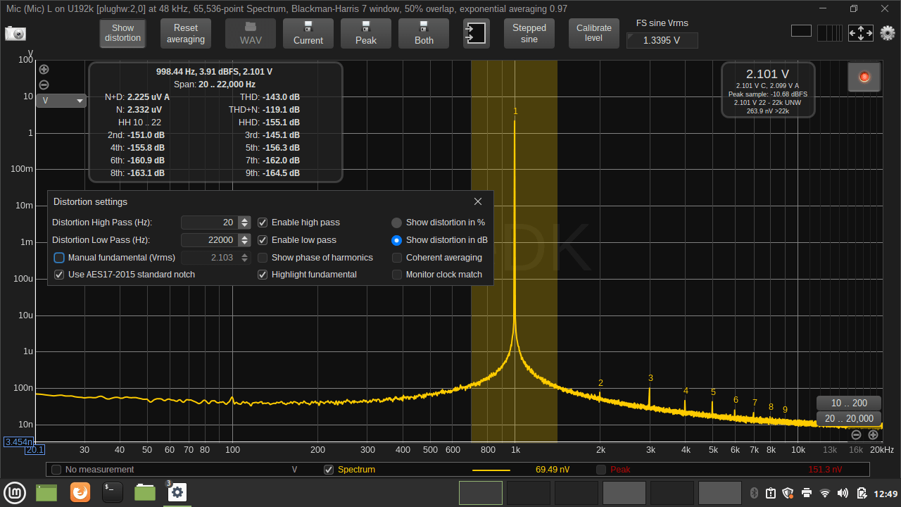

John is helping me out (again) to fully understand the use of a notch filter.
I have seen Archimago taking measurement's with his Victor's osc. to reach -150dB
I can reach -143dB with my hacked Behringer (@MagicBus balanced board)
Not that I really need this, it's just for the sport of it, nothing else... Think i reached the limit here...
Please note, that it's actually not necessary to "check" the manual fundamental, as long as you keep the system calibrated.
Looking at the picture show's that I unchecked this box, and having the same value's.
Jesper.

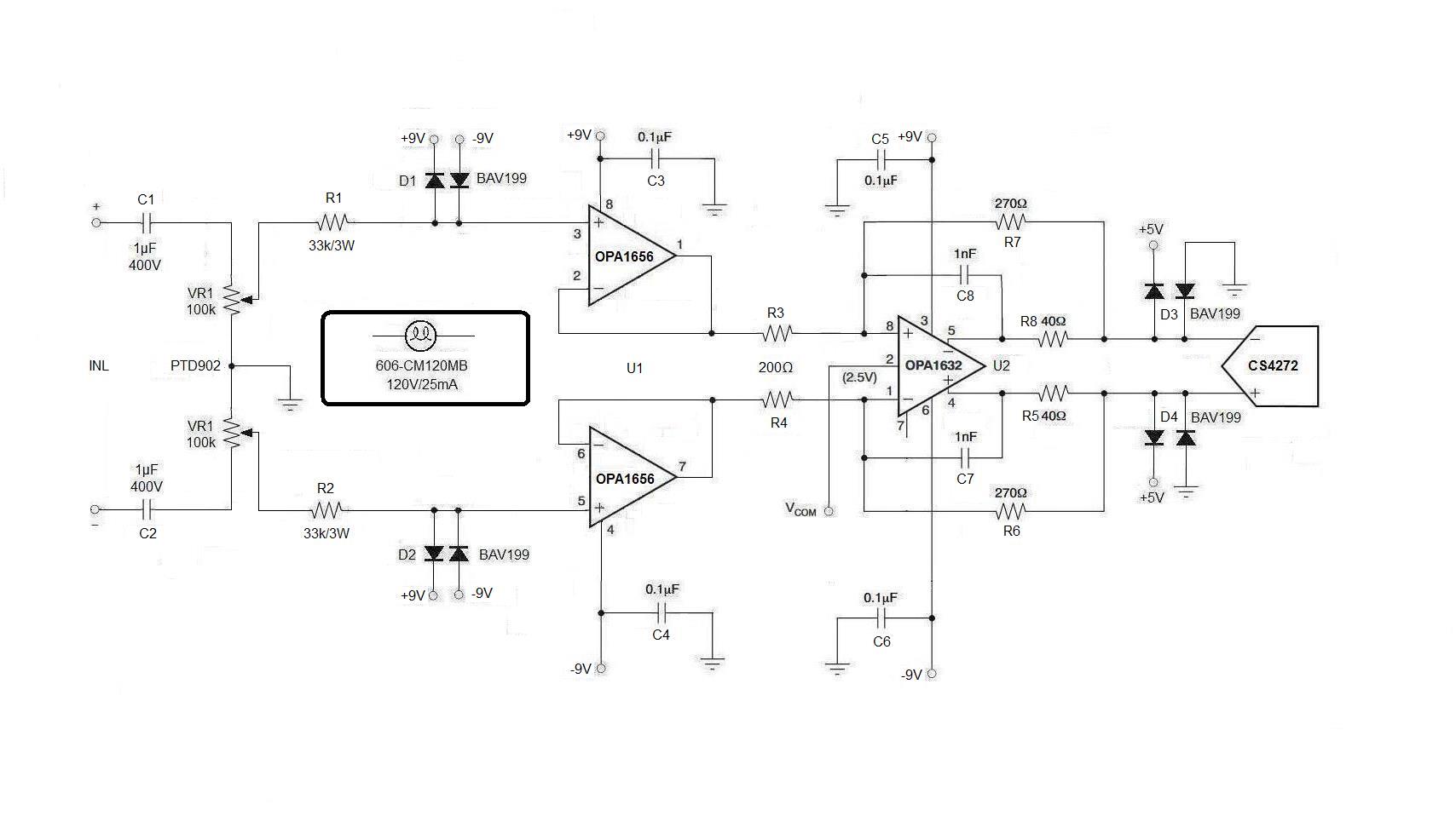

Attached schematic and input impedance specs. of the OPA1656

OPA1632 alone was giving really impressive screenshots but useless because of its lowish Zin. OPA1656 was added for its high Zin. And still good THD+N. That makes the total Zin of the buffer essentially the pot's resistance, 100k per side. And if I'm not missing something, if you keep it floating it should be 100k*2. High so to speak and it will reveal any weak points of the interconnects used. But I can see you are doing well!

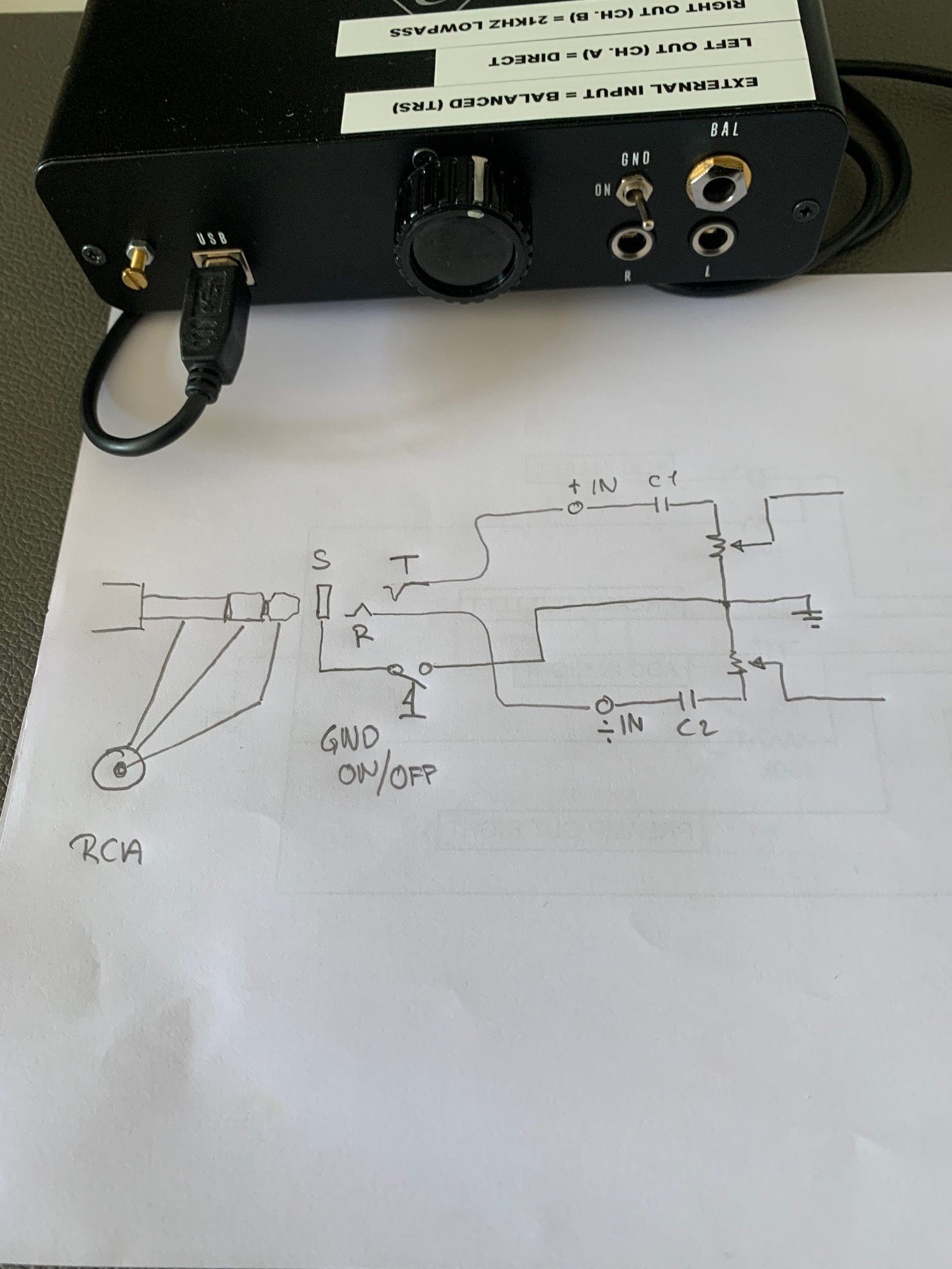

Long ago I tested the connections a lot, and I found out that connecting RCA shield to both S and R on Behringer input gives best results.
I installed a little switch which cut's the GND from the female TRS jack inside the Behringer.
When I set GND to OFF, the input will be "floating"
My Topping test dac (E30II) likes when I cut the GND OFF, It have some spurs/grass around the 998Hz fundamental. Them spurs dissapear when GND is disconnected
The switch is nice to have, as I don't have to fiddle with the jack's connection then.

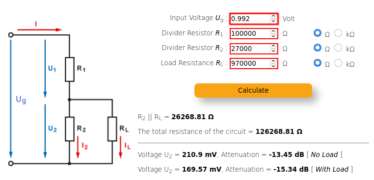

Well reason I asked about the Zin is that I would like to try using some voltage divider's for some testing.
I will try to calculate them, for having 1V input at different levels, just like an autoranger do.
I will see if I get better or worse measurement's this way?
When doing this I will leave the 100K pot at max input (no resistance)
http://www.mh-audio.nl/Calculators/VD.html

Normally, this ground switch should be left permanently off no matter if the DUT is SE or balanced. If you feel like experimentizing you could make an interconnect with a twisted pair plus shield -XLR cable. Hot to tip, cold to ring and shield to sleeve. At the RCA side only hot and cold connected.

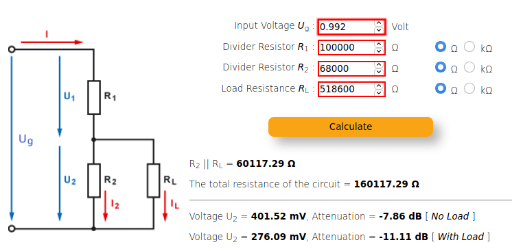

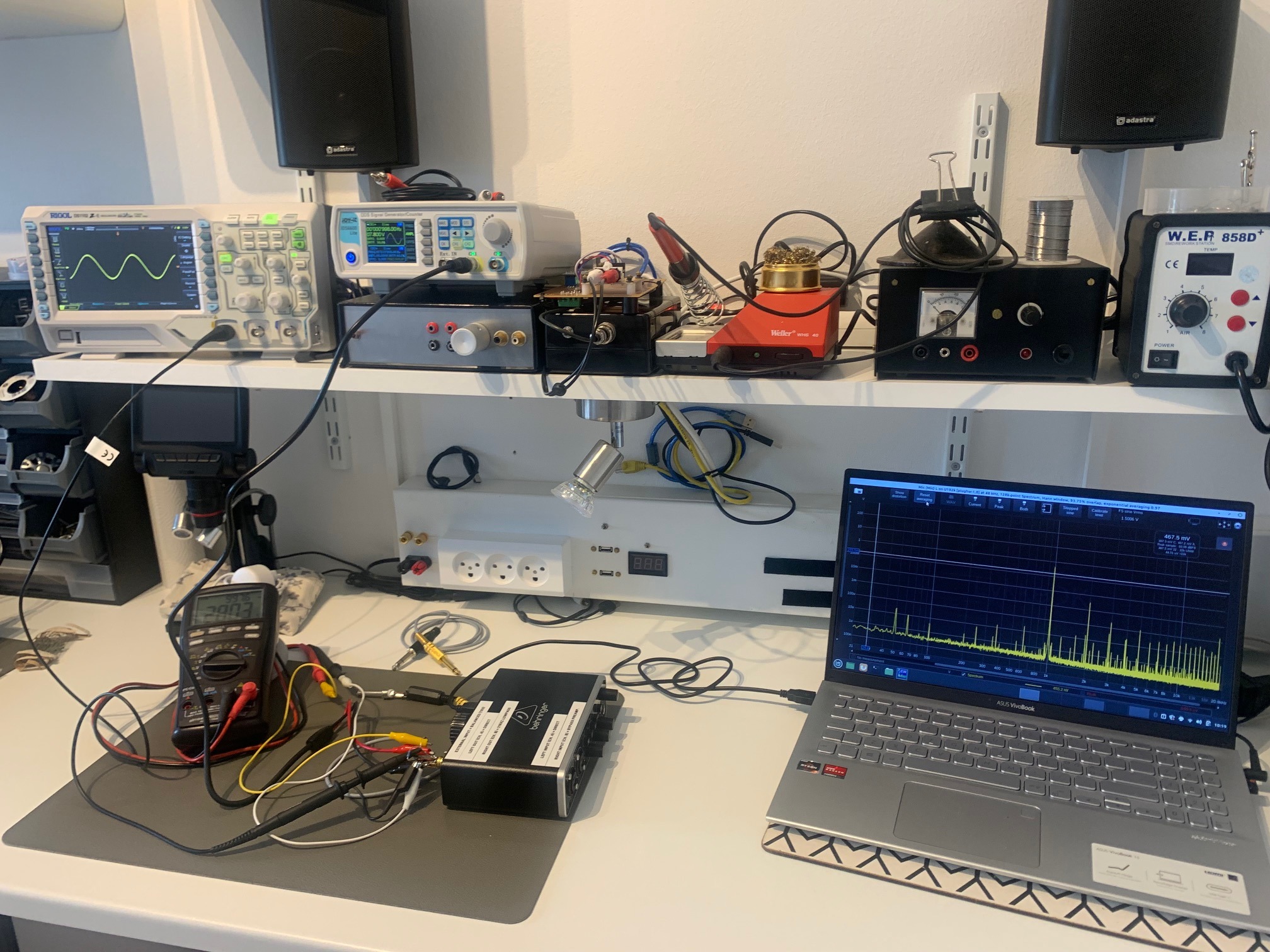

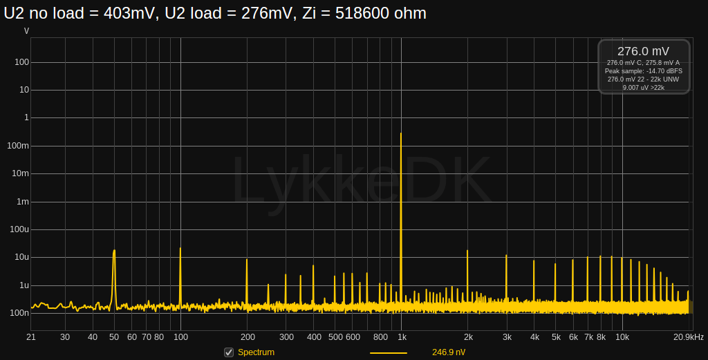

You guy's mervelous to know

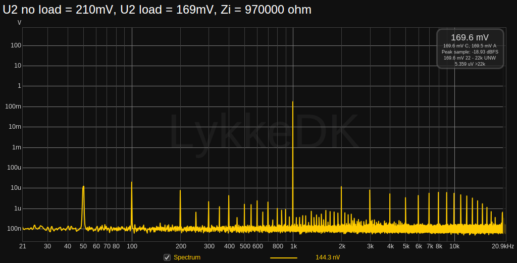

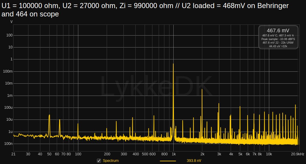

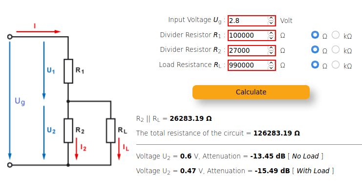

I tried to "BackCalculate", using this site as before as a' ref. http://www.mh-audio.nl/Calculators/VD.html
Everything verified with scope & DMM etc.. both with and without inserted (loaded) into the Behringer.
Voltages seem's to match very closely to the calculator.
I'am not sure, it can be BackCalculated like this, but I have no other possibilities to check the impedance of the Behringer.
Please take a look at my finding's...
Jesper.
100000 / 68000 ohm divider / Zi ~ 518600 ohm (100K/68K / Zi:518.6K)
100000 / 27000 ohm divider / Zi ~ 970000 ohm (100K/27K / Zi:970K)
100000 / 68000 ohm divider / Zi ~ 990000 ohm (100K/68K / Zi:990K)
Jesper.
