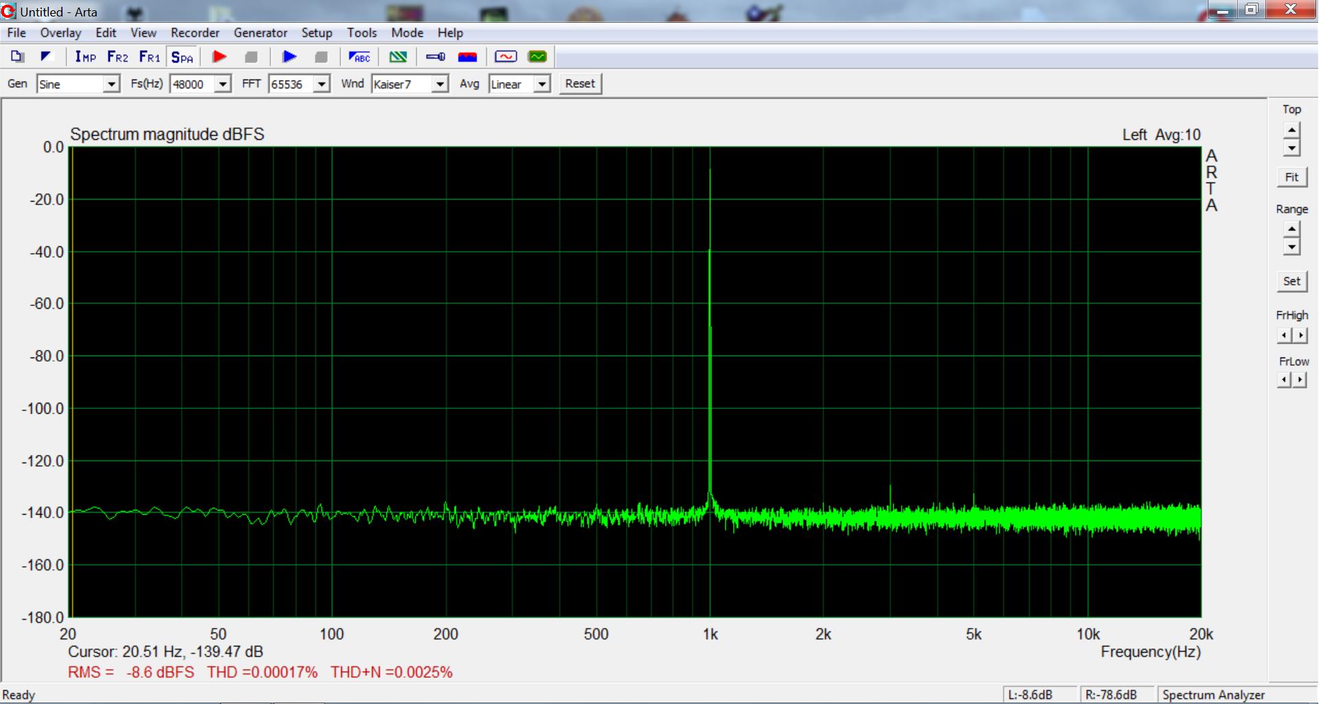

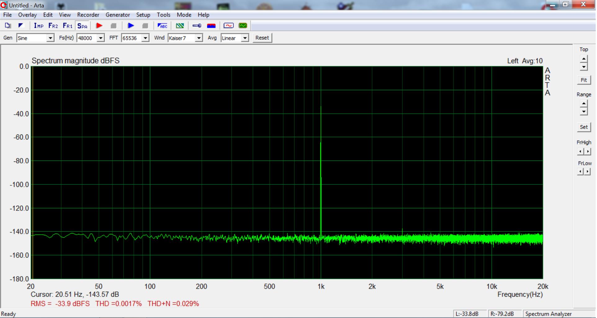

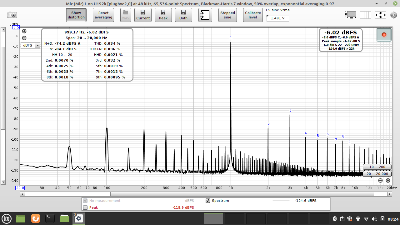

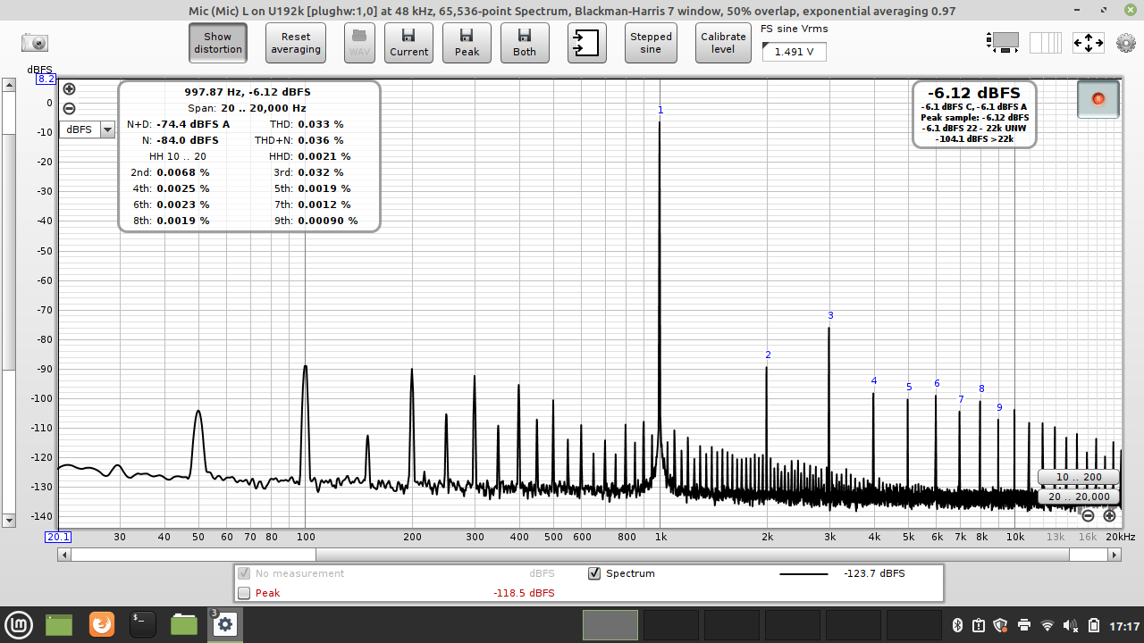

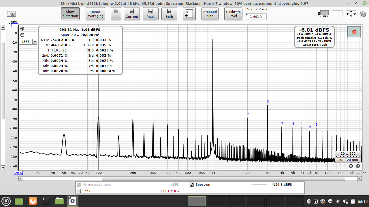

Well i ran some test with my LM4780 Cloneamp.
The switcher (Lenovo USB charger) wins by as little difference as can be seen.
Pictures speak for themself 🙂
Test setup:
All setup's with Victors 1KHz at 1.055V
Shown here is with Cloneamp. loaded with 8ohm and sending out 1v
(I took at different voltages(0.5v, 0.75v, 1v and 2.8v - with simulair result's, e.g no difference with different's PSU)
I still need to test with the direct in mod @YashN, but i belive it will be alike, but let's see when i have it done.
(PC ---> Behringer)
(PC ---> SWITCHER+PSU/USB-splitter-box ---> Behringer)
(PC ---> LINEAR5.2vdc+PSU/USB-splitter-box ---> Behringer)
As last time, i also tested the same 3 setup's with the USB isolator attached in the chain. (PC ---> USBIsolator ---> PSU/USB-splitter-box ---> Behringer)
No difference when in use through.

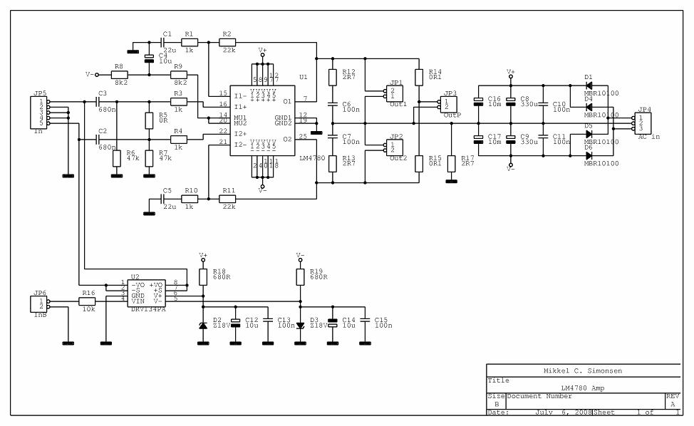

EDIT :: Attached schm. of amp.

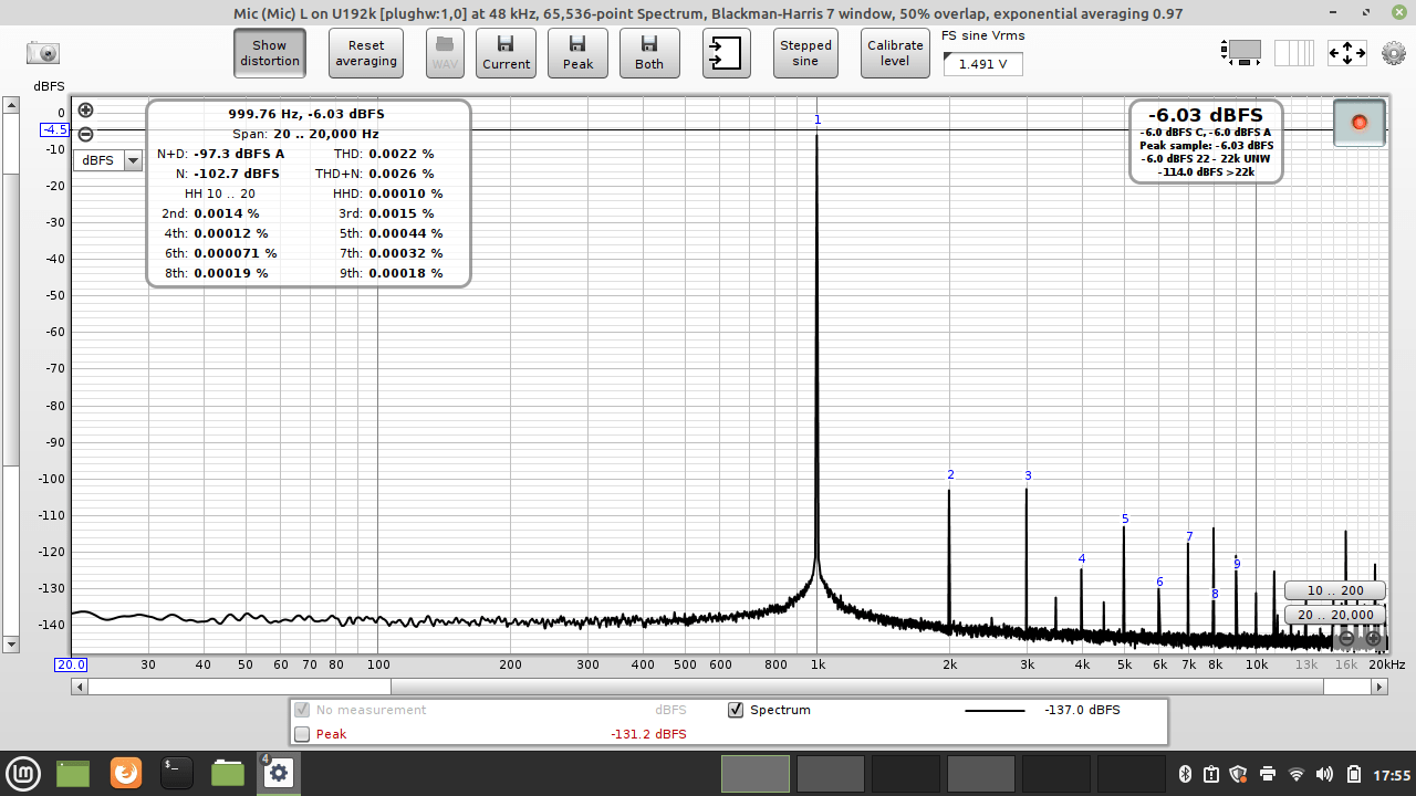

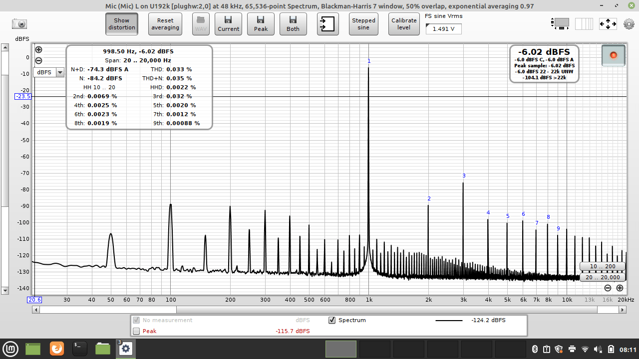

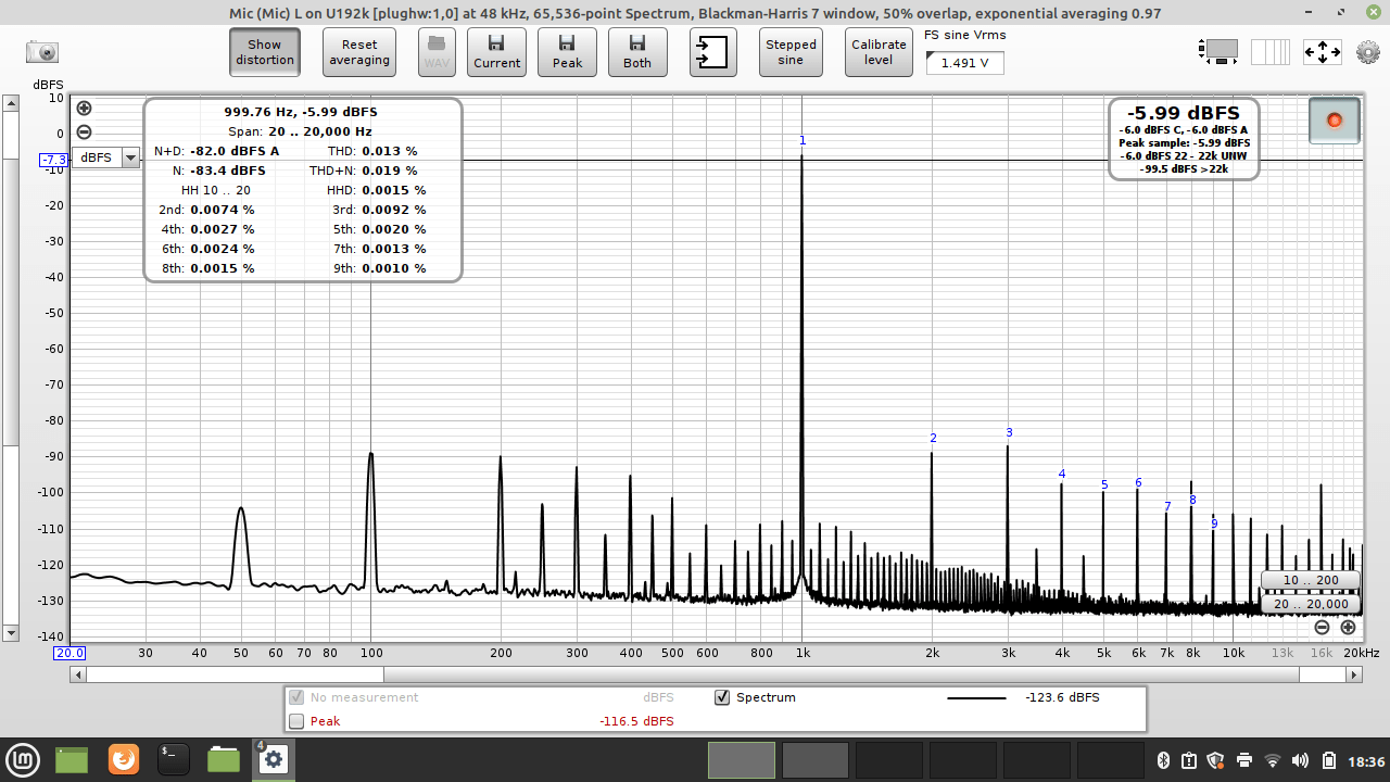

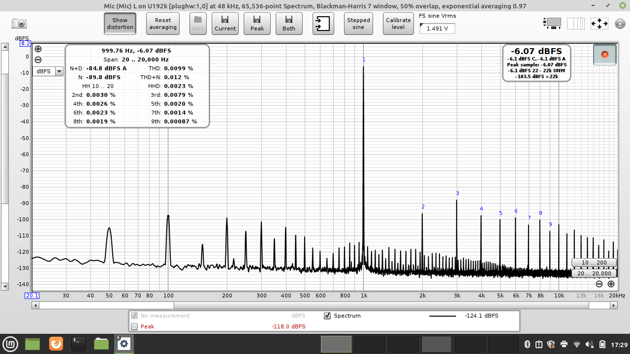

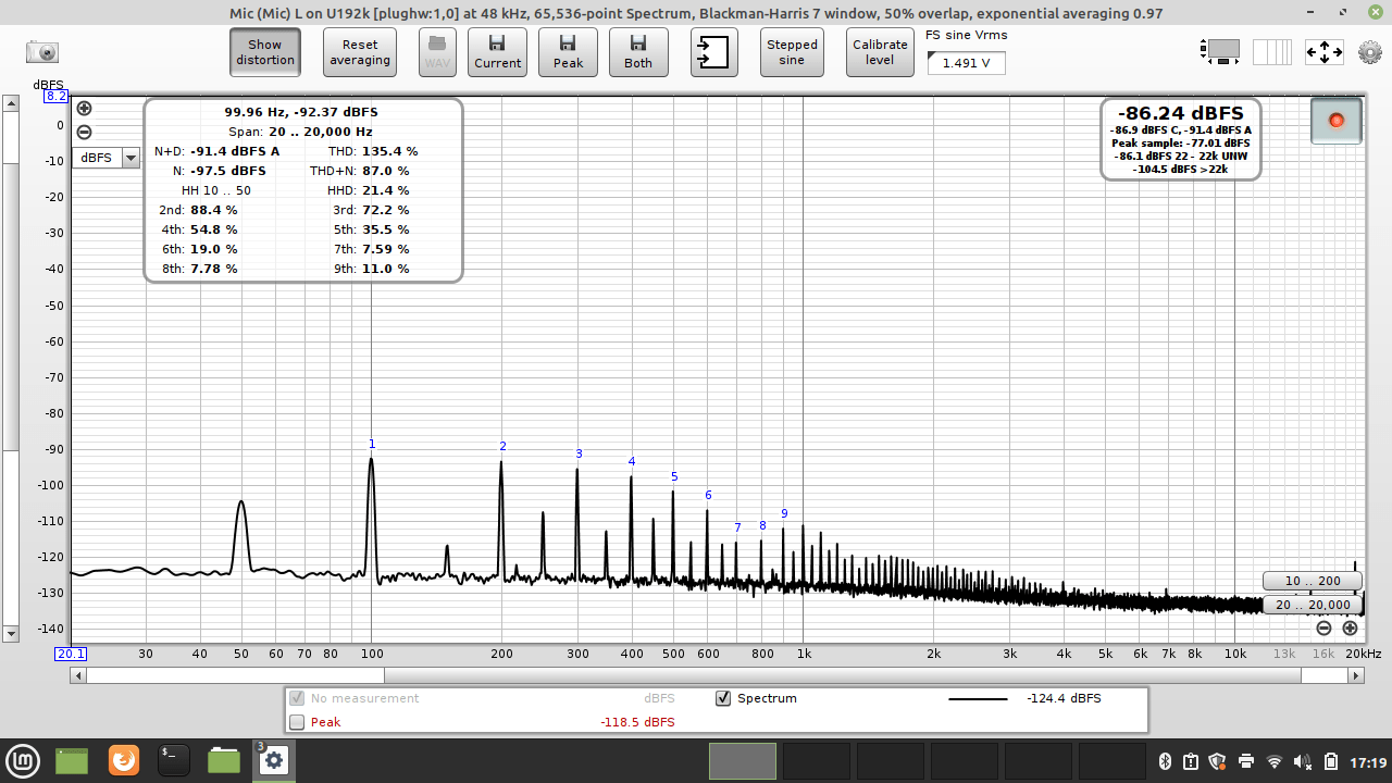

I did some more testing today.
* Trying to get rid of the 100Hz + friends.
First my CloneAmp. with Victors, second with internal generator, then with my Amanero USB & a cheap Chinese DAC (Good enough i can see 😎)
And Cloneamp. with no source connected (100Hz is there)
Pictures speak for themself.
Tried with GND comnection "lift", this was only resulting in higher 50Hz.
So i'am 99% sure that the 100Hz is comming from the Cloneamp. itself.

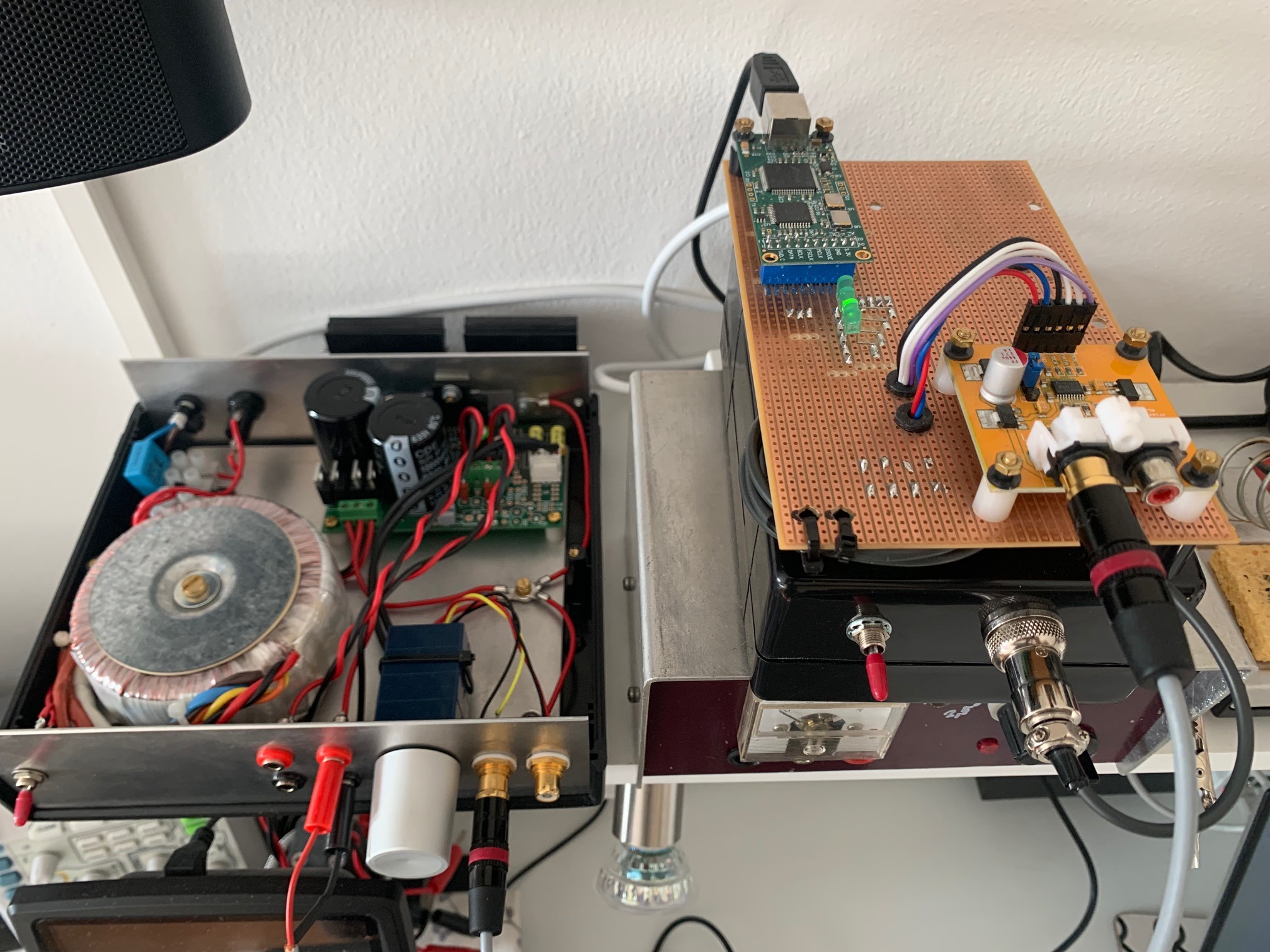

The Amanero + DAC is feed with one of DimDim's PSU he made for some RPI's.
This psu is also with both transformer & diodes + regulator ofcause.

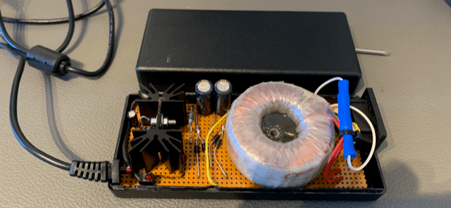

@MagicBus, the psu for the Victor's is a homemade LM317 +35vdc with transformer & diodes inside.
@trobbins I did some "short" test's with aluminium tray's, but having none effect.
It's really surprising to see how good this little DAC is 🙂
Jesper.

Hey...
I just tried removing the transformer (which i also did last week, when changing the grounding of this amp.) 30cm. away from the chassis.
The 100Hz spike is excatly the same.
It's proberly just as it is? - Will think again, maybe i will eventuelly cure it ? 🙂

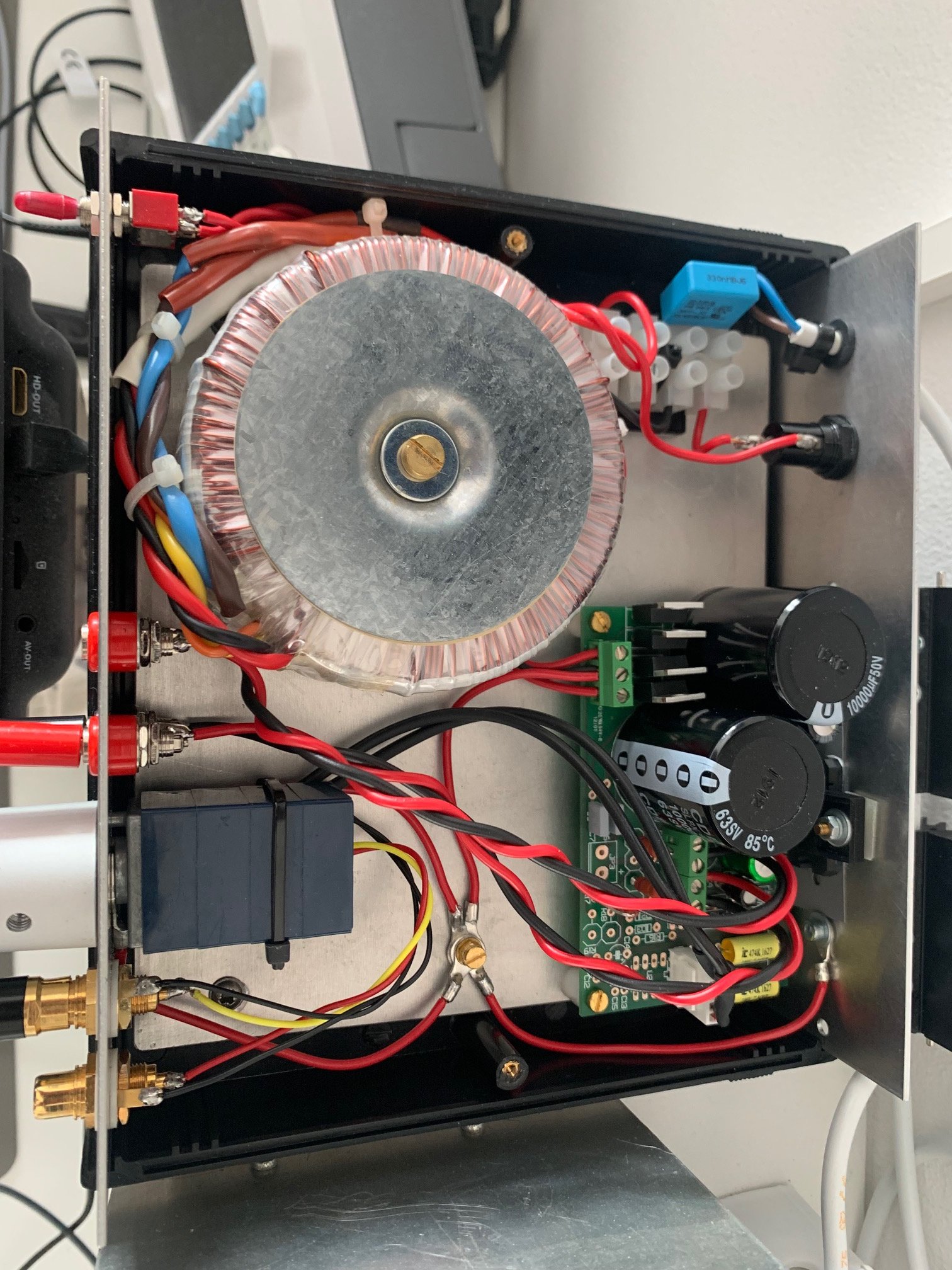

Second try... The ground star has four wires. One from front panel/pot body, one from rear panel, one from transformer center tap and one from underneath the pot -input ground(?) Try to lift the transformer center tap.

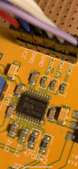

PCM5102 or something like that?

The little DAC is for sure 5102... Your'e eyes are good @YashN 🙂
Yesterday, i took out the pcb, containing the clone, to measure if something was wrong with the diodes or like.
With my scope i could see, that everything was as it should be.
The diodes are MBR10100 Link! , and schottky and besides that it's not needed for the slow 50Hz, the voltagedrop on them are lower than normal 4007 one's.
I'am tempted to change them to normal diodes, eventhrough i know it proberly don't will change anything.
So regarding the star-gnd connection i did, i allready tried combination's of different wireing, i also tried disconnecting the psu CT from the gnd, with no change.
The changes in the 50Hz droppet to half, when i connected the frontplate + potmeter + backplate together. - There was never any change in the 100Hz spike.
On to thinking again! 🙂
Jesper.

Jesper, your clone amp appears to use the same screw terminal for both the transformer secondary CT and the link to chassis ground - is that correct? Does the signal input ground itself at the input socket, or via the pcb to that power supply screw terminal ? The speaker outputs appear to be connected to ground through the pcb somehow. Is there a link to that pcb to show its trace outline?
