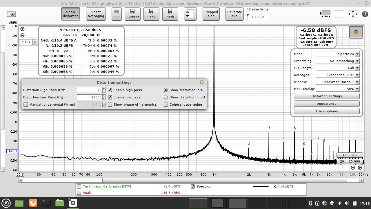

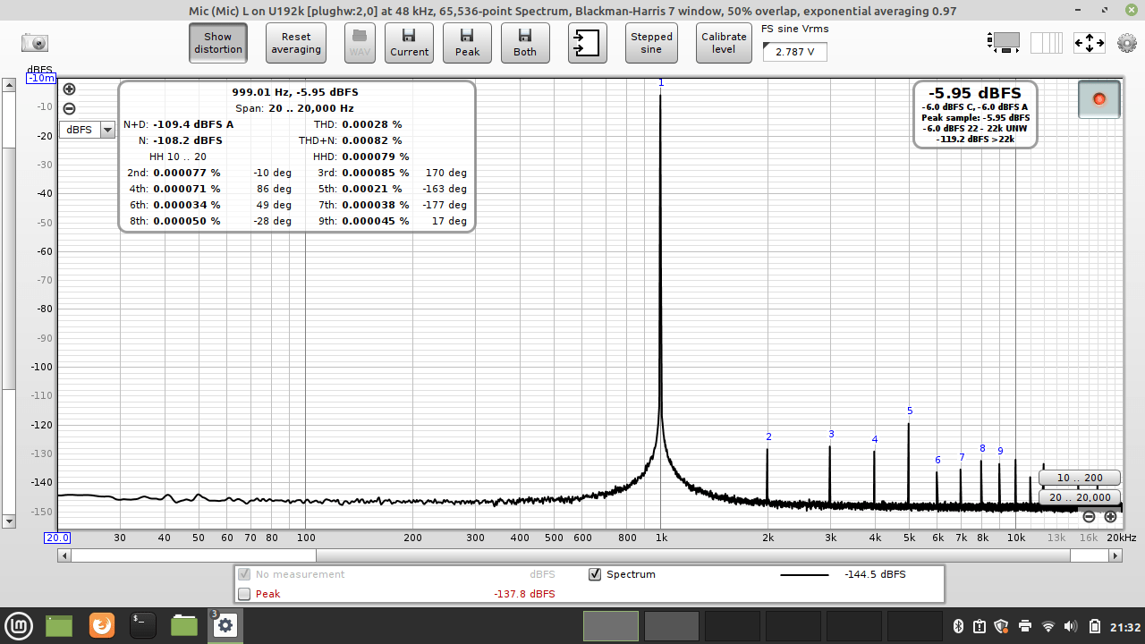

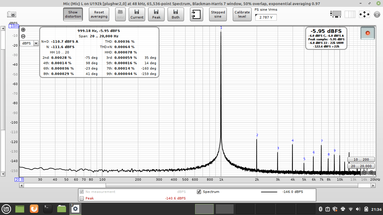

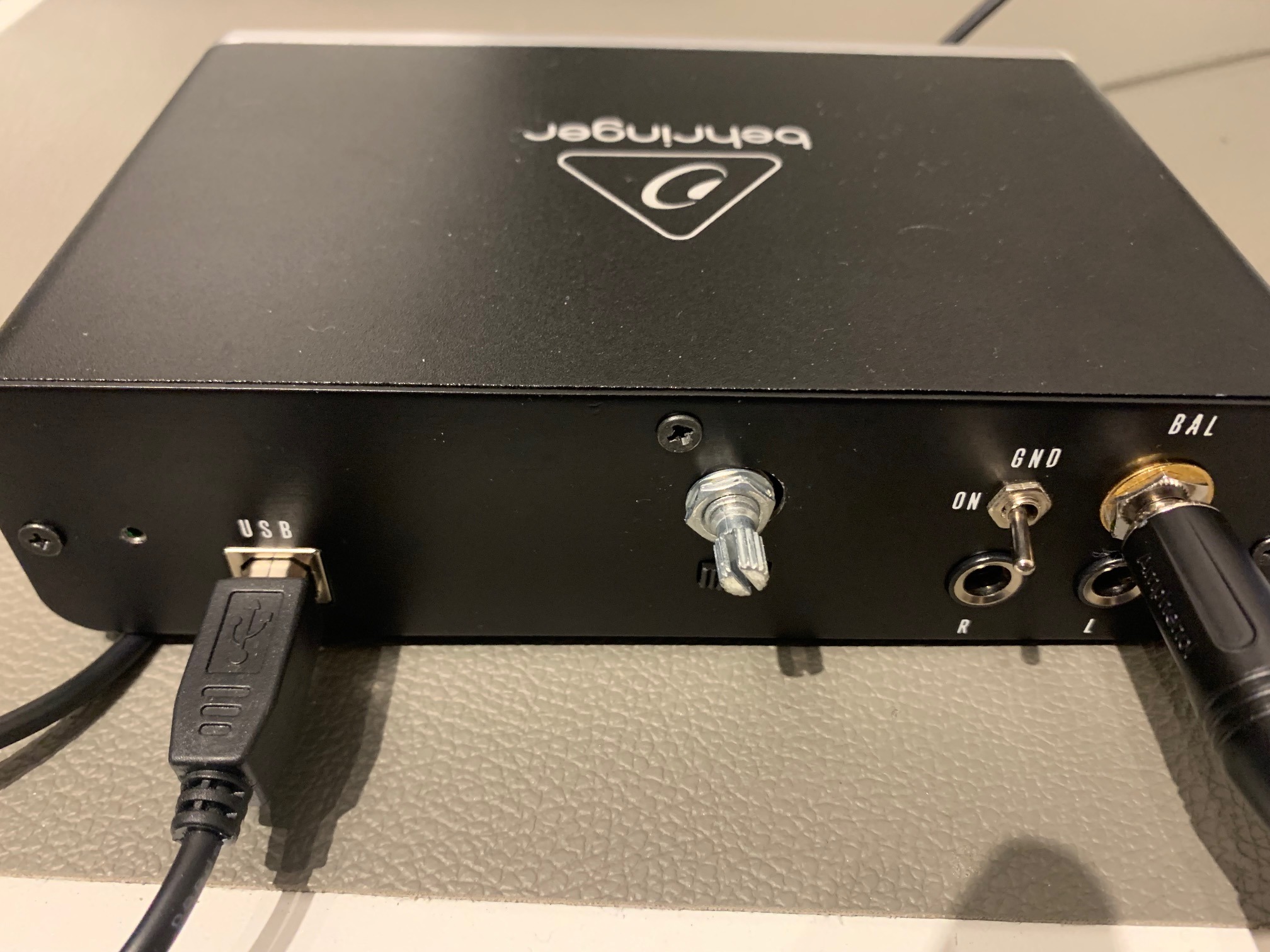

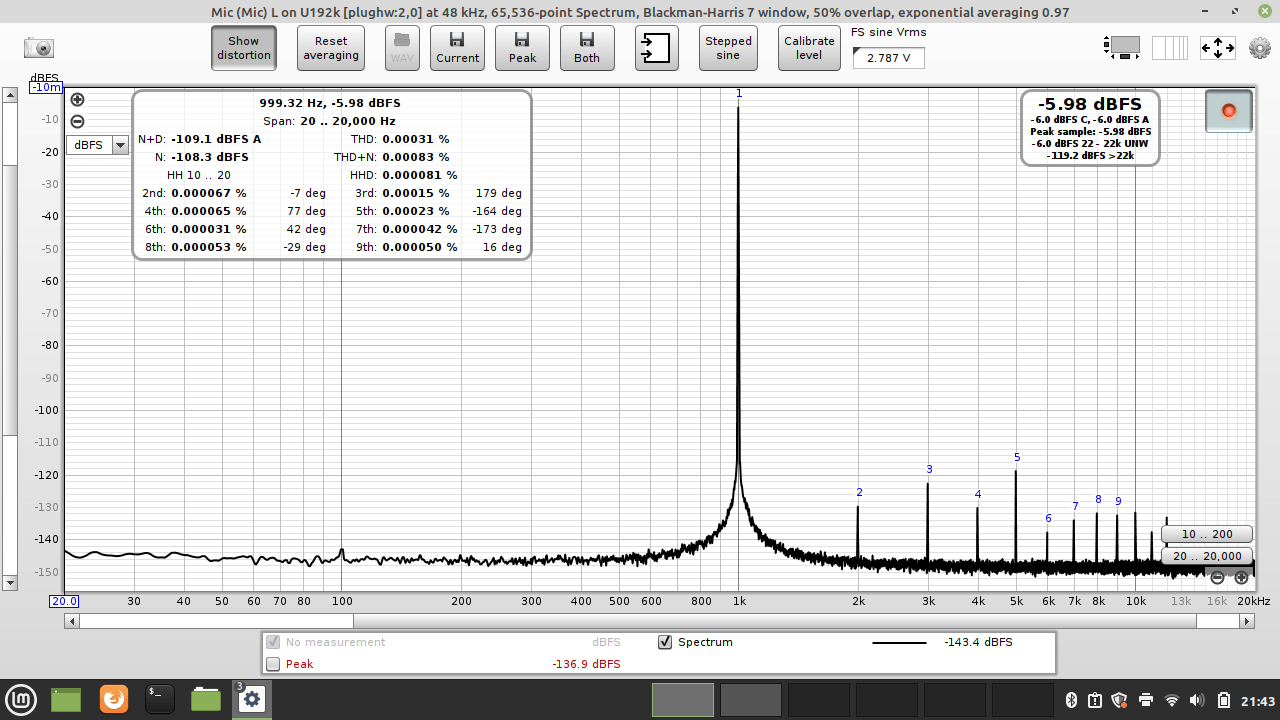

Finally i did test all of them options.
I tried both plain usb cable directly from PC to Behringer, with the splitterbox and an good 5v switcher and finally with a highquality linear supply (dual lt3042)
I tried both with and without the USB isolator.
First off, the USB isolator don't do any difference in my setup, but again could be handy if i ever need to power a unit (DUT) with the PC usb supply? (Groundloop?!)
As Jan told some weeks ago, he did raise the voltage for the codec inside the Behringer with better thd figures.
I also tried this now, and verified with Behringer running some loopback at full scale, that the voltage was stable, which it was.
I did set the voltage to 4.89vdc (originally at 4.5vdc), but stranger things is that the thd figures raises when i do this, nomatter what i do it is worse than the stock setting at 4.5vdc. I'am sure i did it right.
For me, i think i reached the limit of my Behringer-mod, i tried a lot now so i can sleep better, knowing that i tried 😉
Anyway i end up with, just using a plain USB cable is very close to best option.

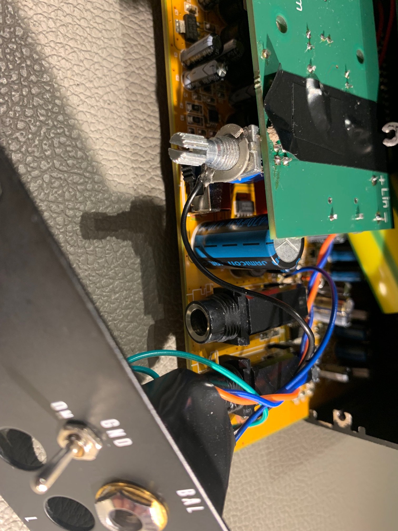

One thing i did was when i had the Behringer opened up several times is discovering that when touching the input level controller, the Behringer responded with noise and spikes and stuff, not much but i found a solution. I cured this by connecting the pot directly to GND, like when making preamp's and stuff.
Jesper.
Attached loopbacks with different supply's, stock codec voltage at 4.5vdc on all. - Source Victor's 1KHZ osc.

Well done, quite thorough.
Is there a Battery test somewhere? You could even try various types of batteries.
Now you can do the same tests but with your amp within the chain. Results can be quite surprising here too.
Not sure about the actual cause of the even order harmonics but rectifying diodes would contribute harmonics for sure. Here, for powering musical gear, I'd prefer having even order over odd order.

I also wonder why even harmonics are higher, using a linear reg. - But i do belive it's the toroid transformer i use.
Well... I also tried my USB batterypack, with and without the USB-isolator, no change.
I think now, that the Behringer is to prone (thanks to the balanced board and some of the GND-fix i did) to have any use of the isolator.

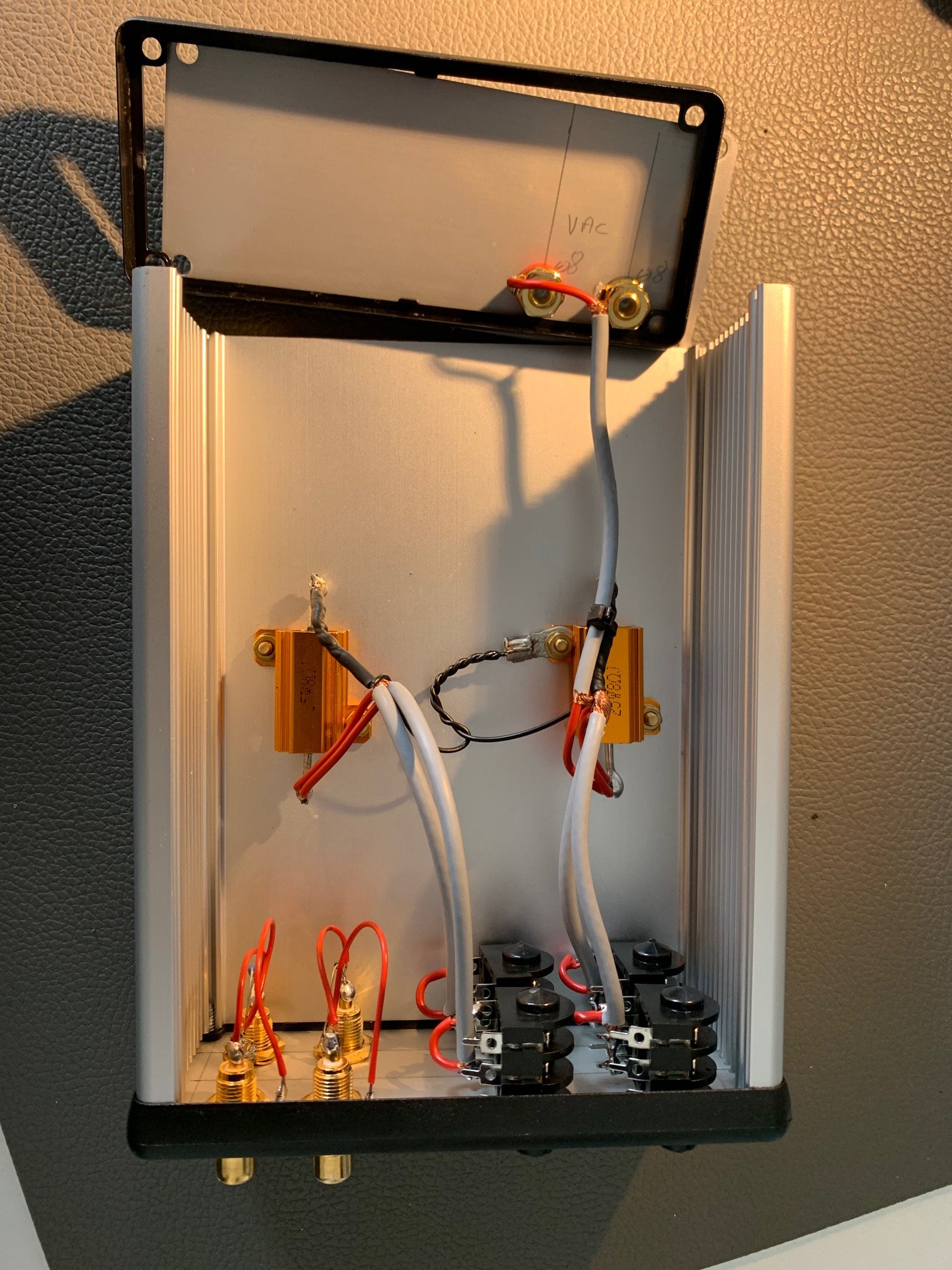

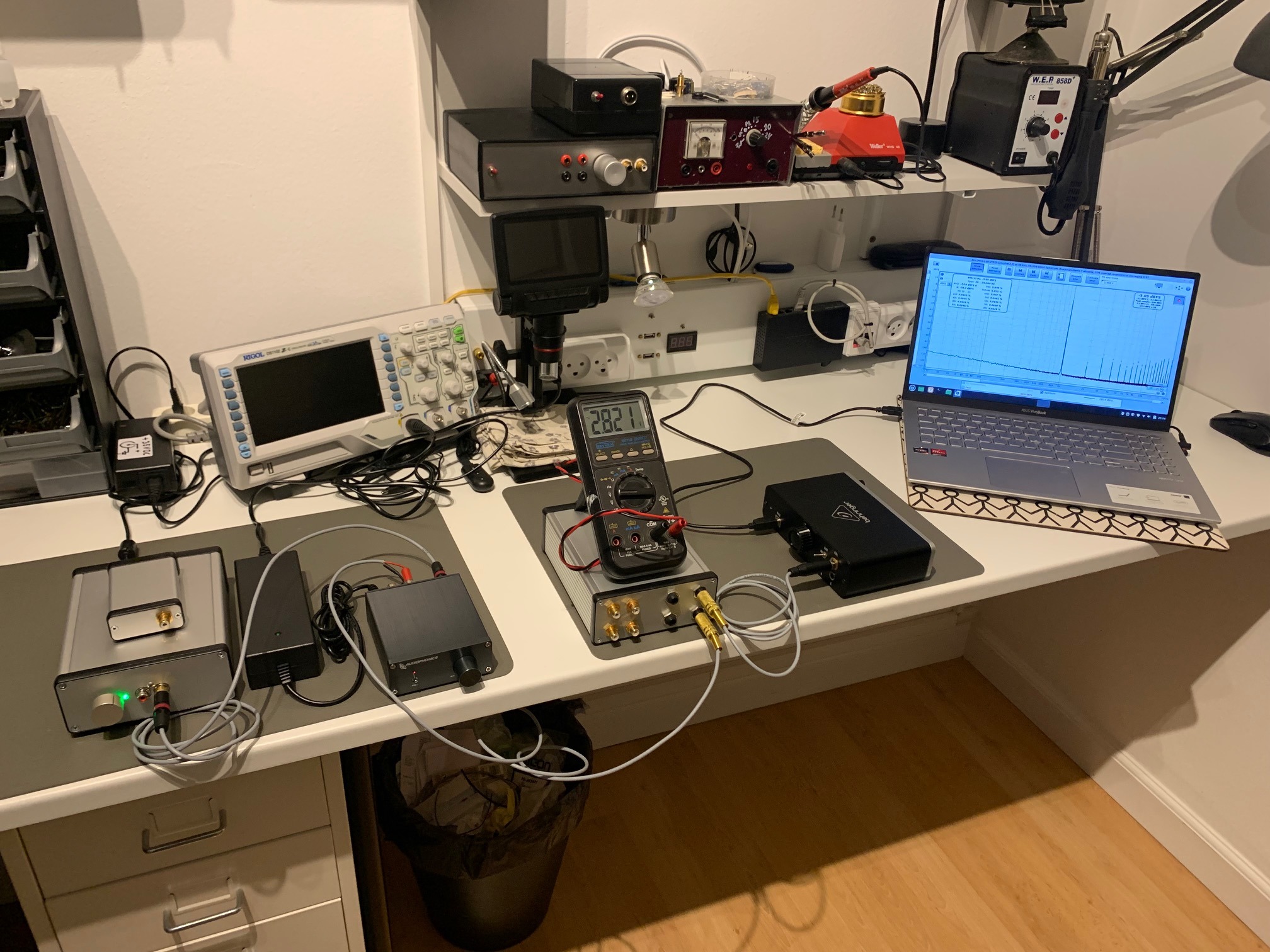

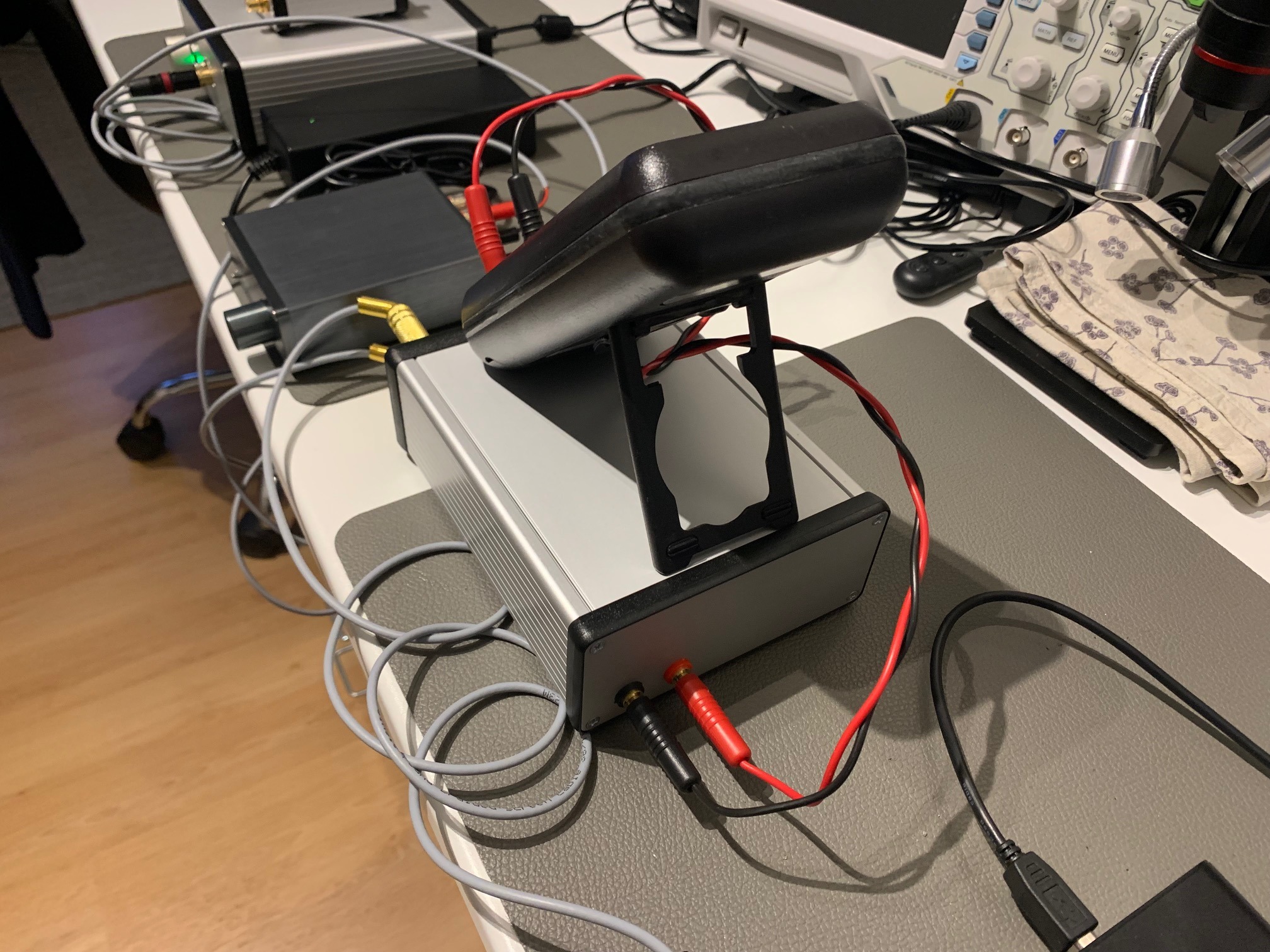

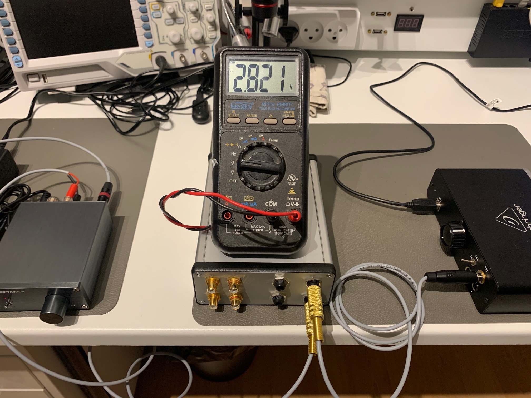

Well well... I just coulden't resist, making my rig complete, so i build the loadresistor's (8ohm, 10K and 910ohm) into a shielded box.
I also created a bunch of different cables with plug's for different setup's. -It's nice to have for sure.
The loadresistor box actually do some good things to my setup. The noisefloor is going lower when using it, instead of having the resistors "open", it's also make things easier to use like this.
Will do some more DUT test... and also be testing @YashN mod to have a really comparing.
Today i tested some cheap Chinese ClassD amp. Noisefloot is higher than on my other amp's, but no 50, 100 etc... HZ spikes at all (I do realise that switchmode supply's are good these day's).

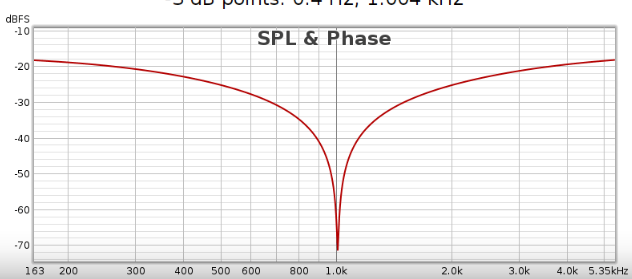

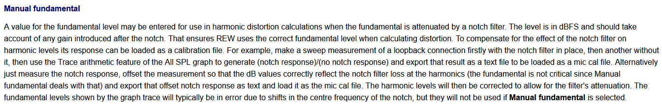

Ready to go! 👍 The notch filter generally goes like this: Gen>DUT>Notch Filter> Soundcard. The DUT will take the fundamental -1kHz- and give it at the output together with harmonic distortion. The notch filter will null the fundamental so the soundcard will see only the harmonics. Since these come at very low level, you can turn up the soundcard input without overloading it with the fundamental. This helps to keep low the residual distortion of the soundcard and have a better view at the DUT. To express this in numbers it will take calculations or some kind of calibration of the distortion analyzer that I'm not aware of.
This is perfect!
This was the explanation i needed to understand the basic's.
* I never understood that i needed to place the notch after the DUT, thank's @MagicBus
If i look at a loopback with notch like this [1KHZ osc] ---> [1KHZ Notchfilter] ---> [Behringer] (See picture)
I'am sure, i then need to offset this transfercurve to 0dB and export this as mic. calibration file?!
OR do trace arithmetic (notch/nonotch) and use this as the offset mic. calibration file?!
When mic. calibration file is loaded i need to enter the fundamental manuel (E.g Victor's osc. at 1V i set this fundamental at 1.000Vrms)
Then i think REW wil calculate the correct THD number's.
I just need to test for real and have this verified by someone expert.
I'am getting there 🙂

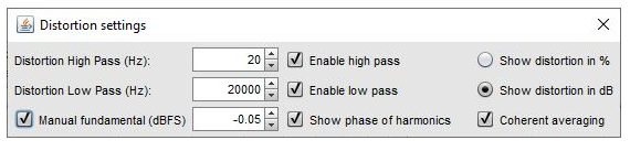

It would be nice if more knowledgeable people could chime in. FWIW, here is what I use to calibrate a diy mic for speakers measurements with ARTA. It's based on a commercial product but I modified the text file to adjust the frequency response to my mic. Not text book approach but it might be a starting point...
Agree 🙂It would be nice if more knowledgeable people could chime in

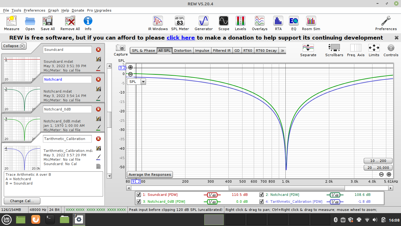

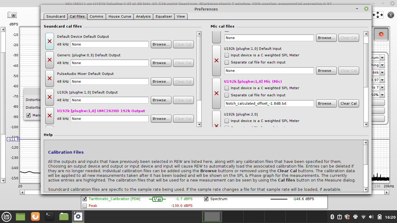

Okay... i will try to explain how i think it should be done.
STEP 1.
EDIT :: This is with full input on the balanced board.
* Calibrate RMS level - internal generator giving 703mV.
* Measure the soundcard, using the internal generator, with and without notch. Do trace arithmetic (notch / nonotch). This gives the blue trace, near 0dB.
This trace is exported as .txt, to be loaded as mic. calibration file.
* Now load the calibration file.
I think so far it's correct?
Jesper.

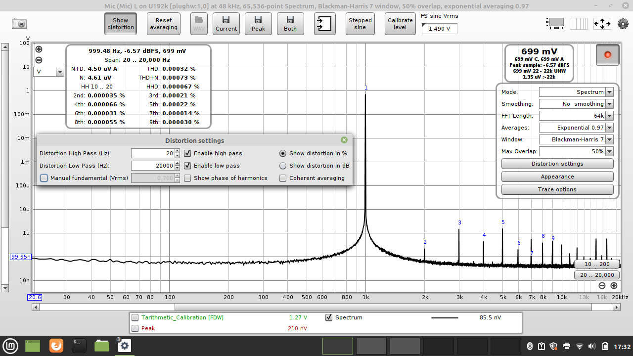

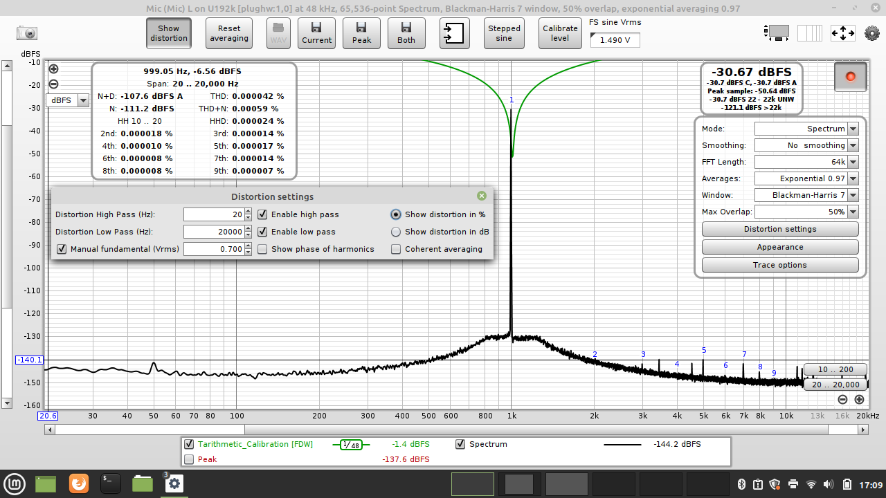

STEP 2.
With mic. calibrationfile loaded.
I send 0.7V from Victors into the notch and then into the Behringer.
I think it's the correct way ??? - Yes/No 🙂
Compared to Victors sending 700mV directly to Behringer, without notch and without calibration file
Jesper.

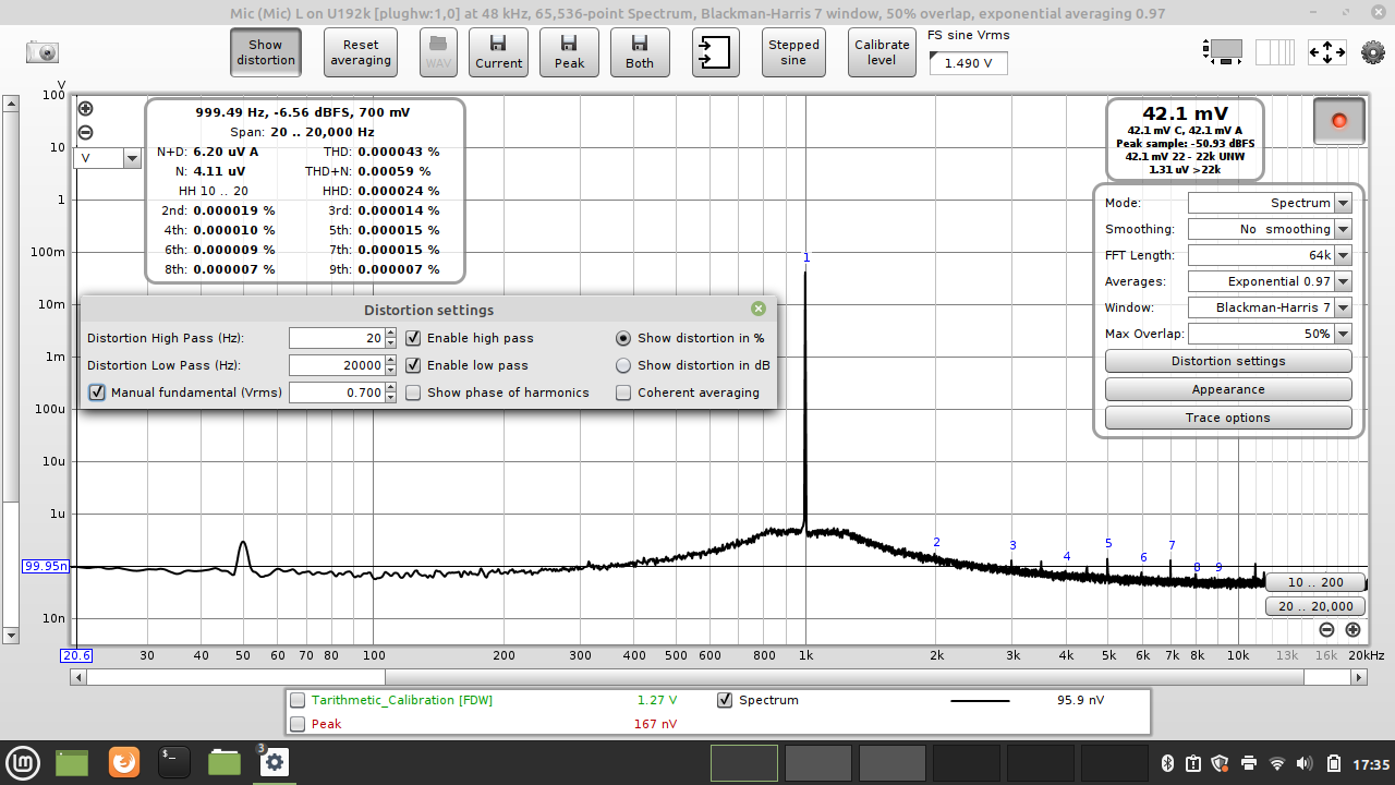

Jesper.

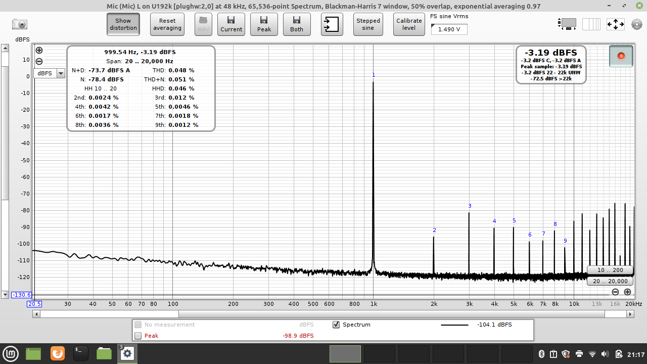

STEP 3.
Confirm voltage calibration (Thanks for learning me this some time ago Salas)
With notch and calibration file ::
With no notch and no calibration file

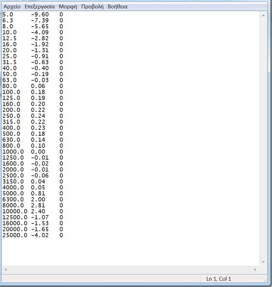

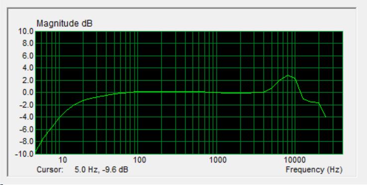

Procedure seems reasonable to me but shouldn't with/without notch filter graphs look more or less the same at least for 1kHz peak level? Is there any signal loss at the filter?
Hi...
Is it this you are ref. to ?
The green trace is just a trace i did manuel offset to 0dB, the calibration file is the blue trace.
If you look left/top on picture you can see the sweep of the soundcard.
The arithmetic do notchcard/soundcard, which gives the blue trace.
Or do you mean the RTA/FFT pictures ?
OK, but what is really interesting here is to compare battery-powered to your graphs in #422 above, and less the USB isolator vs no USB-isolator comparison. The important thing now is to do measurements with the same configurations so you remove one more variable.Well... I also tried my USB batterypack, with and without the USB-isolator, no change.
After that though, you will want to re-do these very same comparisons with the DUT in the chain. Then we can compare what each of these powering solutions really does. I have done a similar study for my DAC and I said, there can be (very big) surprises here.
No, I think it's already well-isolated from the factory, without any mod.I think now, that the Behringer is to prone (thanks to the balanced board and some of the GND-fix i did) to have any use of the isolator.
We can make a note of that and think of it again when we get to comparing power solutions with the DUT in the chain.

Yes, I mean the FFT. Shouldn't the calibrated file restore the "non notch filter" graph as close as possible?Hi...

They already did in that thread on R.E.W. measurements - can't be more knowledgeable than JohnPM on R.E.W. - it's his baby.It would be nice if more knowledgeable people could chime in.

Notch a bit OFF!
