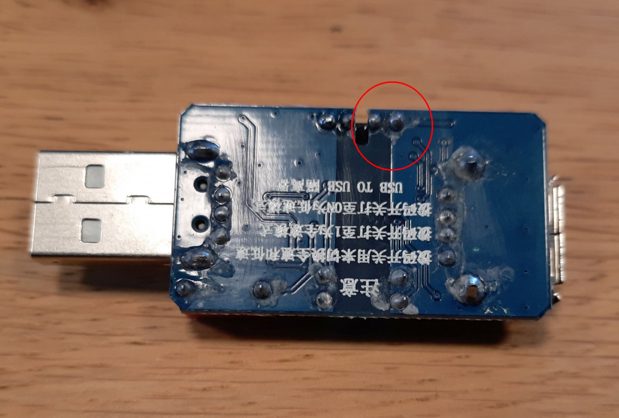

The USB insulator did not work. Not with the UMC202HD, nor with any other device. I'm afraid it's broken. 😞 I'm not going to spend any time and effort in this device anymore. Maybe if someone else achieves convincing improvements with an USB insulator, I'll try again with another device.Interesting! Looking forward to the results. Maybe I'll try my USB isolator this weekend.
Jan
Jan

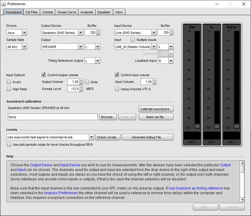

I had suddently something to ask regarding this you wrote some day's ago :
You proberly allready have this in control ? - But you need to be sure that "Control input volume" is at MAX (near 1v) and to uncheck the box also.
Otherwise we got problems going <-6dB or so. (I have been there)

Yes, I did uncheck the option and set volume control manually. My conclusion is that in Win7 ASIO mode works the same for both ARTA and REW. Then REW can do better things with Java drivers but only in Linux. Currently, the reasonable option for me is Win7/ASIO/ARTA. Thanks anyway!

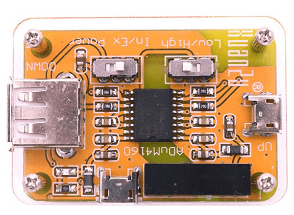

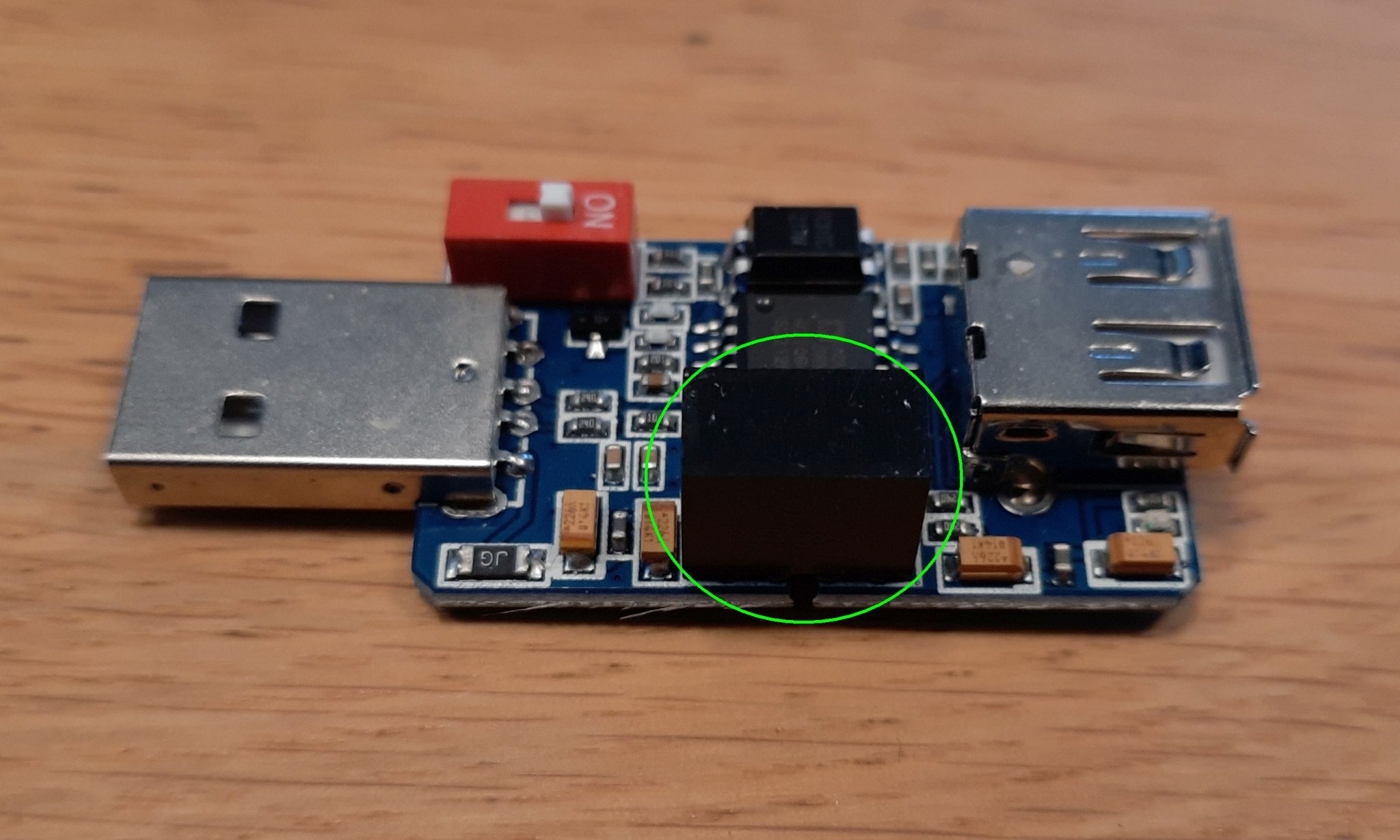

I am waiting to get this usb isolator here : LINK
Archimago is testing the thing : HERE
I know, that i might not getting any better performance, but still worth a try i think.
- Thing is that i can feed external power to it, and raise the voltage inside the Behringer to the codec (raise from 4.5vdc to 4.9vdc as discussed here recently)
Quistion is... Will i gain anything by using a linear regulated +5vdc psu here, or am i better off with a switcher (wall wart) ?
Jesper.

The USB isolator seems like a cool little useful gadget and I am tempted getting one myself, but reading the feedback on Amazon it looks like rather dim when reading all the low rated comments, but one comment was interesting as it suggested to put the USB isolator in between the PC and an additional powered USB hub before plugging in the "sound module", it appears to be so the USB hub does something here, maybe conditioning the signals but it wasn't clear whether the problem lies in the communication signals or the power supply being poor.
The feedback from the link below reads:
https://www.amazon.de/-/en/ICQUANZX.../B07Z21RKMN/ref=psdc_1626220031_t2_B07GF6VMMK
IT WORKS only if you know how to use it
Reviewed in Germany on 23 January 2021
This little devil got me confused for a moment just after i plugged it in. Then i figure it out. It does work if you connect it between the sound module and the pc usb (cause the module has no power to work). But it works if you use a powered hub and the connect this isolator between the hub and the PC port. Then all the sound modeles work cause they powered from the hub and you get no noise cause you dont mixe with the pc usb power. So dont mind the negative reviews.

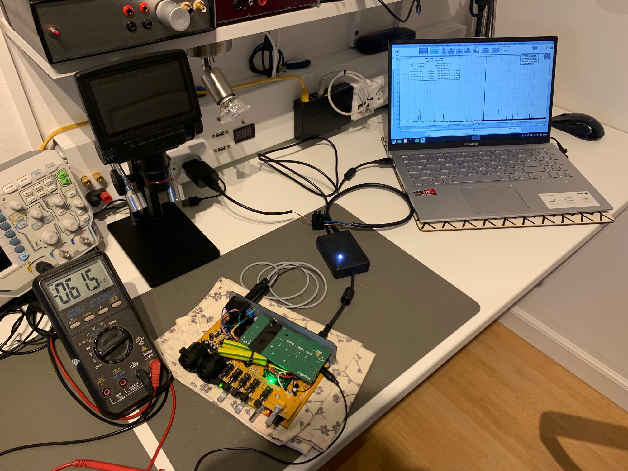

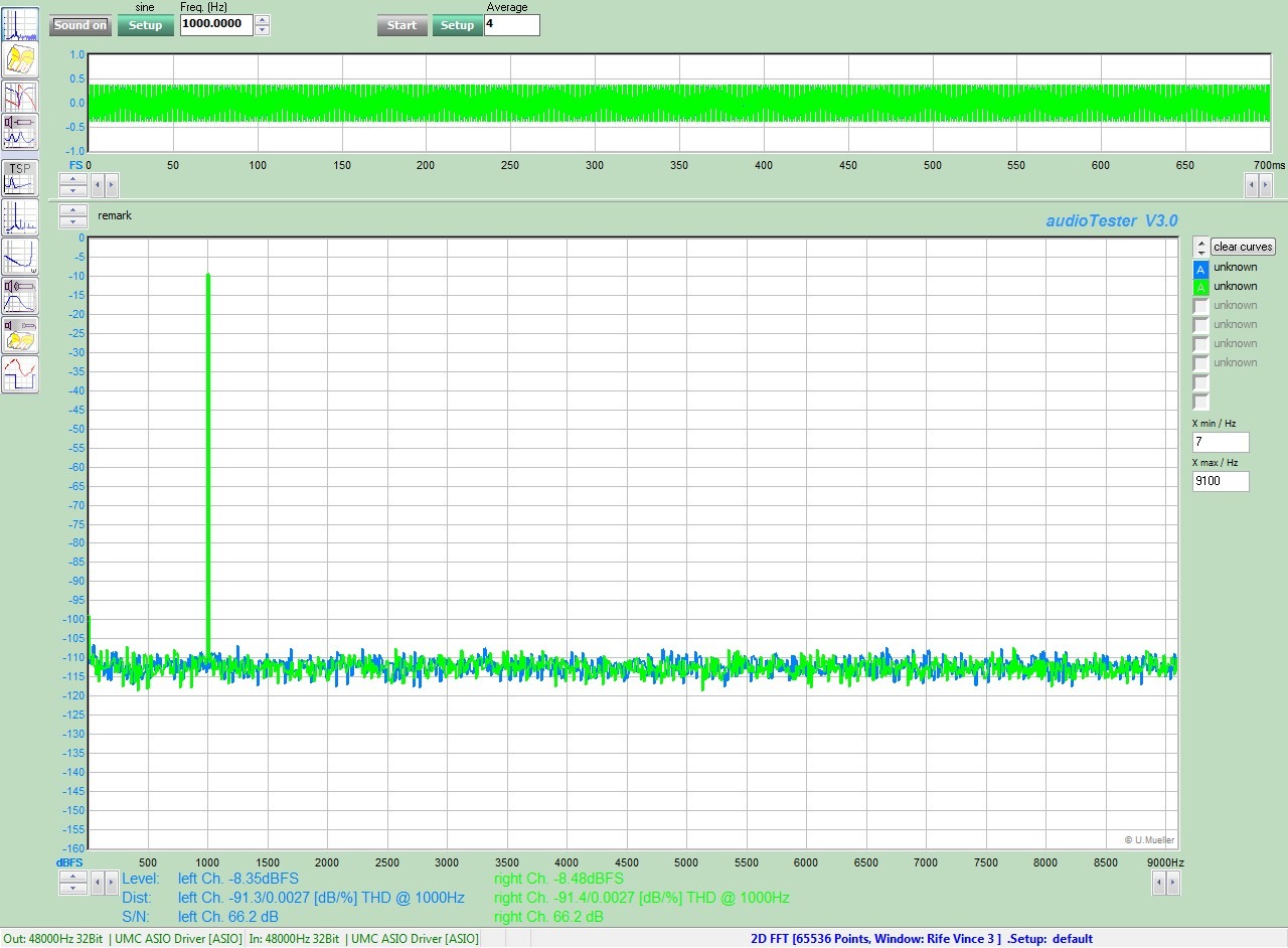

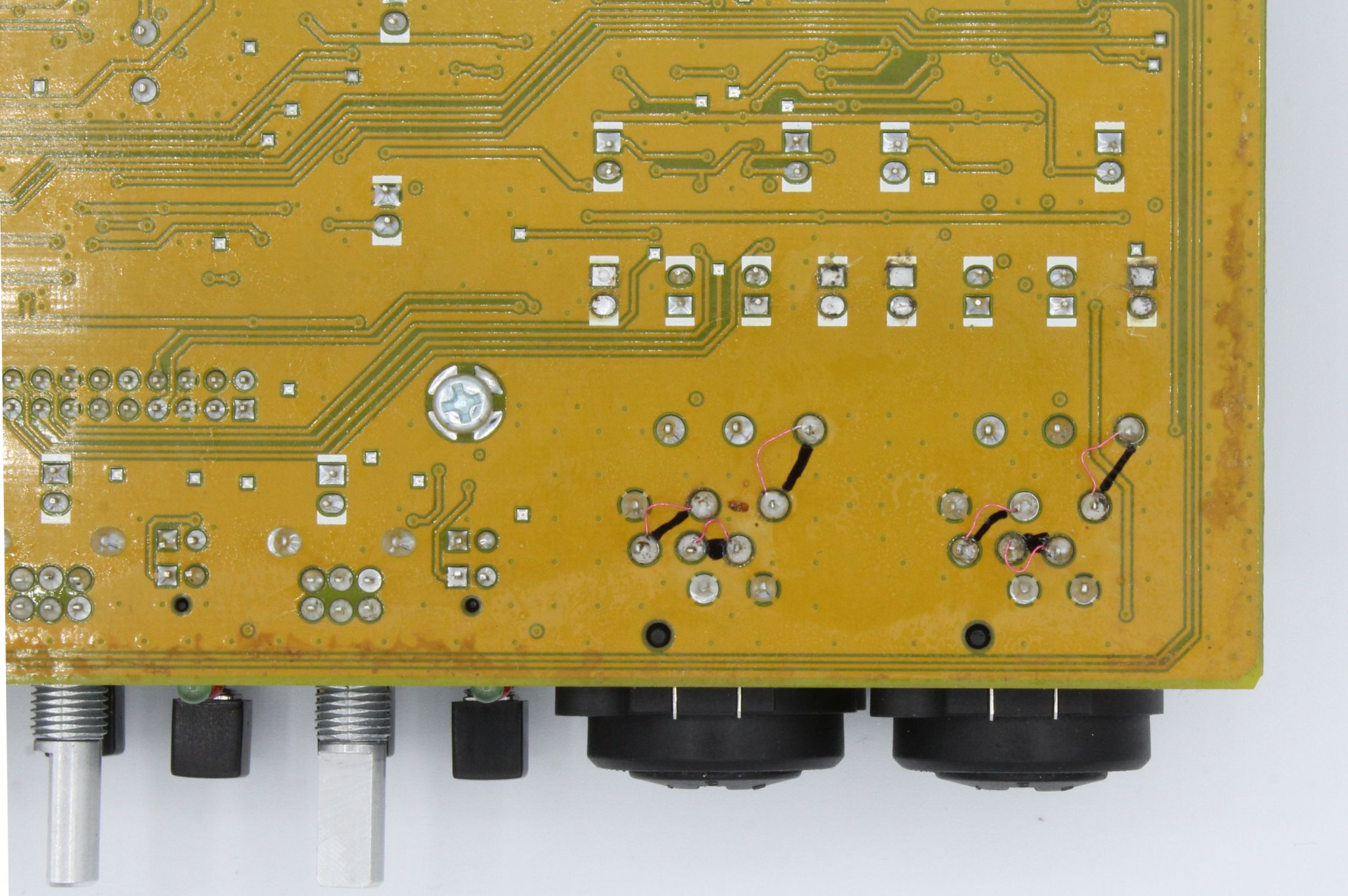

Hi all,
today a former colleague was able to change the CD4066 switch between the TRS input and the XLR amp to a HC4066.
See pictures. Improved THD, but still high noise level. Input was 1 Vpp.
In the meantime I connected the TRS in parallel to the XLR by removing C78, C81, C83 and C85 and doing some connections. See photo.
If you use a mono TRS connector the unused input is shorted by the it. This is not the case for most XLR to cinch cables.
Alfred
Alfred

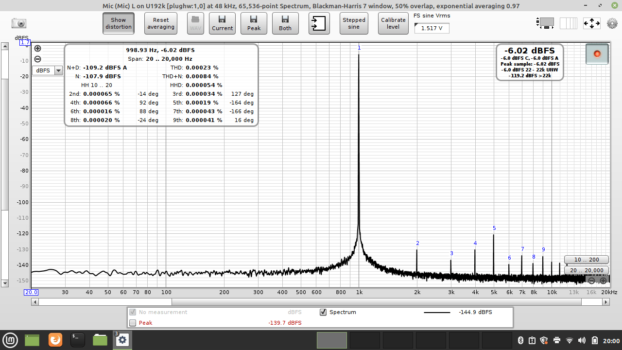

Hi...
@alfredr looking good, nice catch there.

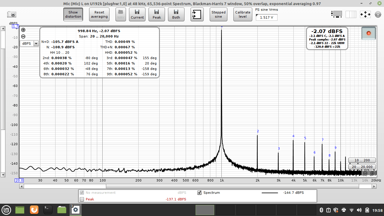

So i recieved the usb-isolator thing, and did some test with it.
The attached screenshots are with 5vdc external switcher-psu & isolator. (-2dB & -6dB)
* The result's are the same without it, so i guess that duo to the balanced input's it does not matter much (but maybe it will be handy for some real DUT senarios?)
It look's that the sweetspot is around -6dB for my setup for now.

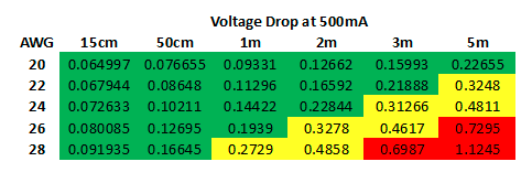

Well what confuses me right now is a thing i have with my usb cables (two ordinary A ---> B & one "Y" split cable):
When i feed the "Y" split cable with say 5.1vdc, i can measure that at PSU end. -But the other end of the cable, the voltage goes down to around 4.75vdc
(This is with the Behringer consuming ~400mA attached)
This is same senario with all three of them, that the voltage drop's in the cable (cables look's okay btw. not the thin ones here)
So maybee it's a usb thing i donno right now.
So my conclusion is, that if i would raise the voltage for the codec, i need to make an external psu connection, and at the same time also disconnect the usb + inside the Behringer or make a cable without the + connection. Donno if it's worth it!... But currious to see if i could get better THD numbers when going near -0dB.
Just some thought's
Jesper.

Thanks for sharing, Jesper, looks good.
Switcher vs Linear Reg would be good.
Then Switcher vs Battery.
Then Linear Reg vs Battery.
I'd keep the isolator in for all tests.
With the Battery, you get the AC isolation for free (here, the switchers pollute a lot), but batteries, depending on their internals have varying levels of internal noise too.
Then there are common Linear Regs which are good, but not as good as the very best Linear Regs. Many times, even the simplest, common Linear Reg can be better than the Switcher.

@YashN :
I did try this quickly, dosen't make any change (with & without isolator)
But i still need to solve my issue with the USB voltagedropping cables.
I found this online here : LINK!
So there is something about this. If i feed power with an even better usb cable than the 3 i got, or using external input with thicker wire, i will properly have no voltage drop.
Behringer with @MagicBus balanced board + @alfredr filter are using ~400mA
Will report back when i figure something out.
Jesper.

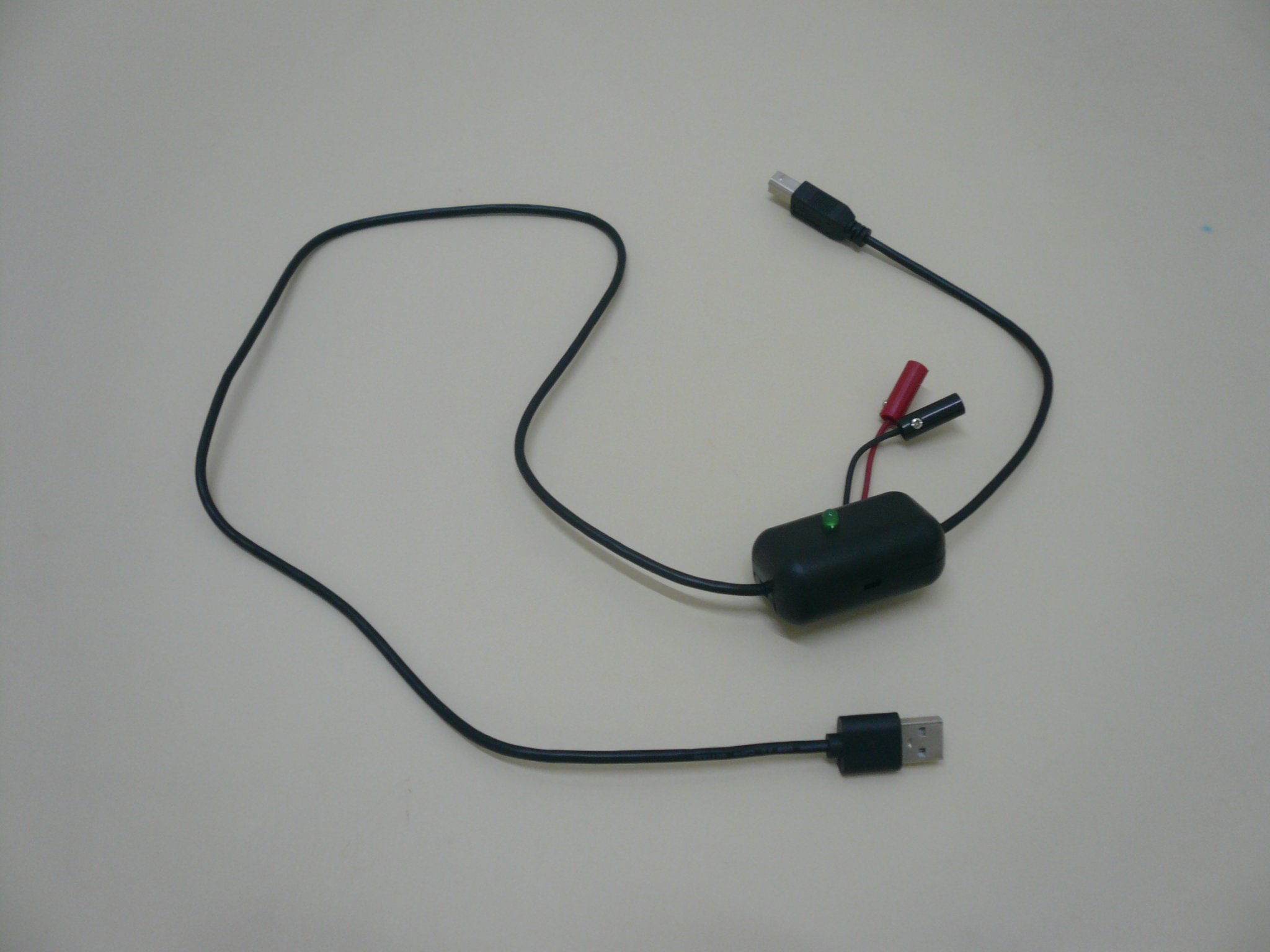

When I was looking around this I used a diy cable. It's very easy to build. You need to cut the red wire. The part that goes to the soundcard it takes the external connector. The part coming from the PC takes a LED/200 ohm resistor going to black wire to make an artificial load so to fool the PC. The black wire should not be intermittent as it's necessary for data too. Just scrap it and take another wire for the external ground connector. You can do this very close to the soundcard end so to avoid voltage drop.
Well, this seem's to be a great idea.
I will see if i have something in my warehouse which could be used 🙂
Jesper.

So... fiddling a bit with this USB-voltagedrop thing.
I'am getting good results with the voltages entering the Behringer now.
Only dropping from 5.18vdc ----> 5.04vdc. So now having 5vdc when Behringer is running doing some loopback to be sure, the switcher psu is loaded.
I now have the chance to test, raising the voltage for the codec to ~4.90vdc from the 4.50vdc it is now.
Let's see within next few day's if i can make it...
Jesper.
