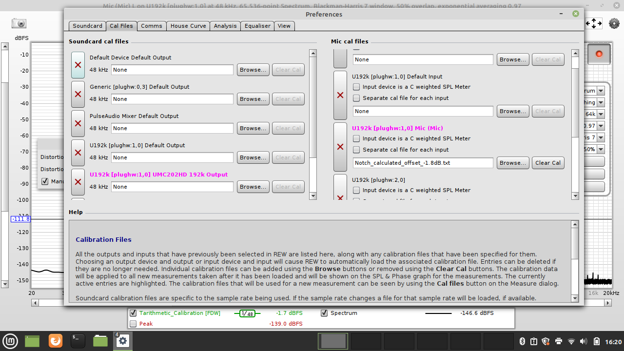

It's been hard to allready understand as much as i do now, using the notch, and i'am not there yet.
You're doing good, no worries.
I will post again on other thread, when i got the notch adjusted to excatly the ~1000HZ.
IMHO, don't post before you read at least a handful of pages before your own post - this has already been described there. The rest is in the R.E.W. help file and once you understand that, together with MagicBus's description above, you're more or less done.
I'm not worried, you'll be there in no time. In fact, you're already ahead of me 😀
Done properly, it does exactly that.Shouldn't the calibrated file restore the "non notch filter" graph as close as possible?
🙂 Okay...It looks to me you're confusing cal. files. The difference is explained in the R.E.W. help. Once you solve that, you're all set I think and will have plenty of enjoyment with your new setup. 😀
I did read all the stuff say 25times... I'am not fully understanding it... remember i'am not native English 🙂
You are very kind if you could be explaining me what i'am missing?.

I tried different, to have the 1KHZ notched closer to the 1KHZ NONnotched graph.
I can't really tell, why it's not more equal. I will do some more testing when i got my notch adjusted to the 998Hz, which my sine delivers.

Regarding the notch filter, in the calibration procedure, I think you should try to get this blue and green traces to the same level. Perhaps you could edit the text file manually if its not too big and not before you save a copy.

The blue and green is the same "notch" sweep, i just did manuel adjust the one at 0dB, just to try it out.Regarding the notch filter, in the calibration procedure, I think you should try to get this blue and green traces to the same level. Perhaps you could edit the text file manually if its not too big and not before you save a copy.

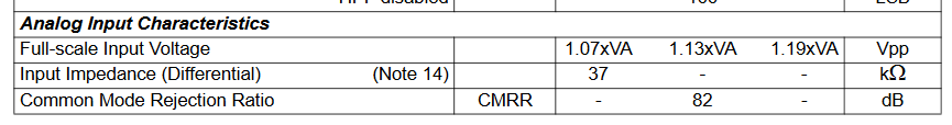

EDIT : Can someone explain this from the CS datasheet ?

Say analog power supply VA=5V, then the ADC would need 1.07*5 - 1.19*5V peak to peak input signal to reach full scale. That is differential. See datasheet page #32. As it's written -and empirically verified with this soundcard- it works for VA<5V too.EDIT : Can someone explain this from the CS datasheet ?

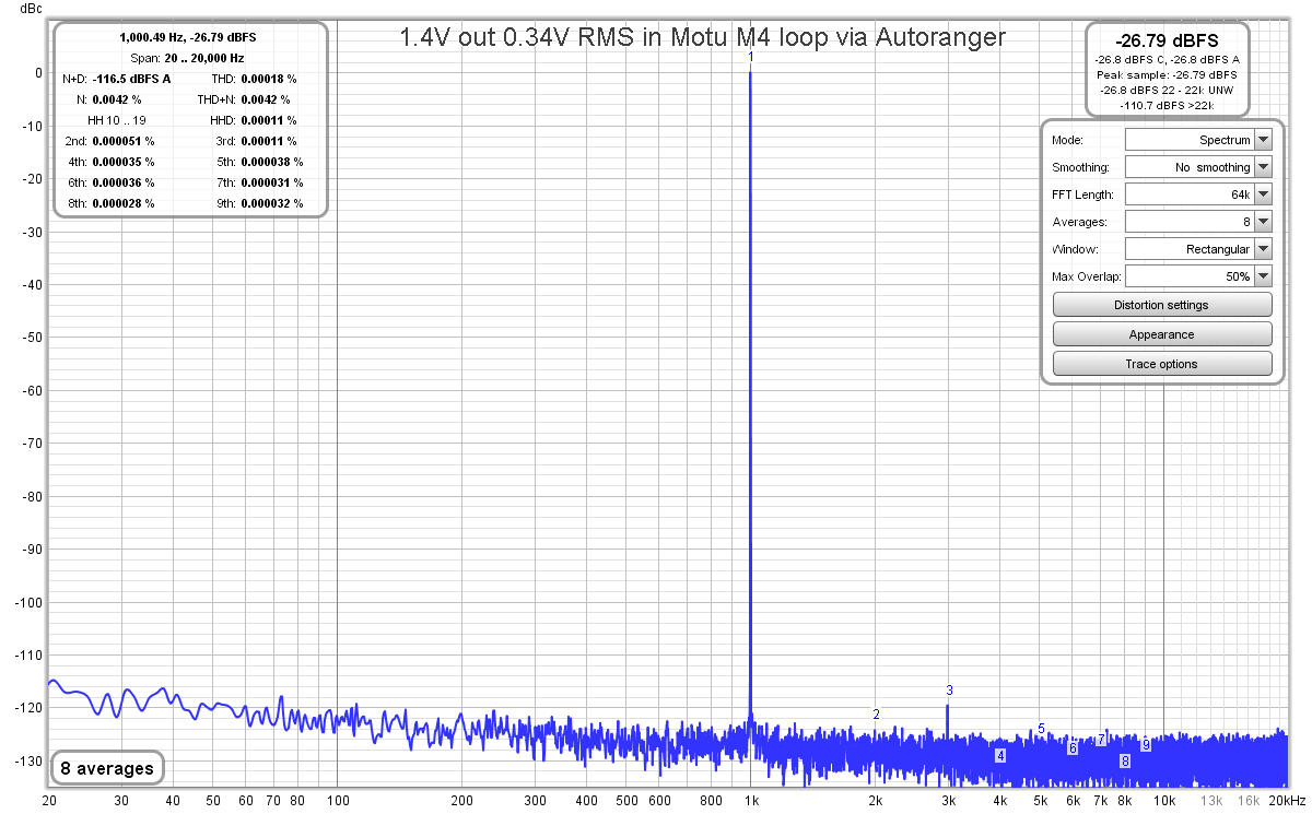

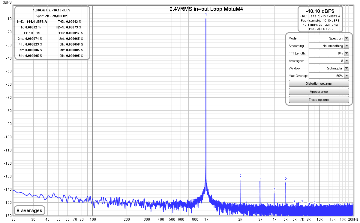

Maybe its also practical to find a sweet spot input level for lowest THD spikes and choose dBc scale to display? That way always refers to zero and has small sticking spikes but the dBFS way goes deeper THD+N. Depends on what aspect you want to focus for a DUT each time I guess.

I got it now with the VA - More visdom to me 😳 🙂

That's a nice interface the Motu, and thank's for the tip, with the dBc.
I did not try it out yet, but having an extra long weekend i will for sure try it.

You still need to first test linear + amp in the chain vs switcher + amp in the chain. I wouldn't worry about anything else until that test is done and graphed.
In REW its readily available and easy to use. Stay around your interface's least visible THD spikes input level. In ARTA dBc is not in the scaling menu, it takes to fake dBFS level calibration for that sweet spot and keep measuring with an input level around there.thank's for the tip, with the dBc.
