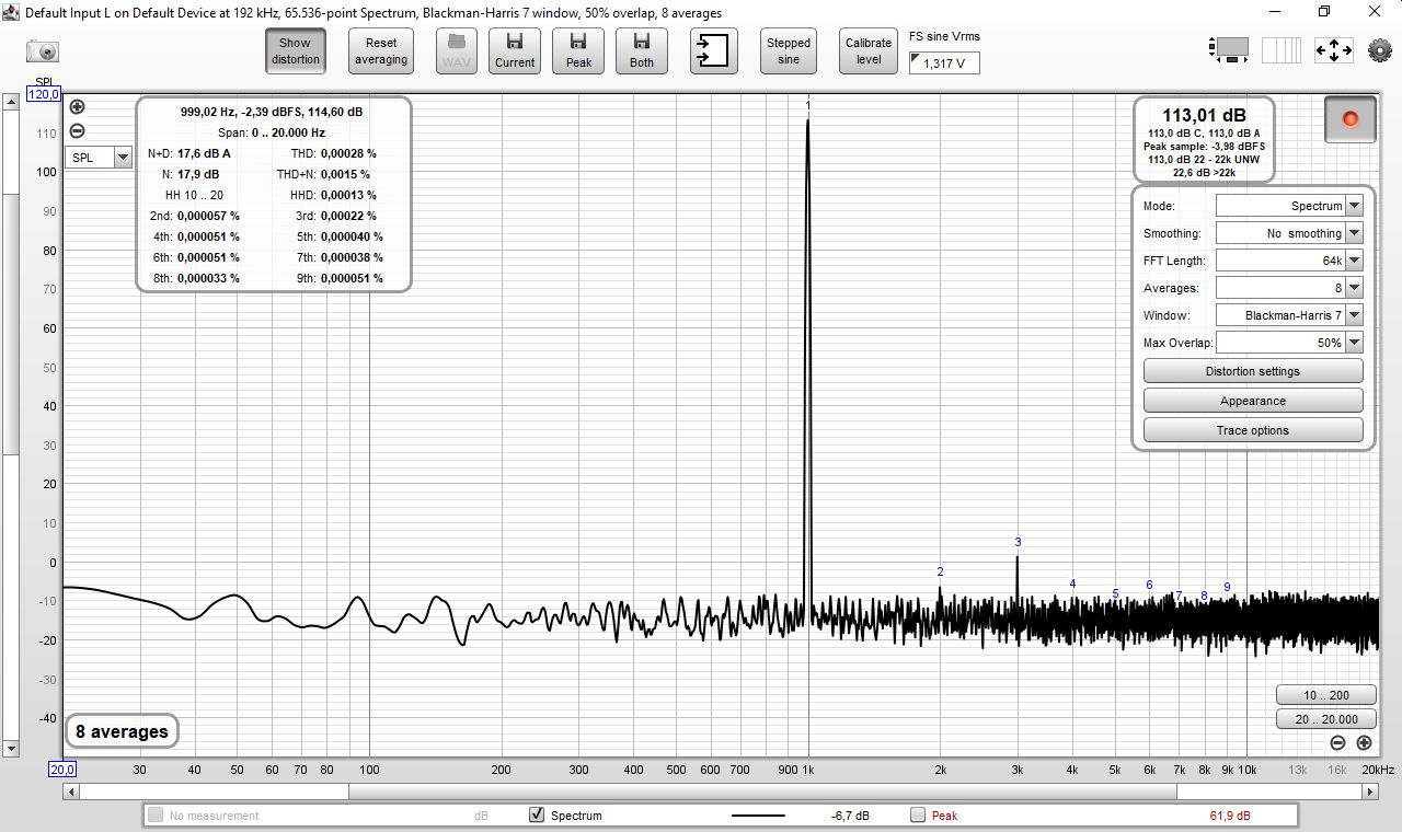

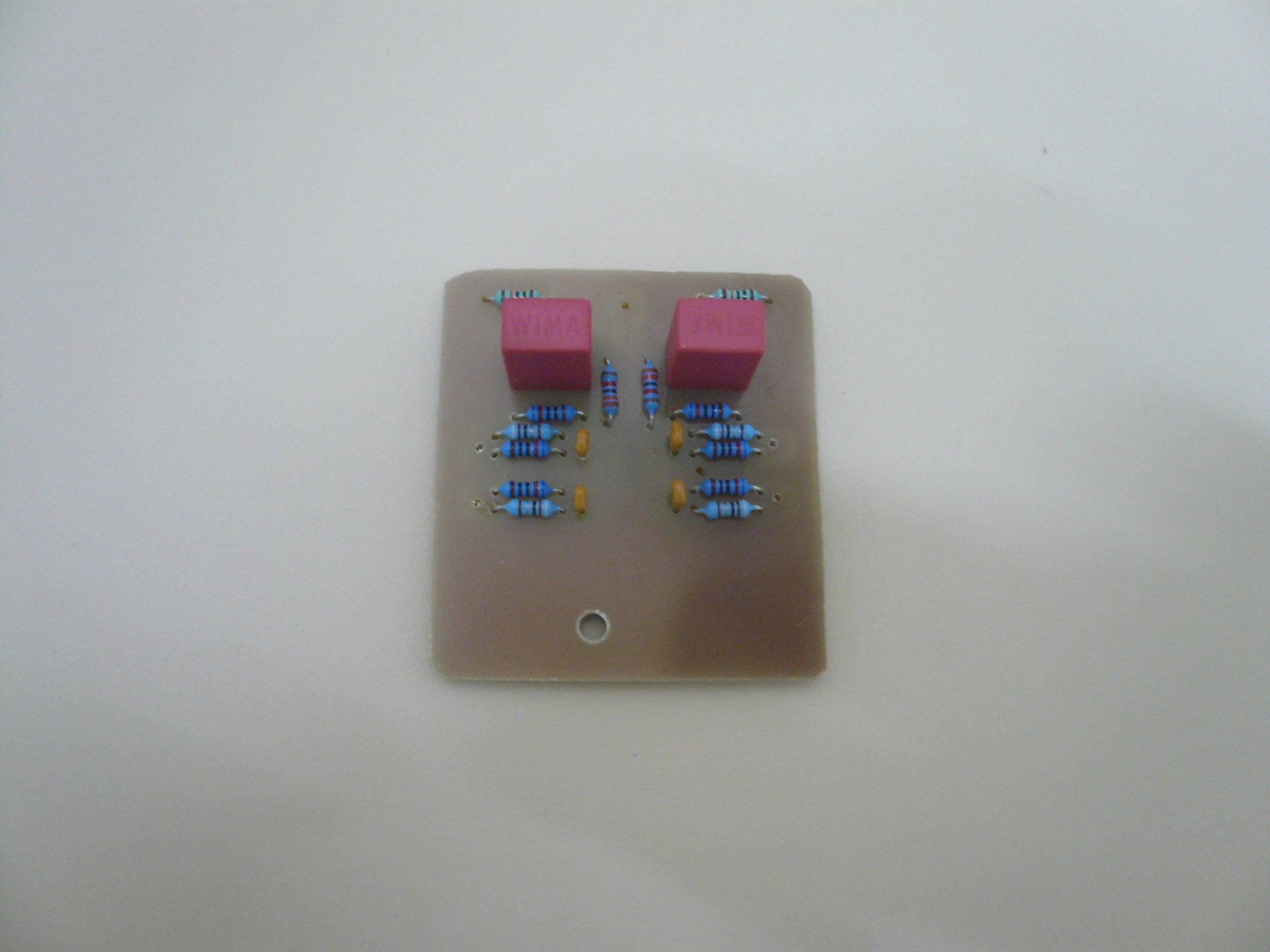

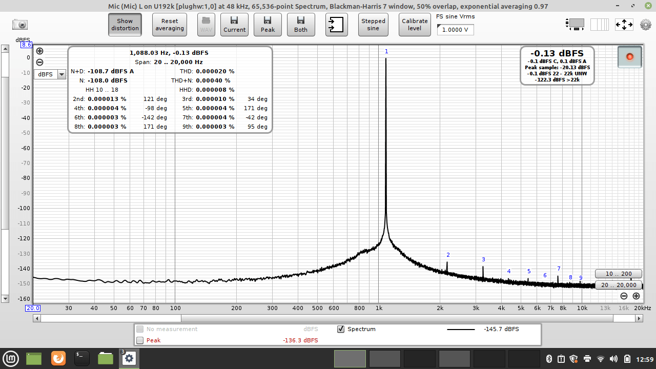

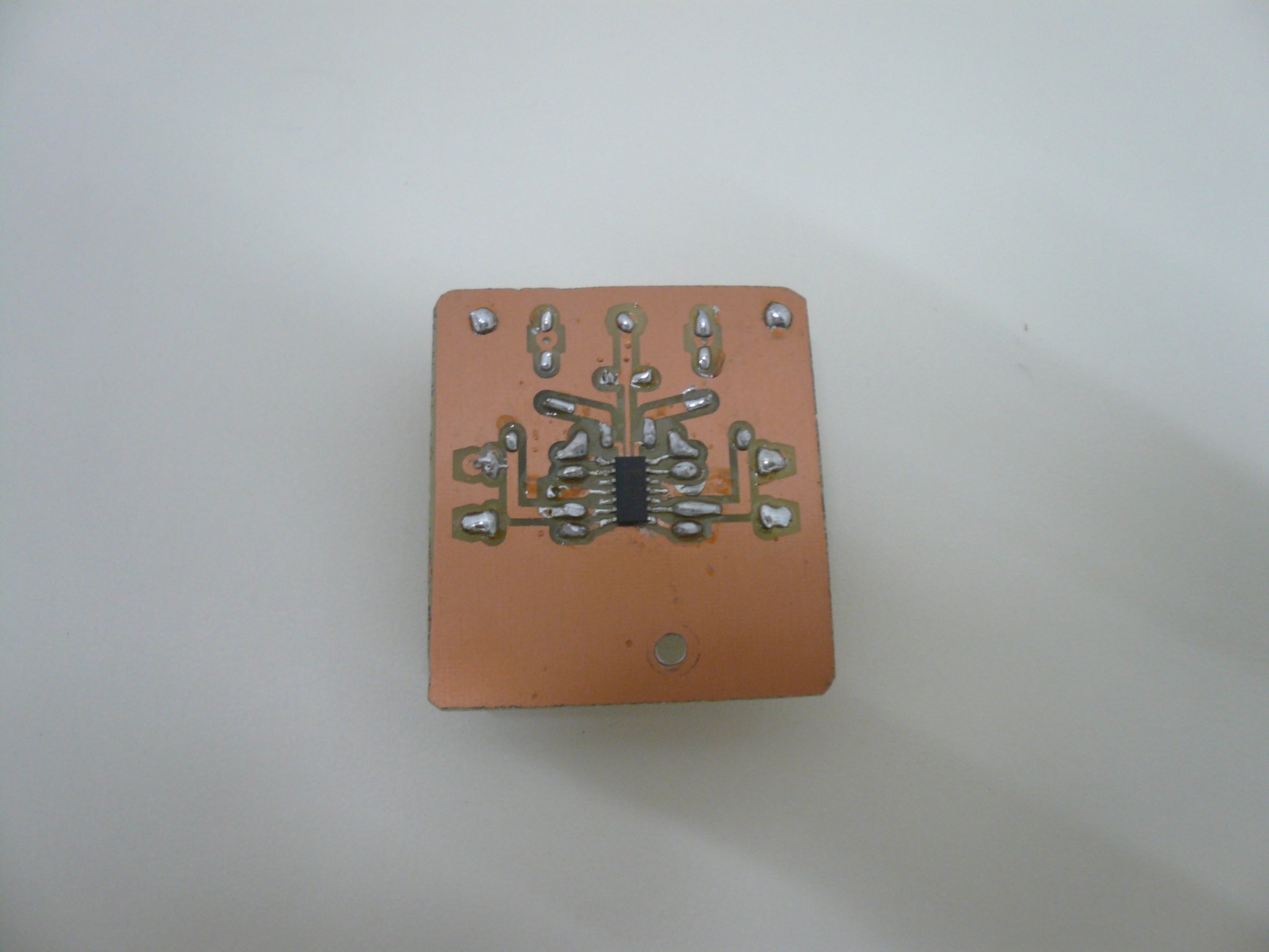

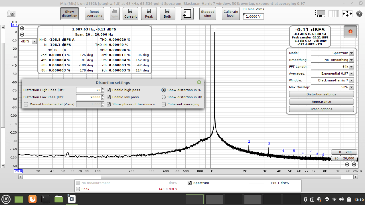

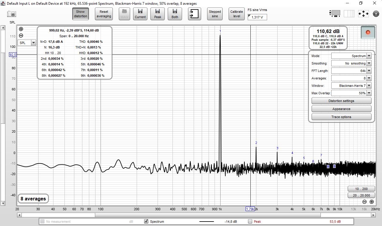

Yep, indeed. With OPA1664. I banned the AD8694s when modding the UMC202HD in September or October last year and they will not return. I modded the other ADC buffer too now. See attached pictures for the results. Shortest possible loopback from IC13 DAC output to IC8 ADC input buffer. The first picture shows the RTA with the stock ADC buffer and the second one is with ADC buffer as specified by Cirrus Logic. I think it's quite obvious the Behringer solution (or design flaw) is inferior to the Cirrus Logic circuit. DAC output level was set to -6dBFs. Output filter -6dB/oct as discussed before. I'm satisfied with the results, so I closed the UMC202HD and will continue my work on the external PCBAs.I assume that is with OPA1664 isn't it? Very interesting! Anxious to see how it goes.

That's an impressive opamp indeed! Stable with capacitive load and not a sign of 50Hz noise! Moreover, going to full scale, I never managed anything higher than -8dB with the stock opamps. I've been always confused with CS4272 datasheet stating that full scale could be achieved with 1,13* VA so I never thought that VA<5V wouldn't work. Nice work!
Thanks MagicBus! But a lot of good work has been done by the contributors to this thread also, which inspired me too. Nice to see how we can learn from eachothers work.
Admittedly, I'm positively surprised too about the actual performance of the cheap CS4272 codec. No need for me at least to try and get hold of a (broken) SSL2 with AKM chip.
Those TI Soundplus series opamps do miracles, indeed. They are my favourite opamps. For my Audio Analzer project, I'll be using two OPA1612 in parallel in the mic preamp circuit, OPA1604 for the line input INA circuit and OPA1641 and OPA1604 in the output buffer. And no, I don't own TI shares... 😉

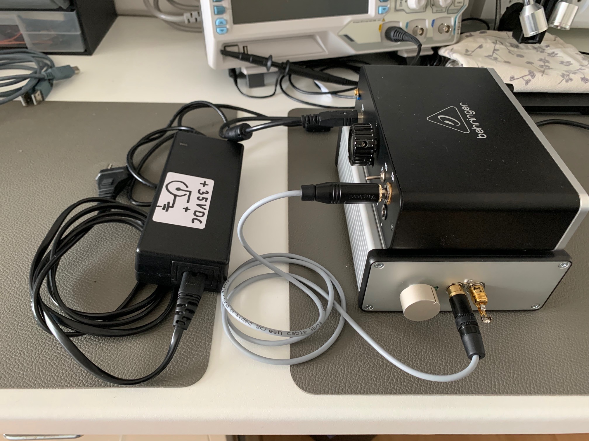

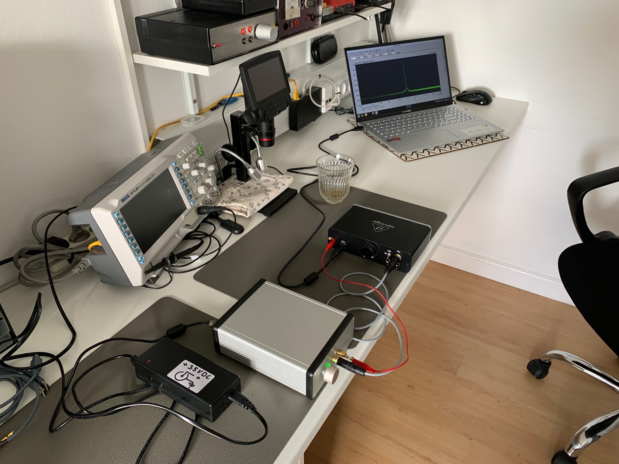

Hey guy's... 🙂
I had some conversation with Victor (the guy which are selling the 1KHZ osc.)... I bought one from him recently; today i did some test's with it.
I had as usually some problems with setup picking all kind's of spikes up (mainly 50Hz + 100Hz etc...)
But with Victor's oscillator i can connect the Behringer shield/GND to the Victor's chassis i build the thing into.
When this connection is established, everything is very prone to noise pickup, i can even leave the laptop psu in the mains outlet, without no noticeable noise measured...
Fortunately i didn't had the time yet to do some real DUT measurement's, but i thought that i would like to show this.
I also build an LM317 psu, which i build into an old switcher supply i had.
The LM317 are somewhat stressed, giving it near it's maximum of +40vdc on the input, having some pretty nice +34.8vdc out for the oscillator.
Attached some pictures showing both battery powered and my LM317 supply with the Victor's.
Jesper.

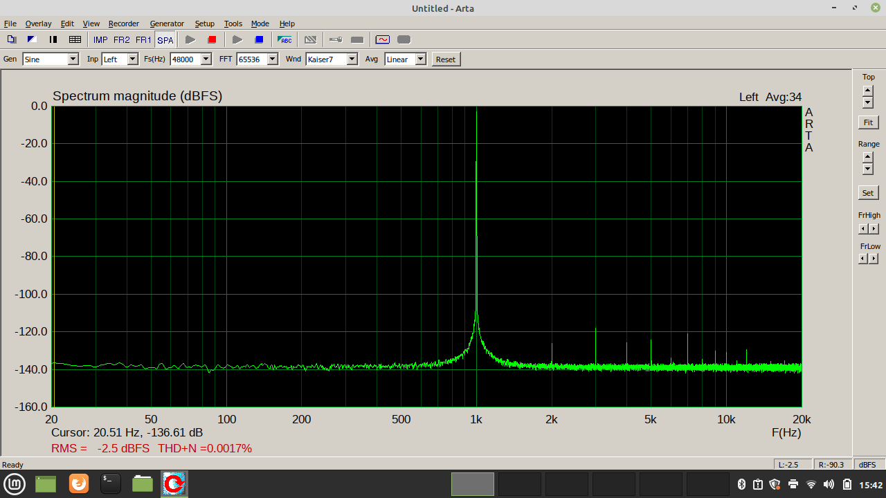

Ofcause...
I just did.
ARTA eats a little more juice, so full scale on your'e balanced Magic 🥷
box, end up with -2.5dB
I tried different input from the Victor's, and the attached picture is the best i could get.
Jesper.
EDIT :: Missing Setup-picture

Thanks Jesper! Generally, REW does better than ARTA. I desperately need to get it working with my soundcard.
You can do it MagicBus...I desperately need to get it working with my soundcard.

Awesome THD+N! Nice work!Hey guy's... 🙂
