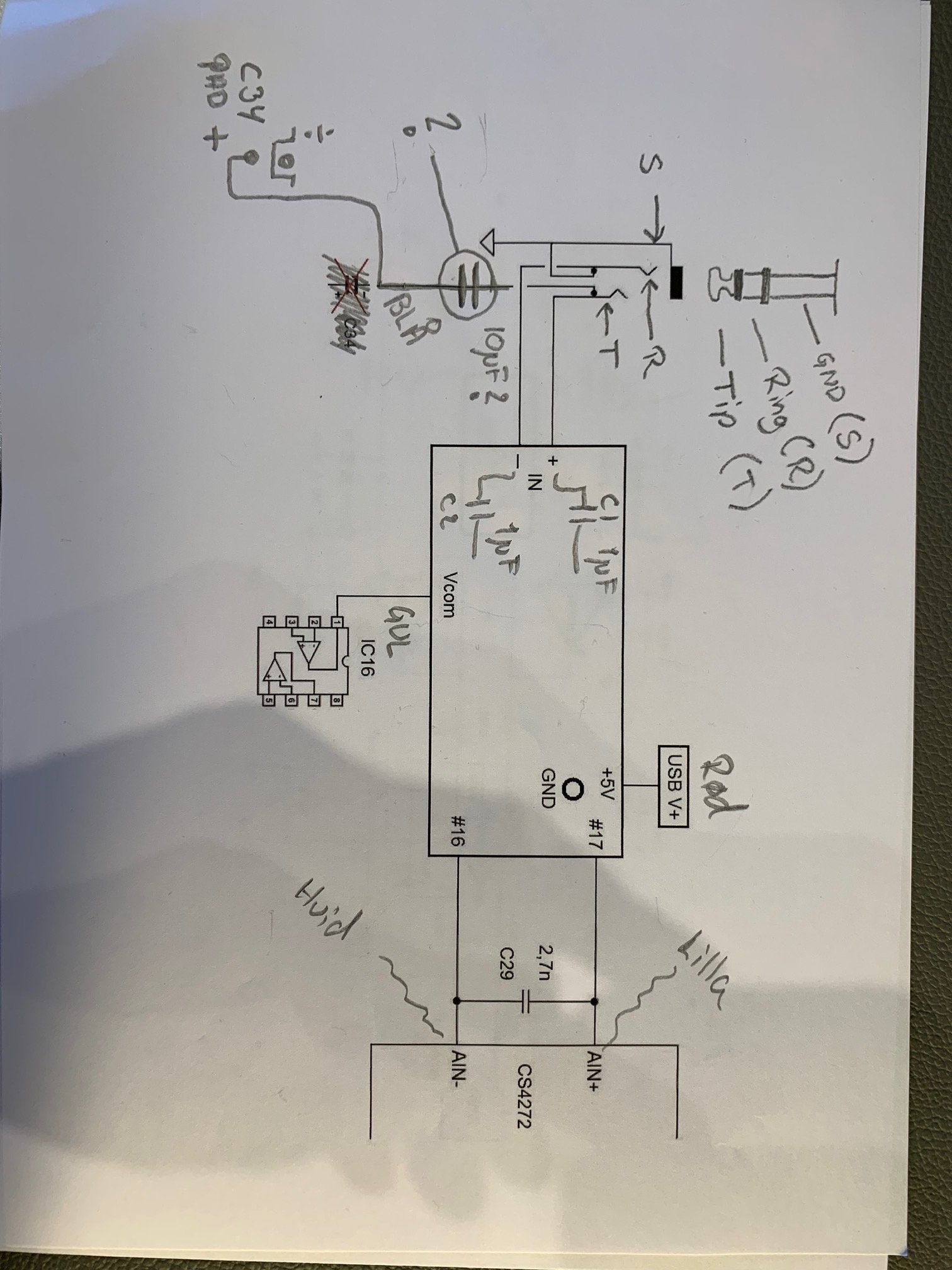

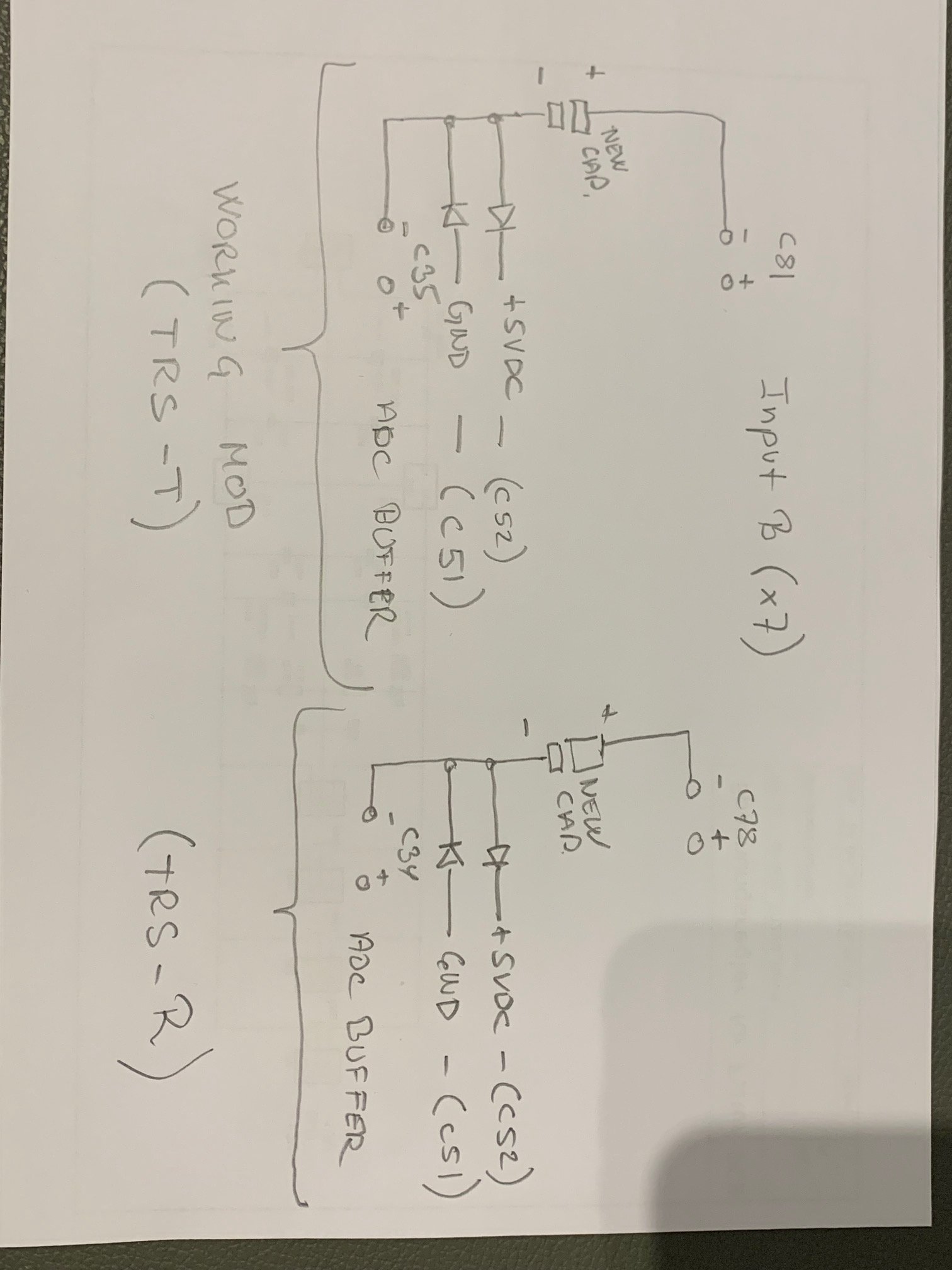

Well, i asked YashN howto mod the other channel, as i thought at that time i could make it aka' balanced.
Looking more carefully i see how it's working now.
The attached picture is what i send to YashN, asking him if it was right; but before he answered i allready did the unusefull 2. mod.
Please care, my schematic is only usefull for the working mod...
'YeashN answered afterwards, that if i would mod the other channel i got the wrong parts on my schematic.
Not sure the importance of this info+ Duo to some laungauge barrier for me, i wasen't aware this was what YashN meant i should post, for other not doing the same mistake. As YashN is very helpfull i ofcause will do, hope i got it right this time ?

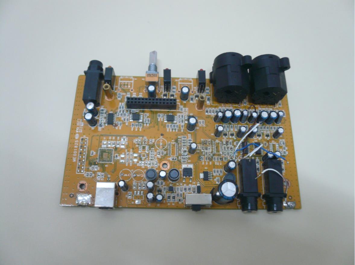

For the Left Channel, doing the simple mod as I did for the Right Channel, here is what I exchanged in DM:
BTW, I made a mistake in my previous post regarding mathching. Only realised this morning on waking up:
Actually, you don't need to match the channels closely using the special modes (ARTA, maybe REW). That's the beauty of these algorithms.
In fact, I did a 4-channel version of that kind of calculation and showed some graph on 4 simulated channels in a thread about building a Phase Noise Analyzer somewhere on this forum, but I don't think anyone followed up.
You can re-use the same PSU-caps for new diode connection joints, and of course, transpose everything to the Left Channel.
The caps/vias for the Left Channel are: C85 and C34 though.

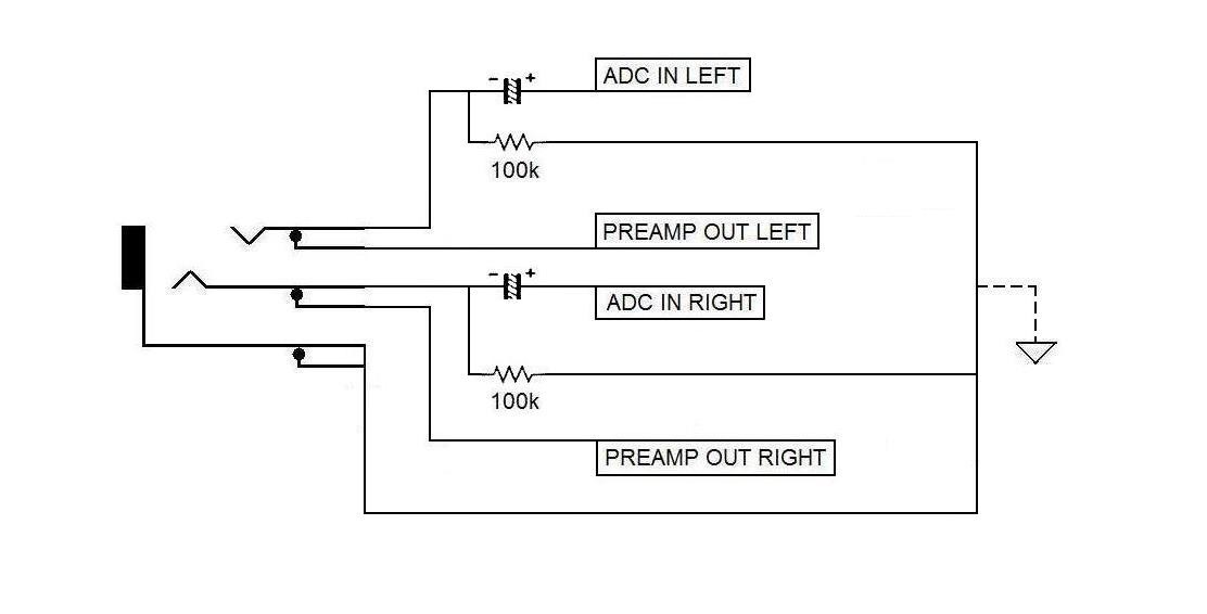

I can't seem to quite understand what you write in post #203 @MagicBus.
The direct in mod i did some time ago, i attached the 47uF capacitor at the extra-TRS plug, so that the signal from the preamp could enter the path via the capacitor when none jack was inserted into the extra-TRS plug.
Well i have no use i think of the preamp left channel, but maybe i got it wrong ?
Btw: The boards was verified fine at pcb-house after you did the correction, thank's a lot!
Jesper.
I'am preparing my Behringer for the mod & @MaigcBus's balanced input board.
I did take out my C34 left ADC BUFFER input-capacitor. But the signal comming from the preamp left is going into the + side of the C34 capacitor (i did confirm this with my scope) so the signal from the left preamp cannot enter the ADC BUFFER this way ?For the left channel, remove C34 and take a wire from the negative pad, no return to positive. The on board buffer for the left channel will be permanently stay disconnected. But wiring a TRS like in the schematic allows full functionality for the front panel input and controls just like the previous mode. The new buffer has just a bit higher gain at ~1,25.

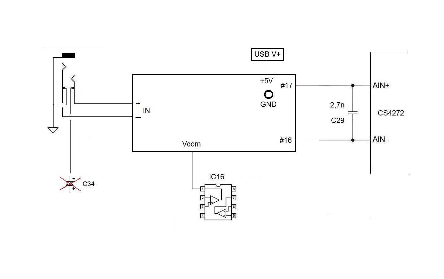

You are correct once again! I tried to figure out from old pictures as you already know the status of my poor HD202. For some reason they have made square the negative pad of the capacitor... So it is a wire from positive lead to the new pcb. The TRS wired as previously but the coupling capacitor for this doesn't have to be that big since the new input impedance is significantly higher.
@MagicBus... you do a h... of a good job, thank's!You are correct once again! I tried to figure out from old pictures as you already know the status of my poor HD202. For some reason they have made square the negative pad of the capacitor... So it is a wire from positive lead to the new pcb. The TRS wired as previously but the coupling capacitor for this doesn't have to be that big since the new input impedance is significantly higher.
Is the attached schematic correct then?
Got 3 quistions more 🙂
* Do i need a capacitor for the input to TRS jack from (C34+) ?
* Do i need the 100K resistor to GND ?
* Should i connect the extra/backplate TRS jack (S / GND) to Behringer GND also ?
Jesper.
Schematic seems correct! You won't need a substitute for C34 neither 100k to ground. C1-C2 and VR1 on the new pcb take care of that. About grounding TRS sleeve, the new buffer input doesn't need any reference to ground. Maybe it could help with the on board preamp but most likely it should not make any difference. I would try it without ground for starters.
Cool... i got it thank's...Schematic seems correct! You won't need a substitute for C34 neither 100k to ground. C1-C2 and VR1 on the new pcb take care of that. About grounding TRS sleeve, the new buffer input doesn't need any reference to ground. Maybe it could help with the on board preamp but most likely it should not make any difference. I would try it without ground for starters.

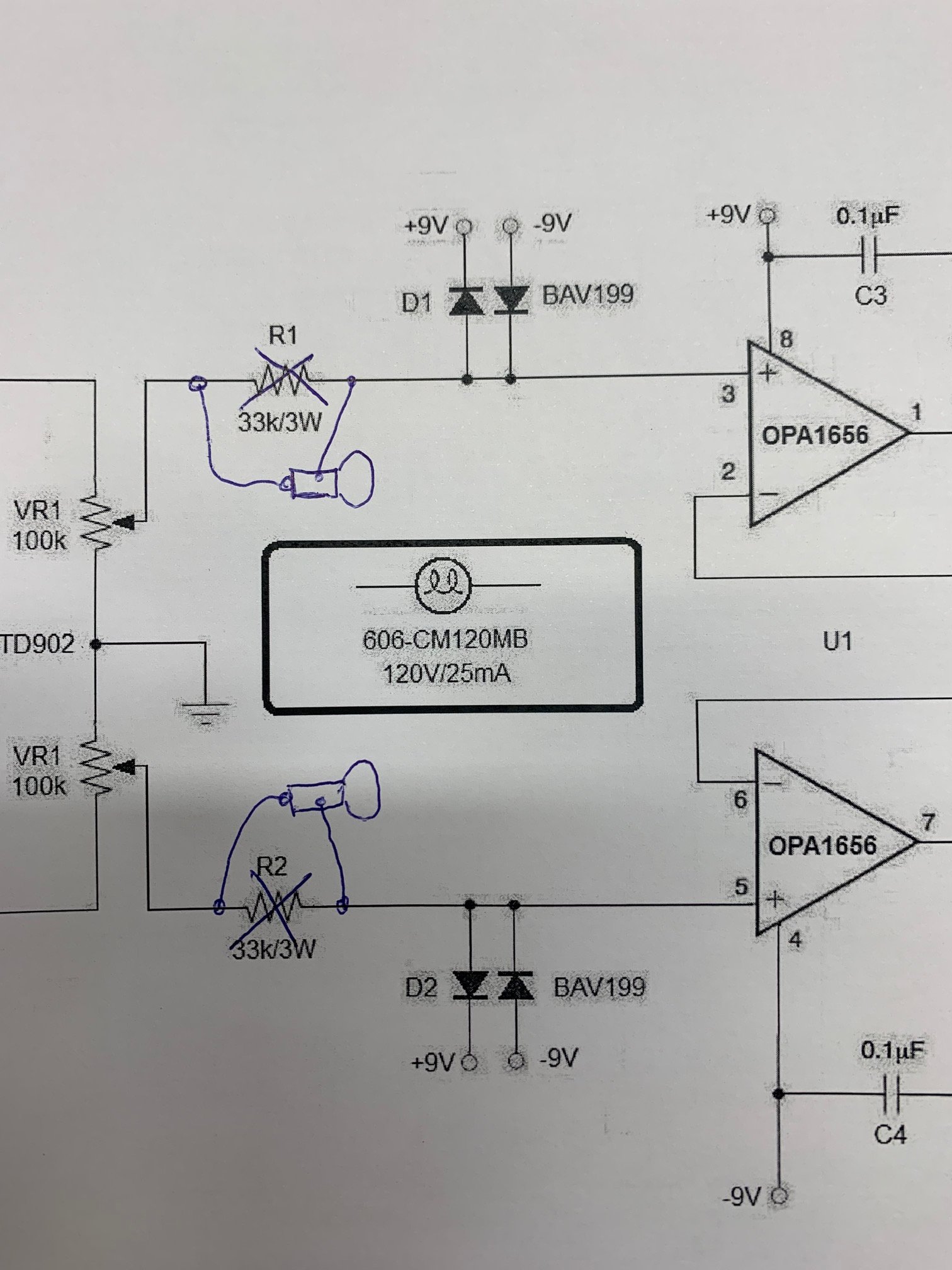

@MagicBus I ordred some of the lamps you described to use instead of R1 & R2 (33K / 3W)
I know that some instrument's are using lamps for measurements operation, or to have some input to behave better than resistors.
But i don't understand how excatly it's working, except that a lamp is aka' sort of resistor (variable that is).
Does the attached schematic where i "put" in the lamps instead of R1, R2 look right?
Anyone explain please how this work 🙂

Current limiting resistors will dissipate excessive power to protect the diodes which in turn protect the opamp from high voltage. But adding in series resistors will add noise. Since this scheme is only needed when high voltage appears at the input, the idea with the lamps is to keep the resistance low when everything is within limits. The lamps' filaments read a few hundreds ohm when cool but will increase rapidly when have to dissipate power. That said, I've tested them for the first time in Pete Millett's PC interface after his suggestion and it was worst than plain resistors. They picked EMI or something and that interface doesn't have true balanced input to allow CMRR to work. But in my diy soundcard I was happy to see it works fine. So, if you are in for some experimentation, you could start from jumper wires -just remember there is no protection in this case- and compare with resistors and lamps. There should be sufficient CMRR in this circuit perhaps to go with the resistors. My soundcard is a complex assembly to try all this now.
