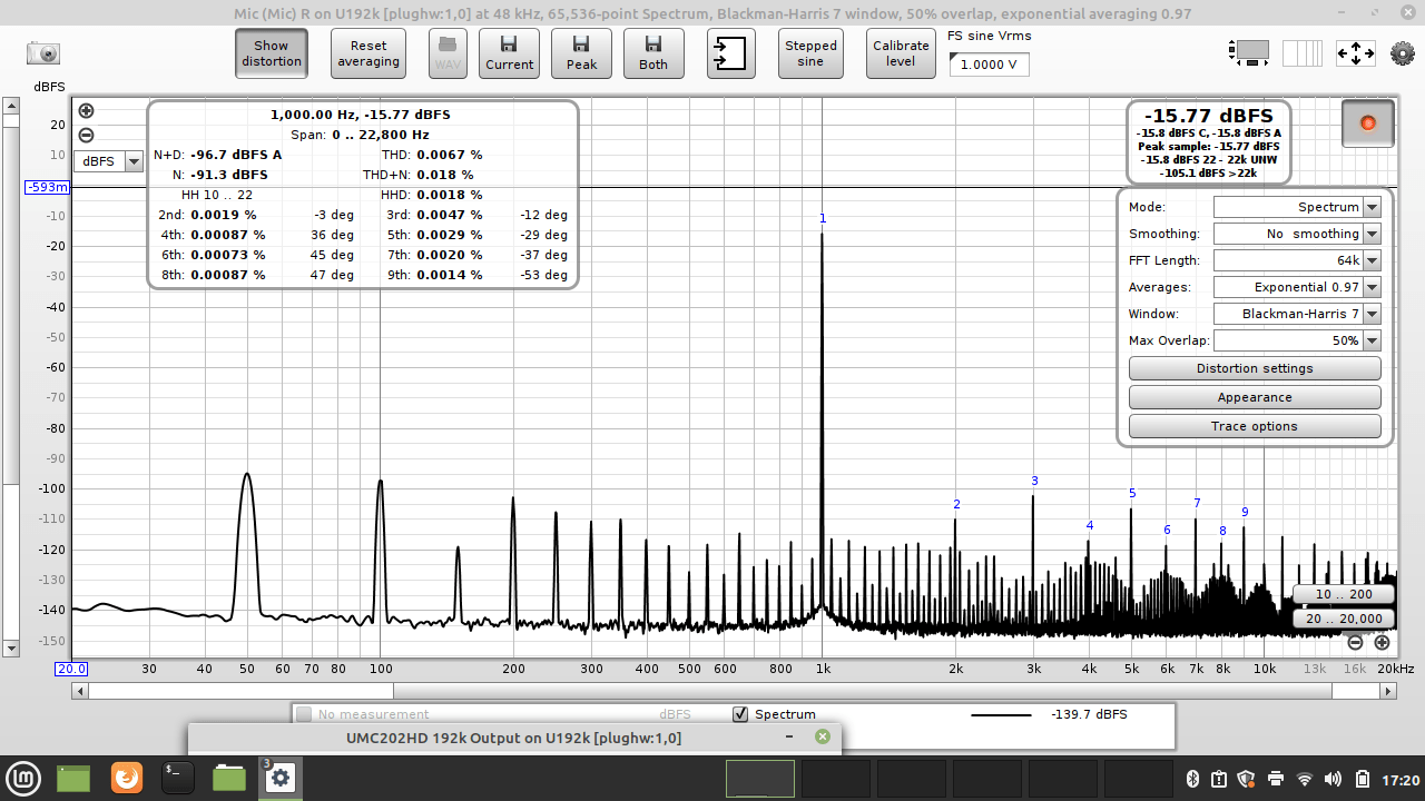

I will carefully look out for not going higher than this MAX level MagicBus.

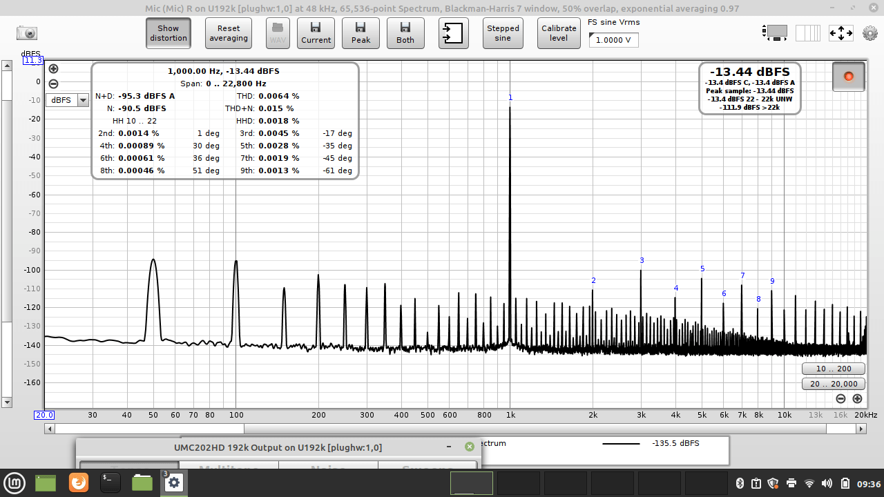

While i'am stock here at home rest of the week, i did try another experiement with batterysupply to the Behringer.
Jesper...
Picture's speak for themself. Batterypower is not better, likely a bit worse in my case.
The measurement's are with same setting's and adjustment's. (I use my Right channel in/out with YashN's mod etc... as i wrote in earlier post)
Been there, done that... I never found the power supply of the soundcard to be a problem, other than the phantom power. The loop measurements of yours are already very good I think, especially complimented by REW. The ground loop problem when a DUT is inserted better addressed with a floating input rather psu.
So... this is the best i can archive when measuring an real amp. (cloneamp. at my lab.).
I tried allmost everything regarding lifting GND's, making "star" connection's etc... nomatter what, i seem to stuck with the forrest -noisefloor.
But okay it's better now at least.
I'am looking forward to recieve Alfred's pcb to buildin between R98 / R99 (DAC filter ---> line out) to try that out.
Jesper.

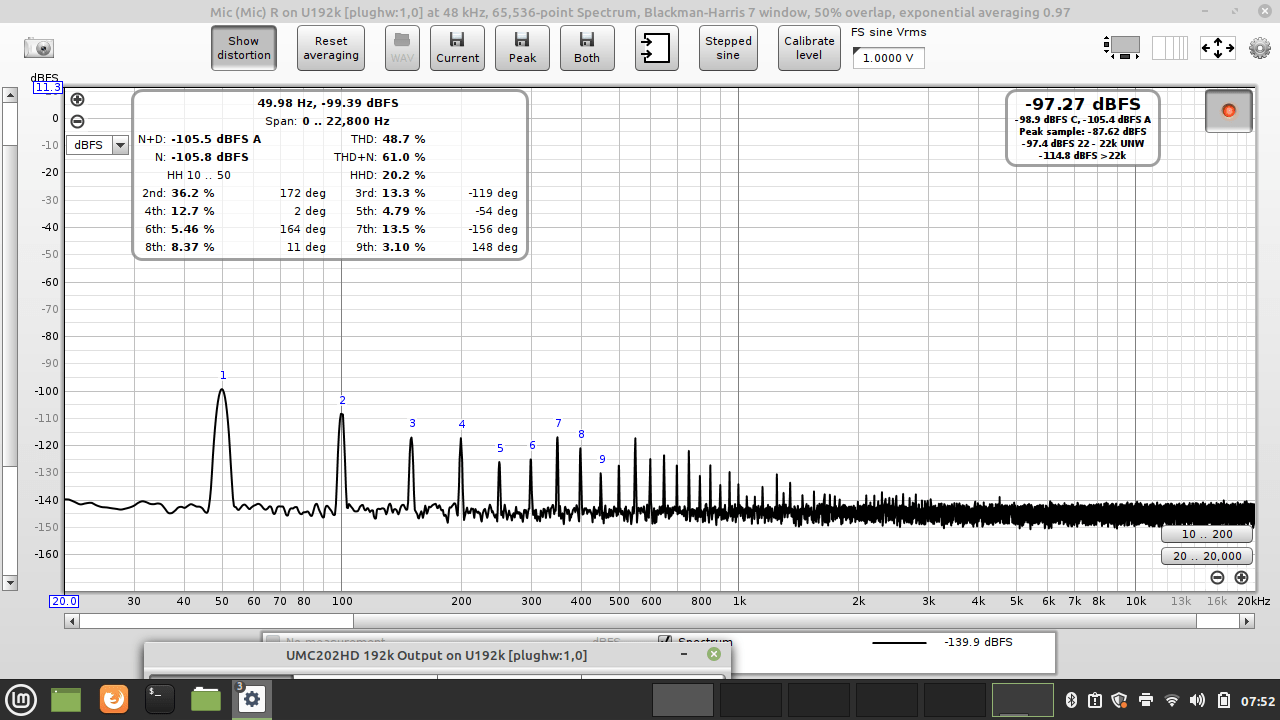

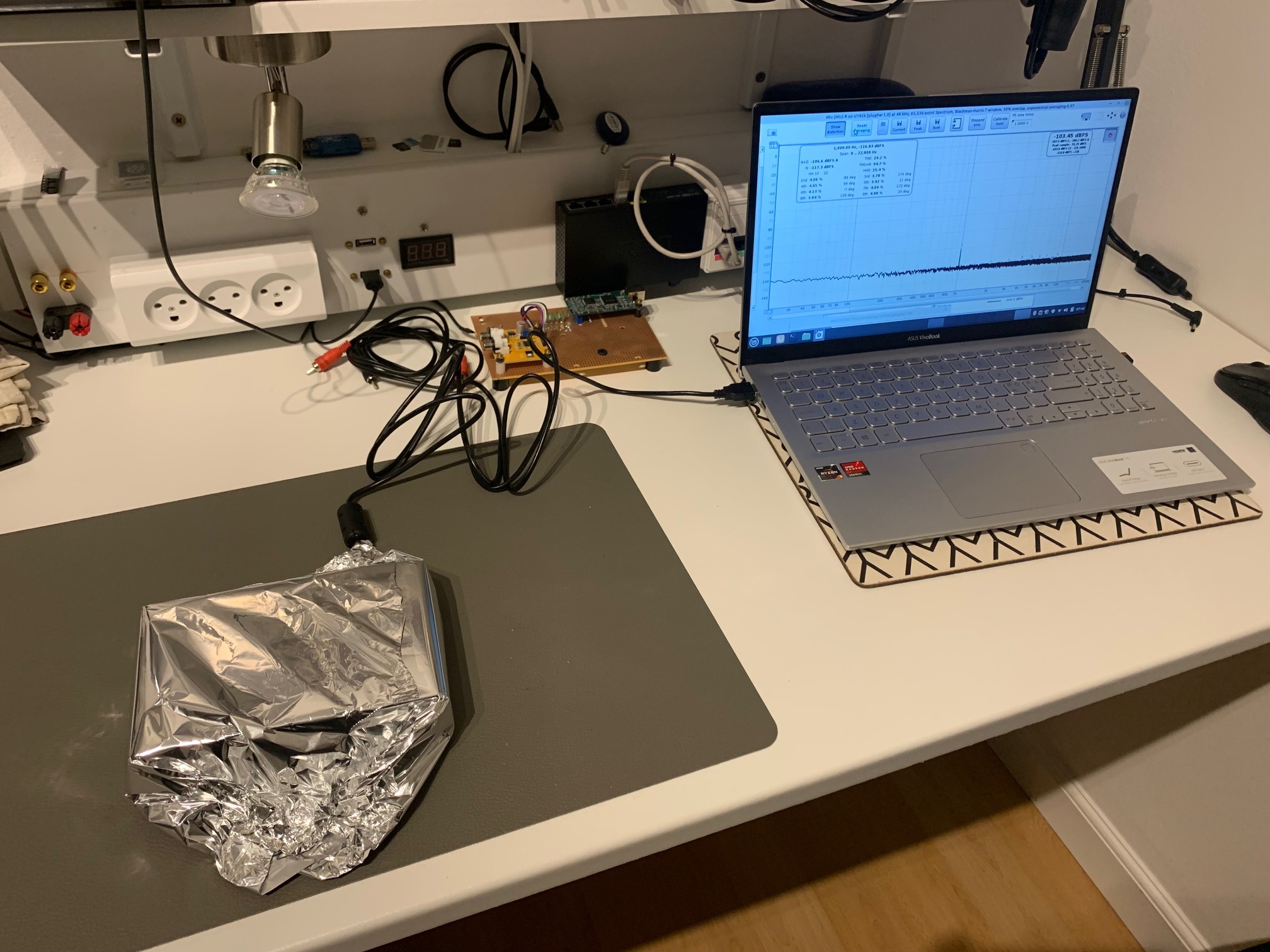

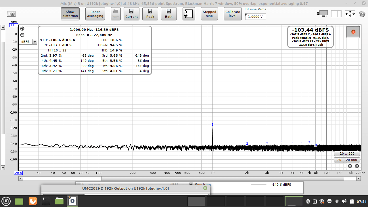

I tried cutting everything off (wifi, router, Philips Hue etc... cellphone etc...) looking at the spectrum at every step.
Unfortunately it didn't matter much in my setup.
So then i tried some alufoil to see if i could shield the EMF/RF whatever.
The result's are clear to me i guess?!, when the Behringer is all foiled up, there is no spikes.
When i plugin e.g. the input jack it act as an antenna.
Even if i attach the bare input jack end to my measurement rig i still got the spikes.
This is with no DUT, so it must be the Behringer or something in the air witch give the spikes?
There is also an attachment of the best result i can get, measuring my cloneamp.
Jesper.

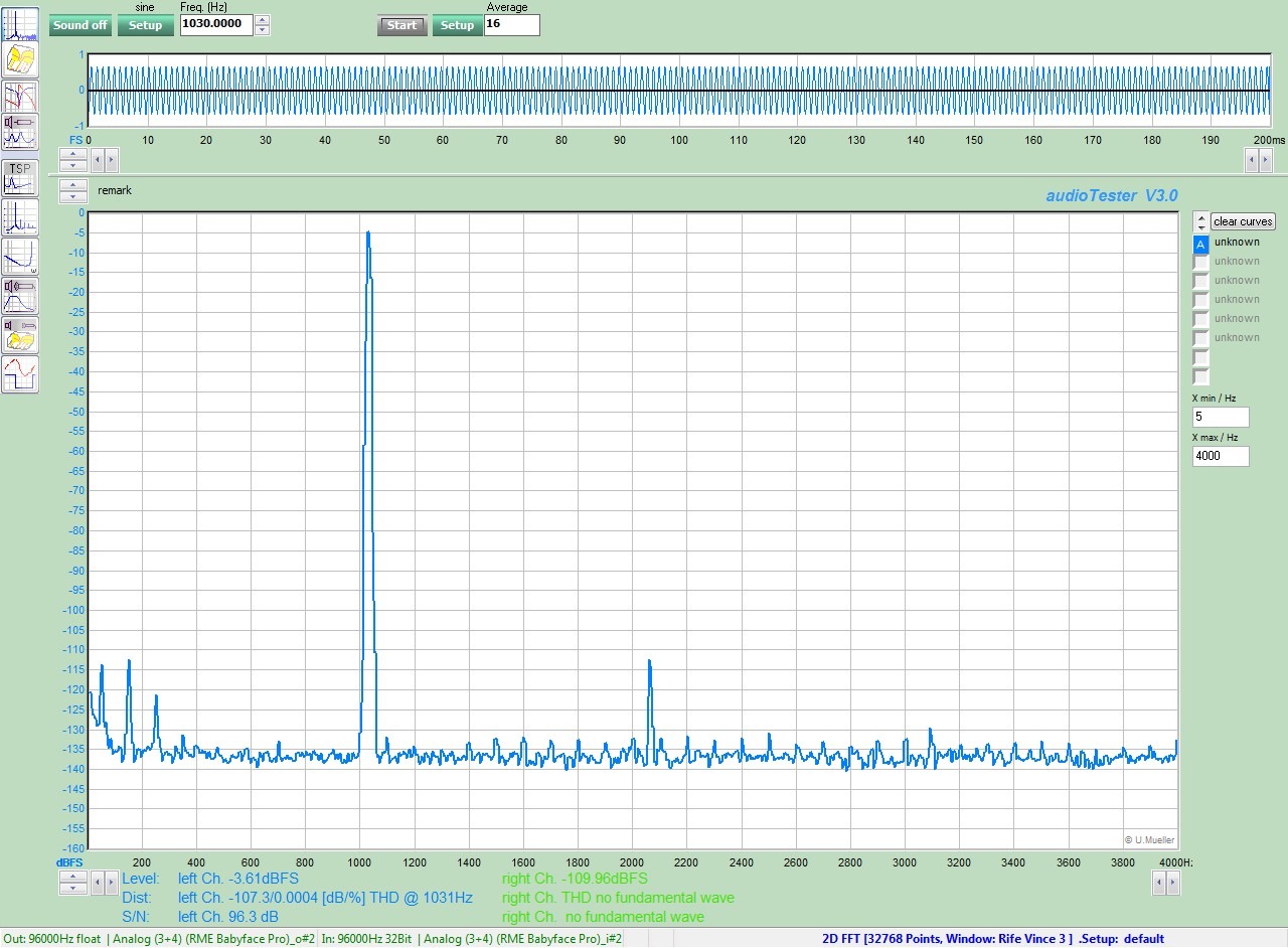

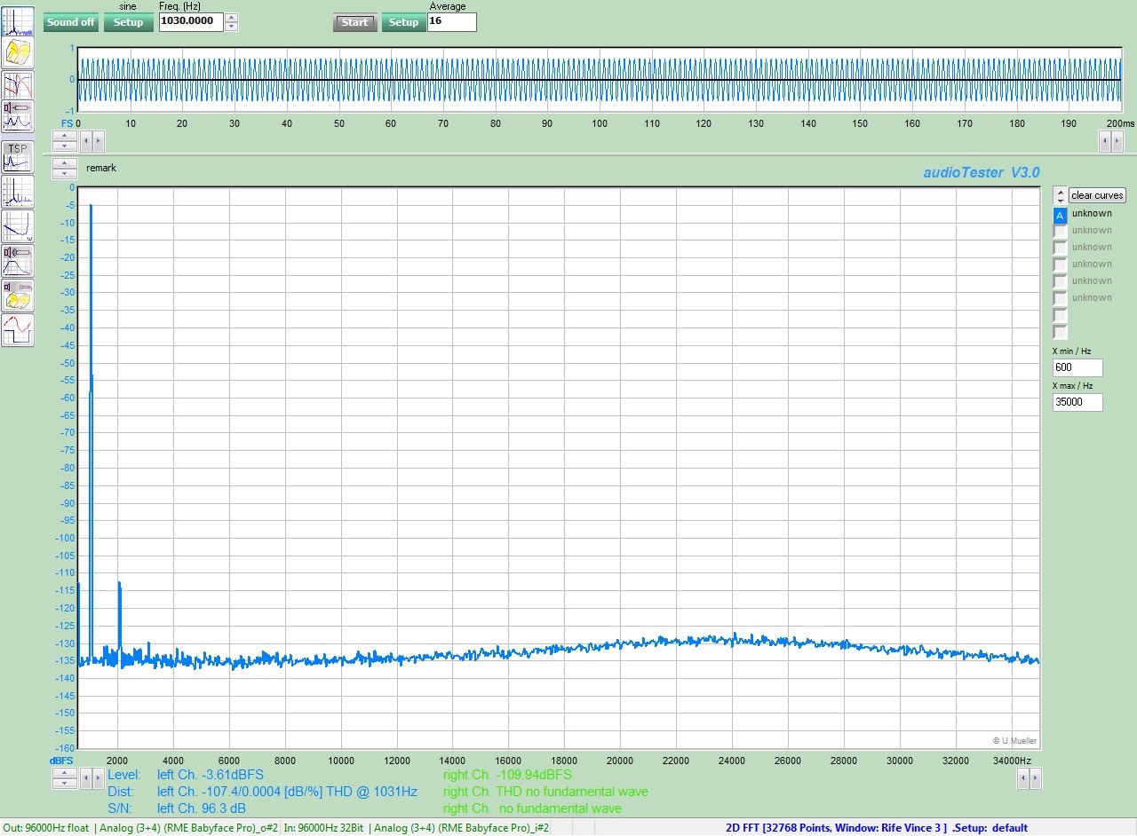

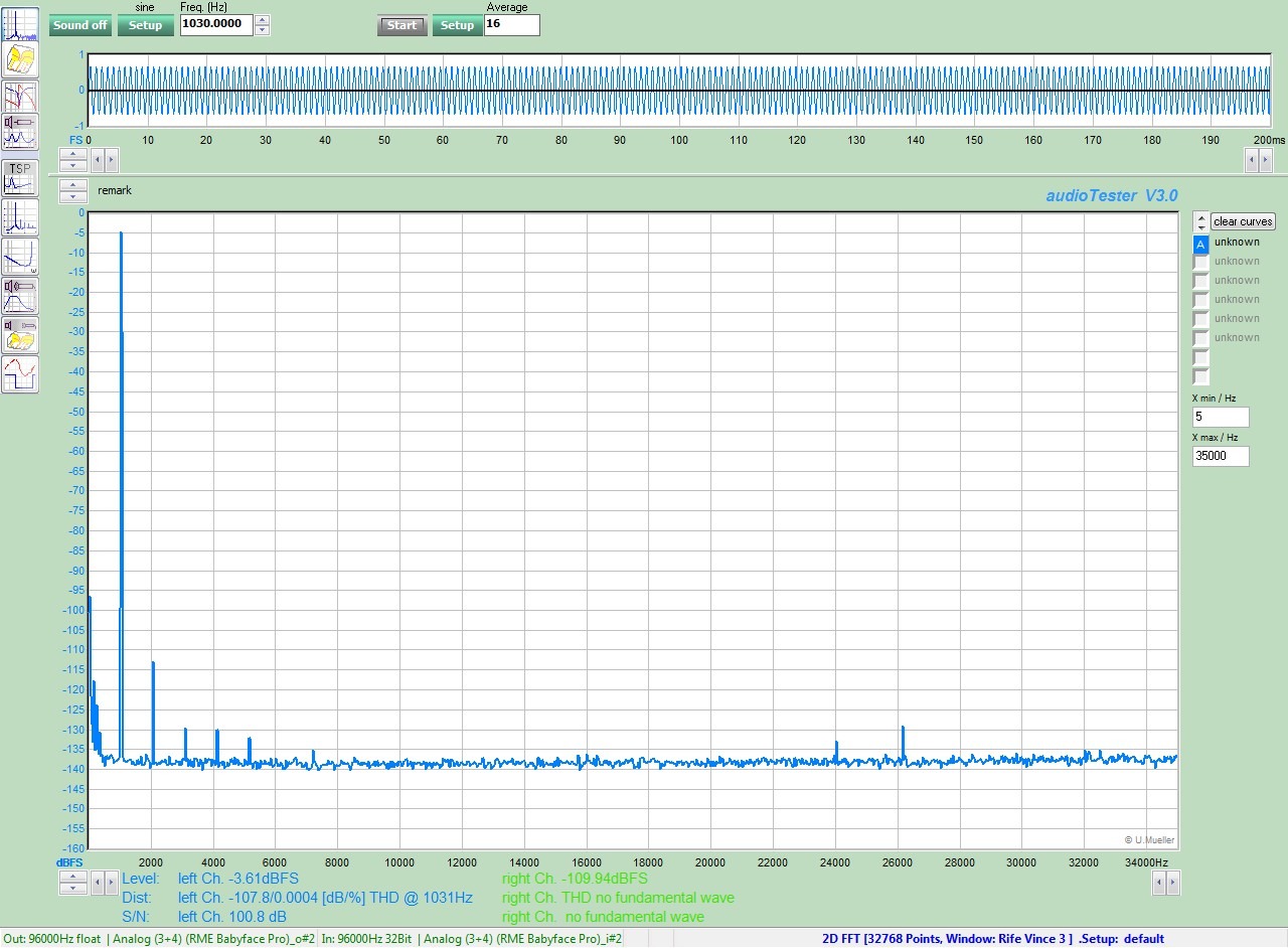

Hi all,
I did some better pictures of the external filter while I switched off the Fritz Box. Done with the RME at 96 KHz.
Loopback is the RME itself. Then two pictures of the filter in between. The bump of the noise around 24 KHz is the filter.
You can also see it in simulation.
Again the 50, 150 and 250 Hz is hum.
Alfred

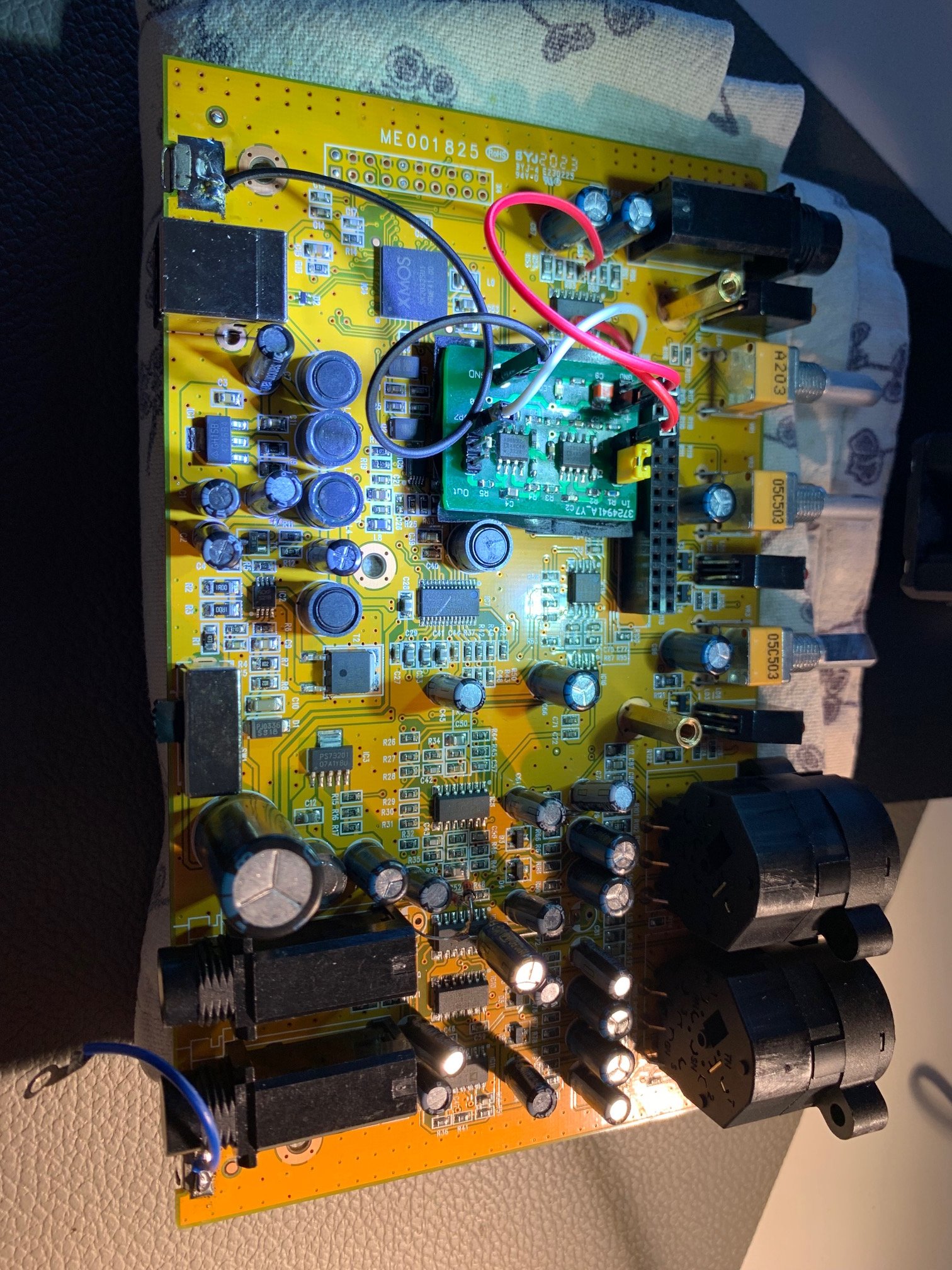

Morning all here...
First off, thank's to Alfred for being so patient, answering my quistion's.

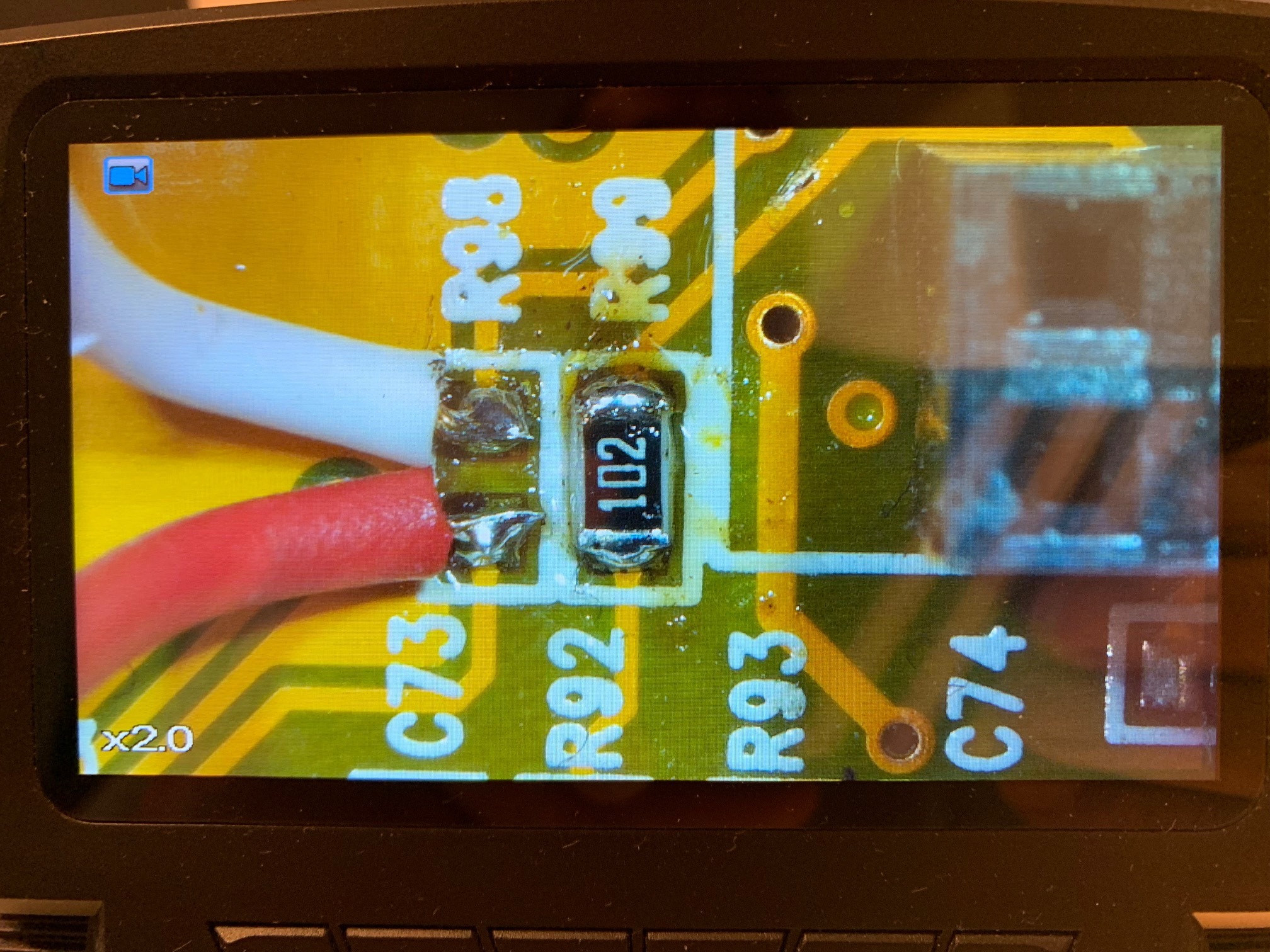

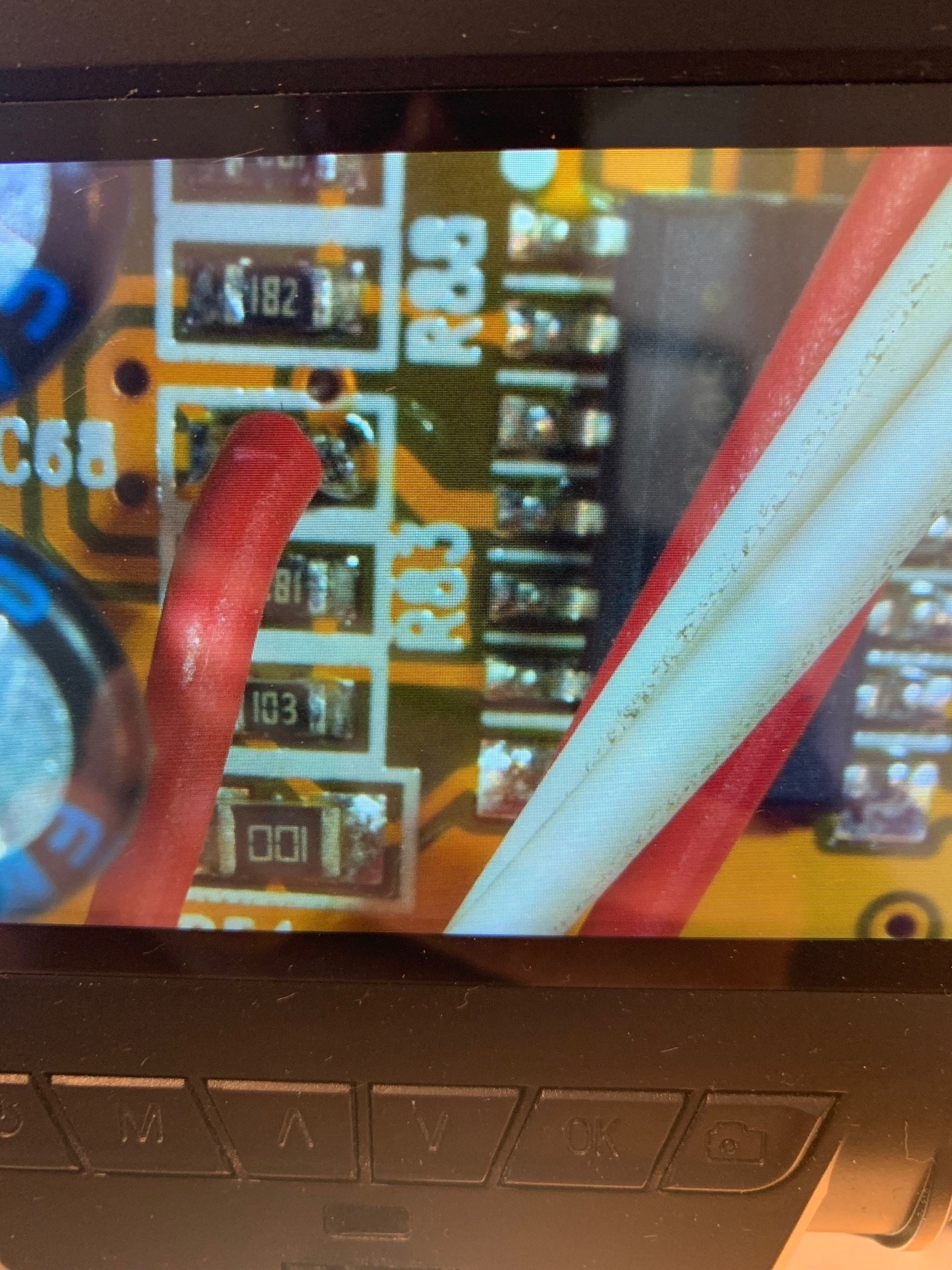

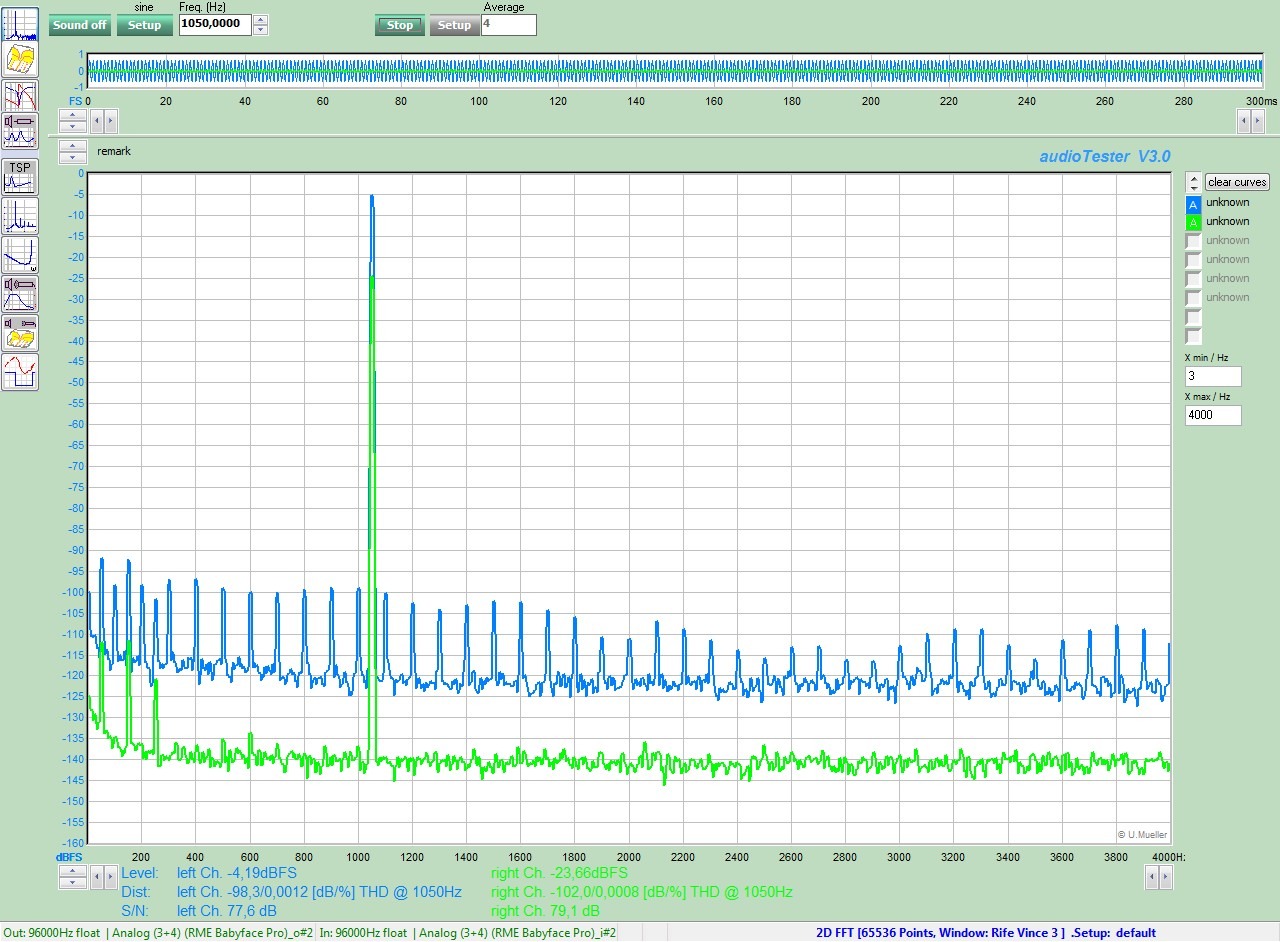

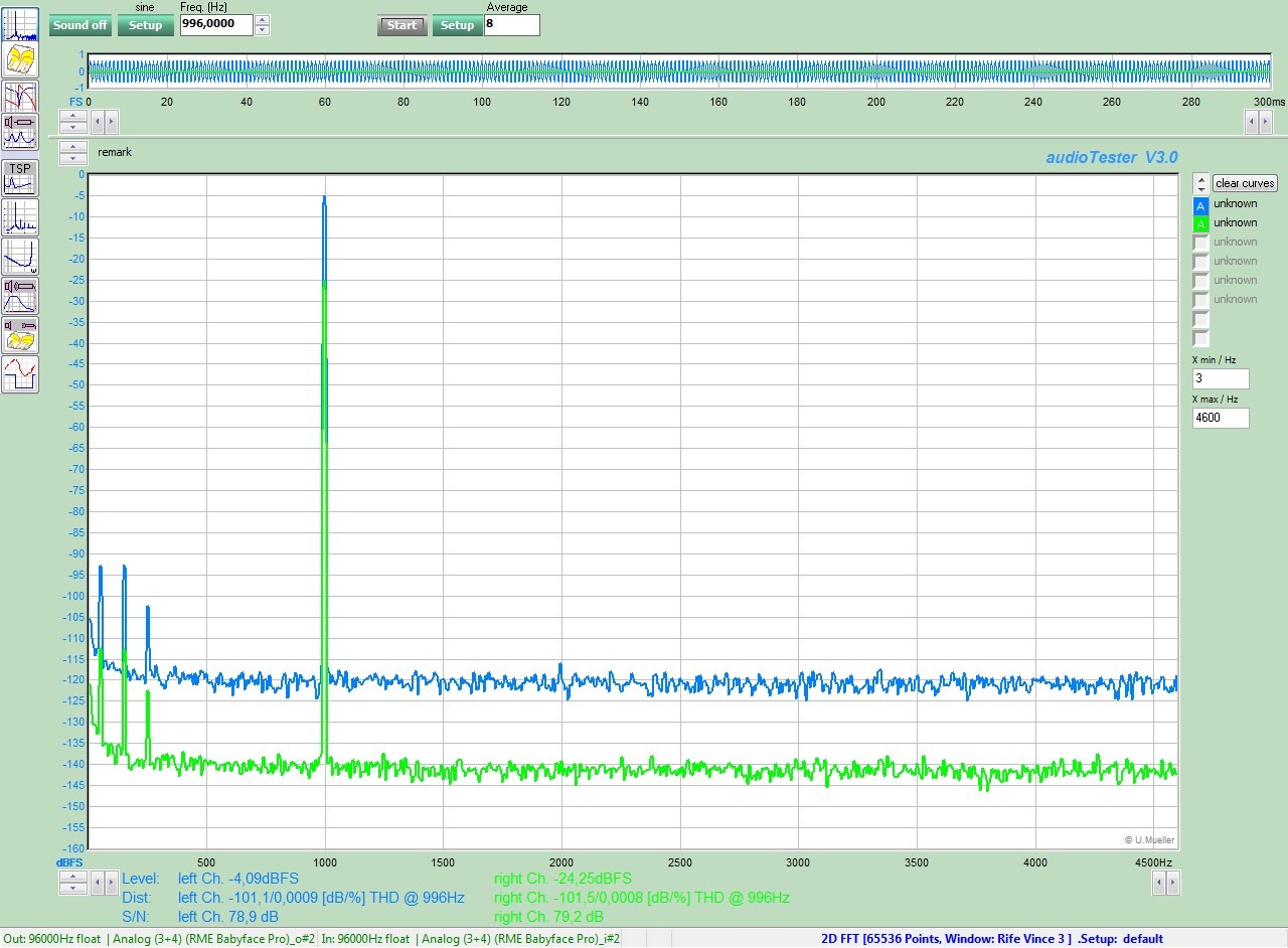

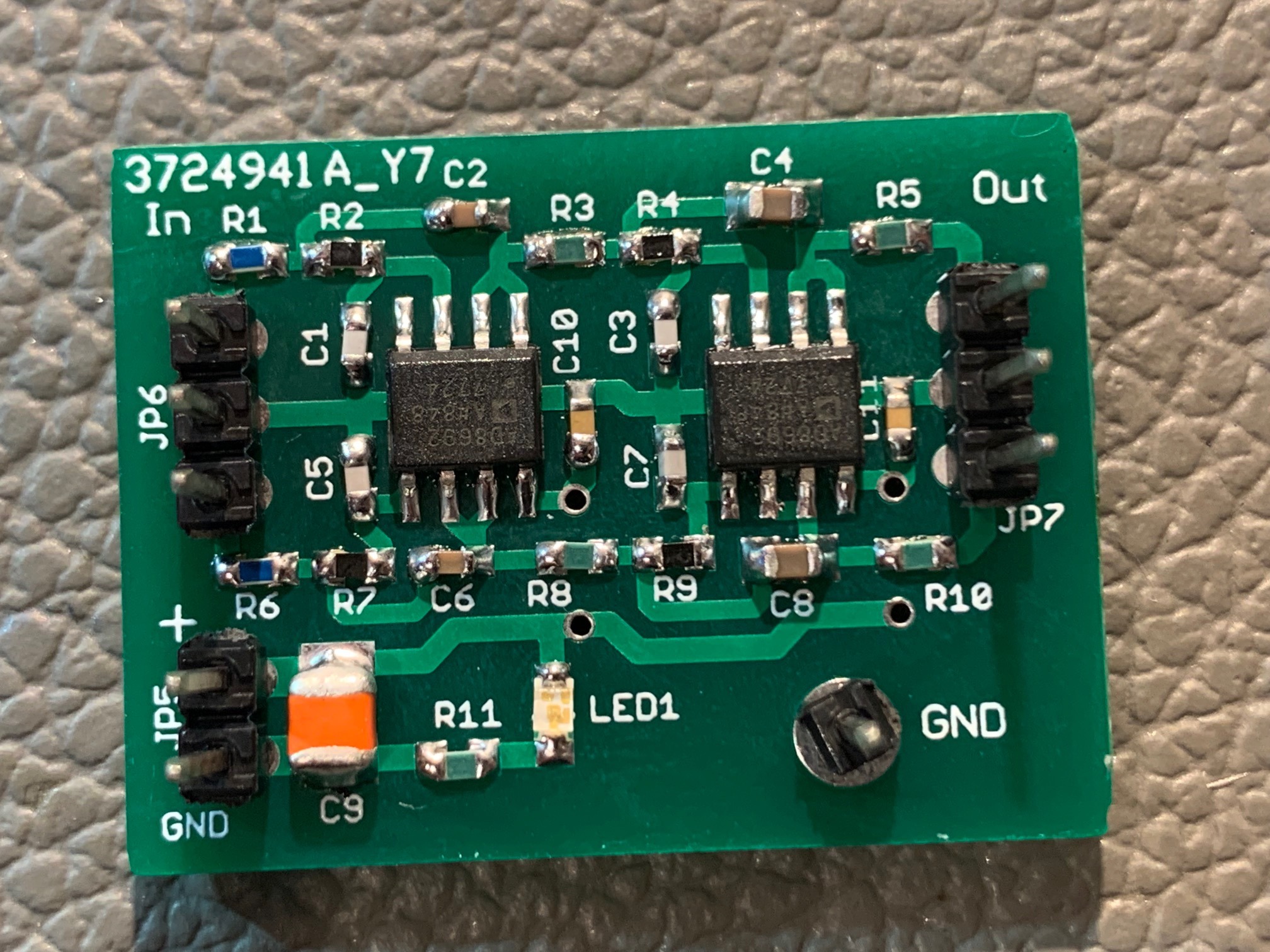

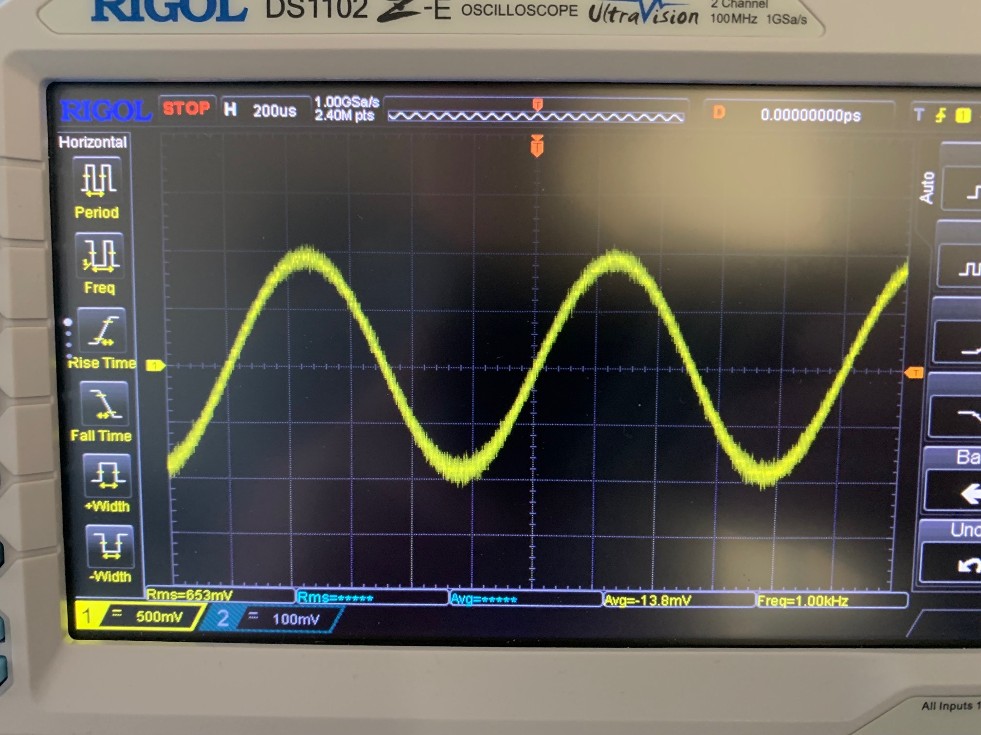

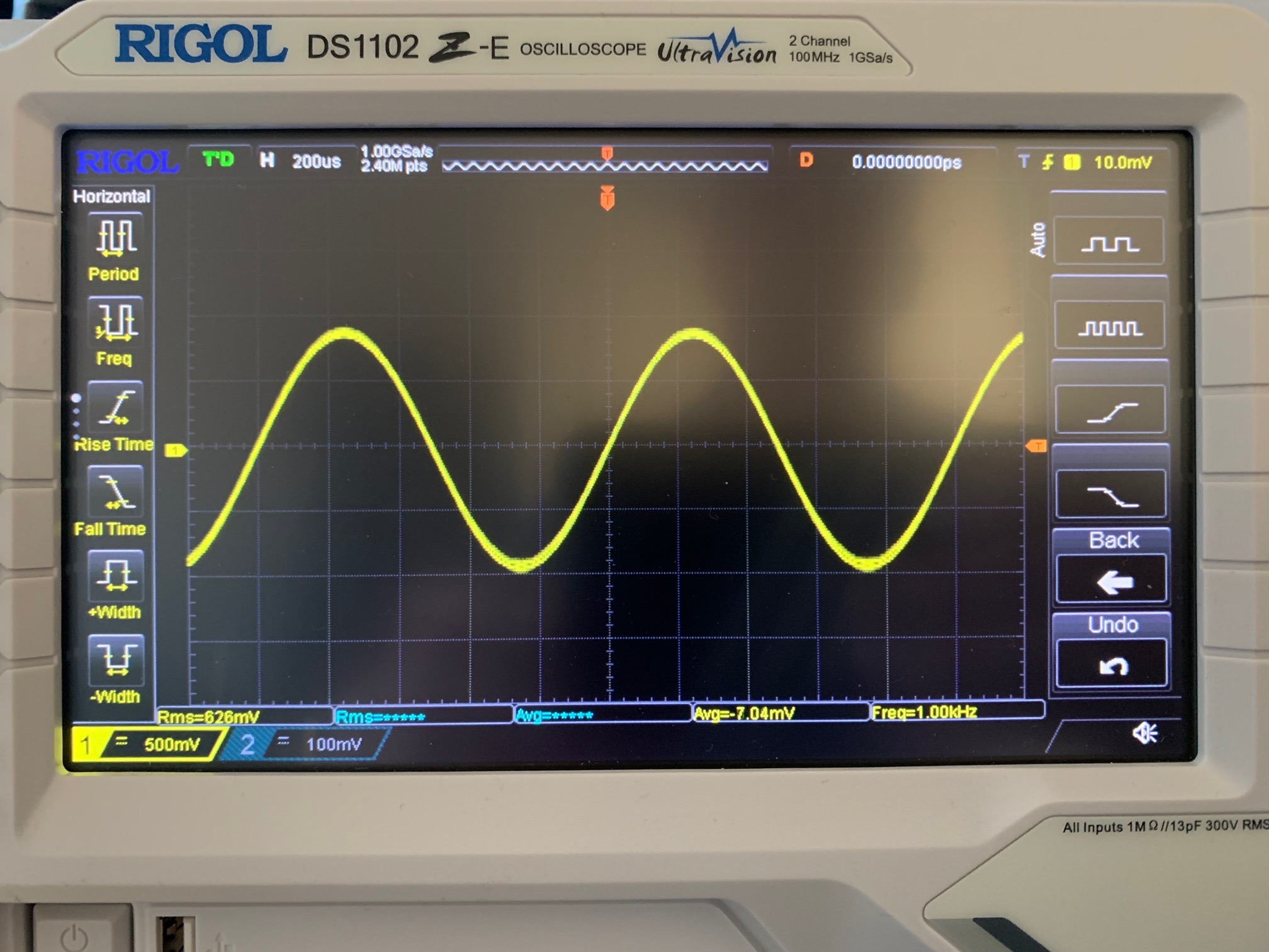

Well i build Alfred's 4. order lowpass 21kHZ filter.
To be very honest, it took me a couple of day's figuring out the purpose of this 4.order lowpass filter, but eventually i figured out, that it is an DAC output filter, better than the one stock with the Behringer. (The sinewaves clearly show's this / 3 pictures)
I was fiddeling around, and finally i installed the filter on one channel only. The filter is put in between where resistor R98 used to be. (Pictures 🙂 also)
So this giving me the possibility to compare. (With & without Alfred's filter)
So i now have the following mod's installed in my Behringer ::
Channel B (Right side) :
Input B ---> preamp bypass (YashN's mod) ---> // ---> Output B (Alfred's 4.order lowpass 21kHZ filter / picture of soundcard calibration shows this)
I also kindoff did an GND mod myself, connecting a GND pad on the pcb to the backplate / chassis of the Behringer...
More to come... stay tuned here 😎

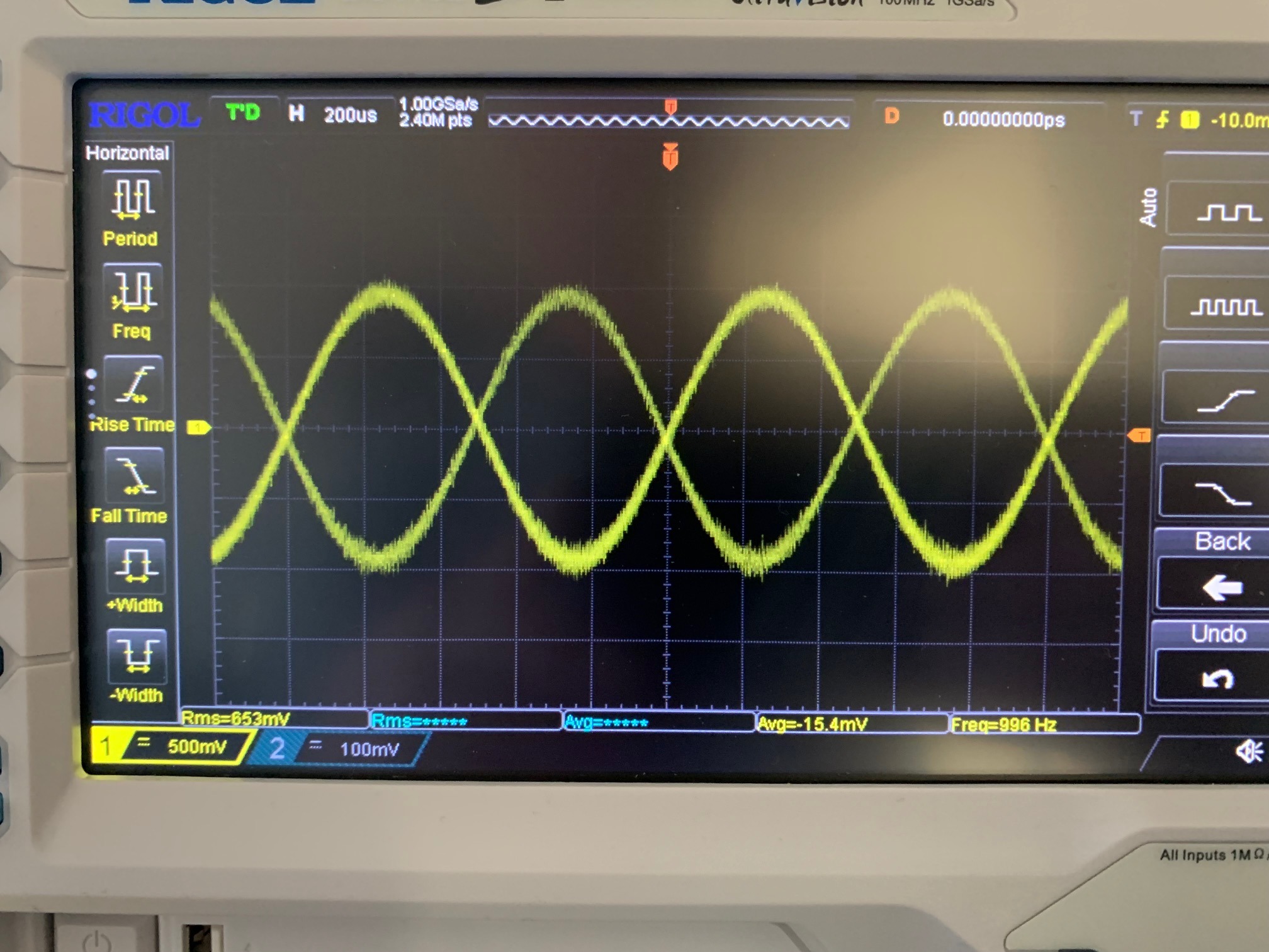

Probing the output of my EMU sound cards with a scope showed ugly high frequency noise as well. So I did some tests with low-pass filtering to smooth the sine waves which apparently worked. But the measured numbers of THD+N in the audio band did not change at all. What we see on the scope is outband noise, not nice on the scope - but beyond audio relevance. The same applies to class d-amps. The rf-residual after filter gives a smeared sine-wave which contributes to noise far above the audio band. We do not "see" music on a scope with a bandwidth of 100MHz or more, the bandwidth limited soundcard measurements are a far better representation of what we hear. For my lab applications only I have built a latFET class-B-amp.
Btw, a 21kHz filter is no bad option at all but must be bypassed if you want to extend measurements beyond 20kHz with higher sample rates.
