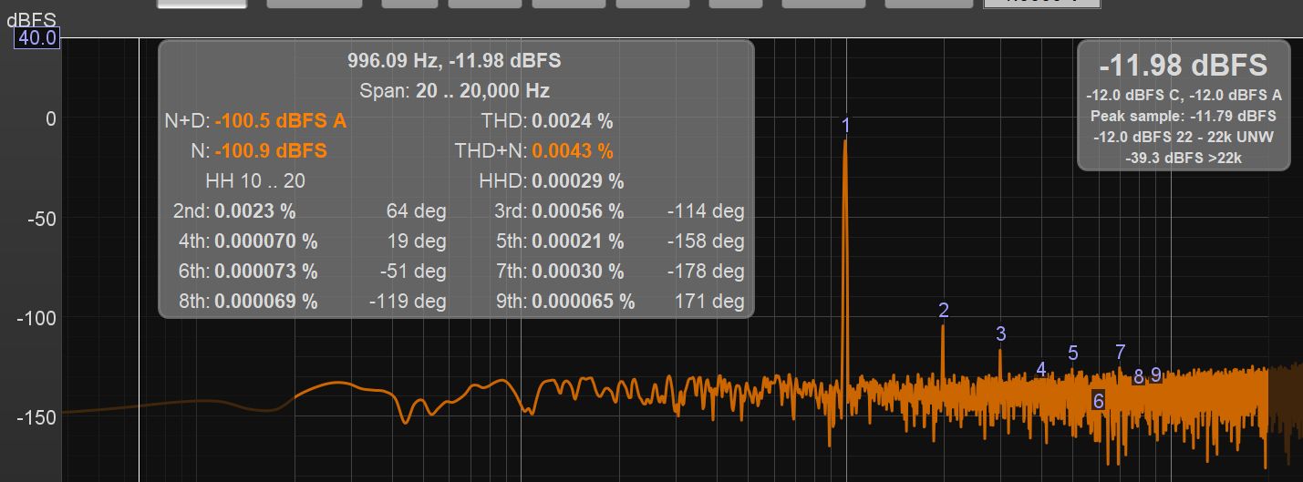

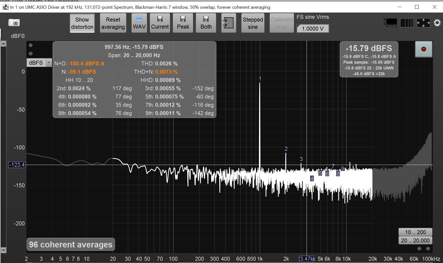

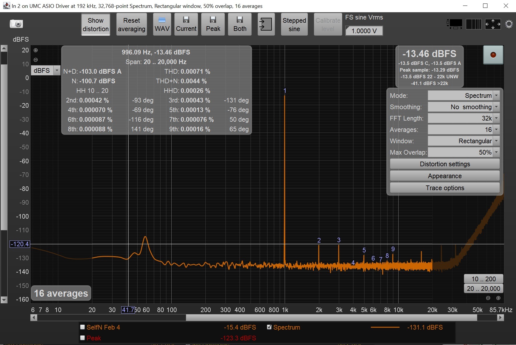

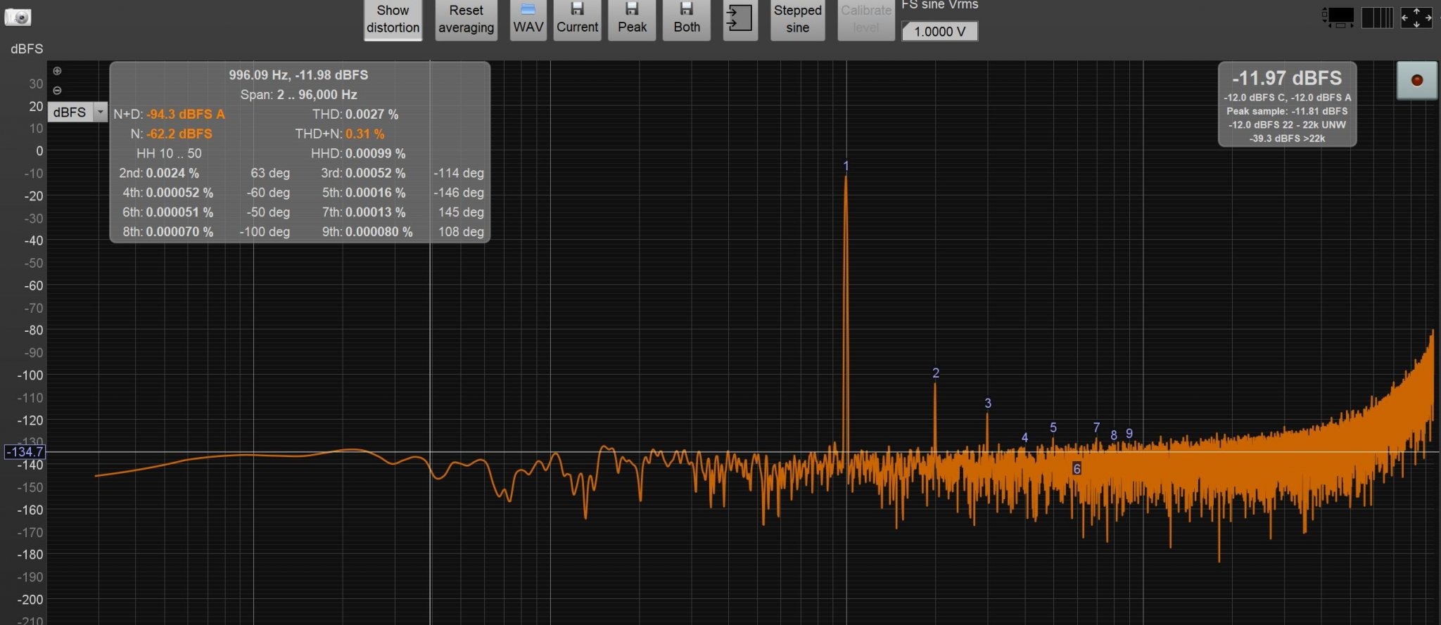

Bypassed the preamp. Success!
Right Channel only. My initial mod for the Left Channel had a flaw I didn't test for: one of the diodes wasn't soldered properly, so believe one op amp went kaput. Reused the existing XLR/TRS jack.
It's fine, I can do a lot of things now with just that one channel.
A little comparison with before (and just by adjusting settings in the software, we can do even better than the above too):

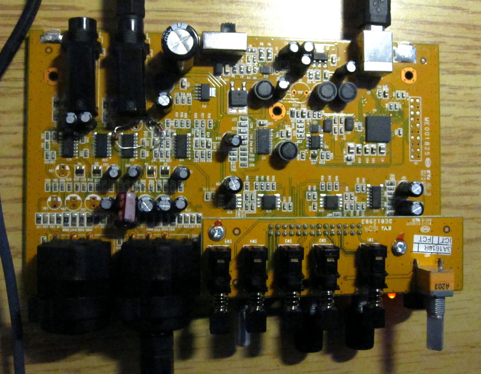

The board with mods:

You're right, Jesper: it's my own spin on a useful mod in the simplest way possible. This can be reversed easily enough: remove mods, then put back the original caps. No relays, no switch, no drilling, no additional switched jack, no trace cutting, no PCB, no differential.
Here, I am not too concerned about switching the original circuit on and off.
It's for single-ended measurements only.
Requirements:
  • One Cap. Either re-use C35 or use a new Cap of your choice
  • Two small-signal diodes
  • Thin wire
Mod Procedure:
For the Right Channel, and orientation as my board in the pic above:
  1. Remove C81
  2. Remove C35. Keep both caps in a safe place for reversal if ever necessary
  3. New Cap +ve goes into C81 -ve pad
  4. New Cap -ve goes into C35 -ve pad via thin wire
  5. Diode 1 goes from C35 -ve pad to bottom of C52 (C52 is the small SMD Cap on the left, diode black marking is oriented down on the picture)
  6. Diode 2 goes from bottom of C51 to C35 -ve pad (C51 is the larger SMD Cap on the right, diode black marking is oriented up in the picture)
NB:
  1. Tip: solder the diodes by the end pointing towards the C35 -ve pad first, then the other end to the SMD caps. Pre-cut and pre-bend the leads before soldering
  2. After soldering, do a continuity test to ensure that both diodes are well soldered, or even nudge them a little with a plastic tool to make sure they're staying put. Had I done this, my Left Channel would still be working as I would have caught the faulty soldering in time.
Use a mono cable for the loopback test and then for measurements. Plug it into the existing XLR/TRS jack.

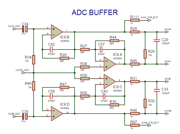

Hey thank's ...
I'am trying to understand the mod, but C51,C52 are not on the schematic. (I did not look at the pcb by now)
I will proberly take a look later today on my pcb.

You're welcome.
Just look at my pic of the board where the diode legs get soldered. Zoom in if necessary. You'll see the labels on your PCB as well.
These are PSU-related caps. I don't think bobun traced these, but his schematics are still very useful with some caveats.

Yep... okay i then better understand why i could not find them.
I allready did the "Direct in" mod https://www.diyaudio.com/community/threads/behringer-umc-202hd-for-measurements.341309/post-6898991, where i removed C34 & C35, letting them be bypassed when inserting into the extra TRS jack connector i drilled on the back.
Is this mod more or less the same ? Except that with your's we still have the coil L15 and the capacitor C90 in your's line in connection?
