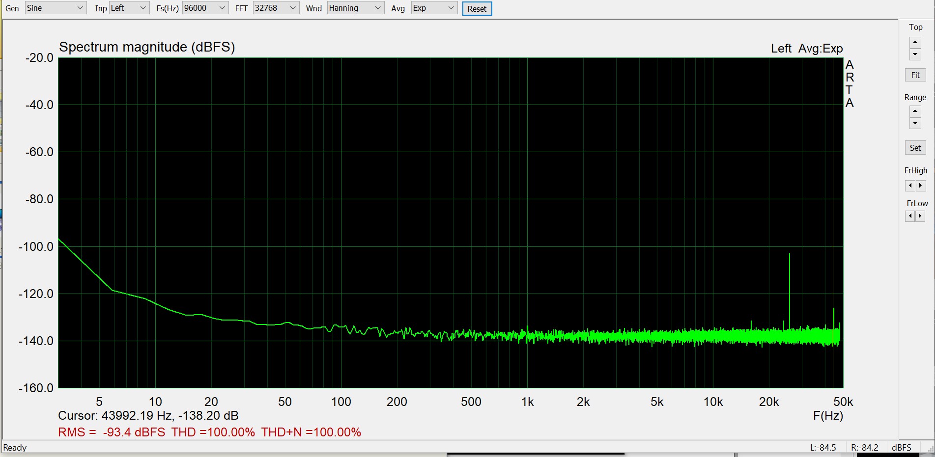

I don't see any problem with your soundcard. As it comes from the factory, the best it can do is what you post, I think. The raised noise floor is because the enormous input gain. The same explains the sensitivity to environment conditions. Could you repeat with all gain controls -input/output- completely turned down?
Regarding this high frequency peak, it seems it's not consistent in all specimens. In mine, it was shown much lower within the audio spectrum. Having it already above 20kHz I suggest you should ignore it since this soundcard is actually meant for viewing audio only.

I don't see any problem with your soundcard. As it comes from the factory, the best it can do is what you post, I think. ... Could you repeat with all gain controls -input/output- completely turned down?
Here's Output Gain approximately as before around 2 o'clock and Input Gain zeroed. My dynamic range is lower. NB: I haven't done any calibration in ARTA.
And here's both Input Gain and Output Gain zeroed:
If you meant that the default audio interface results look not far from that first one, similar to your first graph in this thread, I can see similarities.
The other difference with mine is the seemingly sample-rate related spike at around 26kHz.

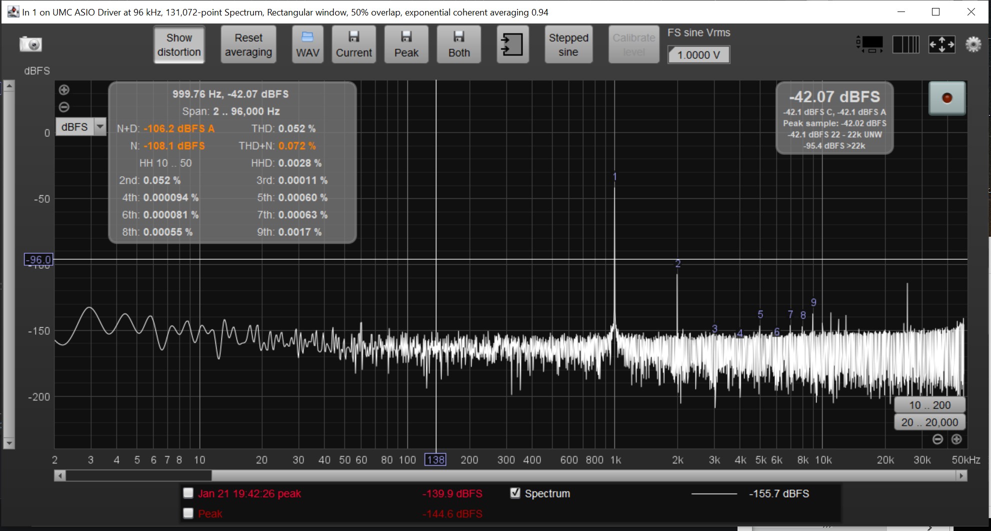

There seems to be some misunderstanding: Setup input gain to minimum, but no, do not set output level to minimum but close to max. Do a loopback from ouput connected with input. Increase output level until best THD readout is obtained. Should be somwhere between -10 ~ -2dBFS of output.
Your plot shows a 1kHz input level of -60dB - far too low, no wonder that a poor THD results.
As a starter set generator level to -6dBFS and do a loopback test
...set output level to ... max. Do a loopback from ouput connected with input.
Everything you see is loopback.
Do you mean 'Increase input level' here?
I did something like that initially with no averaging, and hence I could monitor THD as well as harmonics visually near-realtime after resetting at each position, at -6dBFS as R.E.W. suggests.
Correct. Even R.E.W. warns you about the low threshold when you attempt to calibrate the audio interface at that level.

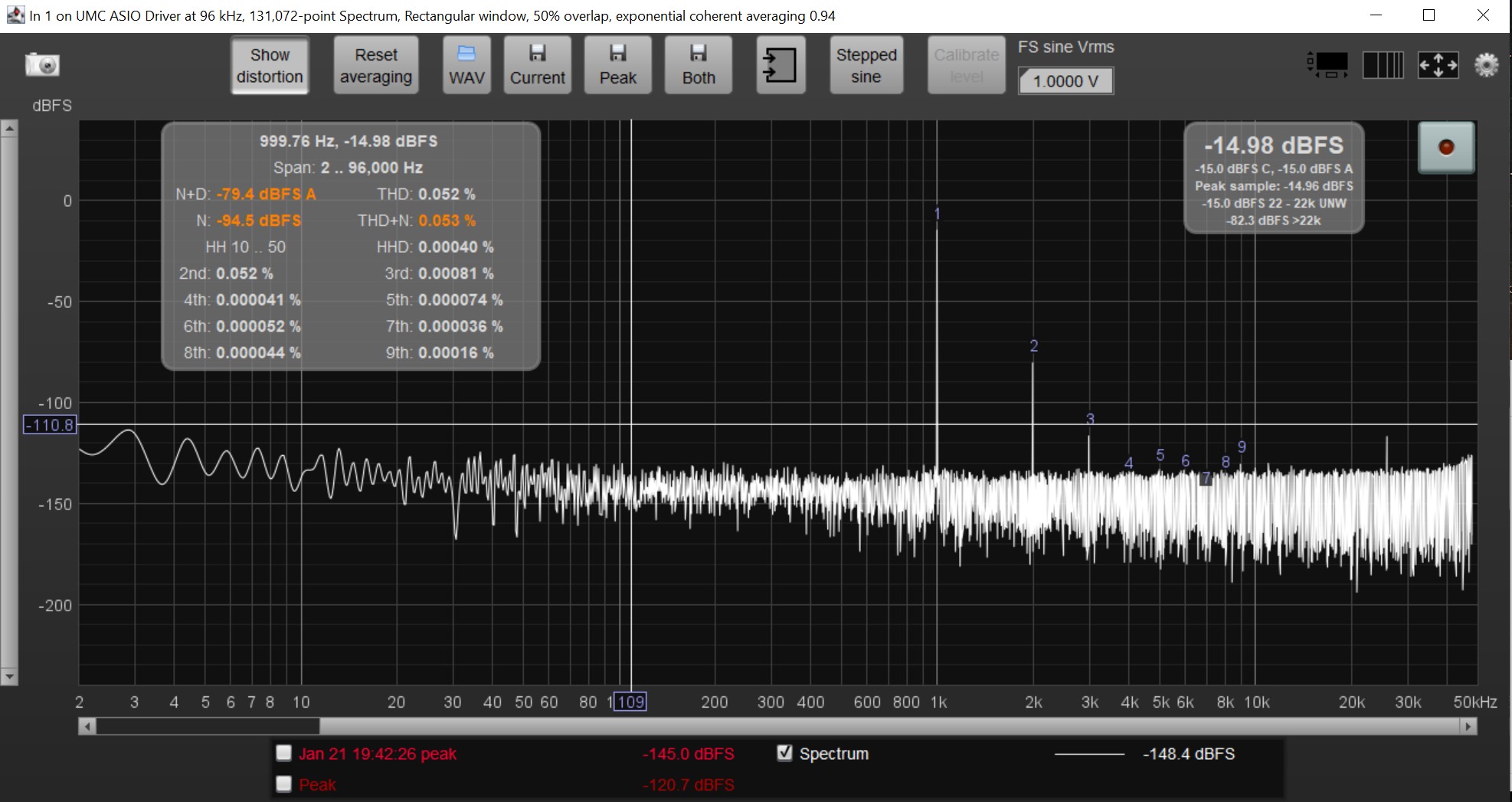

Here's a new test, Input Gain zeroed and Output at around 1 o'clock. There's a spot in this region around 1 - 2 o'clock where the THD will jump from 0.0xx% to 0.1xx% or 0.2xx% abruptly:
Not sure I calibrated Volts properly: only got a non-True RMS DVM, so I must probably revisit and multiply by a factor in R.E.W.
Yes, occurs when REW does not find the 1kHz fundamental i think.
Increasing input gain to adjust level is definitely the wrong way when ouput level is too low.
You have to increase the output level instead. Do not use headphone output but line-out.
I do not know your soundcard. With mine I do not set output level with an analogue potentiometer
but by REW-software: "Set generator level" -> xyzdBFs.
Indeed, there are too many parameters to follow here. Please have another round with all this but with sampling rate set at 48kHz. CS4272 has the typical noise shaping that keeps THD+N low only up to ~50kHz. If you set the sampling rate higher than 48kHz then the average THD+N is ruined.

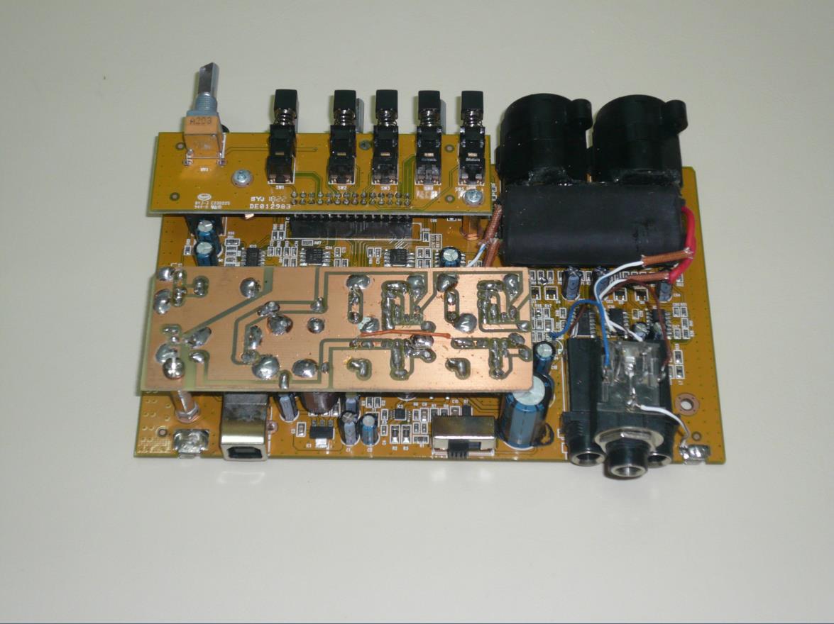

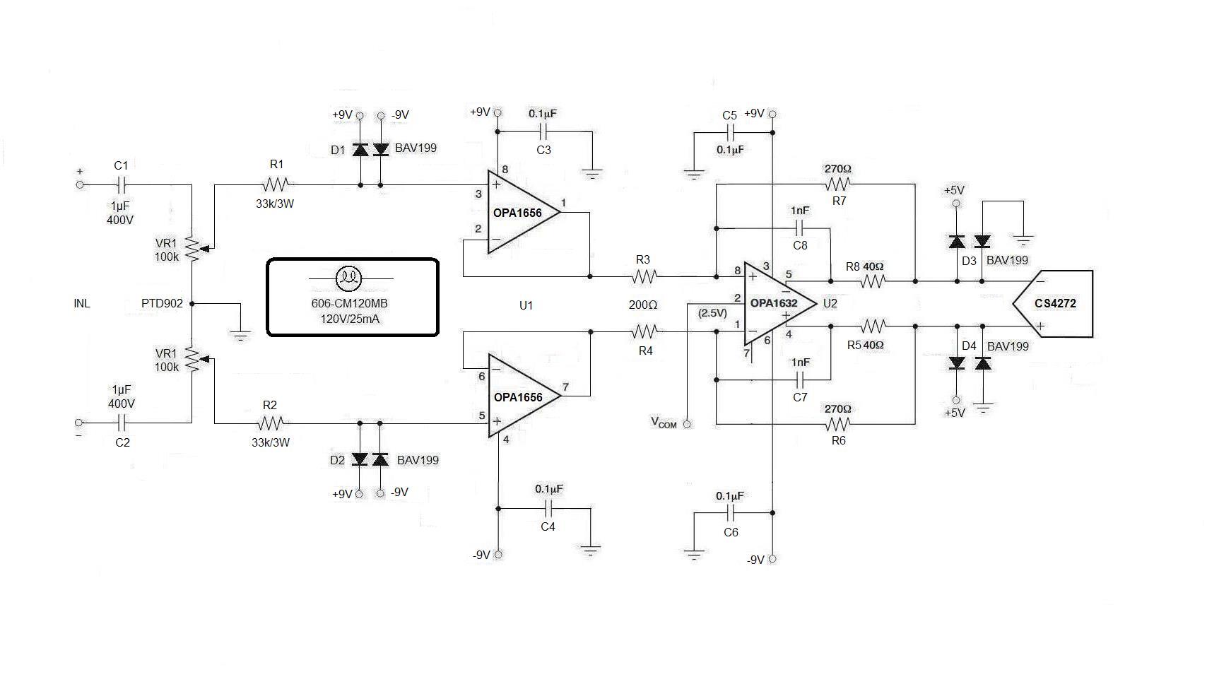

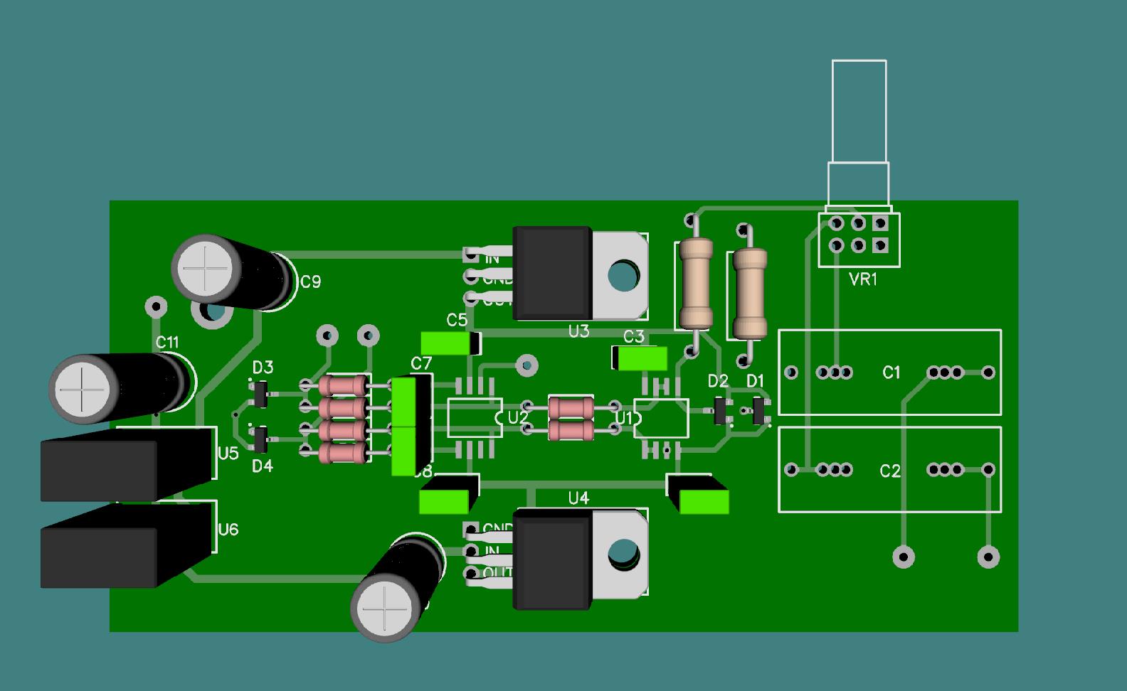

So, the UMC202 checks OK at least for usb microcontroller/drivers and audio codec. Let's give it a chance! I'm not going to test this. I'm giving it for everyone who wishes to try. It's a small pcb made to fit inside the chassis like the one shown in the first pic. It is based on the input stage of my diy soundcard that proved stable and indestructible for more than two years I've been using it so far. It bypasses all circuitry in front of the ADC and provides a new input, high impedance, true differential floating with attenuator and overvoltage protection, ready to accept an amplifier.
Some comments on the parts. There are a few smd but they are manageable with an ordinary soldering iron. Do not use different opamps. Resistors should be low ppm - I used 50ppm- and small caps should be C0G. Input caps at 1μF/400V may be a bit optimistic since there is not much room for these. Then again, 100V should be sufficient protection. Anyway, go for the biggest you can fit. Electrolytics C9/10/11 are 100μF. R1/R2 are the current limiters. Admittedly, plane resistors are not the preferable option. You could improvise using other schemes like back to back mosfets or something. What I used is incandescent lamps. Finally, the psu takes 5V from the usb post and boosts to +/-12V. U5/U6 are the DC converters. I don't provide a specific part number because the global shortage might make it difficult to source. But there are quite a few that would do. Search for SIP-4 11,5*6mm, 5V in, single 12V out no less than 50mA. These do not feed the opamps directly. If you wish to do so, then use 9V DC converters as higher might stress the OPA1632 in this application. But I thought to provide for linear regs U3/U4 for additional filtration. Starting from LM7809/7909 to whatever out there is made as a replacement to them, like LT3042/94 which is what I used.

Looks pretty good. You could improve noise performance furthermore by
reducing input impedance: 10k potentiometer, 2k2 series resistor
Increase gain of first stage a bit
decrease gain of second stage a bit
