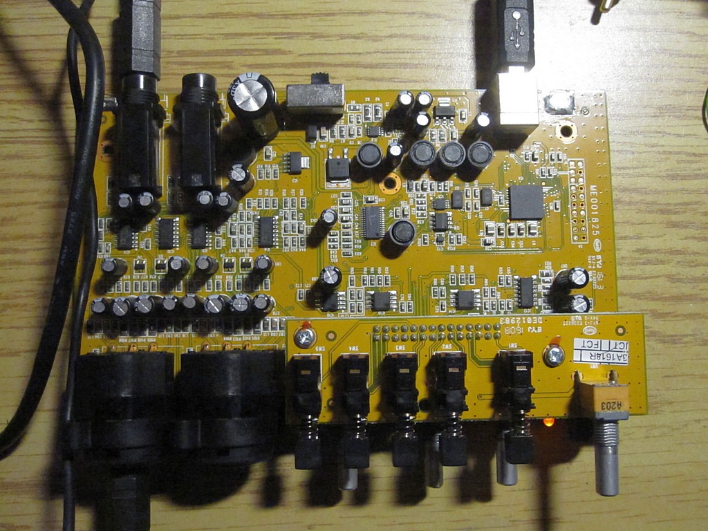

There is only one 3,3V regulator for all the chips - the XMOS microcontroller, the flash memory and the PLL clock. Sadly, even decoupling capacitors are missing. And then this power rail goes to the audio codec digital supply via just an inductor. I think this may be the culprit for the high pitched noise after all. It would be very interesting if somebody could try to separate the audio codec from the rest. The mod seems very easy. Just remove the inductor L11 and feed the CS4272 from another 3,3V LDO.
I think this is worth to try too!

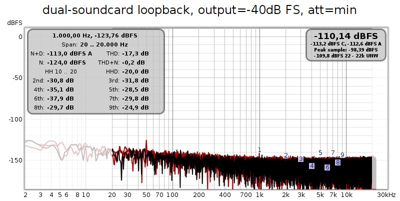

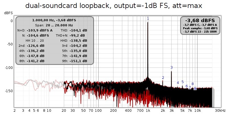

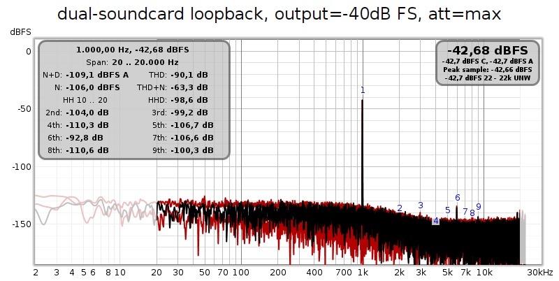

Meanwhile I reworked my test setup to further improve THD+N performance. Loopback investigations revealed that the residual noise I observed was dominated by crosstalk from the active output @ -1dB full scale poisoning the input signal. I had a feeling that there must be some room to improve dynamic range. All in all this looked like some internal ground loop issues of the EMU-Tracker.
After some fiddling I decided that improving the sound card accordingly is beyond me. Facing an I/O crosstalk problem next approach was to isolate in- and output channels. Luckily I hace a second EMU-sound card in my stash, and so I used the EMU-TRACKER for output exclusively and the EMU-0202 solely for input. The audio path is routed balanced through a 3-pole low pass filter to reduce generator noise and an attenuator (passive). Both USB devices are driven from a single laptop PC running REW under WINE/Linux LMDE3 (meanwhile deprecated). The in/out channels were assigned in the pulseaudio sound setup. The laptop was mains powered all the time.
These are my actual results with REW:
I always see a spike at 24k AND another one at 48k (so high freq).

I opened up the Behringer UMC202HD this morning and had another look at it, and while doing a search online, found this:

The problem with UMC202HD is that it stacks unnecessary gain stages introducing distortion and reducing DNR. This thread's project was about bypassing these stages. That leaves us with a very good audio codec and a nice usb to I2S converter at a considerably lower cost. I've been thinking about the next step on this conversion. I believe I'll have something to post in the weekend...

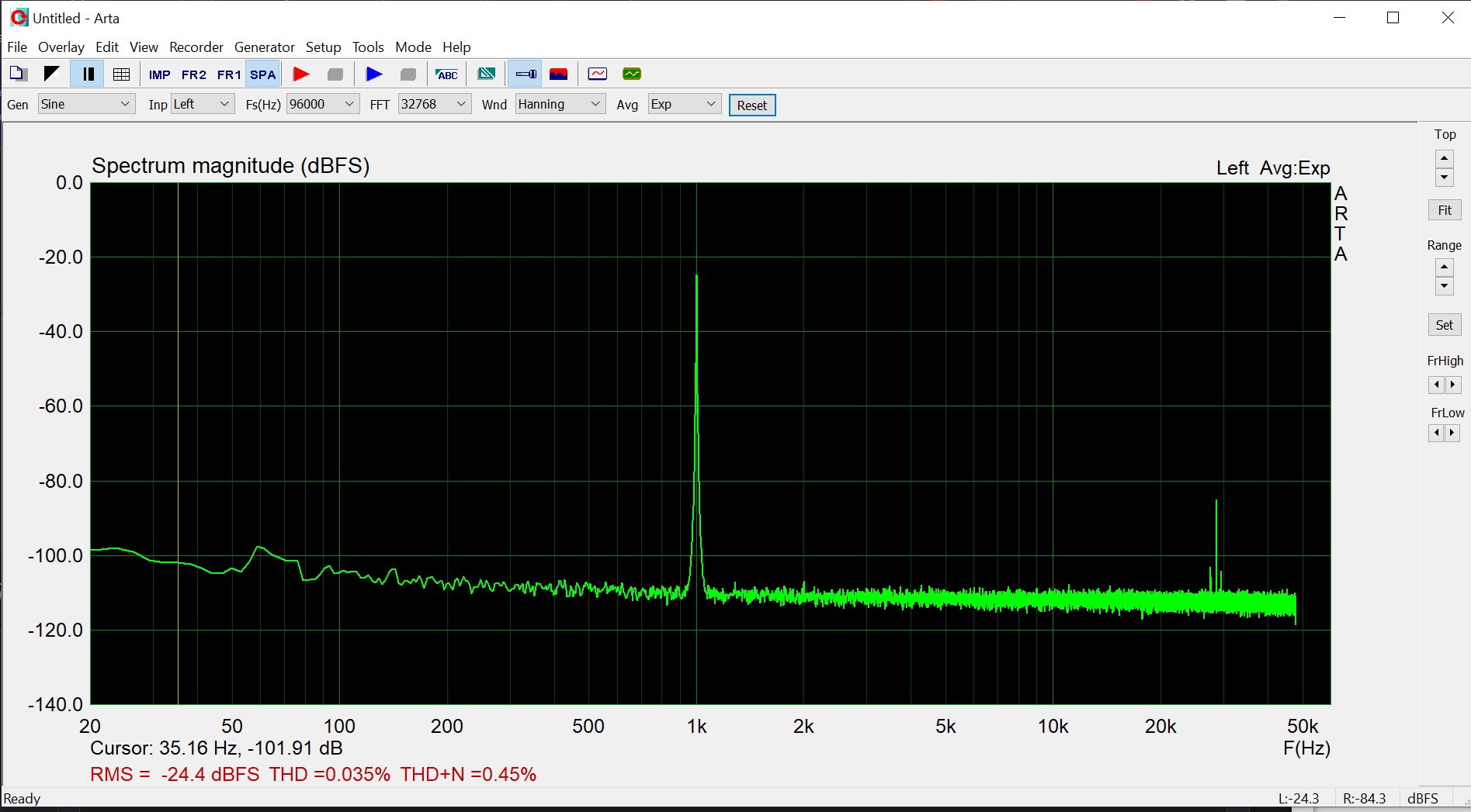

Where I am today (no mods):
And a quick test (no cal.) shows the high freq. spike on the right:
Input gain is approximately at 9 o'clock, output is at 1 o'clock or so., no preamp, no direct monitoring.
My noise floor seems worse than what others have, not sure, what do you think? What about THD here?

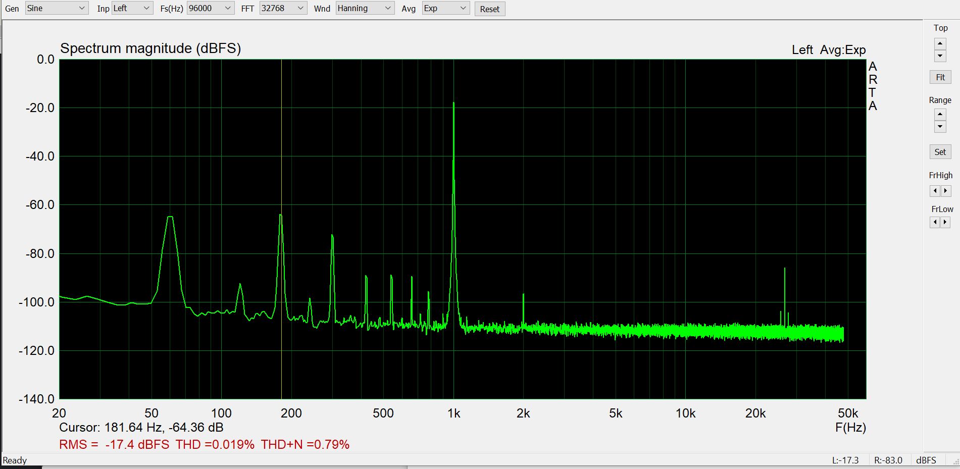

Moving the board on top of my desk PSU and turning the latter on, getting max peaks when the XLR region of the PCB is near the PSU:
The board makes for a pretty good mains interference detector 😀

No scope was needed to show that interference, just the PCB is out of the box and then I oriented it over my desk PSU.

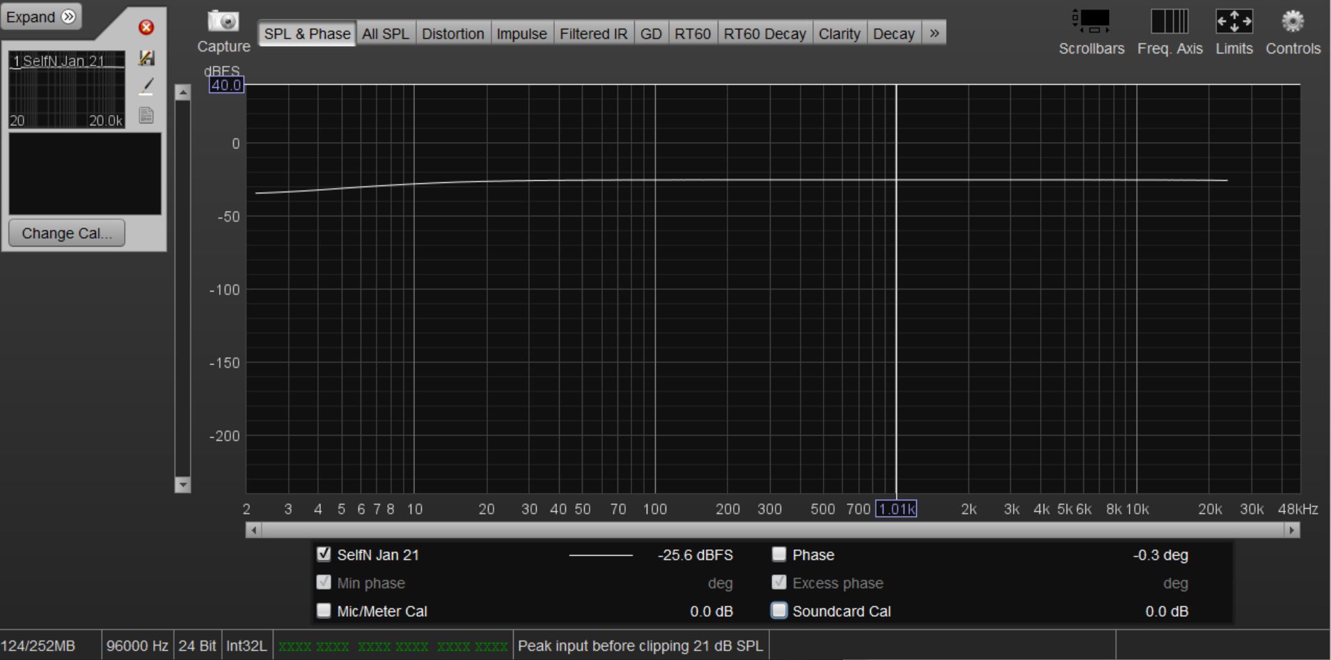

Now I see another problem with R.E.W. and ASIO. I get an error today, something like 'Device Reset Request' and 'soundcard didn't provide any input data from ASIO'. ...
OK, here's what I did to recover from the ASIO error above with R.E.W.:
  • Disconnect and re-connect the soundcard (USB cable computer port side)
  • In R.E.W., change from ASIO to Java.
  • Change back from Java to ASIO
  • Set the ASIO rate, Control Panel Buffer, etc...
I don't see any problem with your soundcard. As it comes from the factory, the best it can do is what you post, I think. The raised noise floor is because the enormous input gain. The same explains the sensitivity to environment conditions. Could you repeat with all gain controls -input/output- completely turned down?
Regarding this high frequency peak, it seems it's not consistent in all specimens. In mine, it was shown much lower within the audio spectrum. Having it already above 20kHz I suggest you should ignore it since this soundcard is actually meant for viewing audio only.
