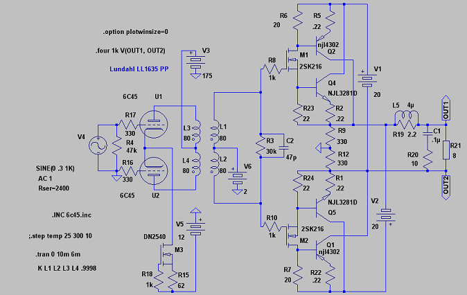

lumanauw said:
What input transformer to use? Where to buy?
Well, it has to be audio signal transformer familiar with these specifications:
- input impedance from 600ohm to 1kohm
- output impedance from 5kohm to 10kohm
- 1:10 primary to secondary windings ratio
- all around shielding (optional)
- audio-bandwidth linear frequency response
Searching the internet should produce some succes finding it.

Welcome inertial. I see that you are interested in upper schematics with transformer at input. The beauty of this one is its simplicity and reliability and that's the greatest quest in audio quality.
Of course you can use triode as a gain stage, I even recommend you to do so. :nod:
I have made one simple and very good sounding triode VAS with BIGBT output stage of which schematics will also be published soon.
You can change 12V accu in series with 22ohm resistor with galvanic insulated 100mA current source.
The power stage needs good linear power supply enabling +/- 50V and some silent 300VA transformer per each channel. 😉

12V accu is a 12 Volt accumulator, storage battery, as you can see it in the middle of schematics. And for the reason it has to be charged somehow, it's maybe better to change it (together with series resistor 22ohm) with galvanic isolated 100mA current source. I can post that later on.
What is interesting in this schematics it is a diode bridge configuration for bias current enabling and at the same time signal blockade when 100mA current is not present (mute state). It is very ingenious solution and can be incorporated in between any VAS/OUTPUT stage you can imagine. Maybe you can explore in that direction.
Two 22kohm resistors in parallel are forming app. 11kohm VAS load to GND, so you can easily calculate current capability of VAS and its correct biasing. Required voltage swing is at least 55V if you would like to drive output stage to clipping. :magnify:

You may even leave out these 22kohm resistors it will still work, but with them you'll get better measurements results and of course better sound. The trick is that those two resistors have to serve both VAS (proper load) and output stage (input impedance) just right. You have to consider input capacitance of the output stage in parallel with these resistors and calculate the value accordingly to -3dB frequency turning point. Too high value or no resistors at all can not compensate capacitive influence of the MOS-FETs and whole output. Try to find just the right value that will not be too much to handle for your triode VAS but it certainly should be less than 50kohms (two 100kohm in parallel).
Finally, about 55V , do you mean 55V peak to peak ?
No, I meant 55V of half periode swing (positive, negative) that means 110Vpp. 😉

Had to try the "compound-IGBTs" on a small Class-A hybrid Circlotron I have been working on. As I had no matched pairs Spice models I had to equalise current by adjusting R6 and R7.
The sims look quite good until clipping even though there is no NFB. THD is with H3 dominating. Extremely low anyway. Even going Class-AB without NFB looks quite impressing but of course with higher THD!
