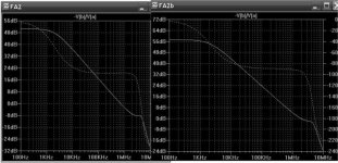

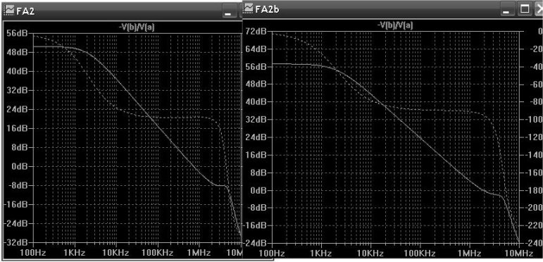

To go from 1381 to mje350
lower the Re's for the differential to 47 instead of 100r(increase loop gain for lower beta 350's ) reduce main Re for VAS itself
by 33% (100R to 68R) mje's have less current gain.

ostripper said:
Sim it..and see..
Oh, I have. Surprise, I found not much difference in the loop gain plots.
Not enough to warrant changing resistance values to check clipping performance.
Remember, it's not overall amp performance that I'm talking about here, just the clipping behaviour.
By MJL - Oh, I have. Surprise, I found not much difference in the loop gain plots.
And here we go back to Andy's statement that MS9/10
"ignores" certain data from the 1381 model.. I also tried
most of fairchilds KSA- XX (high voltage amp trannies)
with the same results.. I am downloading microcap 9 pro
now and will confirm this .
I see an 6 DB gain difference on LT4 ,but on yours (ms)
not much change .. so you tell me ..
OS
OS
It's still simulation as opposed to real life, OS. The clipping performance was worse on my version of your amp running the MJE's. Mine is running a lower VAS current and has the Zetex diff pair plus a few other differences.
Like I said before, sticking during clipping is hard to avoid. It was a problem on my Patchwork and I added clamps to control it. It is not a problem on my Abomination amp for some reason. There is some sticking, but I'm WAY over voltage for it to show.
