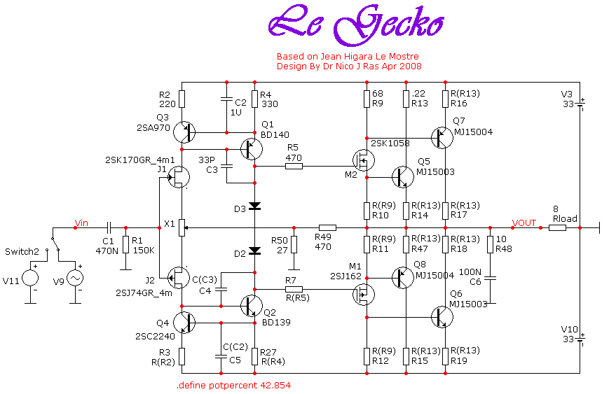

a very elegant design. I support full complementary symmetry and modified Le Gecko yesterday afternoon with the described output stage. Ii is fitted with 2SK1058/2SJ162 and I added MJ15003/4 to each side.
The link shows the original Le Gecko for those interested. There are a few similarities but I would like to study your design a little.
Anyway guys for those who celebrate Xmas - have a very Merry Christmas and prosperous New Year!:cheers: :santa2:
http://www.digisec.co.za/ras/music/Geck MkIV.pdf

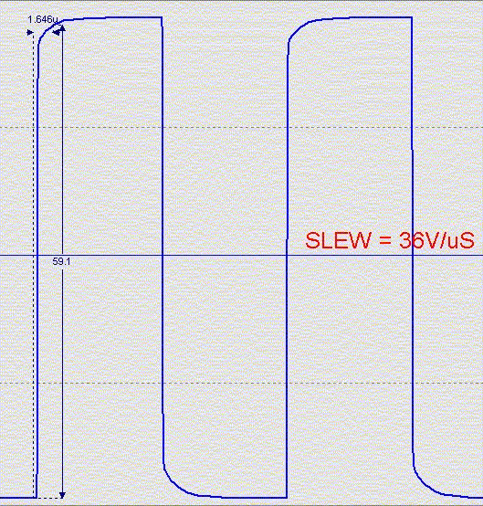

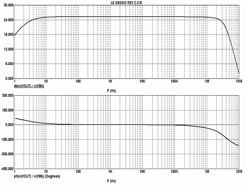

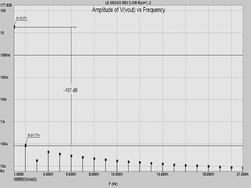

When compared to the original design without IGBT (mosfet only) the H2 is 4 dB worse at -105 dB but slew is the same.
However the design without using IGBT although revealing an overall higher THD, H5, H7 and H9 is an order of magnitude lower than with the IGBT. (according to sims anyway). I cannot make any real measurements because I will only go back to work on the 12th January.
Sound wise there is no audible difference between the two amplifiers.
I cannot see any advance adding four transistors to achieve an IGBT output stage and a lateral MOSFET output stage.
