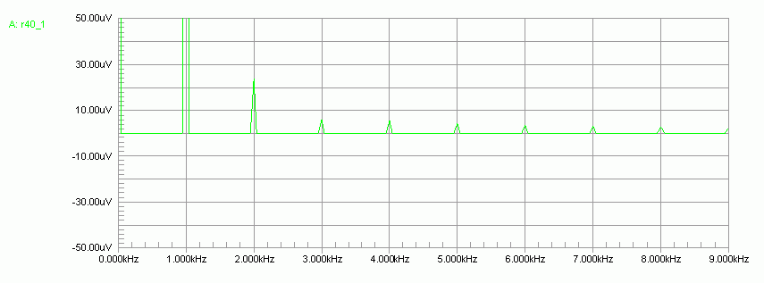

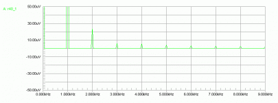

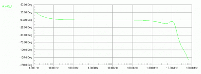

PS: It appears to generate large amounts of 3rd order harmonics, stability is an issue, but on the plus side it is quite fast. It has been used in a 3B-.... Bryston amp some time ago (but in a full BJT version).

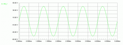

Simulation results of schematic in post #19
@ostripper
well, in simulator... why not, in real life... no thanks!
