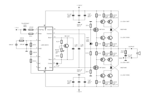

Using an LME49810 input stage ... me too 🙂

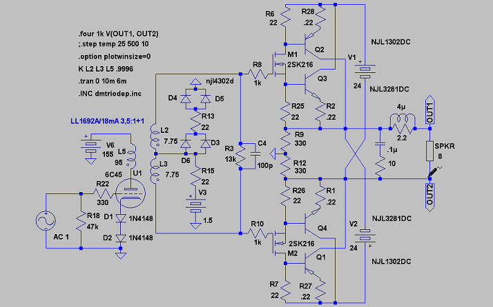

Just had to play around a little more😀.
With a very simple thermal compensation it seems to behave perfect, slightly negative up to over 150degrees C.
Also changed the input stage to SE as the overtone structure was with to much even overtones.
Even in Class- AB with 200mA Iq/transistor it looks good.
Anyway it sims beautiful, maybe one should have a go.........

Nico Ras said:
... I am guessing that the different and very appealing sound character could be attributed to the geometric summation of all the individual currents at the output terminal.
SOUNDs good 😎
Hi LazyCat, have you tried the LME49810 approach (very easy to do)? ... how did it sound ...
Well I have to say that my discrete VAS is certainly more realistic for my ears and long term listening more bearable. LME driver is not bad at all, it gives you more "instant" solution, easy approach to high power, very dynamic, fast and a little bit edgey sound. But certainly better than any D class amp, bacause there is no loss of fine detail and imaging.
I would recommend LME for a good studio monitor driver, strong PA amp and of course home Hi-Fi. This is completely subjective opinion of mine and it depends on what you've heard so far. :hphones:
SE input stage is fine and I like hybrid amps design with output BJTs, especially compact ones as yours.
It can be even build in point to point technicque or on a very nice looking PCB with a little nostalgia look.
I'm a bit anxious about it, can we expect something likely to see in near future? :wiz:
