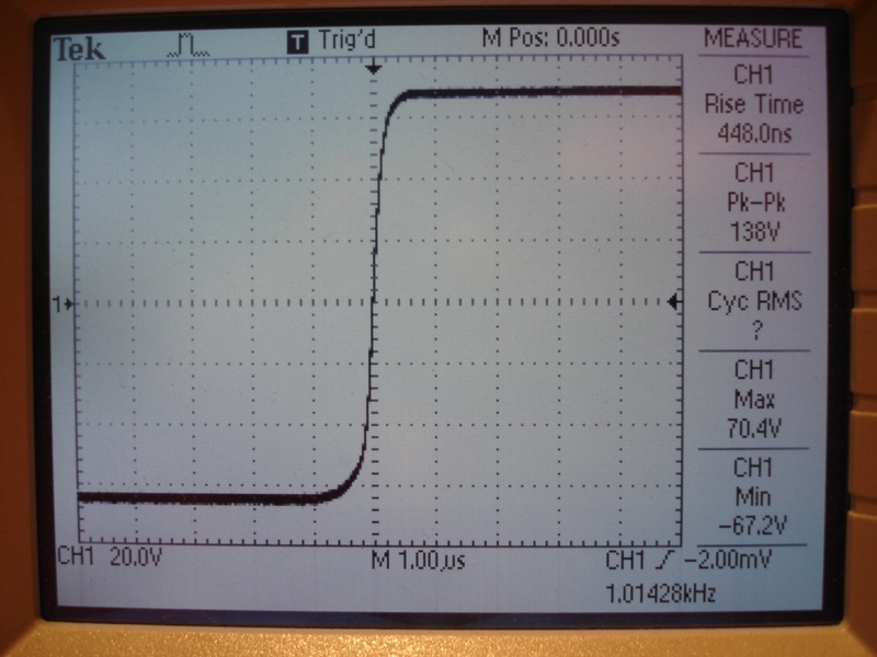

Yes is the answer. One of them is even capable of producing this plot. 😀

Wow, very impresive, love that ultrafast settling times... which one would be the "one" You mentioned & what about drive it full power sinus burst 150Hz + 6K7Hz mixed together for 10. sec in to dummy Load of 1R3 (500W) _ (oscilloscope capture + spectrum of 19+20 KHz full power) would be nice to see ?

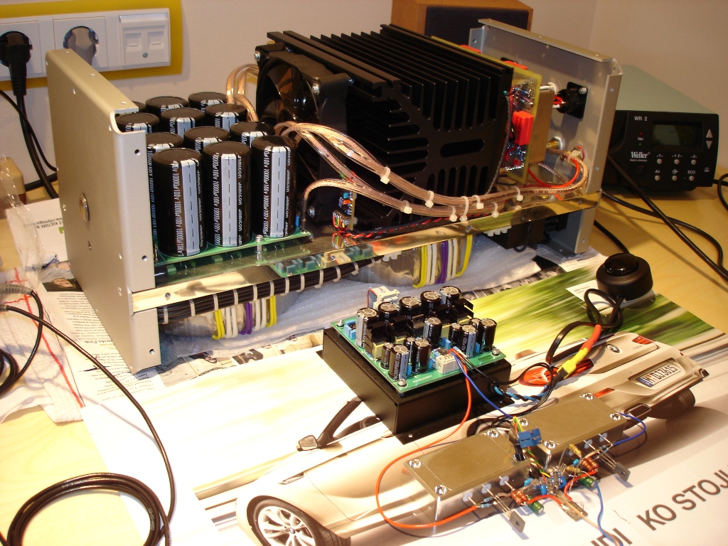

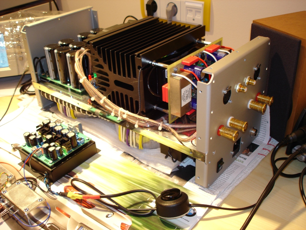

Controversial Power Amplifier

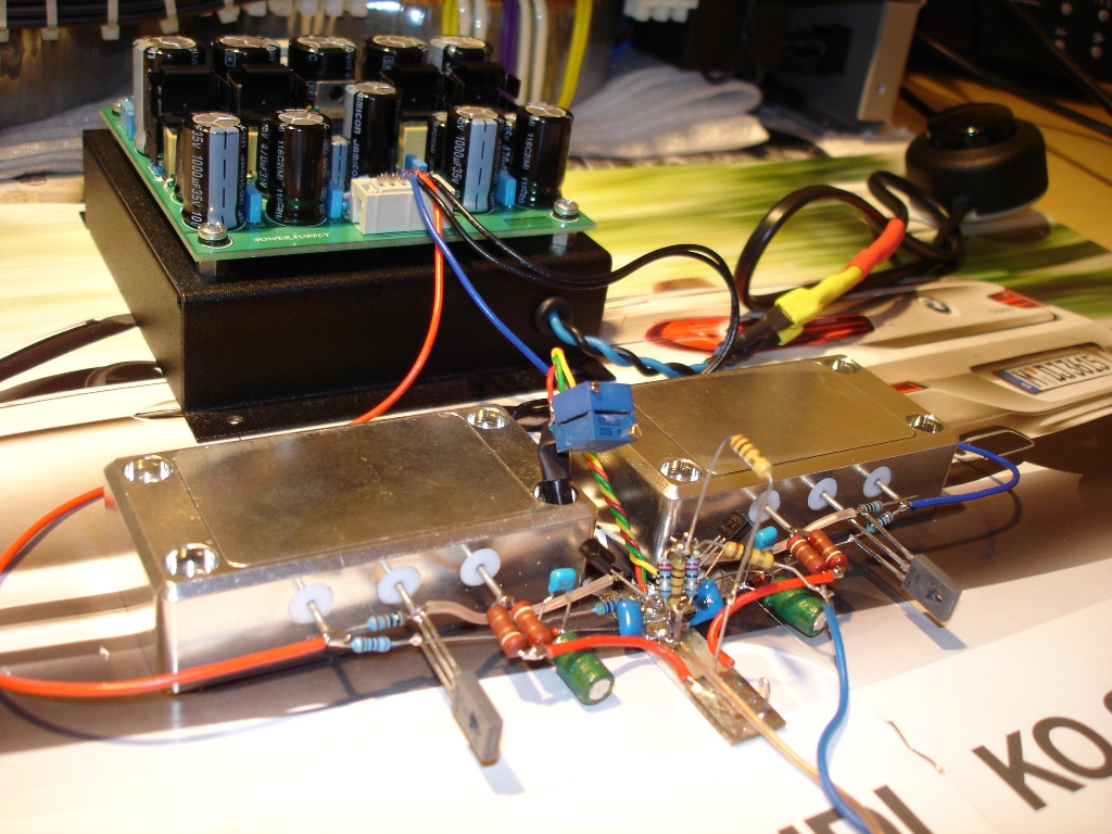

Some final testing in progress with full scale working prototype. Upper plot resulted in flat response 0dB/1MHz/4ohm/10Wrms. 😉

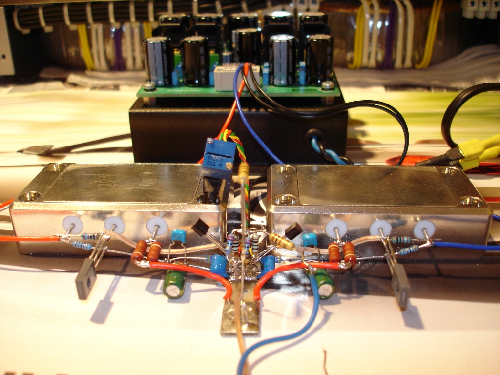

BIGBT Power Amp
This small test power amplifier gives 10 Wrms on 4 ohm load (power supply current limit) at any given frequency from DC to 1 MHz (signal generator upper limit) with absolutely 0 dB output voltage error. This testing amp is also a base to my next step - full power BIGBT amp with these nice looking output power devices. 🙂

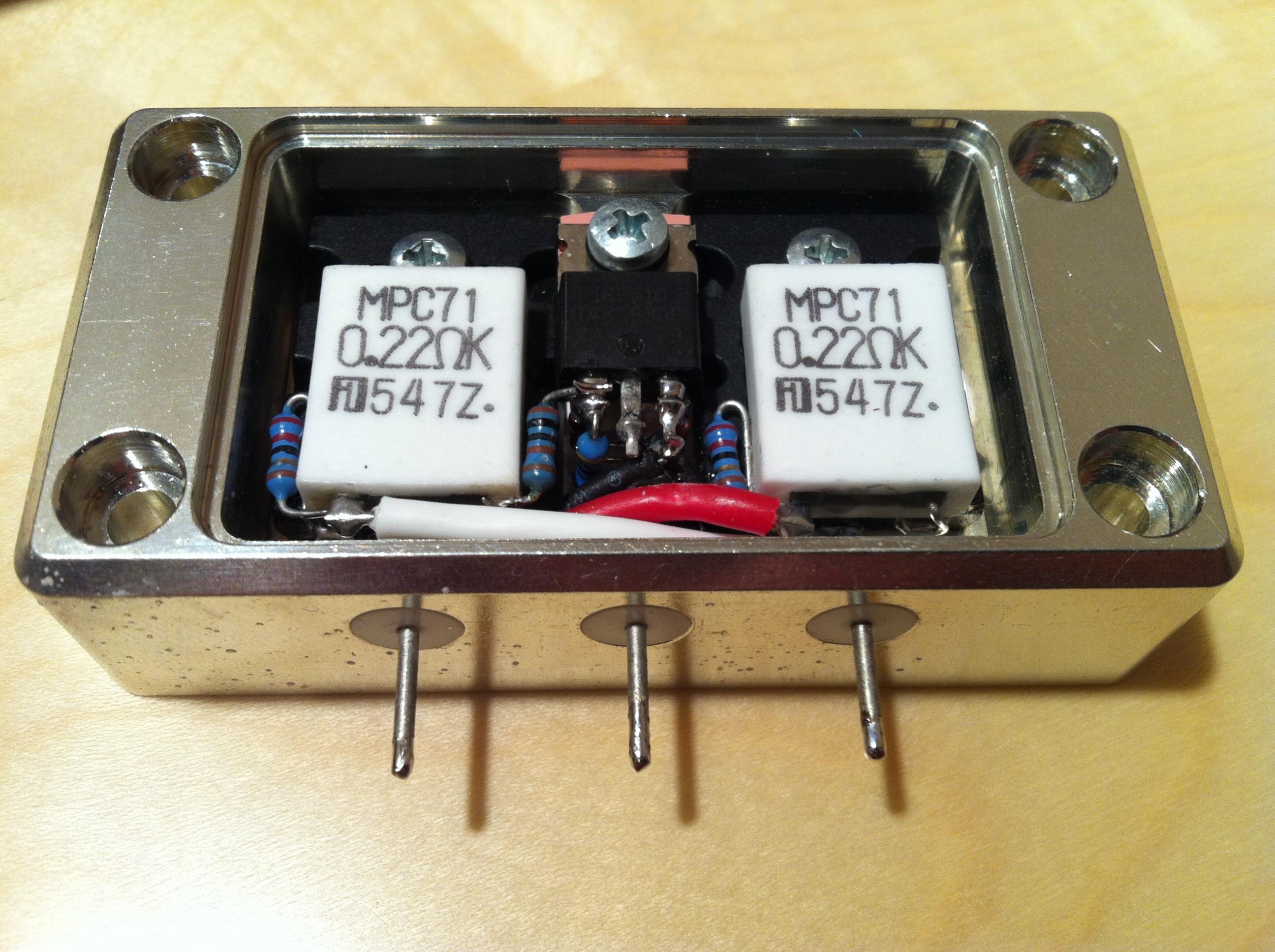

I assume the BIGBT is constructed into those slick looking cases. Where did you source those and what exactly are they? I'd like to find something like what you have pictured here.
Hi jkuetemann

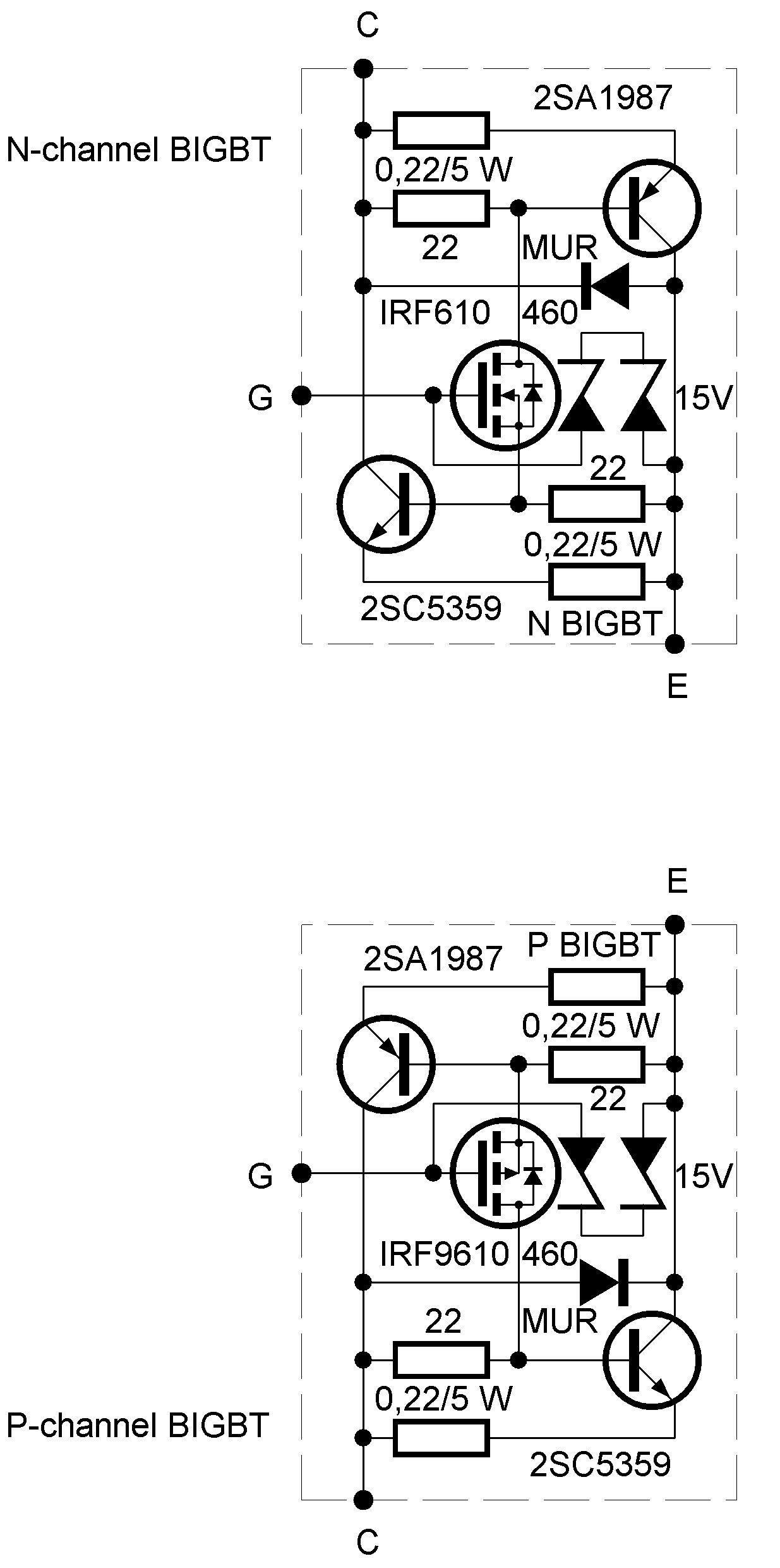

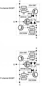

Yes BIGBT sch inside those cases. The case is made out of a single Copper block according to my CAD design. All three transistors isolated so the case can be mounted with four bolts to heatsink directly. It is gate (voltage) driven 230 V, 30 A, 360 W device. 😉

Thanks for the peek inside. There appears to be a couple of resistors in your BIGBT that aren't in the schematic I got from one of the other BIGBT related threads (a 10 ohm I see and another I can't make out). Is this the current schematic of your compound device?
