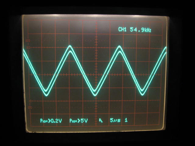

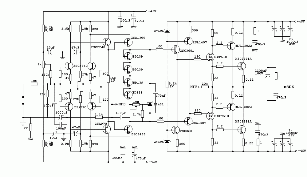

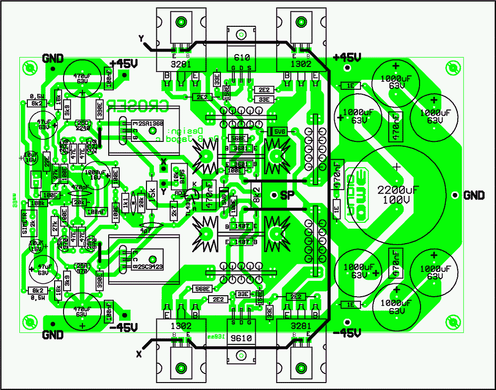

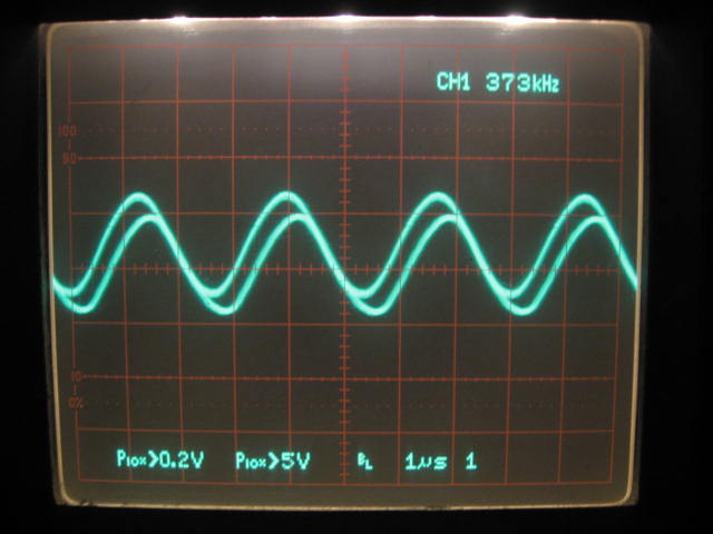

As I promised, here are files of CROSER amp. It has been designed as my respect for good friends and audiophiles on Croatian "ACCO Forum" and they are reporting excellent results!
SCHEMATIC...

Hi Boro!
Why did you decide to use CCS driven emitter followers (2sa1407/2sc3601) to drive IRF610/9610 - I mean, VAS transistors (2sa1360/2sc3423) run on about 4.5 mA - it is enough to drive IRFs directly (they have Ciss of only 140/170 pF). One stage less might be beneficial soundwise 😉

Edit: What was the amp's load when taking those scope shots?
Hi juma!
Well, let mi say first, I am one of those ridiculous designers that realy don’t like elaborating and discussing own designs in public very much.
Intention was to isolate pre-stages as much as possible, and frankly, no degradation has been observed so fare.
“One stage less might be beneficial sound wise” – might be… maybe worth trying, but I am neither a particular fan, nor a follower of minimalist approach of a style: less components or less stages –> must be better sounding. Life is never that simple unfortunately.
To prevent possibility to be misinterpreted, I have to say I don’t approve opposite approach either!
Good audio design is a game of “fine balance”.
