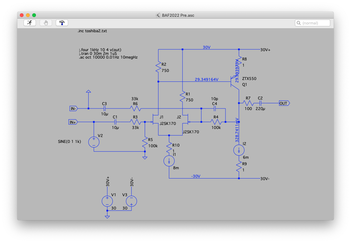

For this post, define mFET := an integer number "m" of Fairchild J113 field effect transistors connected in parallel. All sources tied together, all gates tied together, all drains tied together.
Front end ==
two mFETs connected as a differential pair
with resistor loads between drains and TopSupply
and with one mFET connected as constant current source #1 between diffpair "tail" (source node) and Bottom Supply
That is the First Half of the front end. The Second Half is
one PNP bipolar transistor connected as a common emitter amplifier. Input (base) is connected to First Half output (mFET drain), Common (emitter) is connected to Top Supply, and Output (collector) is connected to CCS#2
and finally another mFET is connected as constant current source #2 between PNP collector and Bottom Supply.
Total device count = 4 mFETs plus 1 PNP.

and no wires?

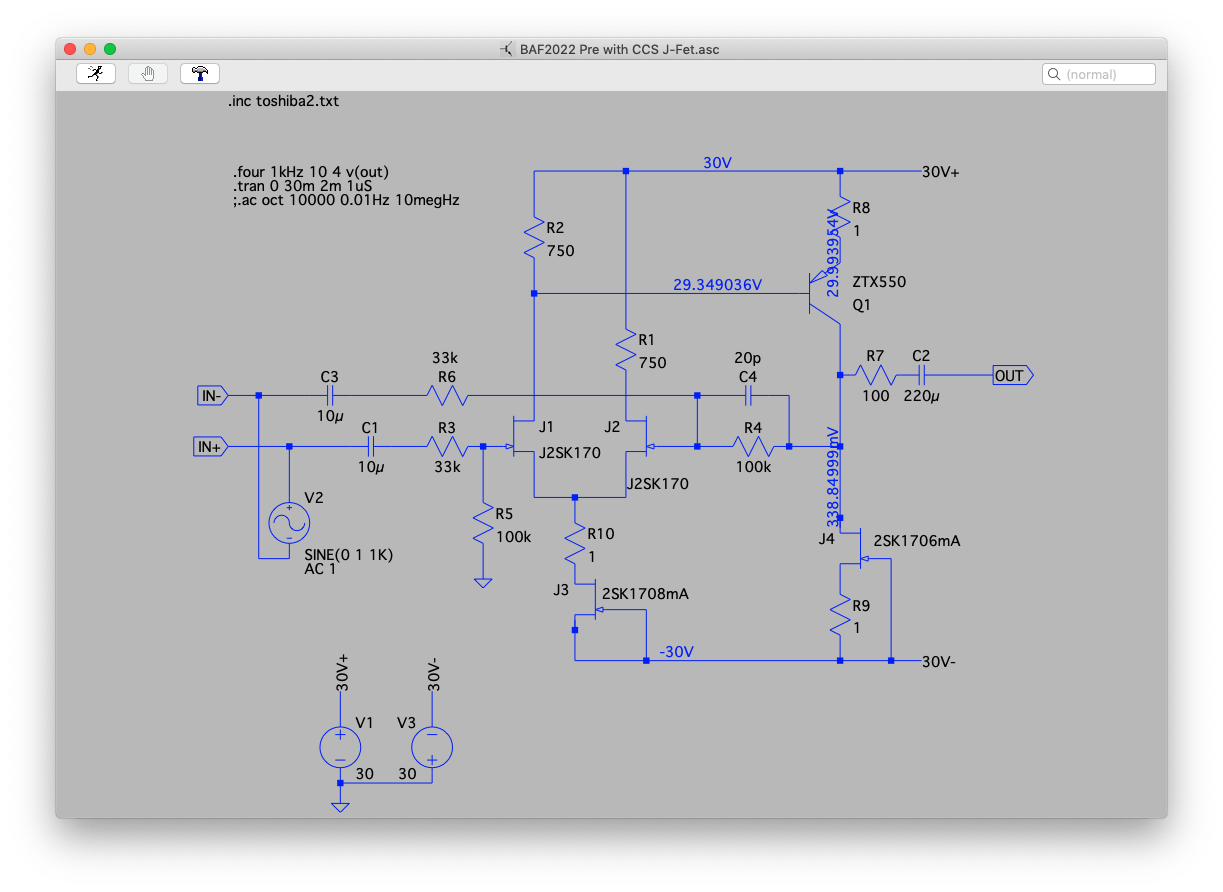

Hi Mark,
something like this?
and ... my distortion values are not the best and the THD pattern Spice shows is funny, so my draft is for sure only a mini mini approximation....
Are there still smaller portions than "halfNelson" to define me.... any suggestions welcome......
