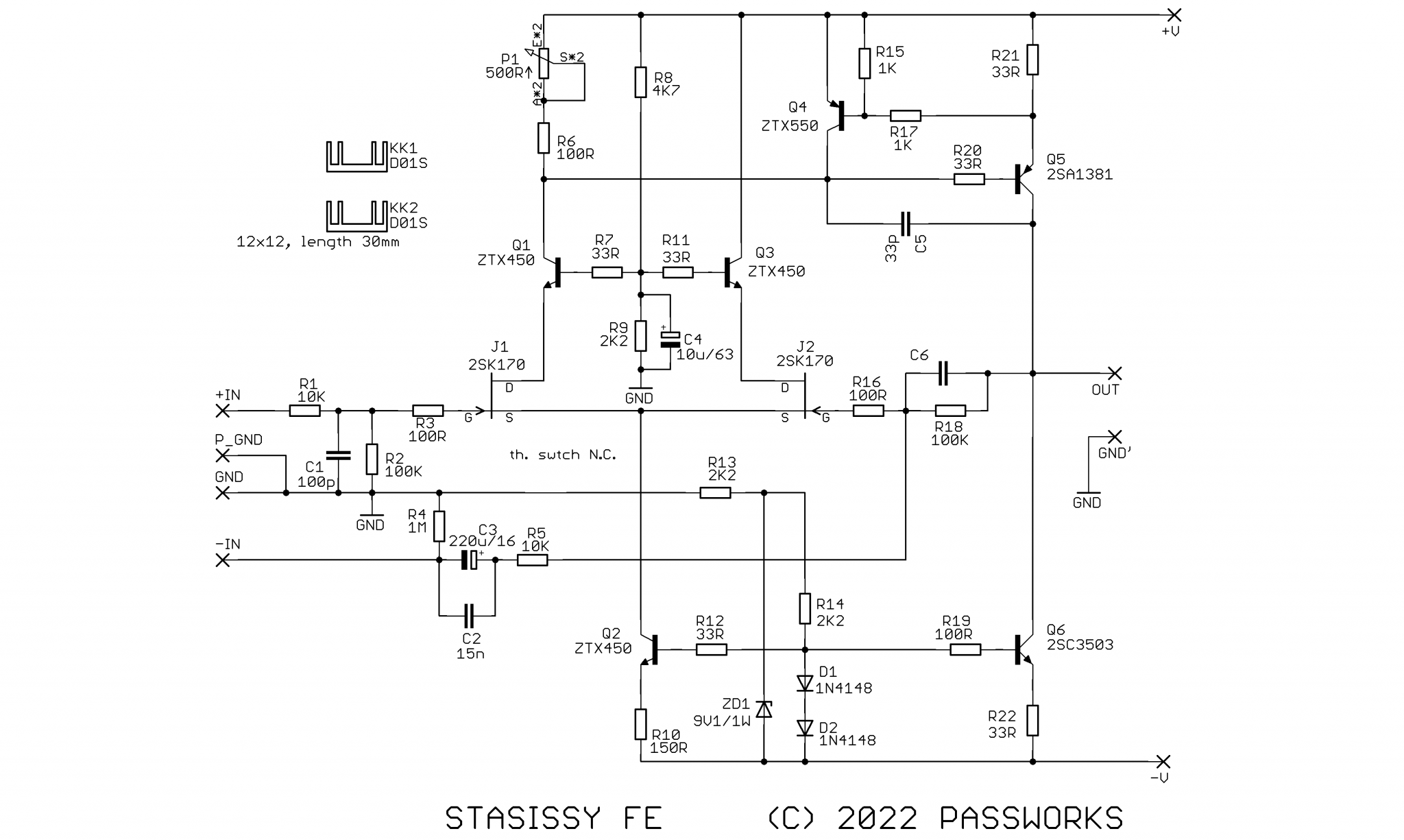

forgot to mention the bit version is with SK170. Maybe the OLG is much higher than with the J113.....

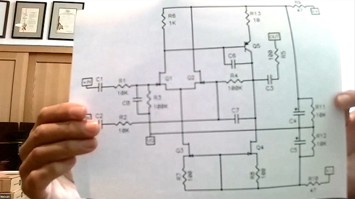

I got better. A blurry screenshot of the schematic of the Front End.Hi Nelson, when can we hope to see your pdf to the new pre?

as Pa is not going to give ya that soon, someone could clean Stasis FE and post

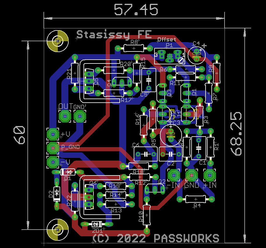

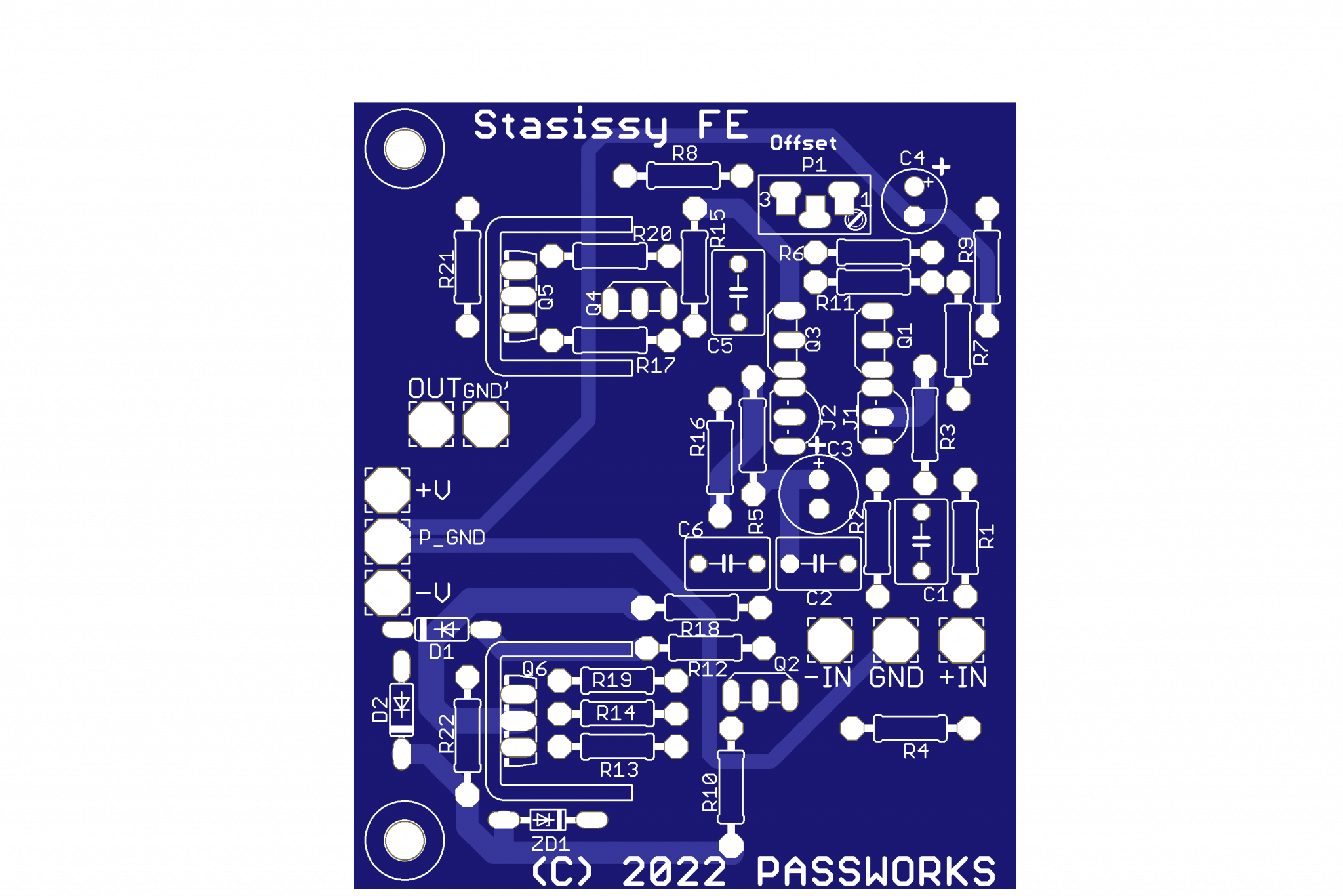

J113 - manage, isolator bushing on one pin is solving rotation of same, if needed
same applies if you want to use BC639/40 instead of ZTX
depending of rails voltage, resistor or two needs change of value, trivial
Ha! No, I was just trying to understand the schematic. Is your ‘-IN’ part of a differential signal, or is it just ‘audio GND’ for lack of a better term? I admit this is rudimentary stuff on my part…someone's greedy?
Ha! No, I was just trying to understand the schematic. Is your ‘-IN’ part of a differential signal, or is it just ‘audio GND’ for lack of a better term? I admit this is rudimentary stuff…![]()
same as screenshot of Papa's schematic in #88, this is having positive input, negative input, input GND, SE output (in phase with positive input) and output GND
so, SE/BAL input, SE out
dual rails
making it for single rail is trivial, but I'm leaving Pa to proceed with limitless overindulge of Greedy Boyz
