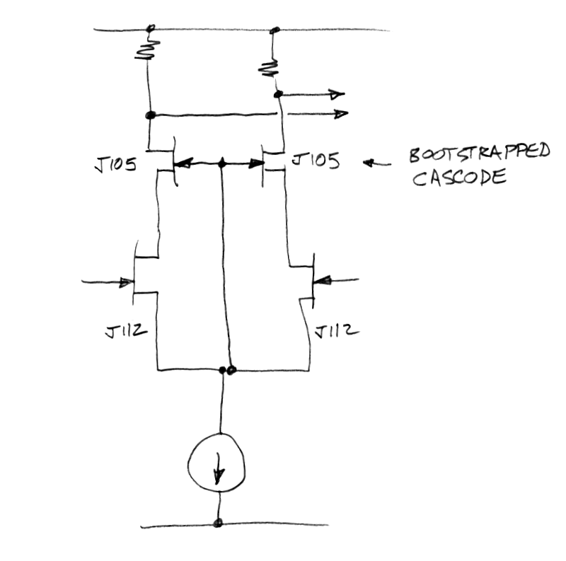

At BAF2022, I asked Paul Norton of Linear Systems to please start selling JFETs useful for bootstrapped cascode circuits. You want a large |Vpinchoff| and a large Vdg_max and a large Vds_max for this application. The old and now-obsolete J107 and J105 were pretty good for this application, if only their voltage ratings were higher. Paul said he would investigate.
