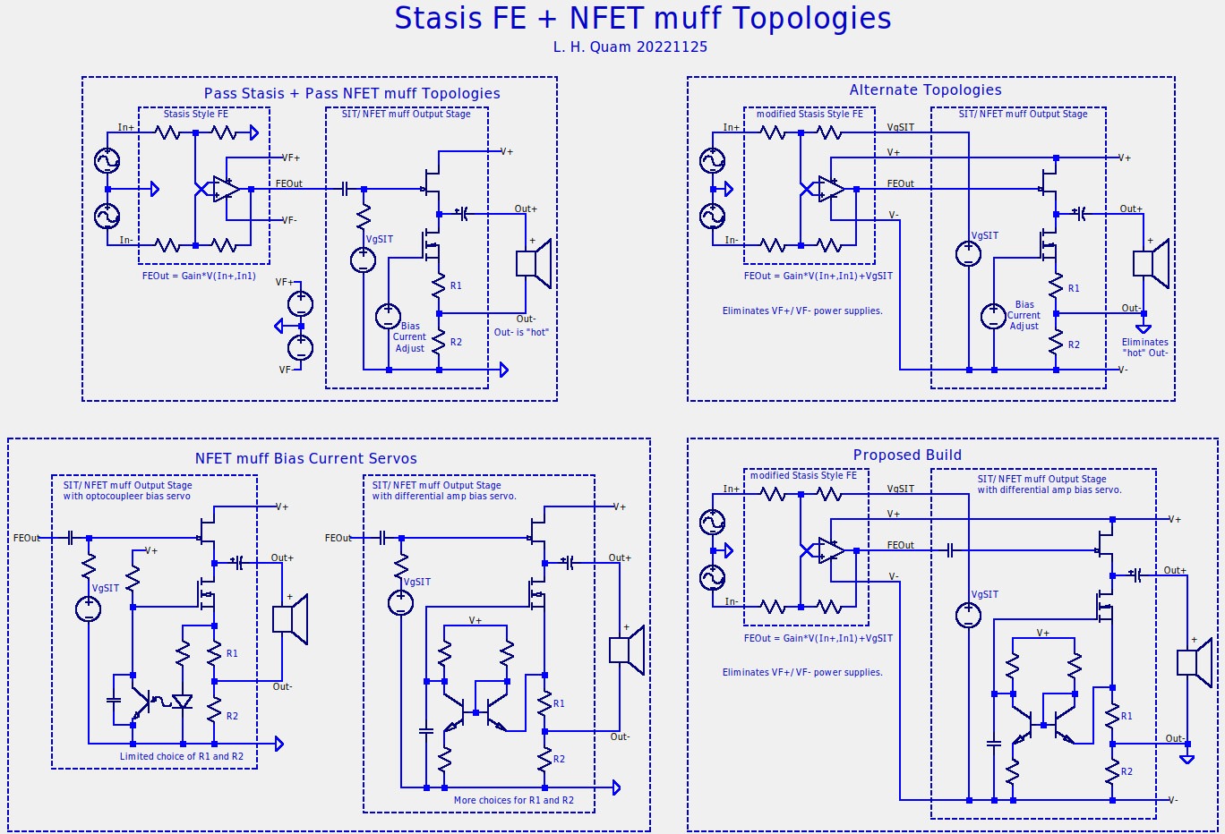

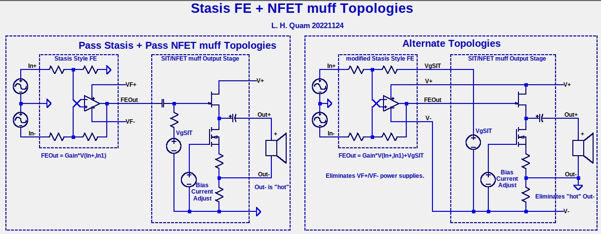

I propose one more change to the next Stasisssss FE: Do not ground R2 (100k) -- allow R2 to connect to an external input as will be illustrated below. With that change and both inputs cap coupled, the Stasisssss FE can use the same power supplies as the OS and do some other tricks as well, which I will illustrate in a future post.
The second one looks like not correct. V- is short to GND only thru a small R. The big cap have to be moved to the negative terminal of speaker.
It is correct. The power supply floats by the voltage across that resistor.The second one looks like not correct. V- is short to GND only thru a small R. The big cap have to be moved to the negative terminal of speaker.

It is still a muff. The reason this works depends on the Stasis opamp having cap coupled inputs and a decent of common-mode rejection ratio (CMRR). The AC swing on the supply is actually small: Vout*R2/Rload, which is Vout/40 for R2=0.2R and Rload=8R. The output stage doesn't care about the location of the ground connection. I have run extensive simulations of this and it works just fine, having exactly the same performance as with ground connection to V-.Should the speaker negative be connected GND? Is it still a MuFF?

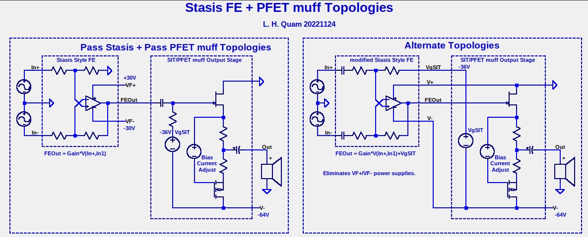

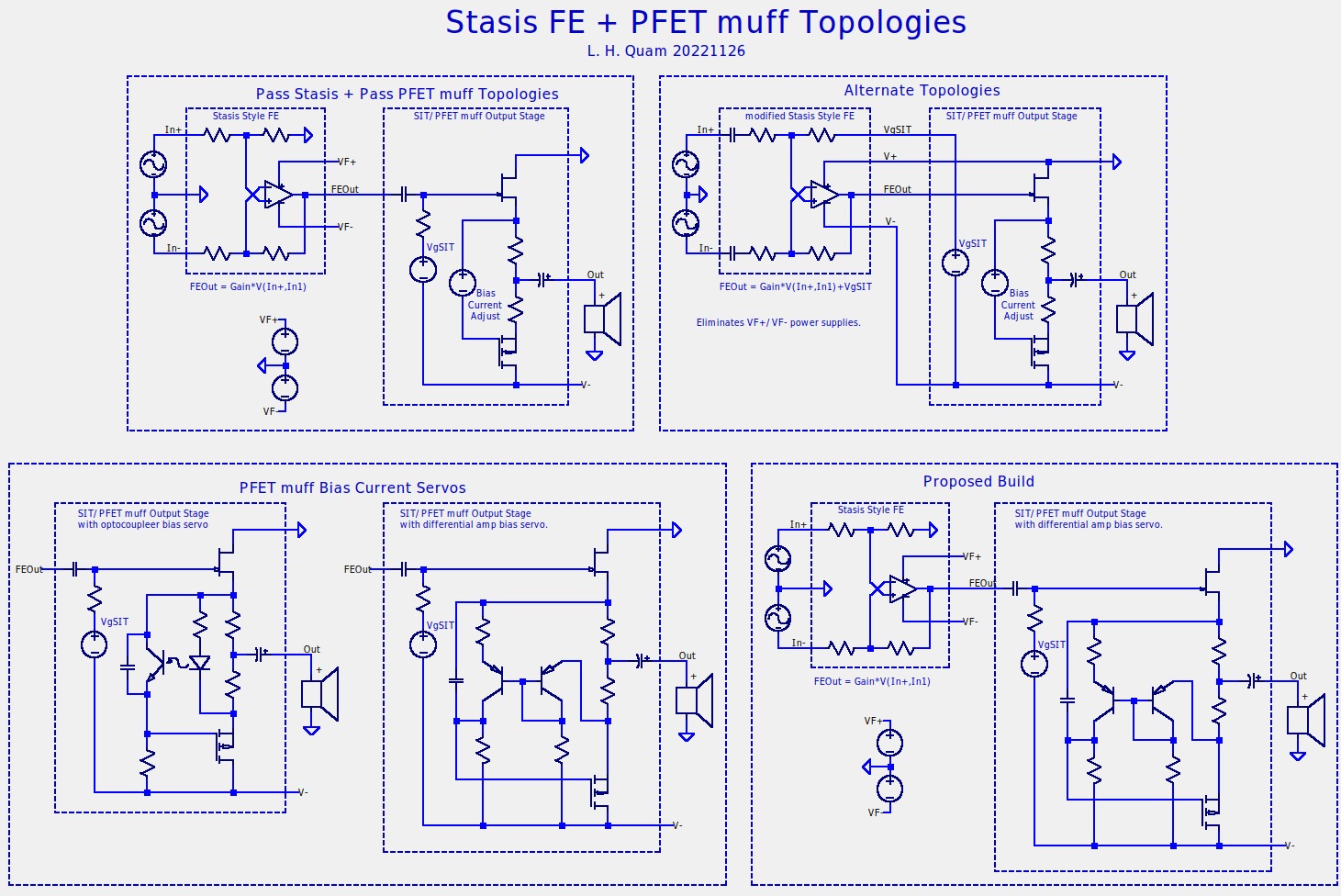

Here are more Stasis FE and muff topology options for both PFET and NFET configurations. I am particularly interesting is the differential amp bias servo because it provides more options for R1 and R2 of the mu follower. The R1 and R2 can be chosen to provide better performance, lower overall power dissipation, and higher output. More about that in a future post.
