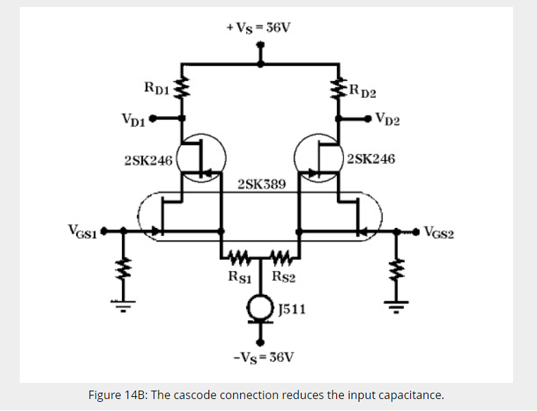

I asked Paul Norton of Linear Systems to start selling JFETs useful for bootstrapped cascode circuits.
You want a large |Vpinchoff| and a large Vdg_max and a large Vds_max for this application.
This self-biasing JFET cascode is what Erno Borbely & John Curl used extensively.
The most popular cascode device is 2SK246BL / 2SK103BL.
They are rated at 50V, and have max Idss of 14mA.
But if you would use them to cascode K170/J74BL running at Idss, you would end up with little or no Vds headroom.
So in the past I have used J111/J174 instead in the same position.
Disadvantage is much lower voltage rating.
J111 still can be had for a few cents, but J174 seems quite impossible now.
You may try your luck with J175 and select those with high enough Vp/Idss.
But again, limited to 30V.
We'll make available our stock of 2SK246BL / 2SJ103BL after matching.
Will take 6 months or so to match them all.
Patrick

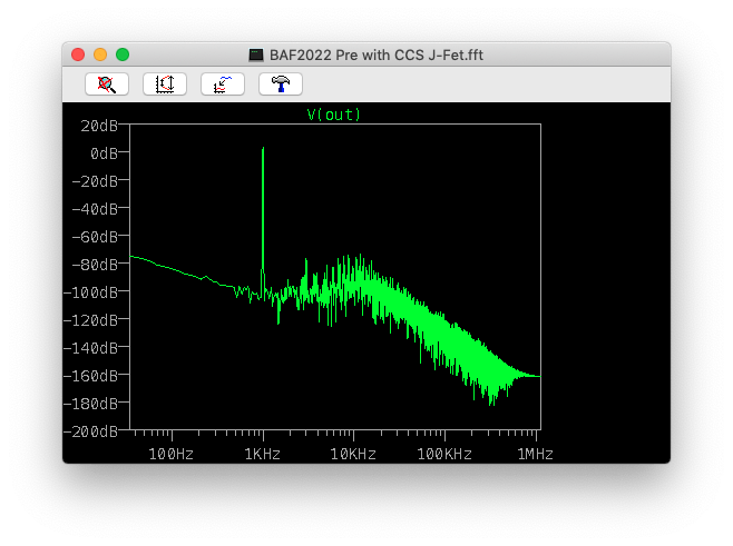

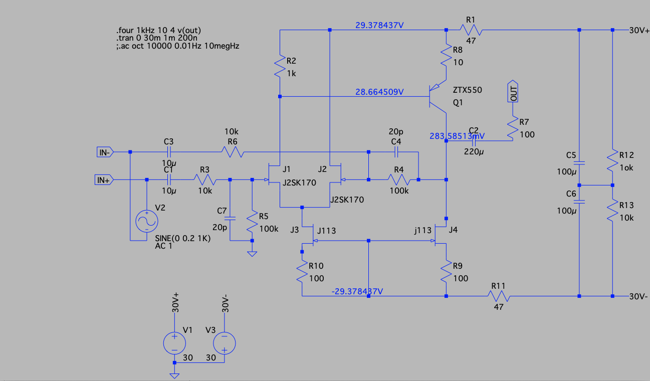

So I looked for the new small pre and here is my Spice following the picture.
On the left side we have no value for C5/6 I took simply 220uF. Same is true for the RF cap in the input, Nelson gave no value I took simply a value that stops bandwidth with 3dB at 100kHz.
Irritating for me the distortion for 2V output and 1kHz is fairly high in Spice about 0.056%. That is too high I think so I must miss something.
