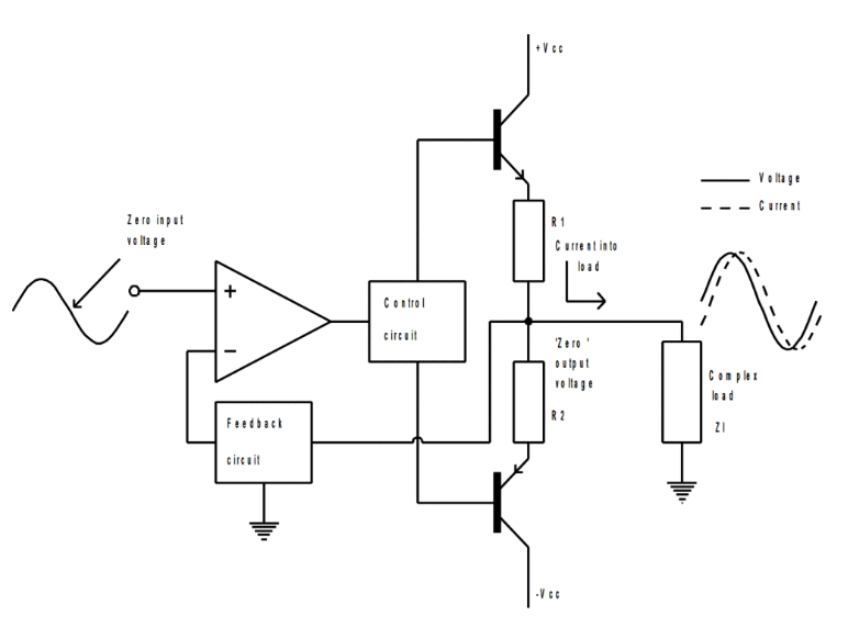

The huge majority of people are listening to Class AB amplifiers and in the transition between A and B, if the voltage and current being are not together, large (and measurable) bursts of higher order harmonics are generated when the 'voltage' correcting feedback has to be used to deal with it.
This has been measured by a Dutch scientist - Hans van Maanen of Temporal Coherence. I quote and please see attachment, his block diagram of a Class AB amplifier is very revealing. Here are the words associated with it.
"When the current through the load is not zero because of a phase shift between the two, one of the output transistors needs to deliver this current. But this is not possible unless an error voltage at the output can open one of the output transistors via the feedback loop! So distortion is introduced and this phenomenon tends to enhance cross-over distortion which is well-known for its highly annoying properties because it has the wide spectral distribution of harmonics as shown... A class-A amplifier is far less sensitive to this phenomenon (simply because there is always current flowing through the power transistors)..."

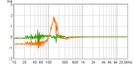

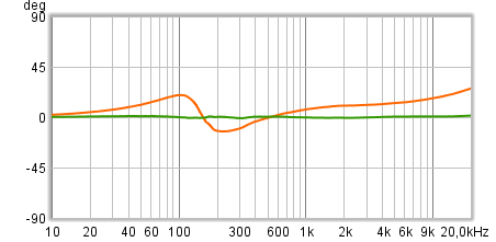

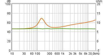

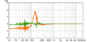

...get the voltage and current of amplifier in sync, in time...
Don't know why but REW verse other software has a feature to show group delay for measured impendances, so when you talk about sync in time any chance that REW feature or that curve in reverse figure can be related.
Below example show 25 times Vifa TC9 drivers in a line array, raw verse resonance/inductance compensated.

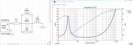

This might help in understanding where the capacitor comes into picture. To model a simplified impedance of a loudspeaker unit, a few parts suffice to do that.
