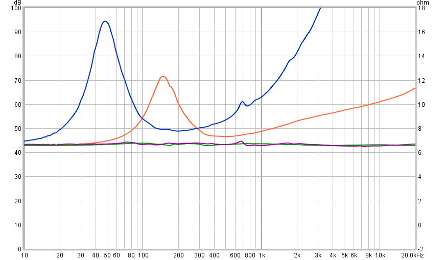

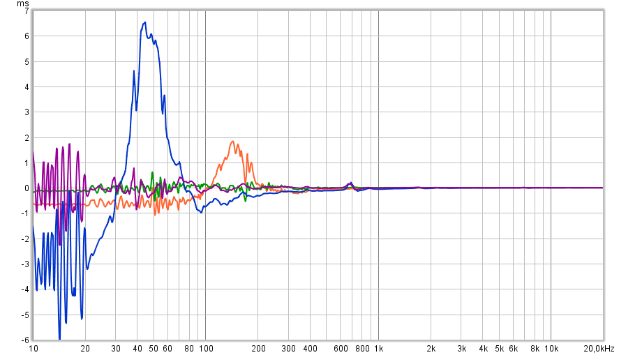

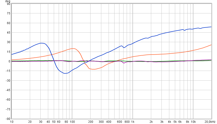

so in Brytt's last plot the orange is raw, the green is compensated?
Precise although note its cone is a relative less diameter and probably extreme small numbers for effective mass (Mms) compared to higher same numbers of woofer drivers you intend to run in parallel yourself meaning power and brake of parallel network compensation feeding to ground is hotter there. For visual comparison in below attached graphs you see a single 10 inch woofer into sealed enclosure overlaid to that previos post using small diameter widebanders.
Re below maybe those post 15061 graphs say nothing but think its collaboration so miss a comment 🙂
...I want collaboration, not fighting...
so the blue line is the 10? (should include a legend of colors)
thanks for confirming my thinking that parallel drivers makes the situation worse.
Yes blue are one 10 inch woofer and orange is 25 times 3 inch widebanders, but i'm not shure agree your thinking where situation is worse its just that if you want to use networks to compensate then situation change needs for value and numbers of components and also in general small leight cones verse big heavy ones (physics) and their intended frq domain coverage means something in the puzzle, suggest try model behavour into free XSim or VituixCAD.
ok thanks Brytt more homework on Xsim (i think there's a little something lost in translation)
the compensation has to be applied to the specific situation? not individual drivers?
Its dynamic and user selectable for case to case for example same compensation network that works for one induvidual driver can work for multible drivers where you have to add same numbers more of multible networks that you also add drivers, but also you can measure or model new situation of multible drivers and make you one nice new compensation network using other and fewer component values that works for that situation. Other dynamics that change situation is for example if its also a multiway situation and if that multi way use passive or active XO points, for multiway passive XO speaker system it also mean alot if compensation network is situated before or after the passive XO network, so alot of dynamics to counter and deside for.
